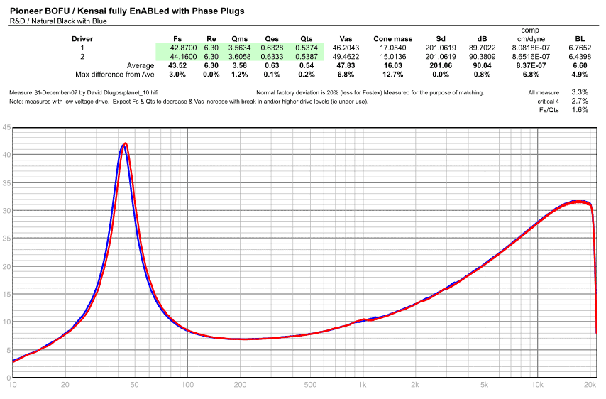

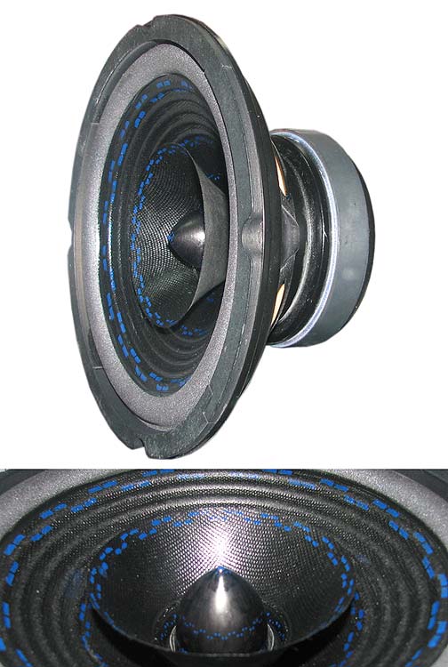

Yup I did some more reading...how many coats of the Micro gloss did you apply? Now that I read all he details I am getting very exited and want to do this...I may have to order phase plugs from you very soon hehe...planet10 said:
I might use damar on the whizzer, but not on the main cone.
I've just treated Kensai's B20s, I used 2 thin coats of puzzlecoat before the EnABL. He already had phase plugs.

Fast1one said:Yup I did some more reading...how many coats of the Micro gloss did you apply?
What are your initial impressions of the modified B20?
3 coats of 50%.

Edit: I hear a lot of talk of dammar, would you reccomend adding a coat of that as well? If so how? (and when)
Edit Edit: NVM Planet 10, reread your posts
Fast1one said:Thank you! I can't wait...
No. My experience with damar is that it will stiffen the cone sufficiently to sinduce some breakup modes -- just the kind of thing i try to kill. On a whizzer cone driver with no top end, using it on the whizzer cone can stiffen things up sufficiently to give more HF (but part of that may well also be a breakup mode, but much higher). Worth experimenting with and one of the reasons i got 4 drivers. My prime purpose thou was to develop the phse plug with tweeter as i figure it can be done for essentially the same price as the phase plugs (for FE206/207/206rSR) that people are already putting into their B20s.
The cones can definitely benefit from treatment i just don't think damar is the best thing to use.
dave

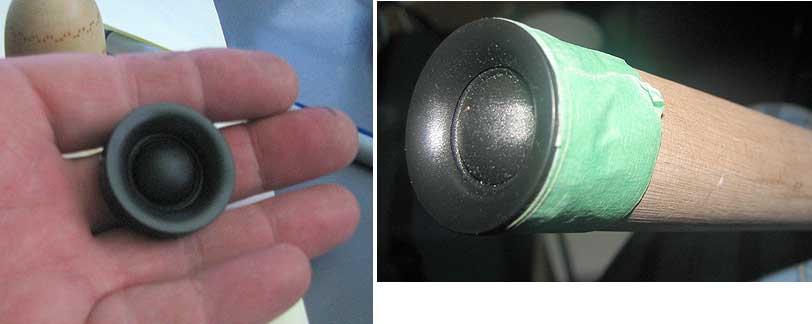

OK guys, now that we have this thread, Let's use it for all discussion of mods to the driver itself, including adding a coax tweeter.

Variac said:now that we have this thread, Let's use it for all discussion of mods to the driver itself, including adding a coax tweeter.
I've posted these pics elsewhere but i'll add them here for completeness.
At 3' this plug needs to be trimmed down a bit.
dave
