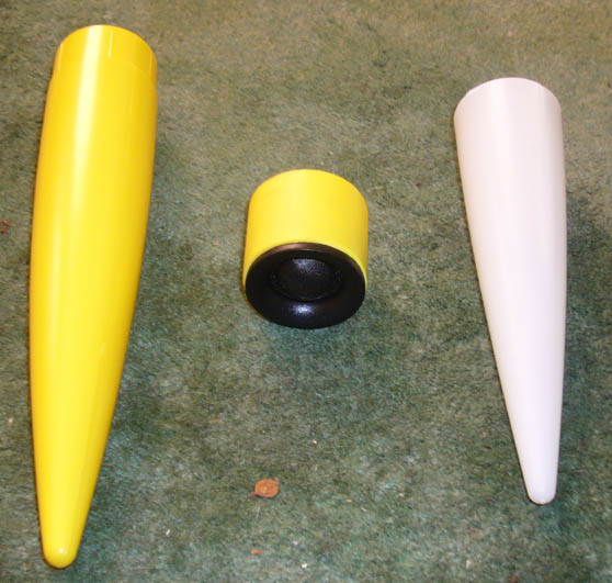

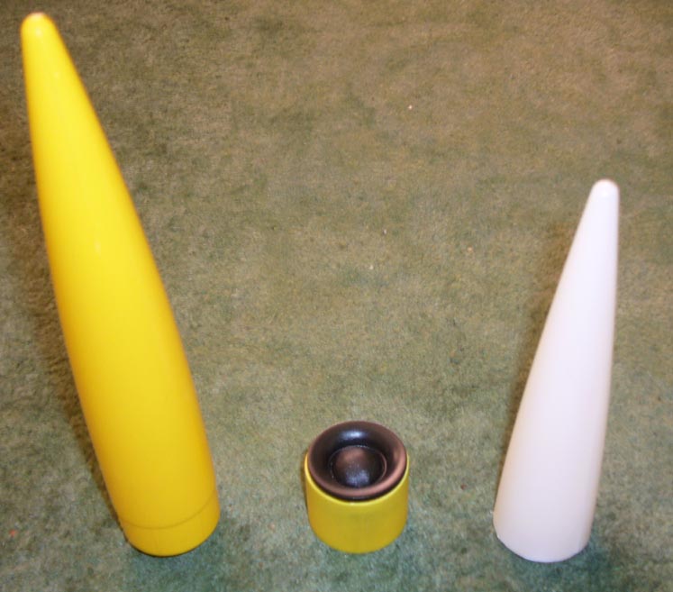

About a month ago I bought some model rocket nosecones to use as phase plugs with the BOFU (B20) My plan was to cut the end off and mount the tweeter there so that there would be a smooth taper phase plug to the point that the tweeter was mounted.
I discovered that the diameter of the tweeter is so close to the diameter of the pole piece that there really isn't much taper possible .
The diameter of the nosecone is slightly smaller than the PP so if it were bigger around the results might be slightly more dramatic, but only slightly. I used an Estes BT-55 size and the next diameter up would be too big I think.. .
So, I'd say that the people using a straight tube or dowel are on the right track.....
