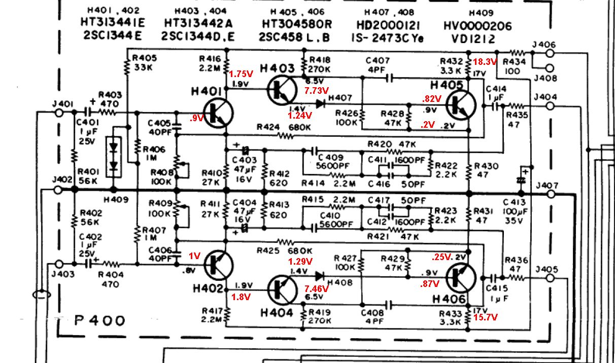

Looking at the schematic, it seems that those potmeters have to be adjusted such that the collectors of H405 and H406 are at 17 V. Is that possible without causing motorboating?
Unfortunately, no. If I adjust them to that voltage, I have motorboating. It isn't until I'm at about 31V that it stops, and 34.5V for other low-level noise to stop.

Thanks for taking the time to weigh in Chris.
All of the parts I used were from Mouser, so I think I'm ok in terms of their provenance. Next question: Did I choose the correct components? I believe I did, but I could use another set of eyes to check me.
C401, C402: 1uF 100V Panasonic polyester film ECQ-E1105KFA
C403, C404: 47uF 35V Nichicon electrolytic UKL1V470KPDANA
C413: 100uF 63V Vishay electrolytic MAL211890513E3
H401 - H406: KSC1845FTA On Semi
H407, H408: 1N4148
H409: Two IN4148 in series
If these are all ok, then I have to look at my installation (again).
My understanding of the datasheets and looking at the original 2SC1344s and 2SC458s on the board is that their pin outs are B-C-E, whereas the KSC1845s are E-C-B. So all of the replacement KSC1845s were installed facing the opposite direction of the originals.
I believe I observed the correct polarity for the three electrolytics and the diodes, but I have to question everything at this point.

Referring back to my list of substitute components, the ones I have any doubt about are 1N1418 for the 1s2473s at H407 and H408, and the Panasonic film caps I subbed in for the odd-looking (to me) tantalums at C401 and C402. Those tantalums actually look similar to the VD1212s -- red with white dots.
Thoughts?

Chris, thank you. No offense taken at the suggestion to reevaluate my soldering work here as well as my technique going forward -- it can always use improvement.
I also agree that I did or disturbed something that's causing the board to misbehave. Perhaps some new information that I gathered earlier today will help get me closer to sorting this out.
So with the bias pots set roughly at the mid point, I have motorboating. However, if the board itself is left to hang perpendicular to the chassis (i.e. not screwed in and only connected by the input/output wires), the motorboating stops. If I slowly move the board back toward the chassis, the motorboating will begin again when it's about an inch away.
I first thought that perhaps the flexing of the ground wires at either end of the board was disturbing a cold solder joint, so I resoldered both posts -- no change. Next I tried to see if slightly moving the ground wires could induce the motorboating when the board was perpendicular, but I couldn't. The one thing that does cause it to start, albeit only for a few seconds, is if I touch the electrolytic at C403. Touching C404 does not have the same effect. I pulled C403, which is a new UKL Nichicon, and tested it with my Peak Atlas ESR70, and it measured fine. Resoldering this cap didn't make any difference either.
So what's causing this? I suppose the most obvious culprit would be the chassis itself. Could voltage leaking from somewhere else into the chassis induce the motorboating? There's also the rather substantial run of wires that goes straight across the space behind where the board mounts, though nothing has really changed with these since before I did the work on the board. But neither the chassis or the wires seem to explain why touching C403 would cause the motorboating to start.

Hi Matt,
Well, C403 / 404 are in the feedback loop. So touching them could easily inject signal pickup and cause all kinds of behaviors. I have never done this, nor have I ever run the board lifted way off the mounts. I have run them close to their normal position, but have never experienced what you are seeing.
I guess it's time to check components. Motor-boating is most typically caused by poor supply decoupling (maybe that capacitor is open) or a resistive ground. Marantz does use a single ground point in their receivers ("the ground") where you will see all the black ground wires converge. This is normally a screw-down terminal or a bent up tag that is part of the chassis. So you have a star connection and another ground connected to that circuit somewhere could also induce a motor-boating situation.

Everyone has been a great help to this point. I realize this is one of those issues that's difficult to solve in person and impossible remotely. So as I add more information to this thread, it's as much to help myself get perspective/think out loud as anything. (Of course, any new suggestions/insights are always welcome!)
With the phono board remounted, all wiring routed close to how it was prior to disassembly, and the bias pots adjusted roughly to mid point, I check the resistance from the two ground posts on the board to several points on the chassis. The highest I read was 0.8 ohms, and the lowest was 0.2. I also measured the voltages and compared them to the schematic. I've attached the results. Nothing seems terribly out of whack to my eye.
That said, this was without the shorting plugs inserted, which is when the motorboating arises. As a reminder, without the shorting plugs, there's no motorboating audible through headphones, though there is significant buzz. When a turntable is hooked up but not powered on, the buzz diminishes. With the table powered on, there's near silence. And there's no noise than I can detect when an actual record is playing.
After checking the voltages, I inserted the shorting plugs and attempted to eliminate the motorboating by adjusting the bias pots to a spot closer to mid point. Previously, they had to be turned near to their max to stop it (when I was reading nearly 35V on the collectors of H405 and H406). When I turned them very slowly, especially the left, which as Chris pointed out could be the channel driving the right into oscillation, I was able to get the motorboating to stop. Both pots were roughly in the middle. However, the motorboating was replaced by significant hiss/white noise in the left channel and a very low level buzz in the right.
Now the odd part (as if the rest of this wasn't). When I turned the function switch from Phono to Aux and back again, the motorboating returned. The bias pots hadn't been touched from when I had just tweaked them and heard the hiss in the left channel.

Hi Matt,
What is the drop across R434 and the B+ (should be 35 VDC).
-Chris
Looks like 1.1 VDC.
I get 33.9V at R434 and 35V at J408.
Hi Matt,
With a short, you have changed the input impedance seen by the base of the input transistor. Having to guess and fire off an idea from the hip, your motor-boating could be related to the time constant between the 1 uF coupling capacitor and the 470R resistor.
One thing you could try to do is pull C401 and C402. See what happens then. I'm really sorry, but this is complete guesswork because I have never been in this situation. If it were on my bench I could give you more helpful insights.

Hi Matt,
Well, we know the amplifier isn't stable now. Changing the input impedance does make it unstable - again this is affecting the feedback to some degree. A change occurred when the new components were installed. Can you try to install a pair of 1 uF capacitors in where the tantalum capacitors were? Smaller capacitor = lower surface area and stray capacitance.

It may be a good idea to recheck transistor pinouts just in case (ideally comparing with the schematic). It is easy to get caught with ECB vs. BCE.
Either way, motorboating is low low frequency oscillation. It is unlikely to have much to do with RF properties. I would look at supplies, bias networks and the like. Maybe better supply decoupling is all it needs. Can't hurt to recheck C413 and its solder joints, not sure what would happen if this were not present for some reason.

Hi sgrossklass,
Yes, absolutely. Motor-boating is LF oscillation as you have pointed out, but I have seen it caused by issues that would upset a circuit in to a high frequency oscillation. Really high frequency oscillation tends to be a single stage, or one or two devices at the most. That's where you will see the MHz type oscillation (and why you absolutely need a 'scope).
If C413 was bad or not connected, I would expect the circuit to motor-boat at the very least. Supply bypassing is very important, and a lower value capacitance in parallel would tend to tame HF oscillation if you had that problem.
This circuit has an EQ that rolls off the highs, so ultrasonic oscillation should not occur. If it does, you are looking at some fraction of the entire circuit where the negative feedback loop isn't involved. The huge bass boost will encourage motor-boating however.

Chris, the caps at C401 and C402 may be the issue. Last night I swapped out the Panasonic polyesters for the original tantalums (which fortunately I hadn't tossed yet). So far, there's no motorboating with the inputs shorted and the bias pots at the approximate mid point. If this is, in fact, the cause, would the stray capacitance you mentioned be the most likely explanation? It seems odd, given that I believe others have used film caps of a similar size here.
