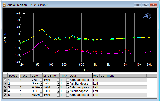

I bread-boarded the circuit with 2N4401. The role of the 100k potentiometer is important and care should be exercised adjusting it
with it cranked up you'll get 60dB of gain (I disconnected the feedback network) noise and motorboating. adjust it incorrectly and gain will fall of after 5kHz.
suggestion -- jumper the 56k input resistor and adjust the potentiometer through its range, set it a bit below the level at which motorboating begins. You should be able to achieve gain of 55dB.
The graph below (input shorted) shows how "twitchy" the potentiometer can be -- in terms of noise.

I measured the noise by jumpering the 56k -- you could also just use a shorting plug on the phono-input.
