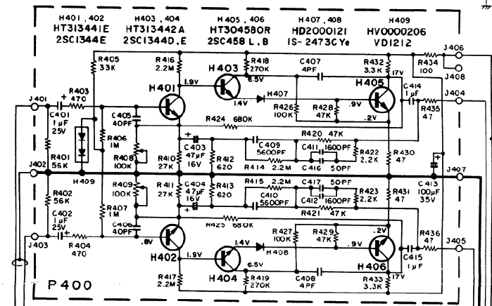

PC Board P400 is the phono board. If you disconnect the wires connected to J404 and J405, (the output pins of the phono board -- probably wire-wrap) and ground these wires, you can determine whether the fault is in the phono board or in a connection from the phono board.
Sometimes these old transistors just fail.
Like a lot of hi-fi gear at the time, these old Marantz receivers were were conservatively rated.
Here's the circuit:
attachment.php

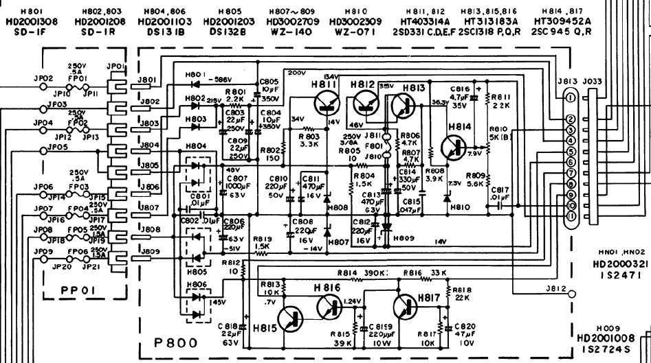

And here's the power supply:
attachment.php
Critical caps: C713, C816 - replace with 50-63 V parts. C403/404 would have to basically go open to affect noise levels severely, but are worth a check.
Zener H810 could use something like 220 µF in parallel, at which point I would also reduce its current to make the filtering more effective by upping R808 to 10-15k (readjust output voltage afterwards).
Critical transistors: The two 2SC458s are arguably the most dodgy candidates, even though 2SC1344 and VD1212 are no unknowns when it comes to intermittency. Static bursts do not equal permanent hiss though.
If I have my math right, the input transistor is running at a measly 15 µA, possibly less - I've seen <100 µA, even 30 µA, but rarely something quite this low. Surprisingly, this should still yield voltage noise low enough (well below 10 nV/sqrt(Hz)), though it makes input capacitance rather critical (having Vbe of only ~1.7 V does not help) and obviously is rather demanding in terms of transistor leakage. With good parts this circuit should not be unduly noisy at all.
Obviously I would prefer the more common kind of 3-transistor circuit that puts the buffer at the output rather than in the middle (see e.g. Kenwood KA-6004). That said, this circuit here seems to have been used in quite a range of vintage Marantz receivers for several years. Can't have been that bad.

I just spent some time trying to isolate the origin of the hiss (relatively smooth, Conrad) using a signal tracer on the phono board. First, I need to correct myself: I said it was the same in both channels, but it's actually noticeably louder in the right. And based on what I could hear with the signal tracer, tt seems to arise at the junction of R421, R423, and R426. Unfortunately, since using the tracer I have significant hum that's overpowering the hiss when monitor the output over headphones.
I just finished telling someone this morning that I don't like to shotgun repairs, but in this case, I'm leaning toward just replacing the electrolytics and notorious transistors in both the phono board and power supply.
The noise minimum is about IC ~= (kT/q) * sqrt(hFE)/Zs. With Zs about 12 kohm (effective RIAA- and A-weighted average impedance of a 500 mH cartridge) and hFE around 250, IC ~= 33.3 uA. It's a rather flat optimum, so anything from 15 uA to 70 uA should be close enough.
