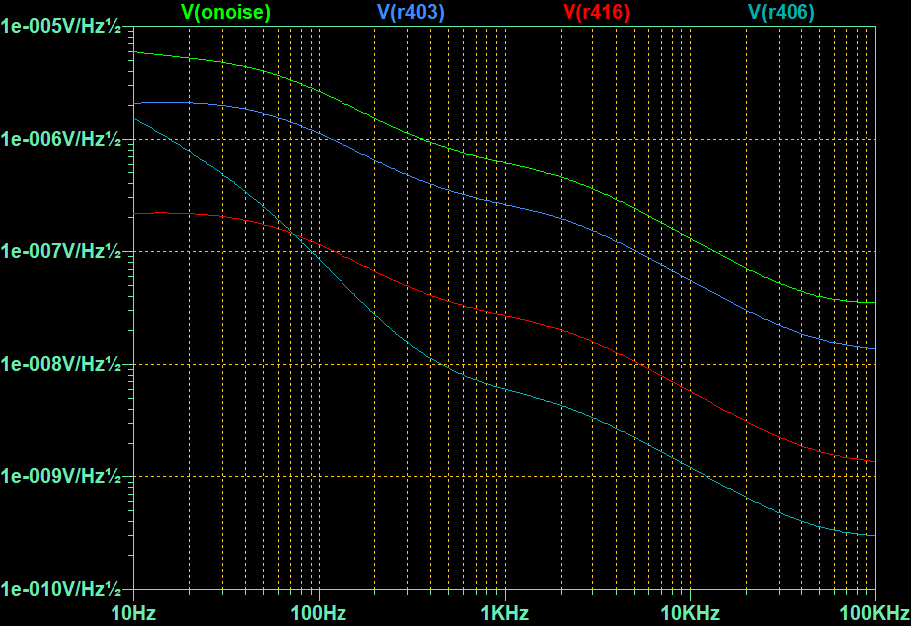

That 60 dB surprises me, because when I look at the circuit, it seems well designed to me: first stage with a good low-noise transistor biased close enough to the noise optimum, reasonably low impedances in the input and feedback networks, no obvious other flaws.
Is that 60 dB referred to the usual signal level of 5 mV RMS at 1 kHz and if so, is it in dB unweighted from 20 Hz to 20 kHz, in dB(A) or in dB measured according to ITU-R 468 (previously known as CCIR 468)?
With a reference level of 5 mV RMS at 1 kHz,
60 dB(A) is indeed quite bad,
60 dB according to ITU-R 468 is rather good, as the quasi-peak measurement prescribed by ITU-R 468 normally results in much higher measured noise levels than other methods,
60 dB unweighted is largely irrelevant, as the unweighted noise doesn't correspond well with the noise one would hear.

Did you take into account the effect of the cartridge inductance and the amplifier's equivalent input noise current?

When a moving-magnet phono preamplifier has an unusually high measured signal-to-noise ratio, it often means that the designer has overlooked the effect of the amplifier's input noise current and has measured with an unrealistically low source impedance. Hence the question, have you taken into account the effect of the amplifier's input noise current and the cartridge inductance?

I have not calculated those parameters per se. There is a reduction in preamp noise when the cartridge is connected meaning the bias resistor is the culprit. This is why I alluded to a new biasing method to eliminate this resistor. Pioneer listed the s/n on the original preamp as 78db and mine is outputting 7 db more signal with roughly the same amount of preamp noise. The other unofficial test is the noise is more then 20db below the lead in record groove noise.
Do you mean the 47 kohm termination resistor and replacing it with a combination of series and shunt feedback? That's a good way to reduce its contribution to the input noise current. In any case, when you have low noise with a real-life cartridge connected, everything is fine.
About 110 ohm.
That is, looking at the Hitachi 1 kHz noise figure graph, when biased optimally, its noise figure is 2 dB with 300 ohm source resistance at 0.4 mA. Neglecting the difference between junction temperature and the 290 K used in the definition of noise figure, that means the transistor's noise is equivalent to (10^(2/10) - 1) * 300 ohm. Subtracting (1/2) * 26 mV/0.4 mA to account for its collector shot noise and (as it is biased optimally) an equal term for its base shot noise, I end up at about 110 ohm.
How did you model the cartridge?
Used the equivalent series resistance of the inductor at 1kHz, 6.3kHz and 10kHz, and a simulation with zero series resistance -- compared. At 6.3 kHz (ITU-486) the noise contribution is 520nV/RtHz - 190nV/RtHz.
So I did a recap and swapped in KSC1845's to replace the 2SC1344's and 2SC458's. Now I have a new problem: motorboating. Could the KSC1845FTA's have too much gain for this circuit?
So you use an LR series network, simulate with four values of the resistance and compare the results? That should work.
You could use Laplace to create a frequency dependent resistor -- assign the model to LTSpice "Varistor"....will have to get the little grey cells to work on it.
So there is an effect, but the rolloff of the RIAA curve mitigates against it.
