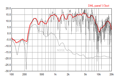

I have made some measure on a starbass driver, another kind of DML
http://eazy-world.com/images_et_son/enceintes/ENC-STARBASS.htm
here is a wav.zip attached, it's a convolution of logsweep, so you can examine amplitude response, harmonic distorsion and phase and so on. The wav has been resampled to 44/8bits to fit in a small file
The dip at 10kHZ comes from the standing waves in the thick board I used, (my computer board)

Jzagaja
ok I thought it was ARTA but I did not get the fotoshop trick
in this .wav you find a main pulse at the right, this is the response
and a suite of smaller pulses to the left, those are not echoes
but harmonics (distorsion), from this transducer (and microphone)
This is related to the FARINA's method of capturing a logsweep
and doing a convolution with the inverse of logsweep.
http://www.melaudia.net/zdoc/sweepSine.PDF
This is by far the best, easiest and more complete method
of one shot measurment on a transducer or gear.

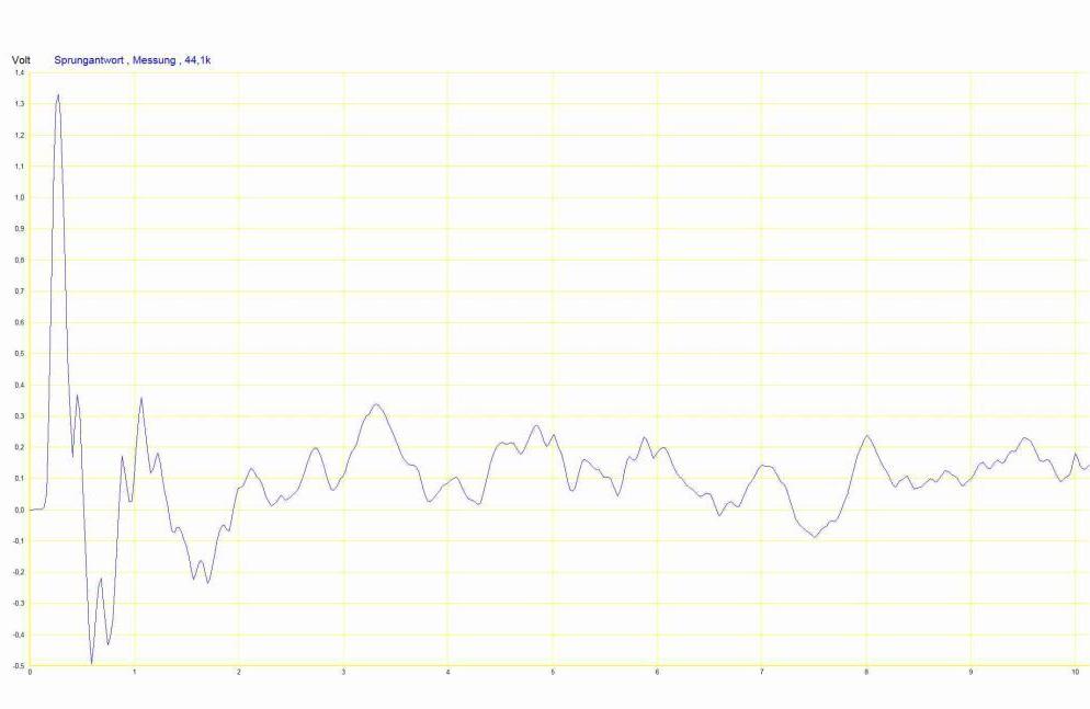

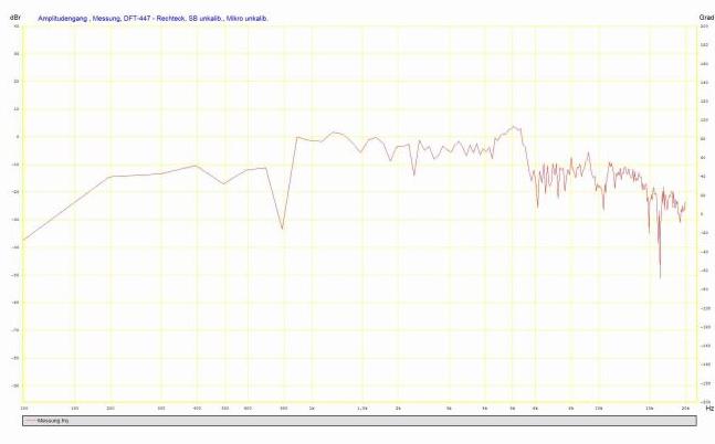

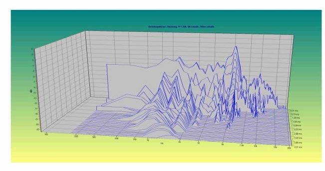

Since this driver operates modal above 800 Hz,
it would be useful to average over several
microphone positions.
As for all DML speakers a single on axis microphone
position does not tell enough to estimate the behaviour
of the driver. Frequency response varies even with small
changes in angle, which is typical for DML.
When tuning the driver to be nearly flat above 5Khz,
it sounds "overbrilliant" and "nasty".
Auditively the driver sounds rather good by now,
the presence region is not as natural as it should be.
There is still a peak around 5Khz, which can be smoothed
easily using a notch, which i omitted for the measurement.
But i heard a lot of conventional fullrangers which sound worse,
and need more amounts of compensation ...

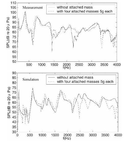

Hi jzagaya,
you have shown interesting investigations.
As far as i understand, there is a main problem which is
common to all transducers which rely on propagation of
bending waves:
Low modal density at the bottom end of operation. Low modal
density of a DML is nearly a synonym for "low quality" in the
frequency range under question.
I can identify the following strategies to circumvent that
Problem in current (commercial, established) systems:
1: Balance the modes by adding mass (and optional damping),
and align the diaphragm to have usable modes for balancing
-> "BMR"
2 a: Avoiding the range of low modal density
2 b: Making the diaphragm (excited panel) large enough
to have high modal density in the low frequency range.
2a Leads to multiway systems, incorporating conventional
dynamic bass drivers. A very pragmatical way to go IMO,
which may lead to good results, when implemented properly.
2b Leads to very large sized panels, causing the well known
acceptance problems (at least in the "non audiophile"
rest of the world ).
IMO there would be a third strategy:
Think about increasing the modal density at low frequencies,
without increasing the diaphragm ...
When going this way solely by searching for appropriate
materials, we end up with materials that have low speed
of wave propagation leading to low efficiency.
Kind regards
