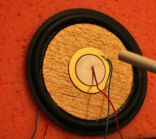

PIEZO NXT type panel
And how it looks like.
I'm not in to technical response curves as such, but I can see that 2 piezos in phase increase output at their most efficient frequencies?In my experience, as more exciters were used, the sound got better and better - it's as simple as that.
To this day, I find no abnormal resonances (but the panels are still not properly mounted and supported - that may be another story?).
Also, according to your set up, you must NEVER place an exciter in the exact middle of a panel, be it round, square or rectangular. I read this on some NXT application notes somewhere a while back.This may be the reason for some of the resonant peaks?
I have never taken most people's suggestions seriously on using push pull exciters. Your response and experiment proves this - well done!🙂
