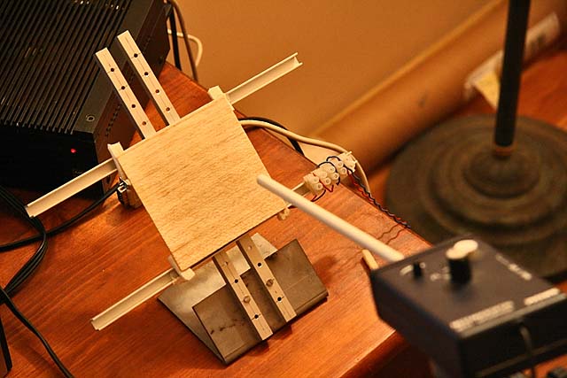

Does anybody have an idea why nobody is using balsa plywood?
Because it's soft? I have 10x1000x1 sheet and shellac. Should I make a laminate 90deg with Patex Moment and measure with a piezo?
Just curious, one 27mm piezo element has R=2.1kOhm, Z=61kOhm, C=26nF. Does it mean I need sqrt(61000/8) = 81:1 transformer? That's too high IMHO.

Balsa or Samba can be found in every hobby shop in Poland for 4,5 EUR/m2/1mm. Typical format is 25x1000mm. Tonight will try make some laminate. I have in my mind a model made of stiff pyramid pattern excited with a long piezo custom made. In theory compression wave that is smaller than panel dimension will radiate like above coincidence peaking off axis and pyramids will convert the rest to a bending wave.

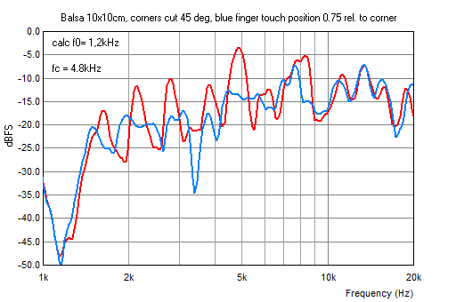

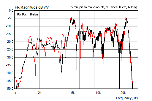

Find better position or/and balance the modes 🙂 5kHz looks to me as 3rd corner mode as exciter is on an exact center position. Sound get nicer when I put my fingers on the corners or one finger no matter where. If one piezo element is Z=65kOhm so we use only a fraction of its efficiency that is nearly 100%?
Find better position or/and balance the modes 🙂 5kHz looks to me as 3rd corner mode as exciter is on an exact center position. Sound get nicer when I put my fingers on the corners or one finger no matter where. If one piezo element is Z=65kOhm so we use only a fraction of it's efficiency that is nearly 100%?
Interestingly if you cut corners you will excite more modes between 1,5kHz and 5kHz. I can repeat experiment with 100mm round membrane with typical rubber suspension. Expecting less modes and worse sound.

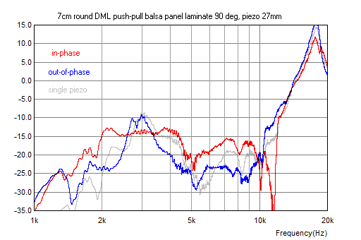

Yesterday made round membrane and applied shellac with pumice and linseed oil as usual furniture coating. Sticked two piezos with a brass plates face to face and sticked to balsa on both side making push-pull, connected in- and out-of-phase. Response looks like one big resonance from the piezo plate itself and wood response below. Nothing interesting but don't see much change between a single arrangement and push-pull.
