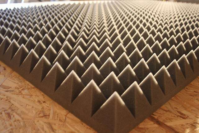

As for the third strategy I'm curious what will happen if you take such a foam:
http://apama.pl/APAMA FOTOS/PANEL STT7.5.200/STT7.5.200-1.JPG
spray with a stiff resin and excite transversely and longitudinally.

The idea is as follows - generate longitudinal waves like in yours plus transverse and if they are shorter than panel dimension then radiation like above fc occurs. Below bending waves are excited on pyramids - "wide coincidence region". Radiation will be efficient but the question is if f0 are not higher than in a plain membrane.
jzagaja said:... Below bending waves are excited on pyramids ...
Can you please explain ...
"Below" means below concidence frequency or below the
range where (bending) wavelength is in the range of panel dimension ?
What do you mean with "excited on pyramids" ?
What kind of motion do you intend for a single pyramid e.g. ?
I mean the torsion motion on the edges, radiation below coincidence. You can check it with your transducer just compare curved membrane with a flat one. Curved will be more efficient. Bending waves forms around exciter and edges so more "knees" you have more the longitudinal waves are transformed into bending transverse waves.

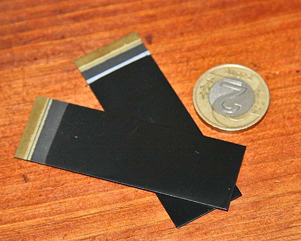

Panels go down below 100Hz with a volume velocity I suppose. Disc bender seems to have higher fundamental resonance. Anyone already used Chladni patterns for n=0,1,2,3... modes to find excitation area? This is a nice violin makers technique and could work as well as FEM simulations. Impedance and capacitance for piezo is high, resulting efficiency rather low. Time to wind tranny.

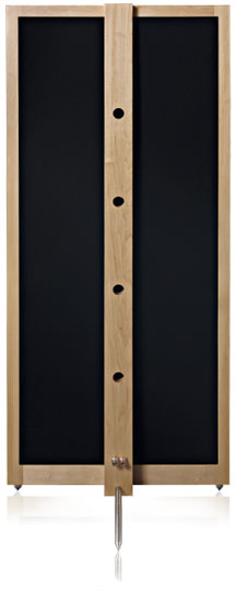

> It all makes sense now when you realise that the PODIUM speakers mount their drivers down the centre line of the panel width. Also noticeable from the photos on 6 moons , and as mentioned before, no one driver is positioned at the EXACT CENTRE of the panel - important?....yes, I think so.
Ziggy , I dont know if you are still on this job
but the picture shows clearly that transducers are exactly on the center line. I have done some tests, only this central position give the maximum bass extension. And if the motors were aligned on the short axe of panel, instead of the long one, this would extend again bass response. (plain 1/4 wave excitation)
