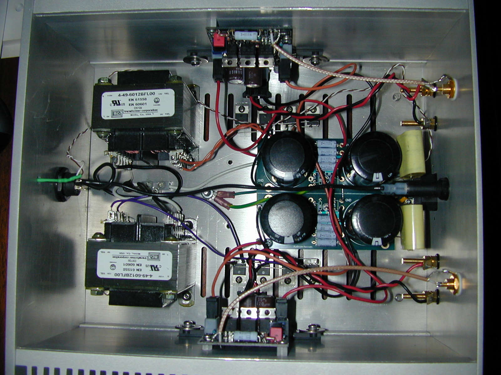

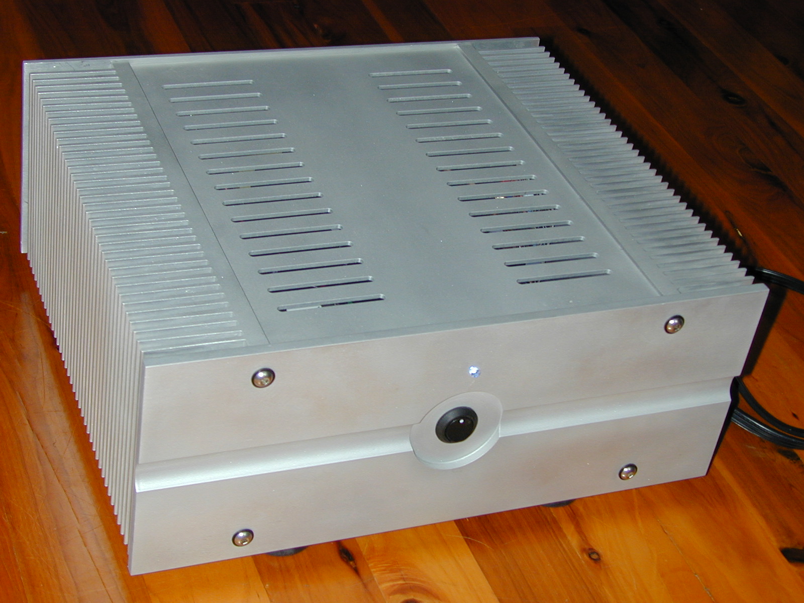

Finished my Mini-A a while ago, BrianGT boards and Peter Daniels PS board. 12V transformers left over from a work project and Antek heat sinks.
Thanks to Zen Mod and others who helped me get this dialed in :)

Thanks! Only took 4 zillion man-hours of milling, drilling, tapping and bead blasting......

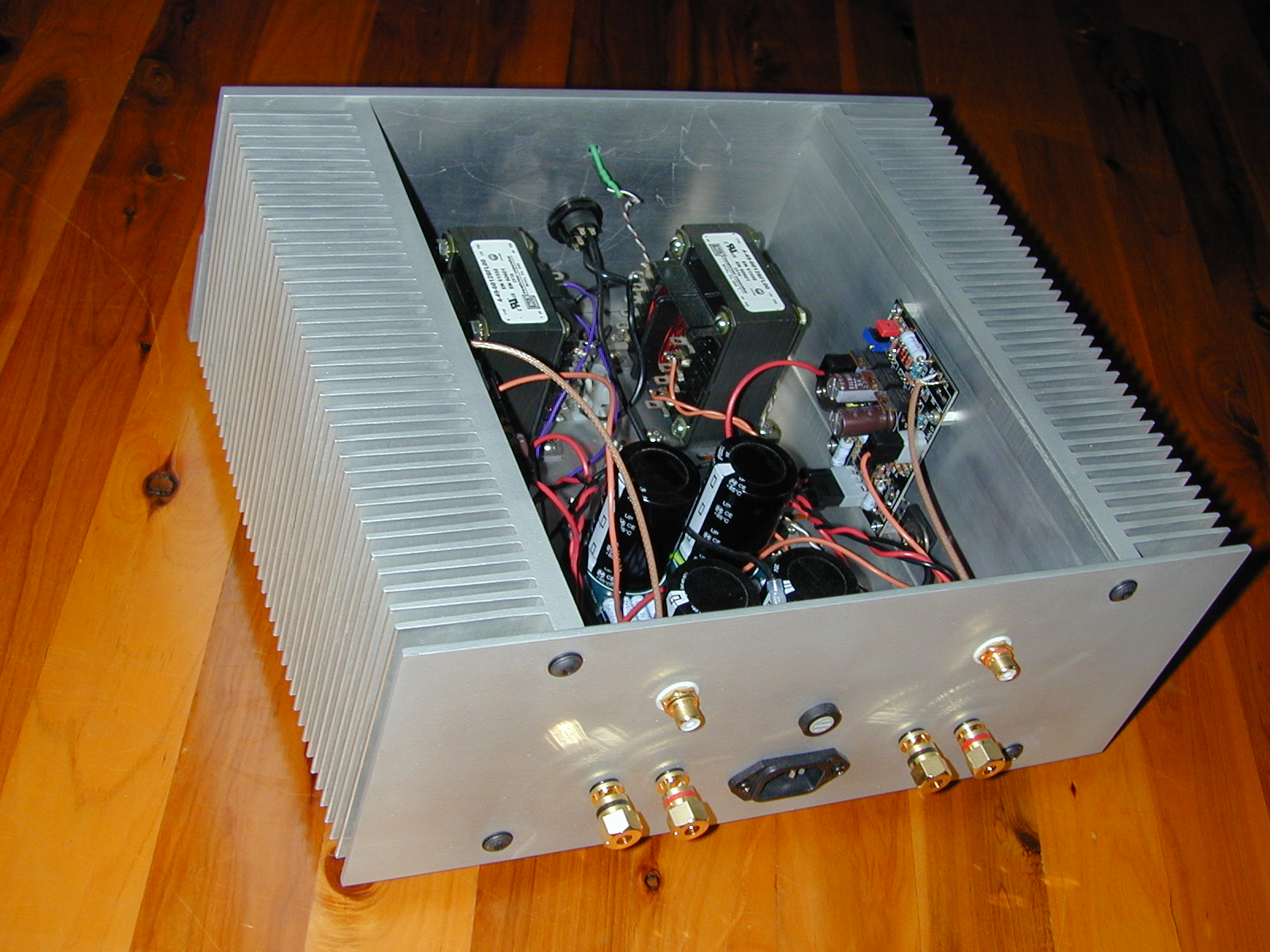

Here's one more pic of the back....
I feel your pain having just gone through all that. Your efforts truly were justified by the results. I really like the strap mounting of the chips - probably the best method. Looks very clean and pro. :up:
.......... Looks very clean and pro. :up:
My comment stands on the general build. I would just add that keeping as many wires as possible close to or on the chassis would also be spiffy. 90 degree turns on the wires surely isn't necessary, but adds a little flash. You've done such a great job with the case and layout, why not go the extra measure? ;)
PS, Isn't that a switch - not a pot by the tranies?

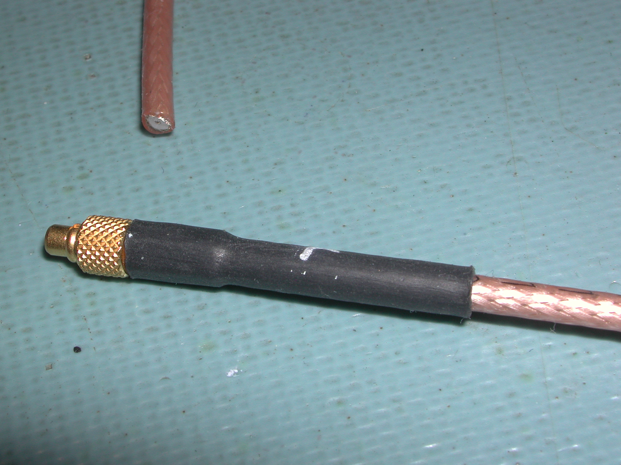

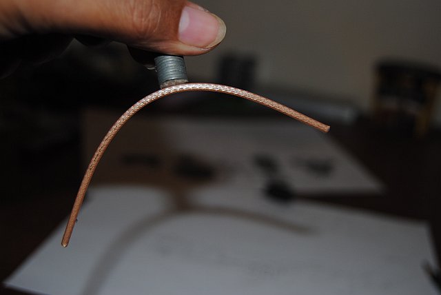

fantastic job !, but I can not help noticing that familiar hookup wire from RCA to PCB, please test it with a magnet, if it's ferrous replace with better/ copper one. Just one my bad experience with that wire
The coax is also left over from a work project......they are 802.11 wireless antenna cables with fancy gold plated SMA connectors. It's kind of a shame to cut these up, but they have been sitting in a box for years. They are non-magnetic tinned copper.
