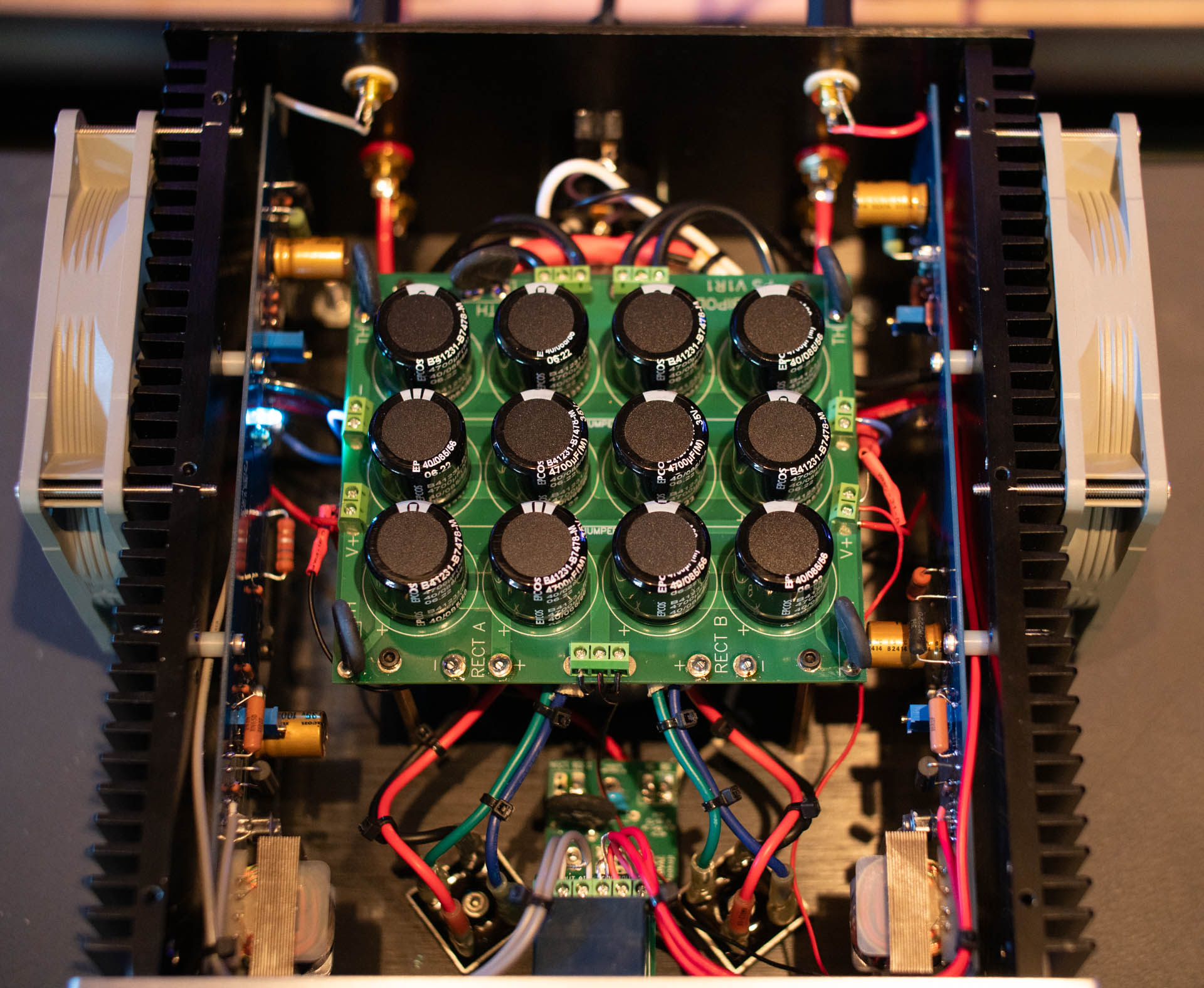

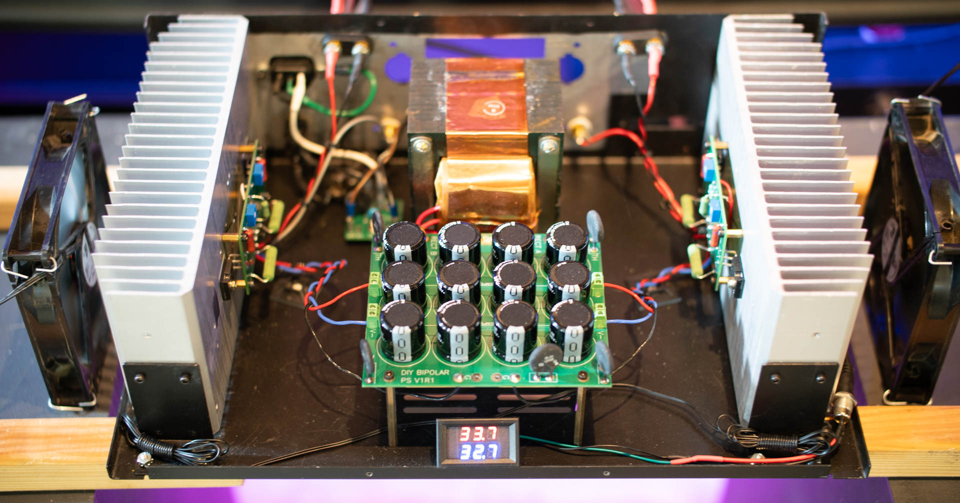

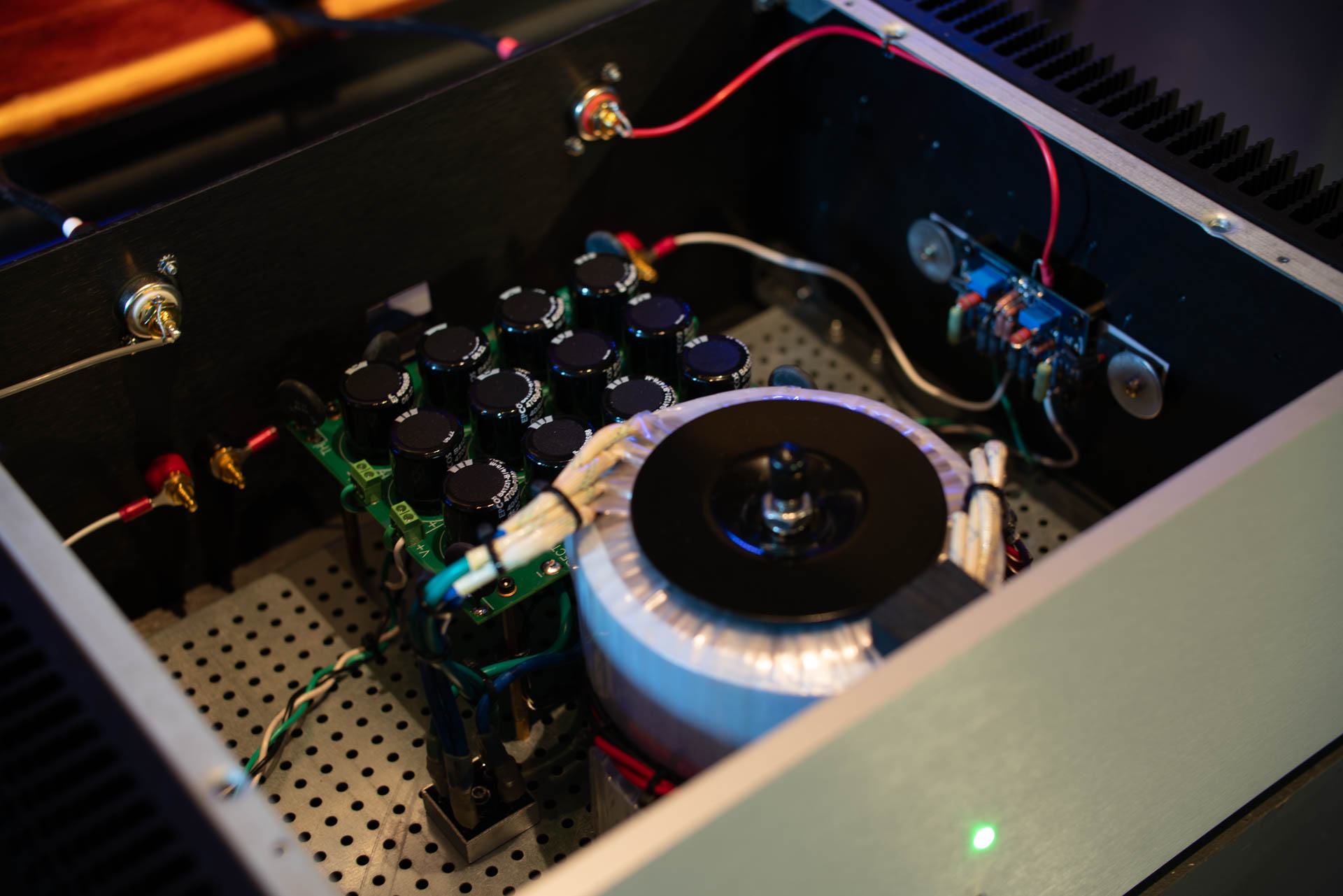

I have these pics in other threads, but they should probably be here, too.
Here's a small chassis F6.
Here's my F5m:
F5 built with Daniels boards.
If you can't tell, I really like the new power supply boards lol
Here's my F5m:

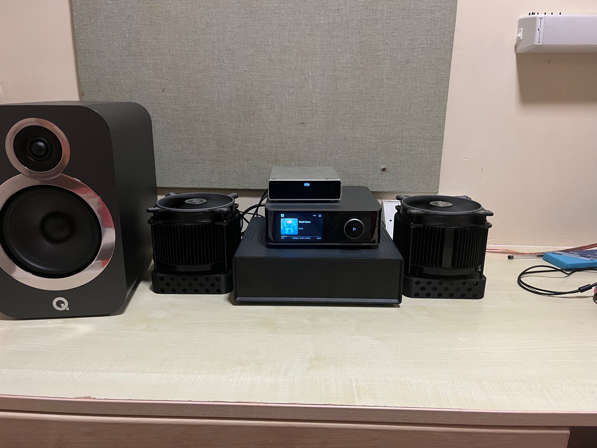

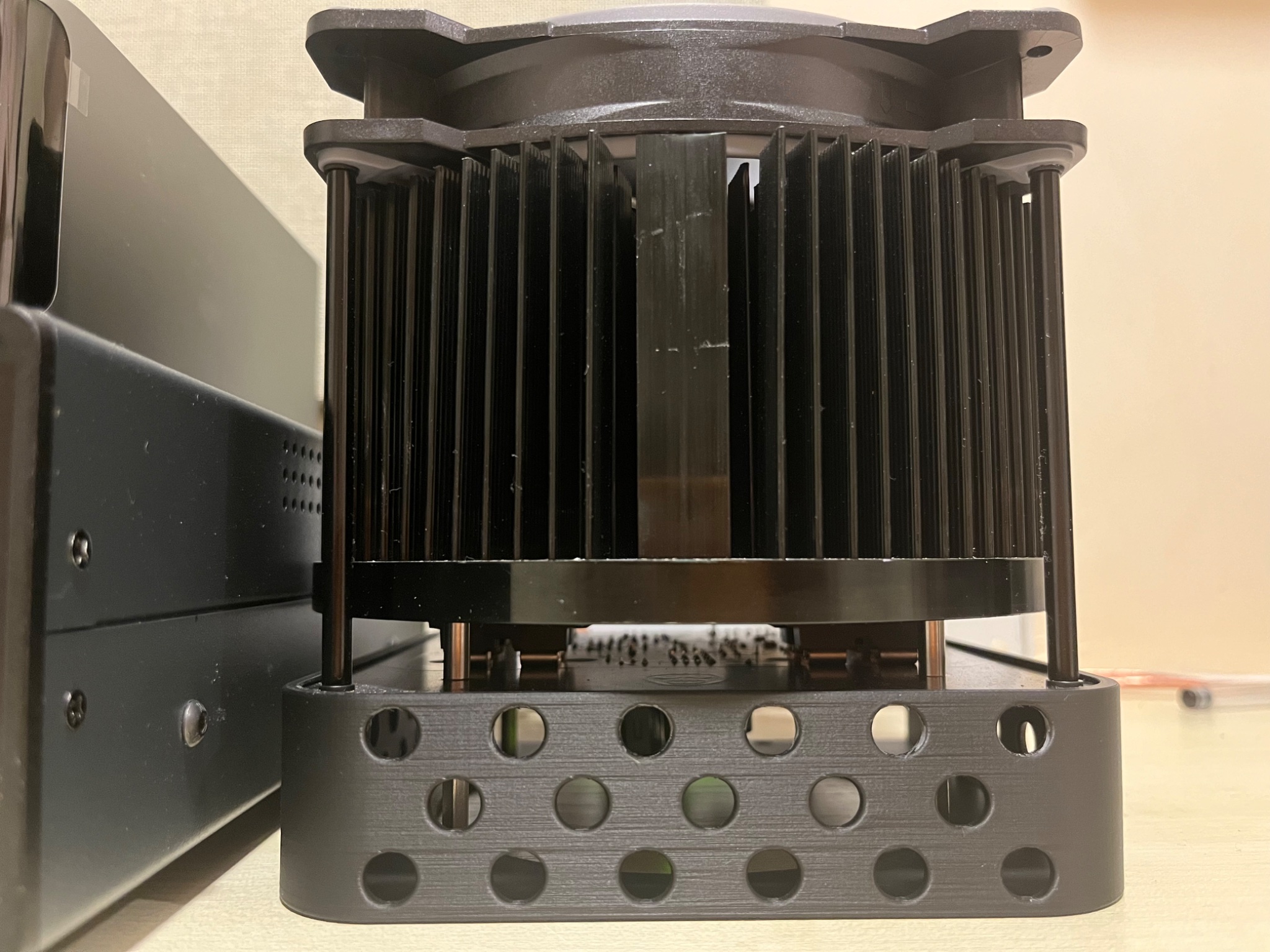

Here are my Holy Grail Follower mono blocks with external power supply (in the middle). They are biased to about 2amps, +-30v and use IXYS hockey pucks. They sound great and the heatsinks with a silent fan only get warm (I used @N Brock’s Redux concept/idea for the heatsink and fan). Totally silent with my ear to the tweeter with a balanced input. This is a great setup for when I am away from home working.

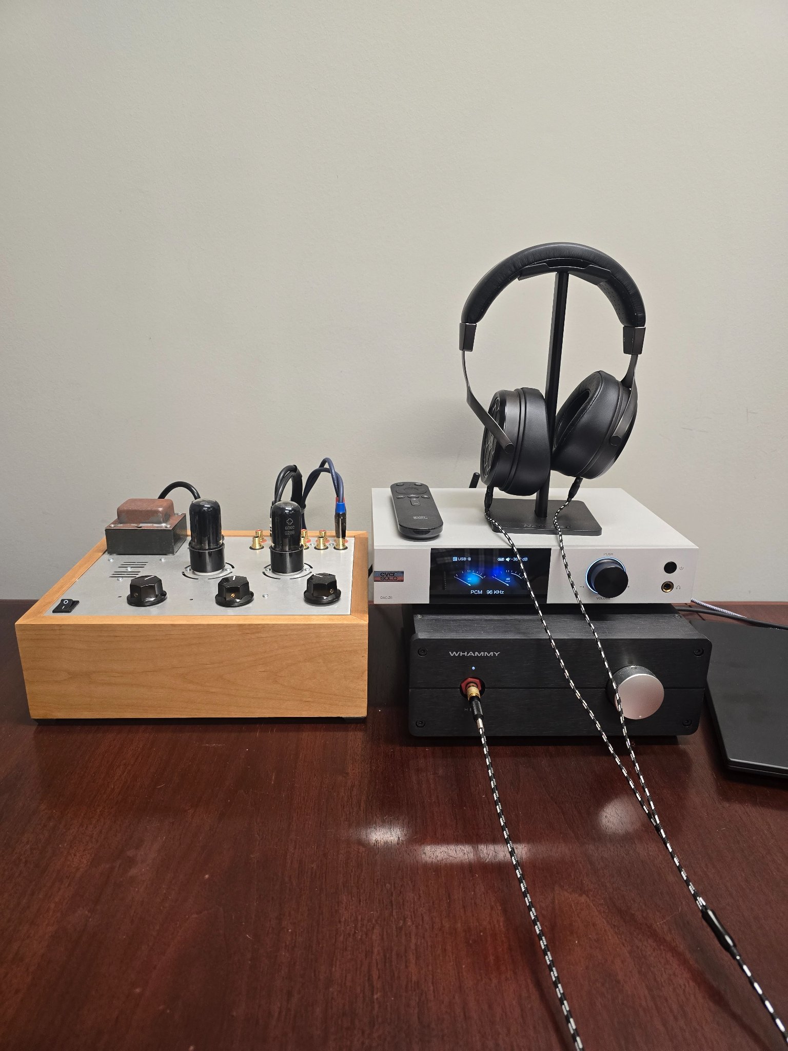

Yeah, it was a fun PTP project. To my ears, it pairs really well with the sound of the Whammy.Love the Moreplay!
The DAC is based on ES9068's. Really happy with that combination for most items.
Weakest link in the chain are the cans. They're ok but saving up for some Arya Stealth planars

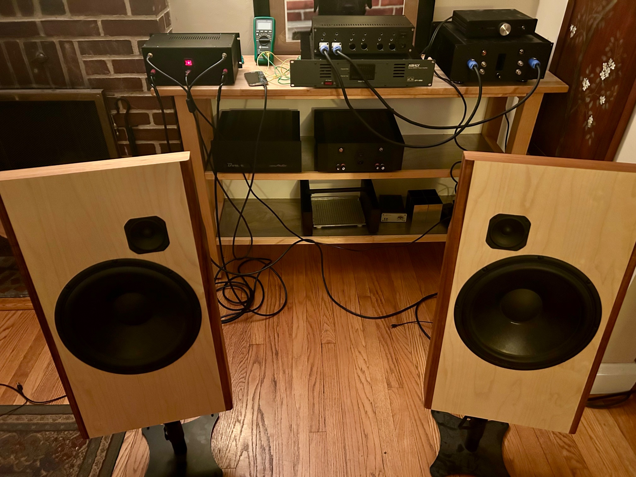

Minor experimentation turned into an amp-swapping extravaganza this evening.
It started with seeing what a multi-parallel LatFet PA amp sounded like with my Manzanitas. Not bad, actually. Gobs of power. Sounded great, truthfully. Then I decided to see what swapping out would do. So, all told, here are the amps I’ve been trading with:
I like all these amps.
Gotta pull out my favorite class D builds to try, too.
What does any of this prove? Nothing! I merely like building amps and playing with them.
Happy weekend, all!
- Ashly CFT-1800
- TDV
- F5 (K1530/J201)
- Modulus-86
Happy weekend, all!

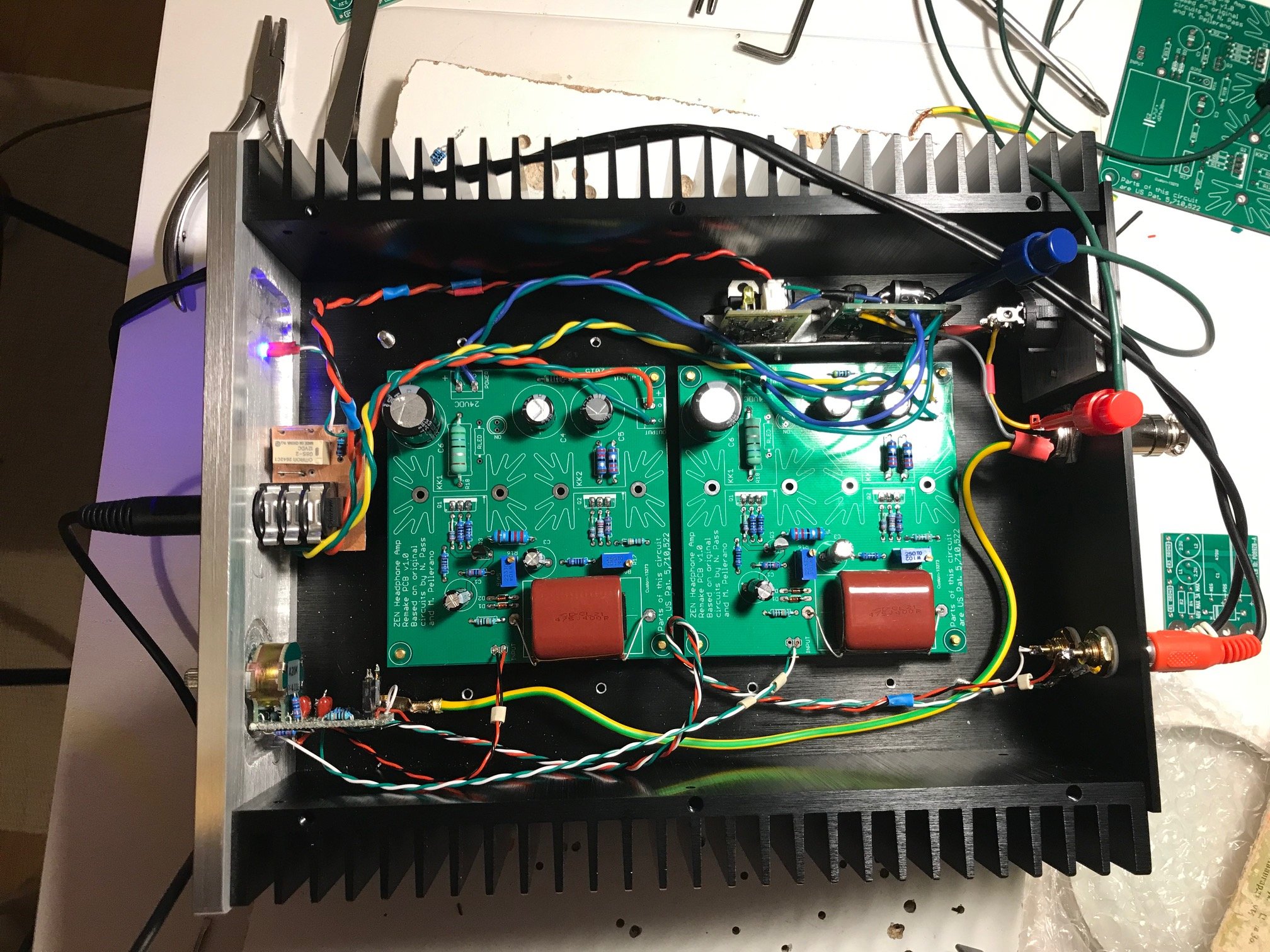

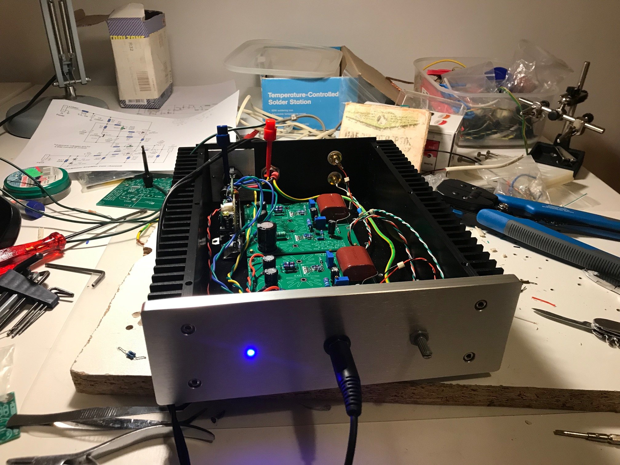

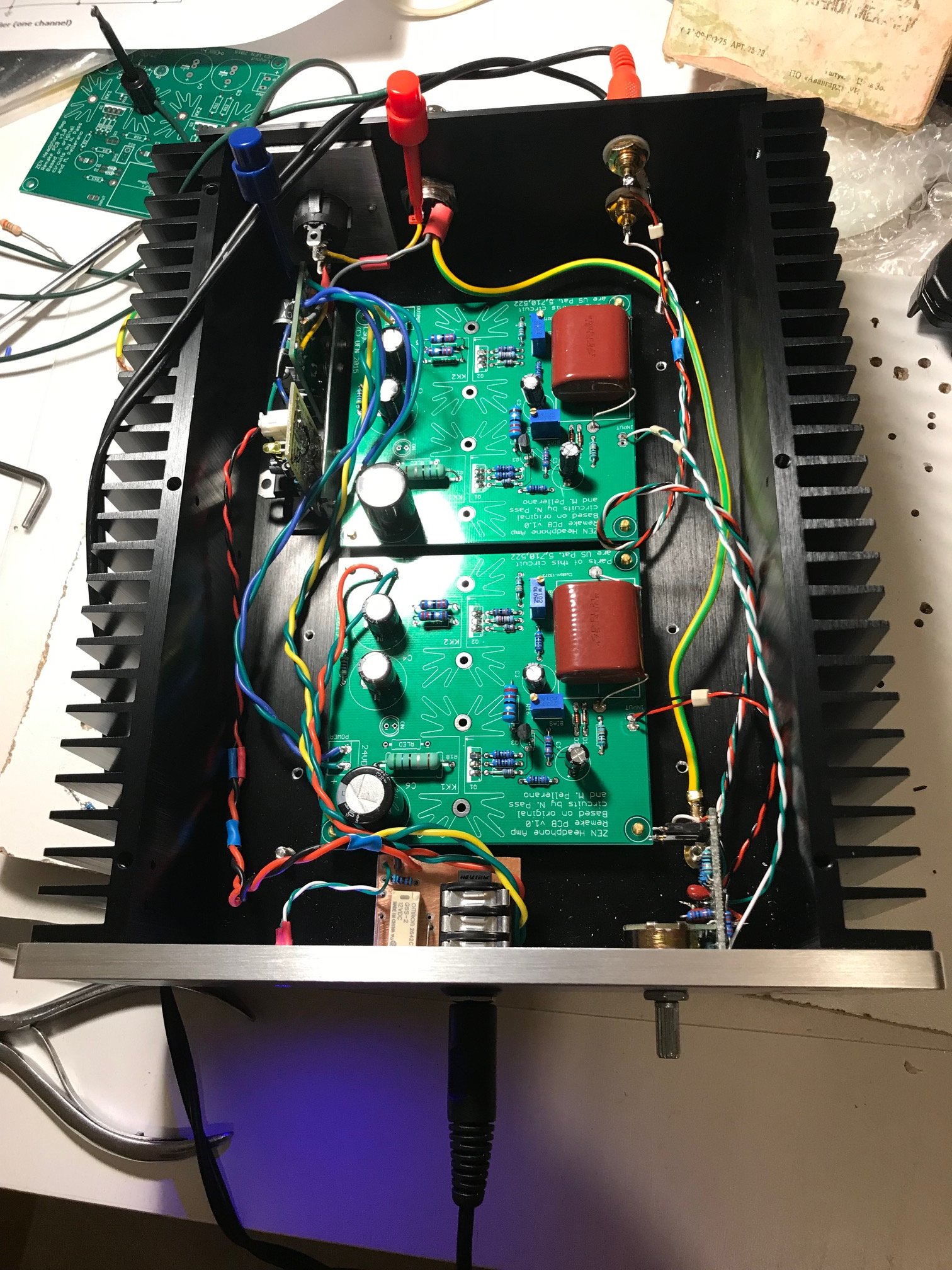

Another Zen headphone (Pellerano/tortello's) amp being born here!
Amp boards from TheSlowDiyer.
I have another Zen Head, but this version one is to be powered by a laptop brick.
The small pcbs at the back are Mark Jonhson SMPS filter, then the power on mute circuit cobbled together using ne555 (rely on the small pcb together with the headphone socket).
The pcb with the pot hosts the cross feed circuit (I do not make a headphone amp without these days).
I was going to finish it today ie sort out the cables and solder the power socket to the laptop brick but I got sucked into a prolonged listening session with the assembled amps running on a lab power supply.
I have another version of this amp (with a linear PS), Whammy, EUVLs Super Linear and UTiHAM (Patrick's amps were not easy to build). The assembly of this one is easy and therapeutic. I can spend hours with this one. This little ZEN is soooo musical!!!
Nice, I think that's the same chassis I just built an F6 in for a buddy.Another Zen headphone (Pellerano/tortello's) amp being born here!
Edit: Very close, I think that chassis is a little shorter, but same footprint.
F6 box must be MUCH larger?
BTW the above amp is also for a friend. But I think I'll build one for myself too to replace my shabby build of my first head amp ever. Initially the idea of building for a friend was to build something without cluttering the house.
I might be losing my mind with an optical illusion, but it looks like the same chassis, just this one is the taller version.

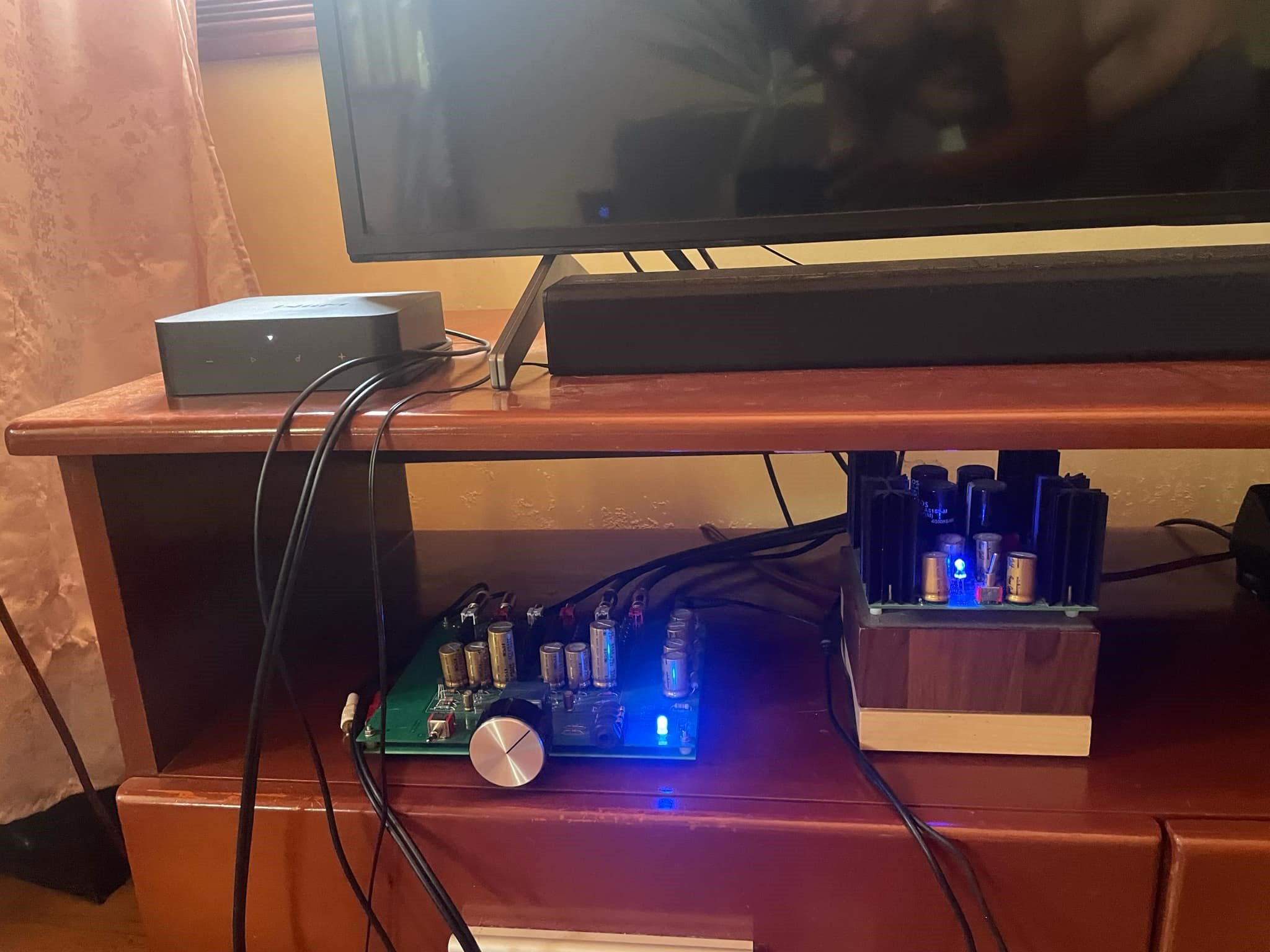

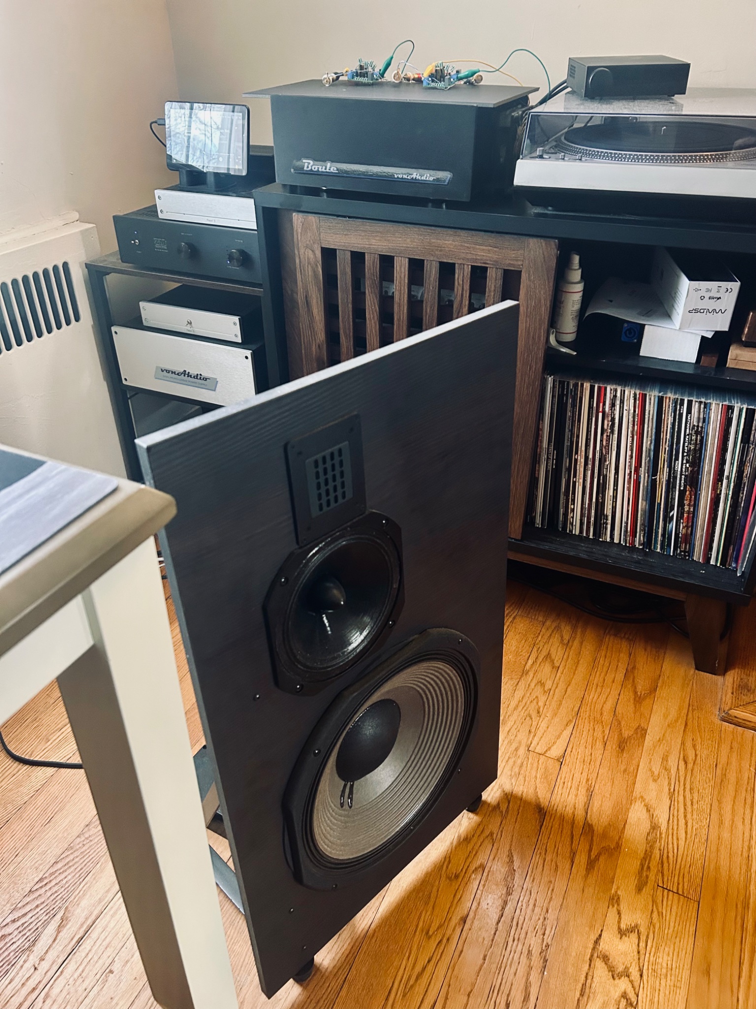

My FE2022 adventures are live in the main system. Sounding VERY good. This is a nice pairing (BooLu OS and FE2022-with-K209-Mohawk). I will certainly put these boards in the chassis permanently.
Happy building and listening, all!

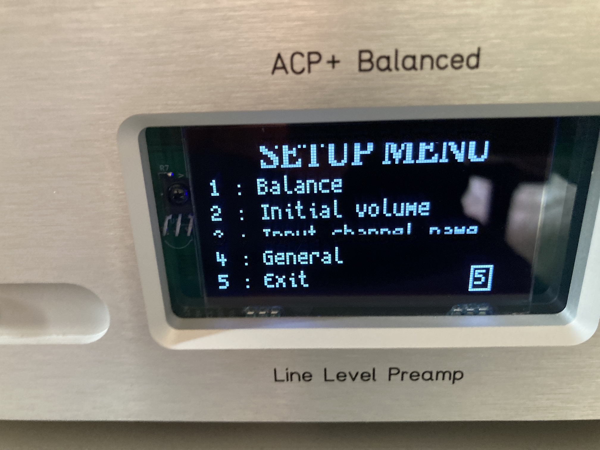

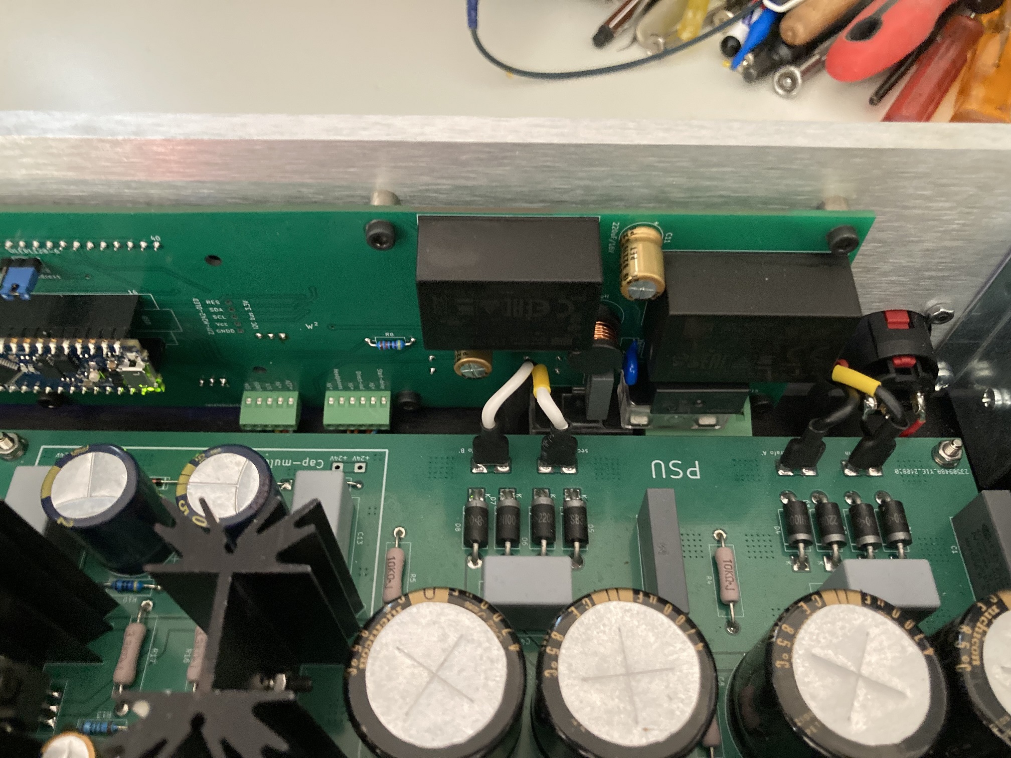

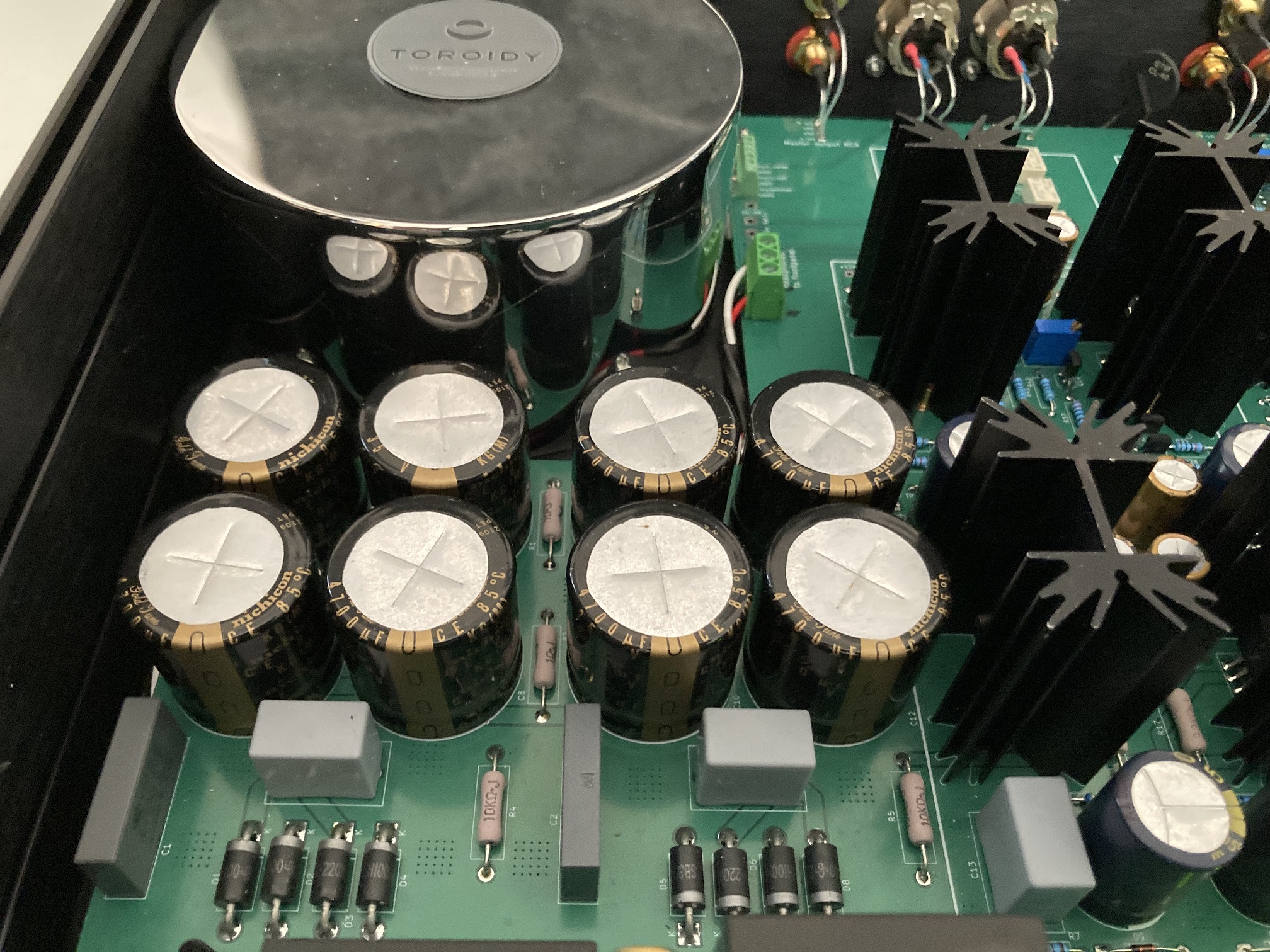

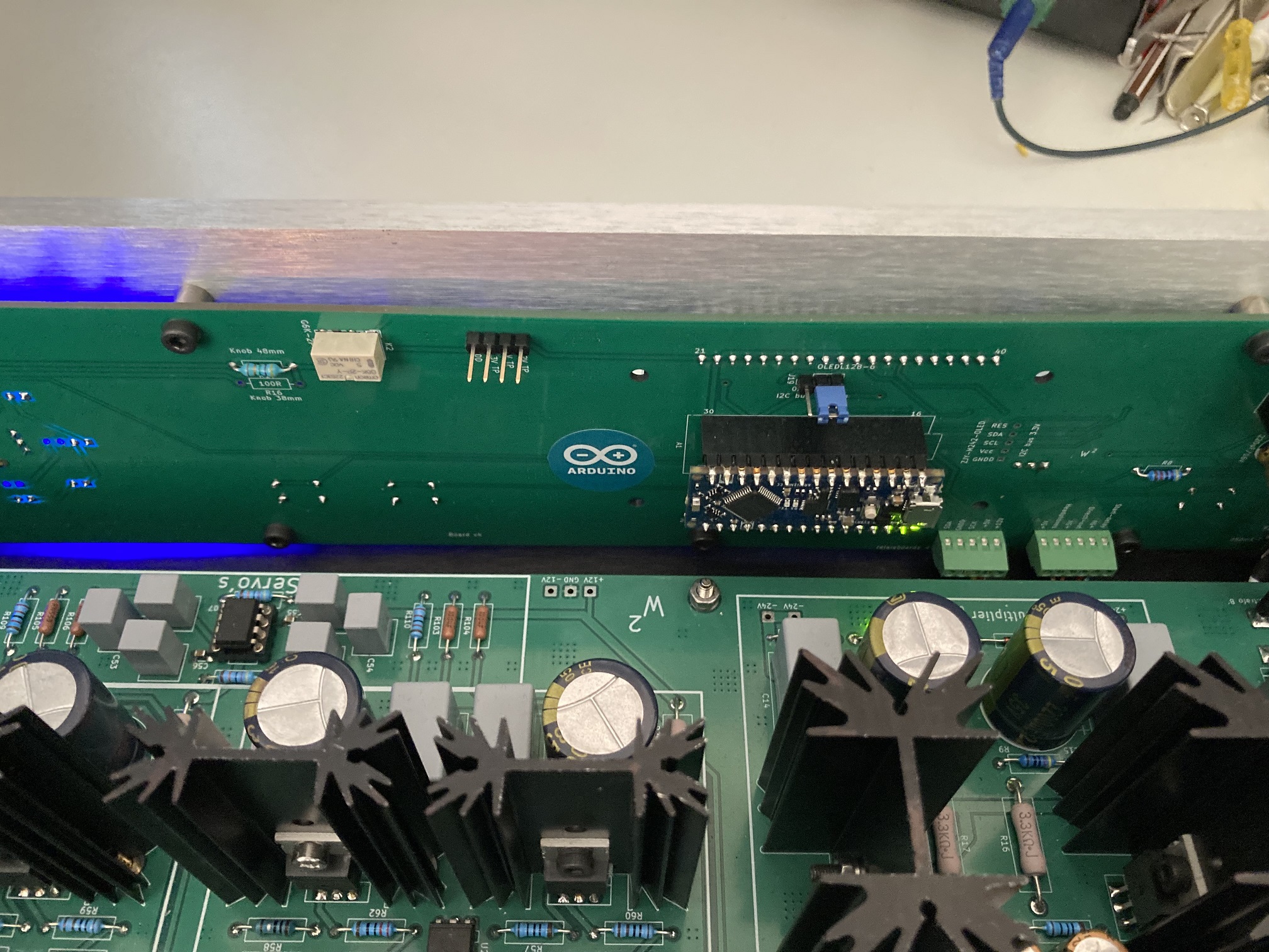

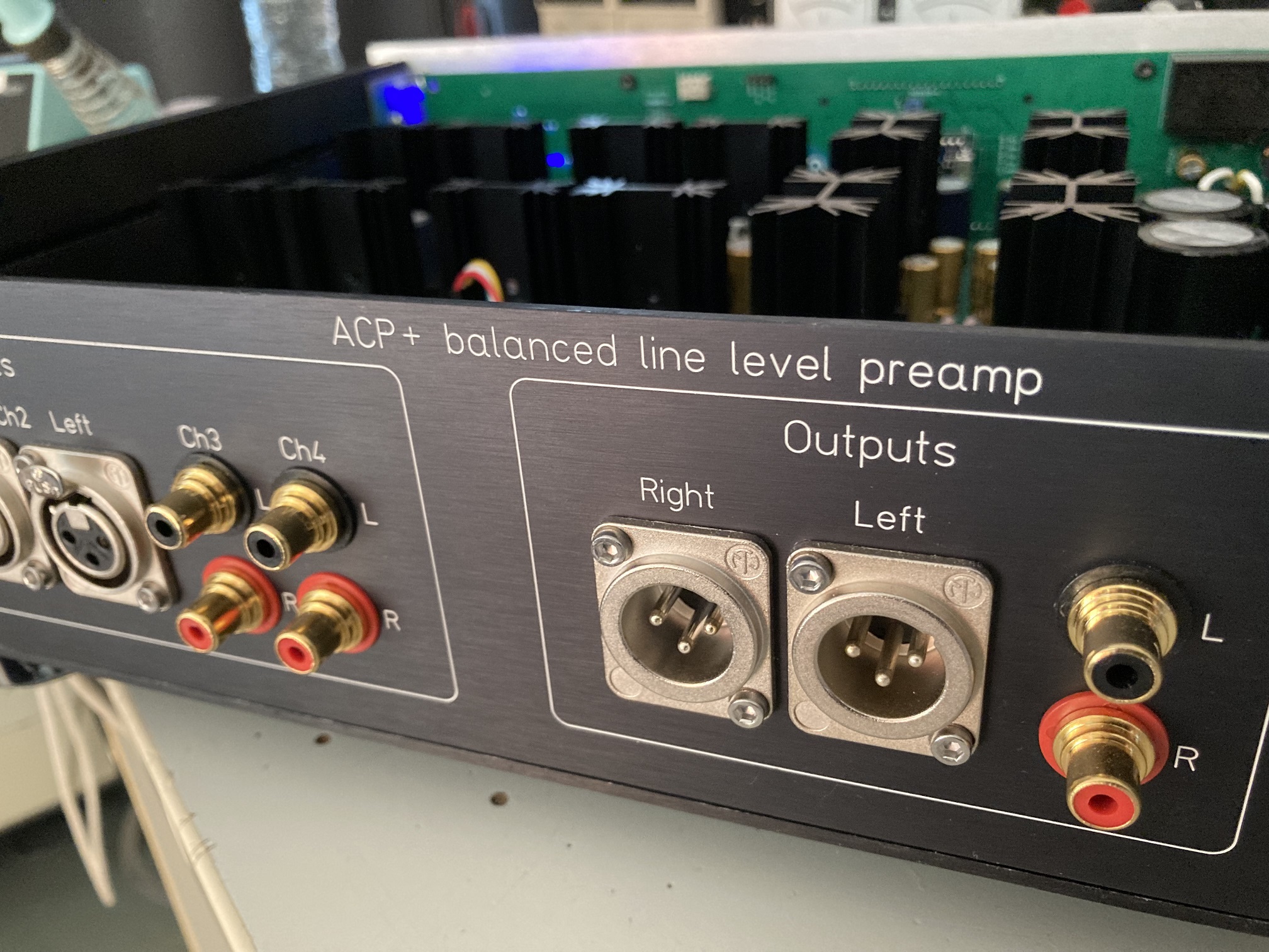

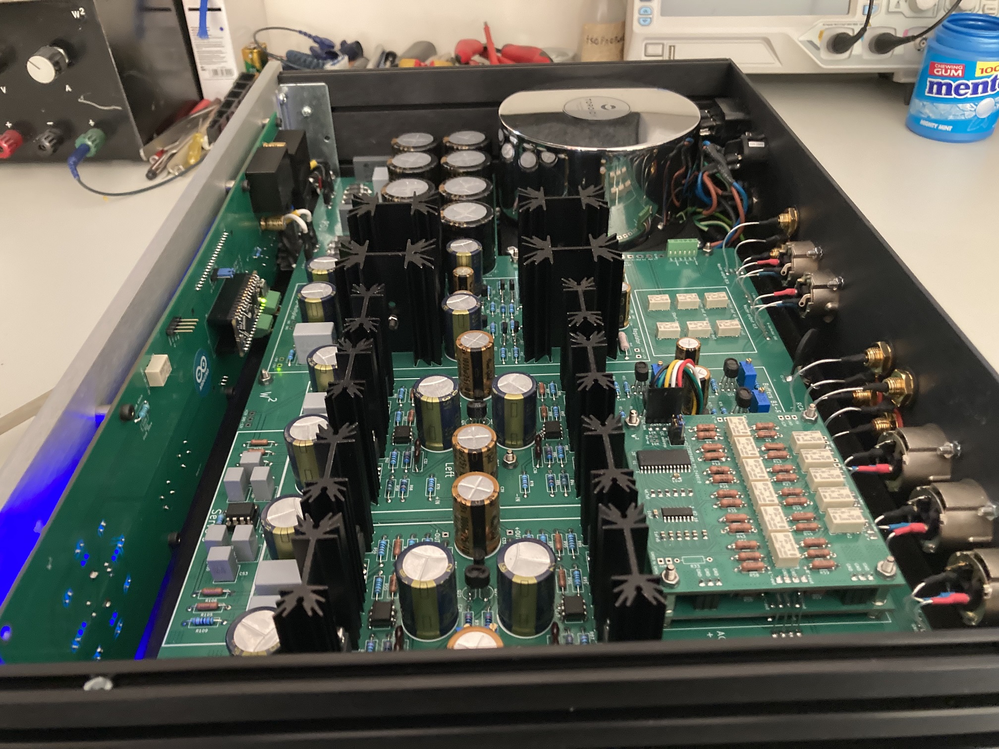

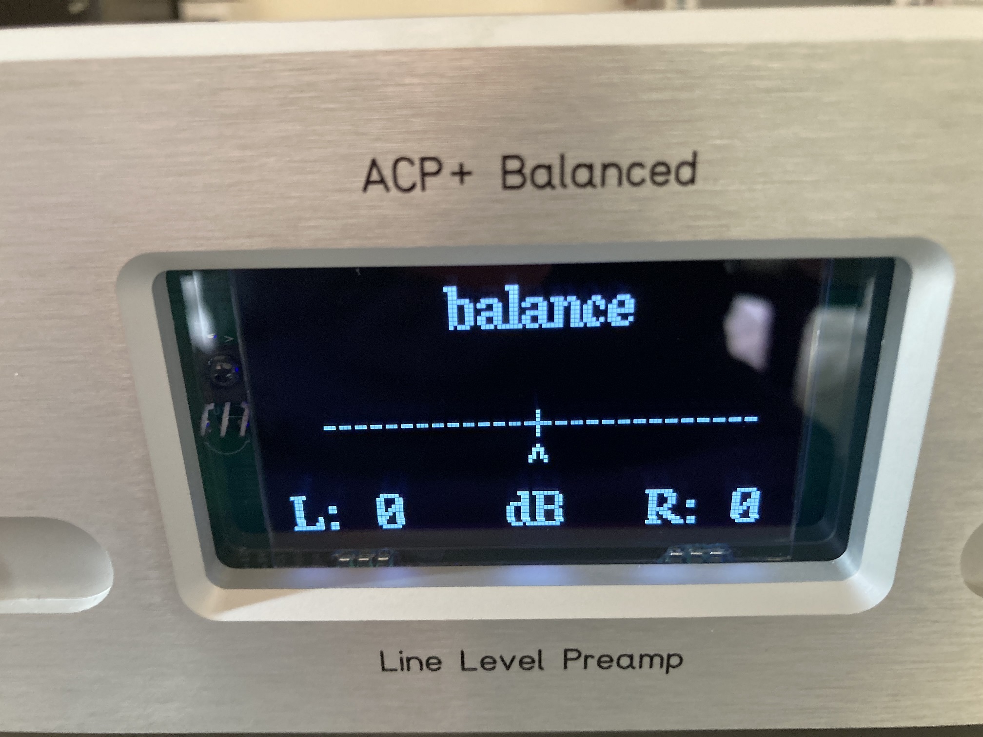

Finished my Balanced ACP+.
Pictures and description are her: https://www.diyaudio.com/community/threads/amp-camp-pre-headphone-amp-acp.344836/post-7858345
And below the last pictures.
Thanks Modushop for the Artwork 👍
