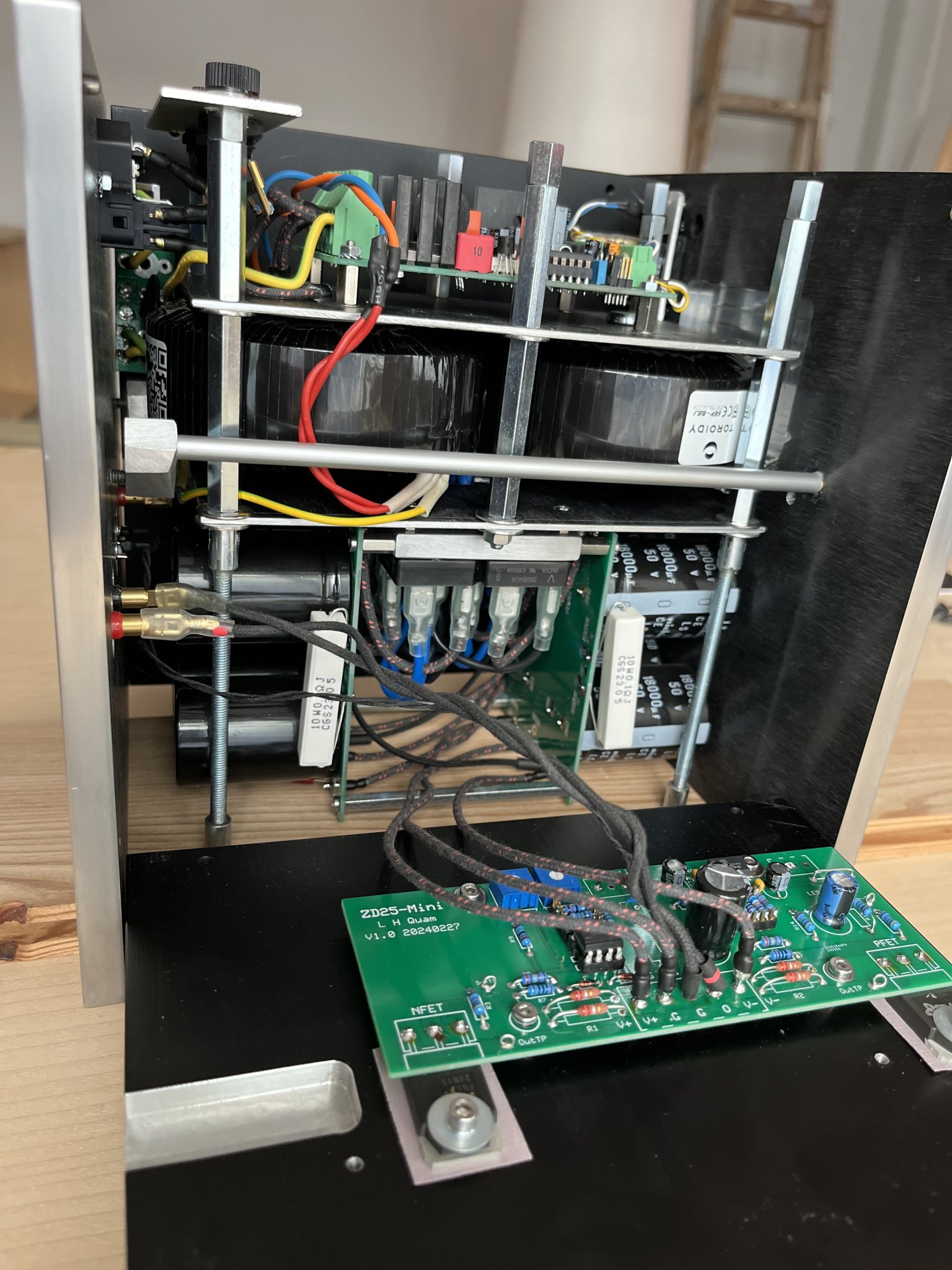

Speaking of procedure, and space…

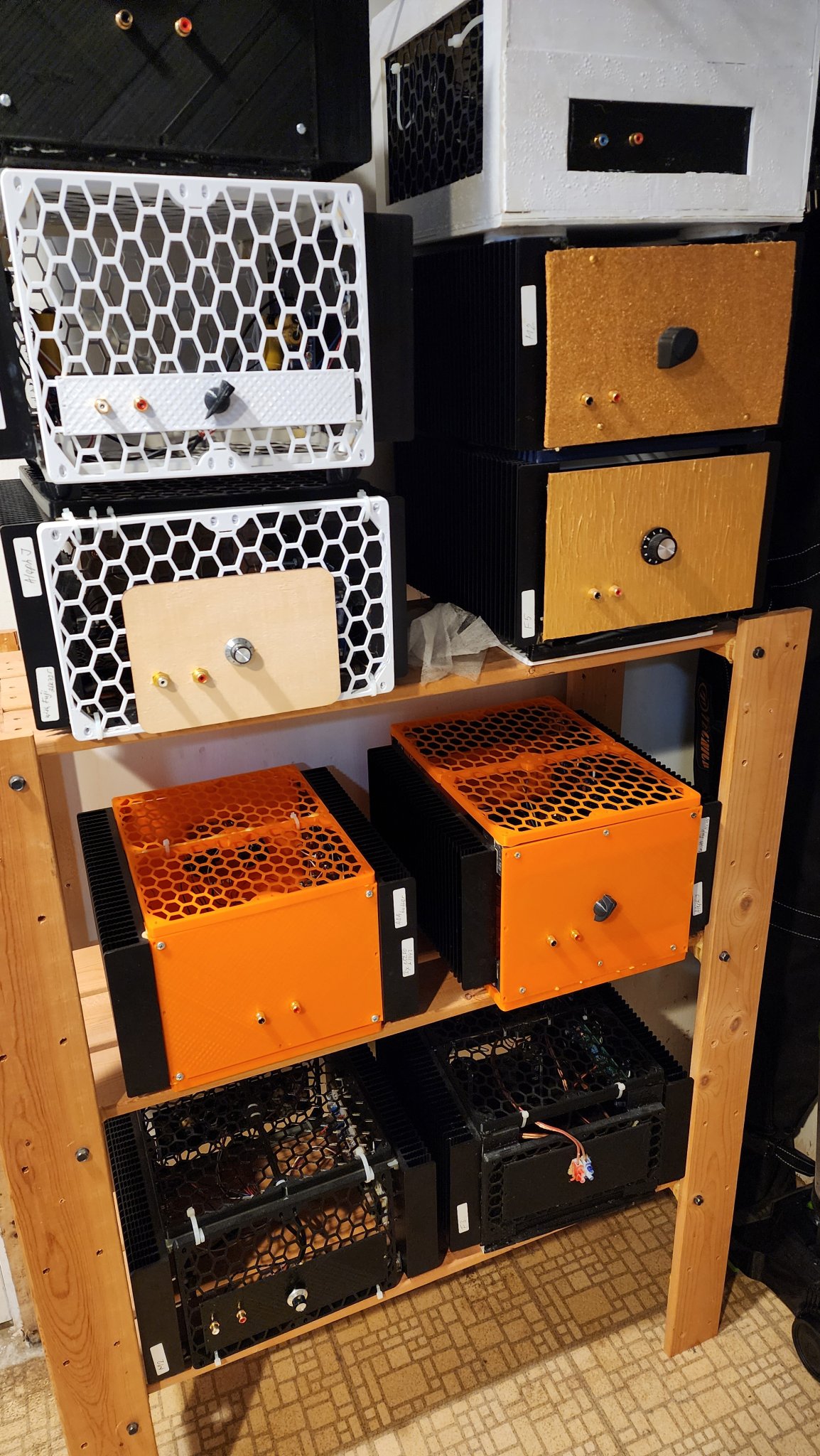

Some First Watt amplifiers sans their power supplies patiently waiting their turn in circulation.
Impressive collection!
They're Audio-grade. No Idea how they'd compare to Sedlbauer or Talema. But all 3 have a good reputation.
They're in the second floor for space-issues, as the IEX and front-switch couldn't to be sitting "somewhere in the plates". Below, at the 1st./ground-floor is Mark's, uhm, H9KPXG "softstart".
(Yes, the amp is reversed on the desk, the cap-bank is on the top, toroids in the middle, 230V-stuff at the bottom, so the H9KPXG is mounted feets-up...)
Reactions: NE WAY

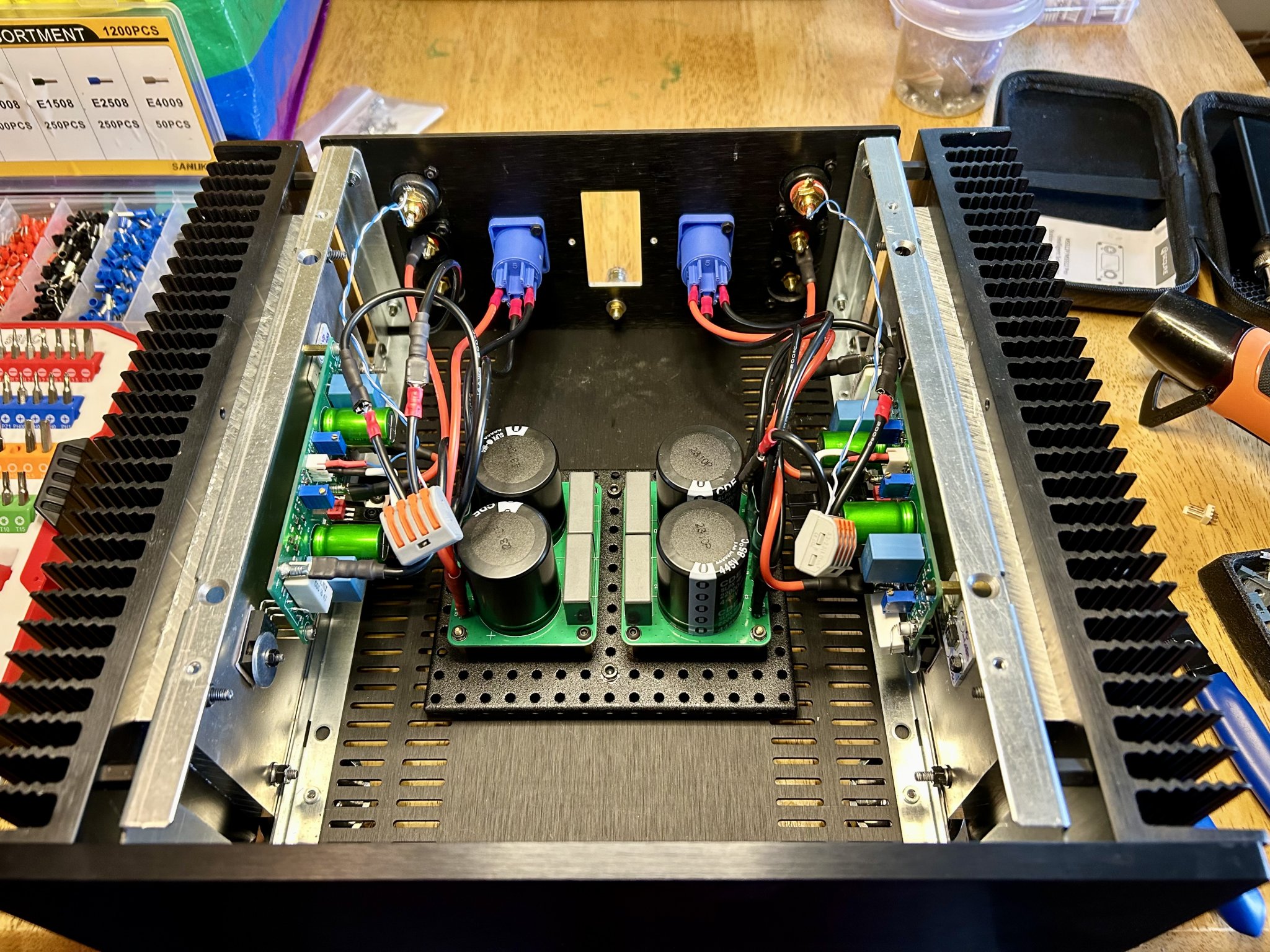

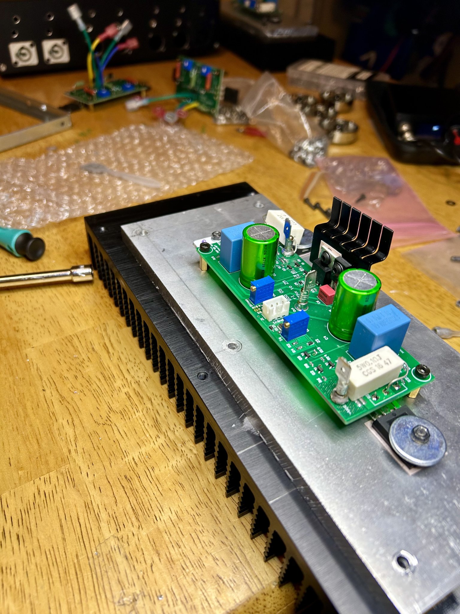

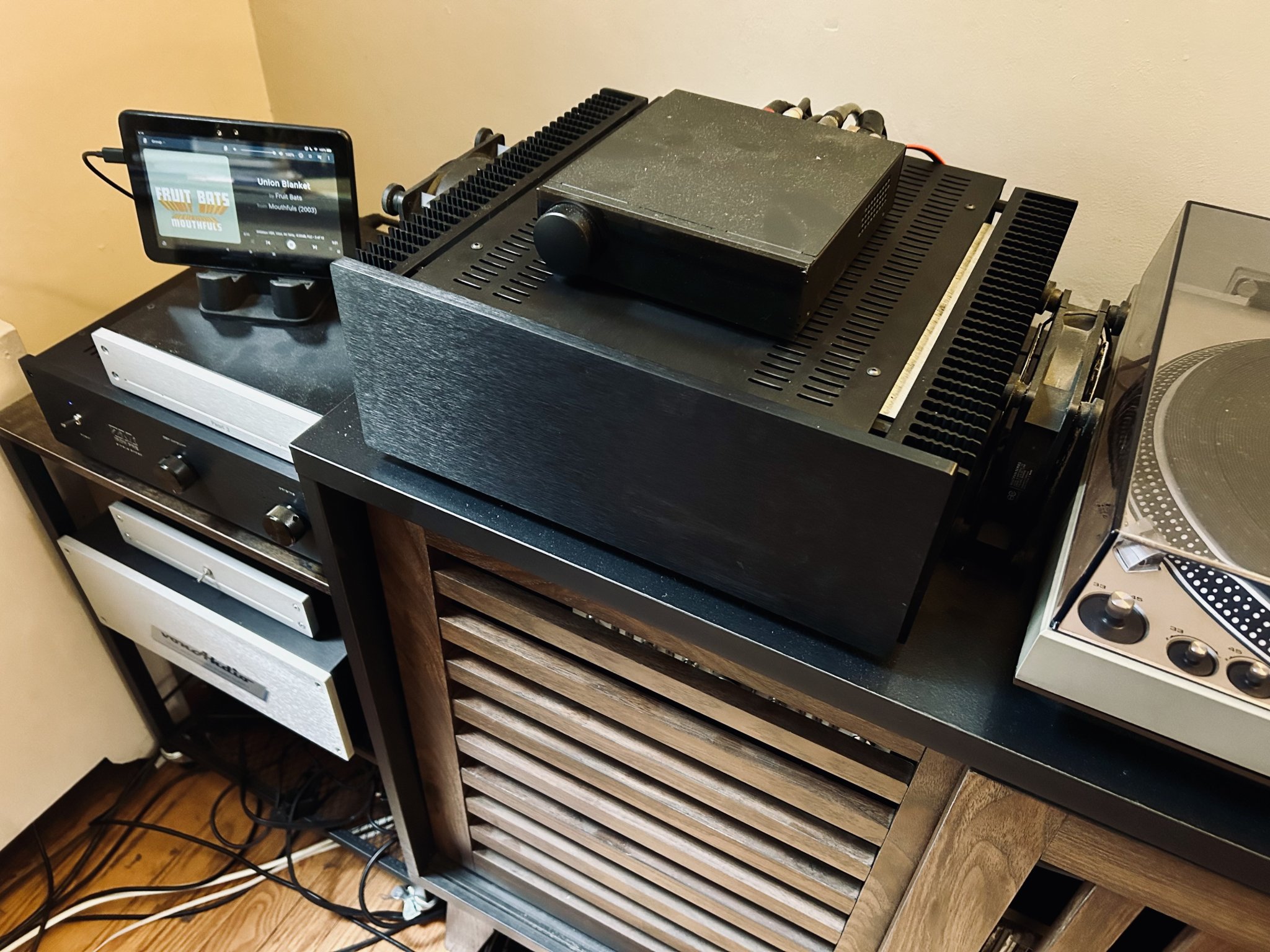

Newest heater in the stable. @schultzsch’s Boo OS with LUs. :yes:
This one was a long time coming. Very generous transcontinental work and support from Romania.
It took me so long to get this done that Gianluca changed the heatsink rails at Modushop in the time since I started with this amp. My heat spreaders no longer fit, so I improvised with spacers. The chassis is now is a Tie-Fighter. :clown:
I have barely enough gain with my Iron Pre to get this to normal listening level, so some gain structuring is in order. However, for now, it sounds sublime. Quick assessment is it sounds like it’s between my K1530/J201 F5 and my Scryer. VERY respectable company. I think my favorite amps list now has three entries. :Popworm:
Thanks again, @schultzsch !
