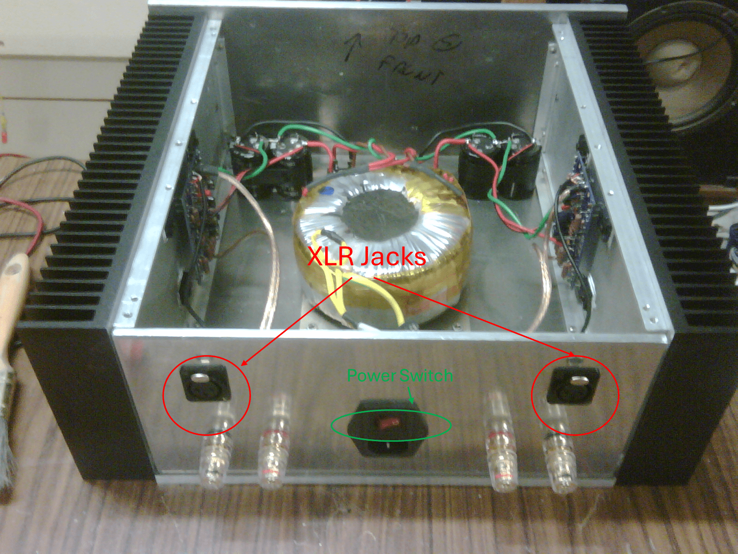

F4 crammed into a 4U mini-Dissipante chassis from Modushop. I think many DIYers use the full-size Dissipante because it is easier to work with. This takes some extensions, a universal joint, contortions and occasional cussing to get it apart and back together.
Next step is to do what @von Ah did, make a separate power supply chassis but been busy with a new house and other audio projects.

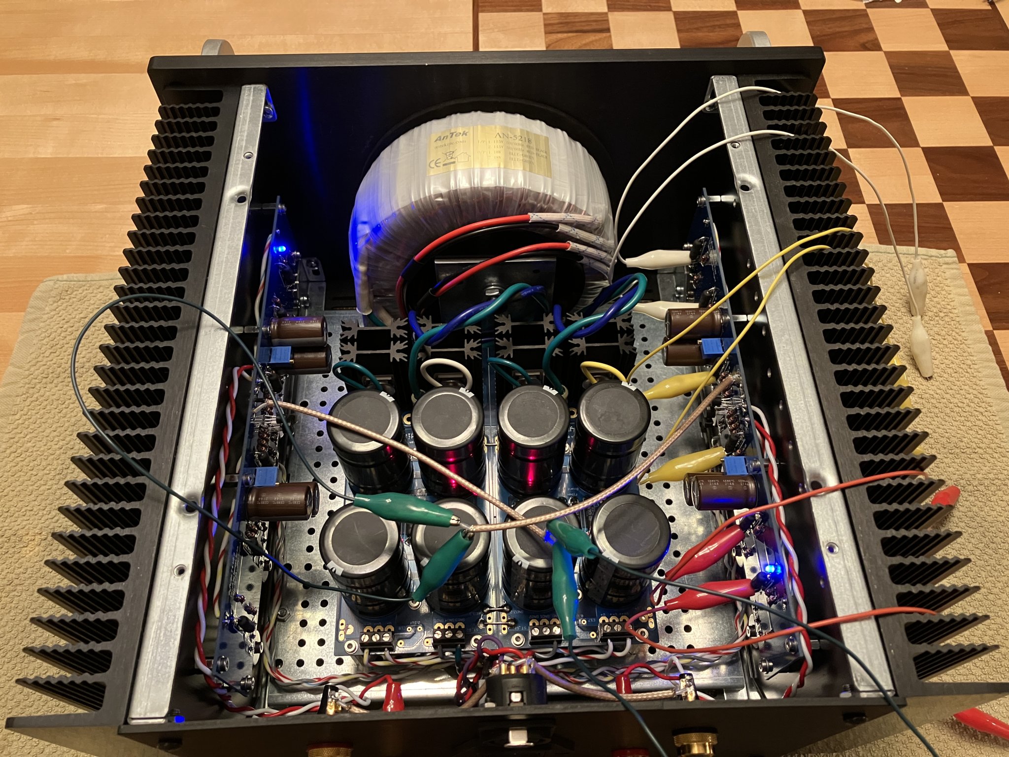

I found an external PSU always delivers in regard to space and easy access.
In fact all my projects with the exception of one tube pre-amp have an external PSU.
Even my Technics turntables get an external PSU as a matter of course.
Obviously that means more plugs, sockets and cables but I think, at least for me, it's the better and easier approach.
Reactions: audiosteve and 6sX7
I am definitely going to have an external PSU, a hefty one, so that it can be reused with other amplifiers, without having to reinvest in another PSU.
But that leaves even more empty space in the casing, when the amplifiers call for humongous heatsink.
I have been doing external powers supplies for years. Most of the Mr. Nelson amps share the same power supply.
Are you using the same voltage for all the amps?
I am in the process of ordering my transformers, started with wanting one with 24X2 + 12X2, same current rating for all four, so that I could use either 12V, 24V and 36V.
But when I analysed it, it doesn’t appear to be as cost effective as I think, for:
1) the full transformer rating will only be utilised when I use 36V x 2, when I use 12 and 24 I will only be using 1/3 or 2/3 of the rating, so if I want 600VA for 24V, I will have to spec 900VA for the transformers ==> defeating the purpose of cost savings;
2) transformers with multiple voltages output will have to be made to order, which is actually quite costly, sometimes it may be cheaper to buy another transformer.
My other alternative is to have transformer with output of 48Vx 2, I could connect the 48V in parallel, and with floating earth method I get about +- 32Vdc, or connect that 48V in series and get 64Vdc.
Do you have a cost effective way of having multiple voltages to play with different amp at different time? Without having to resort to a Variac? Which is another costly thing to pay for.

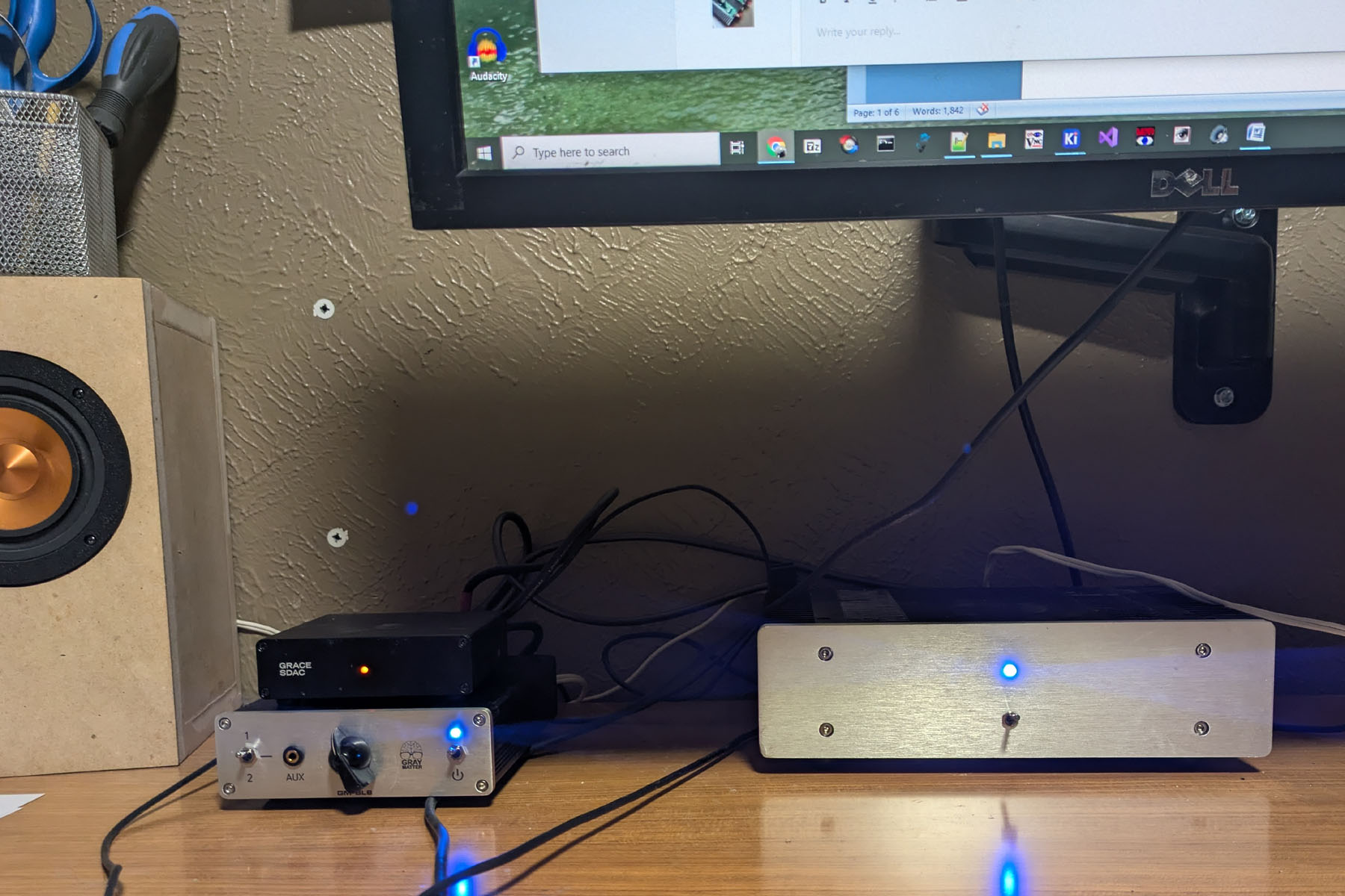

This is the current;y assembled office rig.I had to share it. I still need to put up shelves and things but the sound is putting a big smile on my face as is. The pre with tyhe chicken head knob is a B1R2 with PS, gain stage , 3 source relay selector and power on timed output relay. The DAC is a Grace audio SDAC to be replaced at some point by Miro's NOS DAC. But its is really good! The power Amp is an ACA Mini but reconfigured with new boards to fit in a smaller normal looking power amp chassis. The speakers are Mark Audio CH-70's sealed. I'm listening to Night Train by Oscar Peterson right now. The sound is so very, very good. Thanks for all the great stuff @Nelson Pass !
