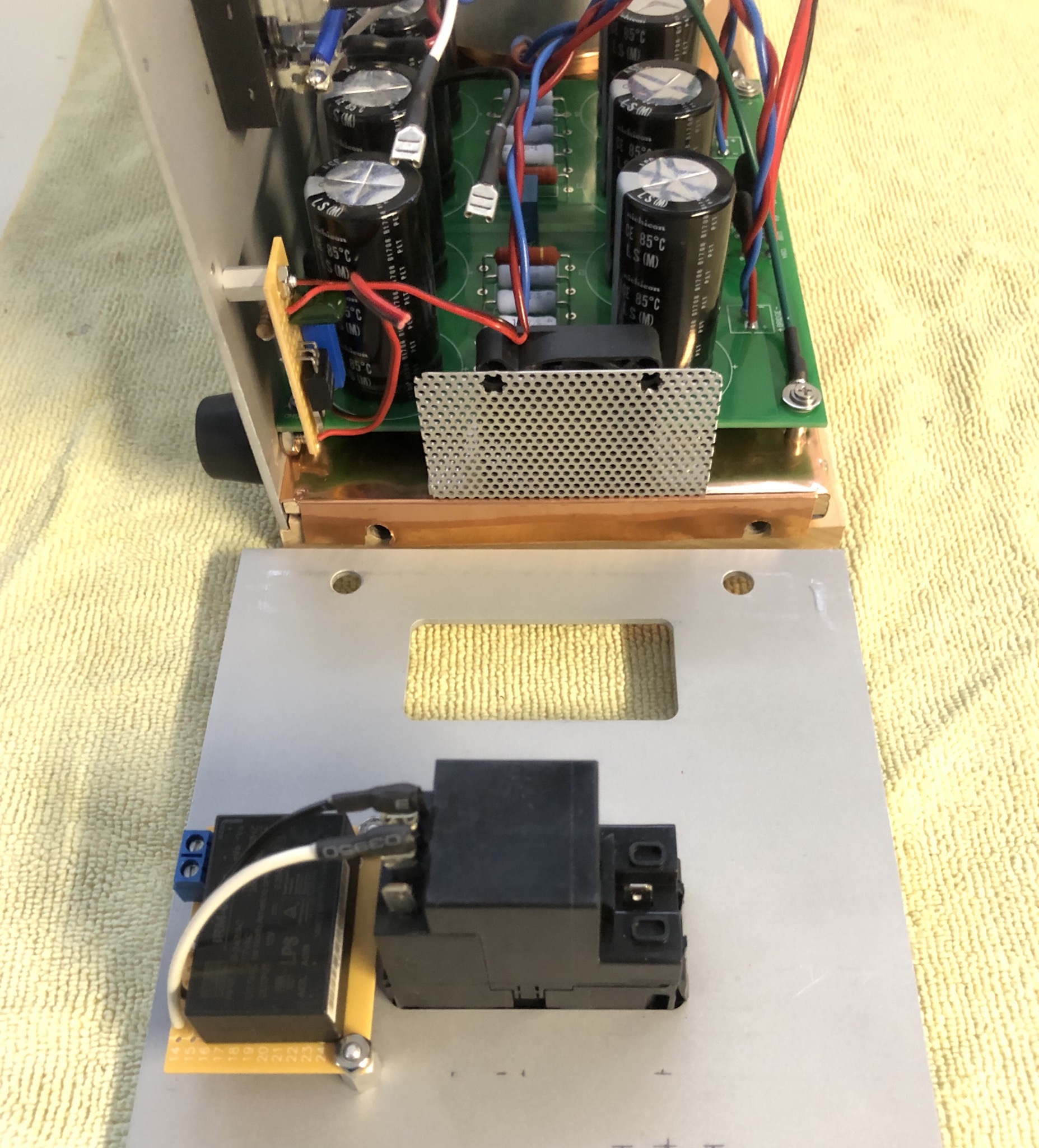

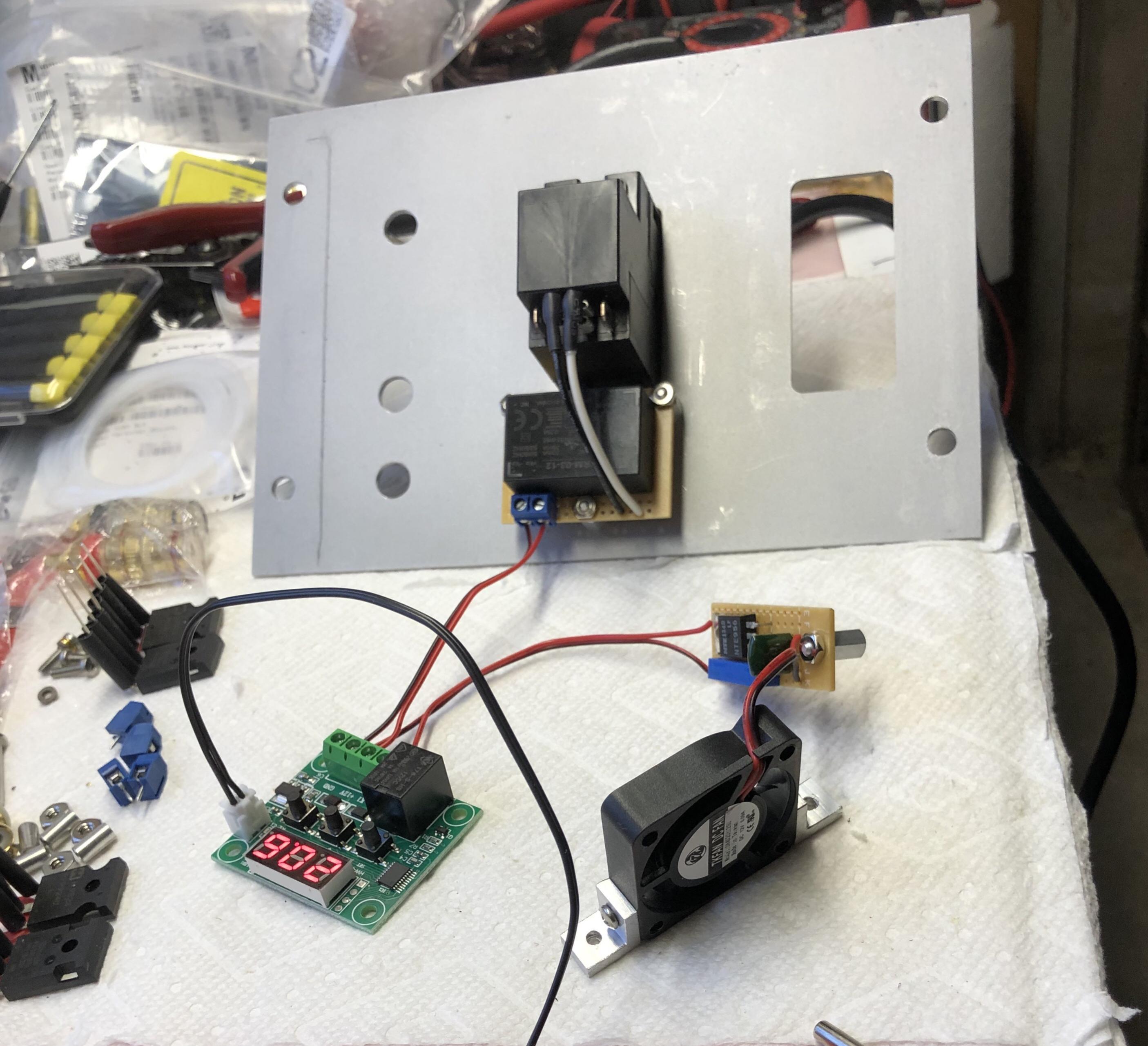

I also found those digital thermostatic controls on eBay. I was concerned with heat build up in my fairly compact F2J monoblock build and had decided to incorporate some small 12V cooling fans in the back of the cases to be safe.
The ones I got did work. I decided against using them because, even though I had already built and installed a seperate power supply and voltage regulator for my fans, I did not know what effect the switching relay might have on my listening experience if it was cycling on and off.
I had already milled some holes through my top mounted heat sinks and the case bottom. I also added some small screws that elevated the heat sinks (like Zen mentioned) to allow for better breathing.
My amps do not heat up much past 140 degrees F internally or externally. In terms of Papa’s 5 second rule for bare hands on the heatsink that is pretty much right on the money.

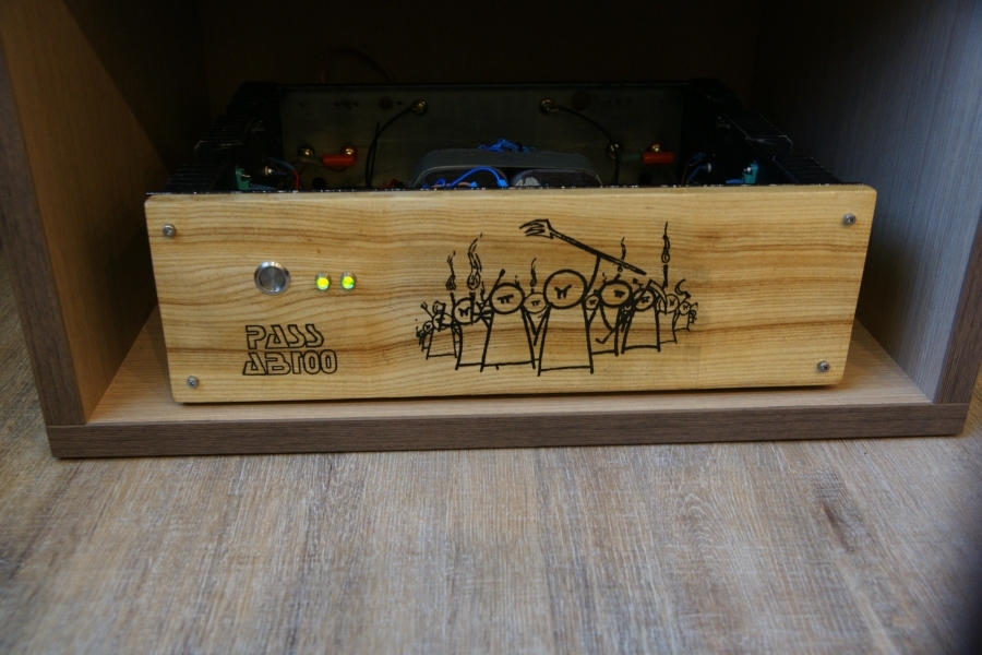

If you know someone with wood burning skills, that could be very cool.

I never even thought of this, good one man. This is why a forum is such an important part of diy. I might just buy a small 60mm fan at work and let it run permanently, maybe through a 7809 regulator, so that it aint that fast and loud
Maybe I can pull out my old soldering iron and try it myself. On a spare piece of wood first. Light pencil markings first, and then let it burn

you can try the "iron" method usally used to transfer PCB tracks, just get right a mirror image of the letters, as I "did" ... then cover everything with varnish.

I think I already said Fugly! for that one
Absolutely love this one!

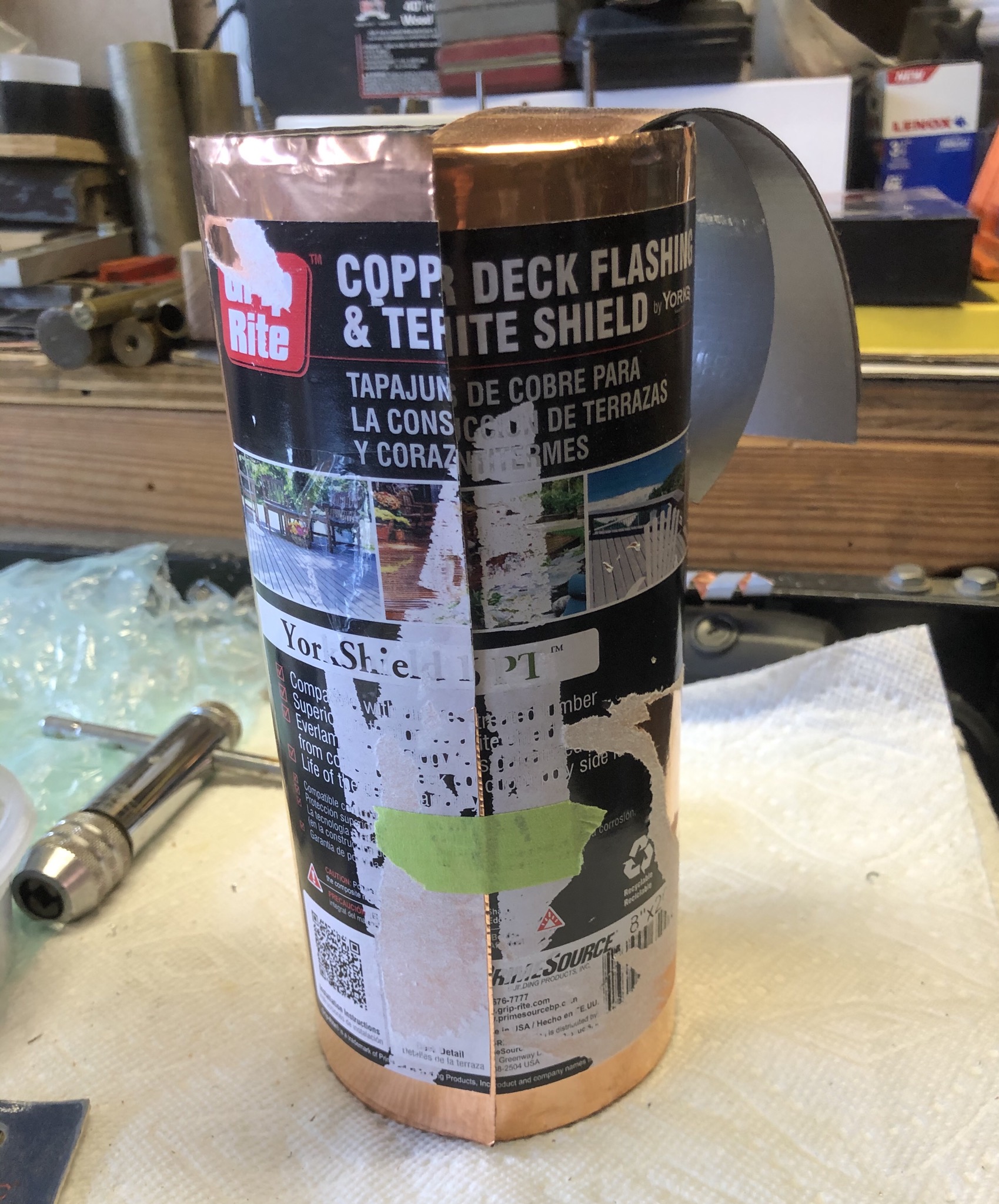

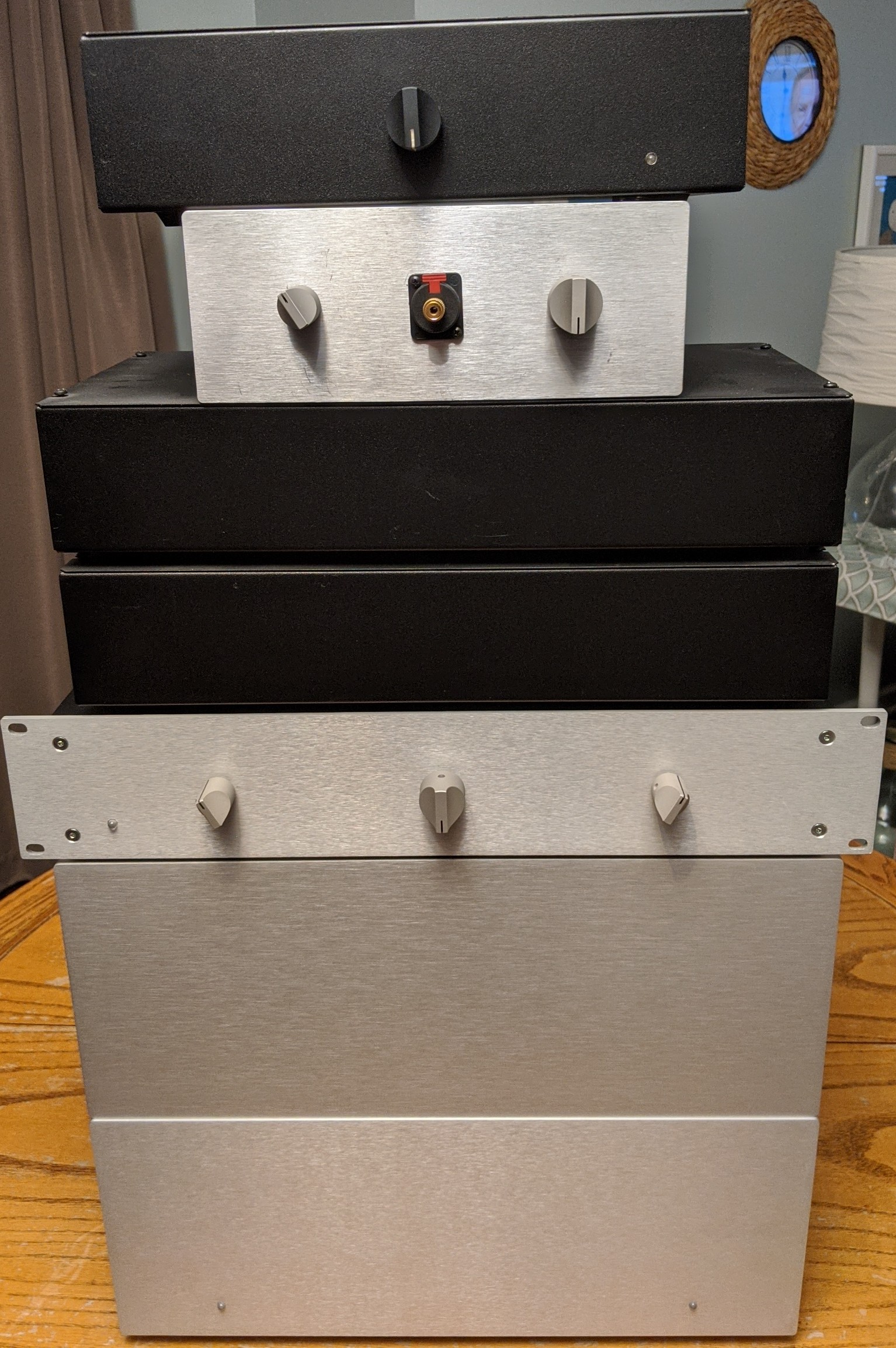

@thompson I like the copper for a couple of reasons. It is much easier to make my cases by using wood cheeks (side panels) and I like the aesthetics.
It’s not that expensive as the copper I use is vinyl backed termite barrier that I can buy rolls of reasonably cheap at Home Depot/Lowe’s.
It’s something I started doing when I built my first phono amp and I was not only concerned with EMI affecting the circuit, but more importantly having the entire case grounded properly with the wood being part of the case.
@ballistic I tested several fans and found them all too noisy to live with. The quietest was the small 1.25” X 1.25” 12V fans I got when the local Radio Shack went out of business.
Even then, I couldn’t live with the noise the little fan produced when it ran at the 10 or so volts that my mini 12V power supply was putting out.

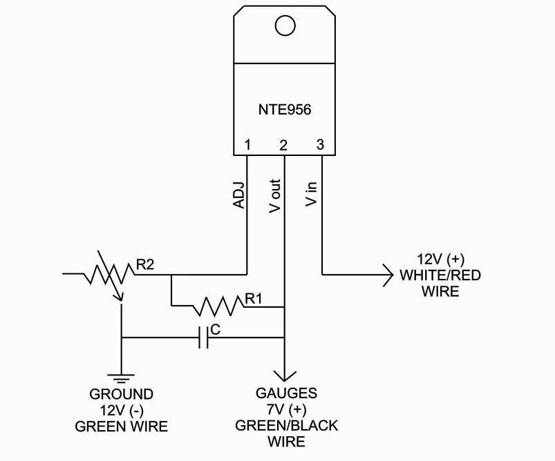

I had to build an adjustable voltage regulator with some parts I had on hand. I had an lm317 equivalent and built my adjustable regulator from info I found online.
Once I had it working and everything in the case I adjusted it until it was inaudible from a few feet away with the lid on the amp. I found 6V output to be just enough to create a cooling breeze without excessive noise.
