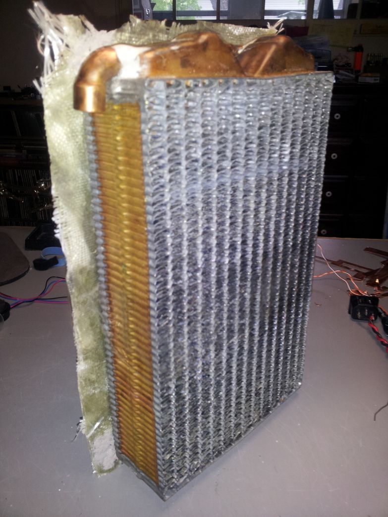

Sneak Peek - If my little BA-3 experiment works out as hoped, you can just pipe it into your central air ducts and heat the whole d*mn house - or get some very long speaker cables and move it around to the coldest spot in your castle !!!

Just need some very long feeder hose for the heat exchanger and short speaker cable . look good.Sneak Peek - If my little BA-3 experiment works out as hoped, you can just pipe it into your central air ducts and heat the whole d*mn house - or get some very long speaker cables and move it around to the coldest spot in your castle !!!

Sneak Peek - If my little BA-3 experiment works out as hoped, you can just pipe it into your central air ducts and heat the whole d*mn house .

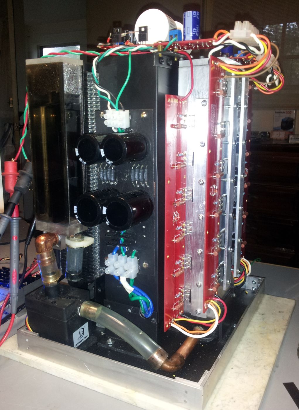

Bob, at some point in time, you might want to add some "water wetter" to your coolant water. It tends to improve the cooling capacity of the water (I think it promotes better metal to water boundary transfer). I use it on my race cars--and if it gives me a 15 degree C temp reduction on my McLaren (1,000 HP from 355 cu in), then it ought to be able to help cool your amp, too. I used the additive made by Red Line.

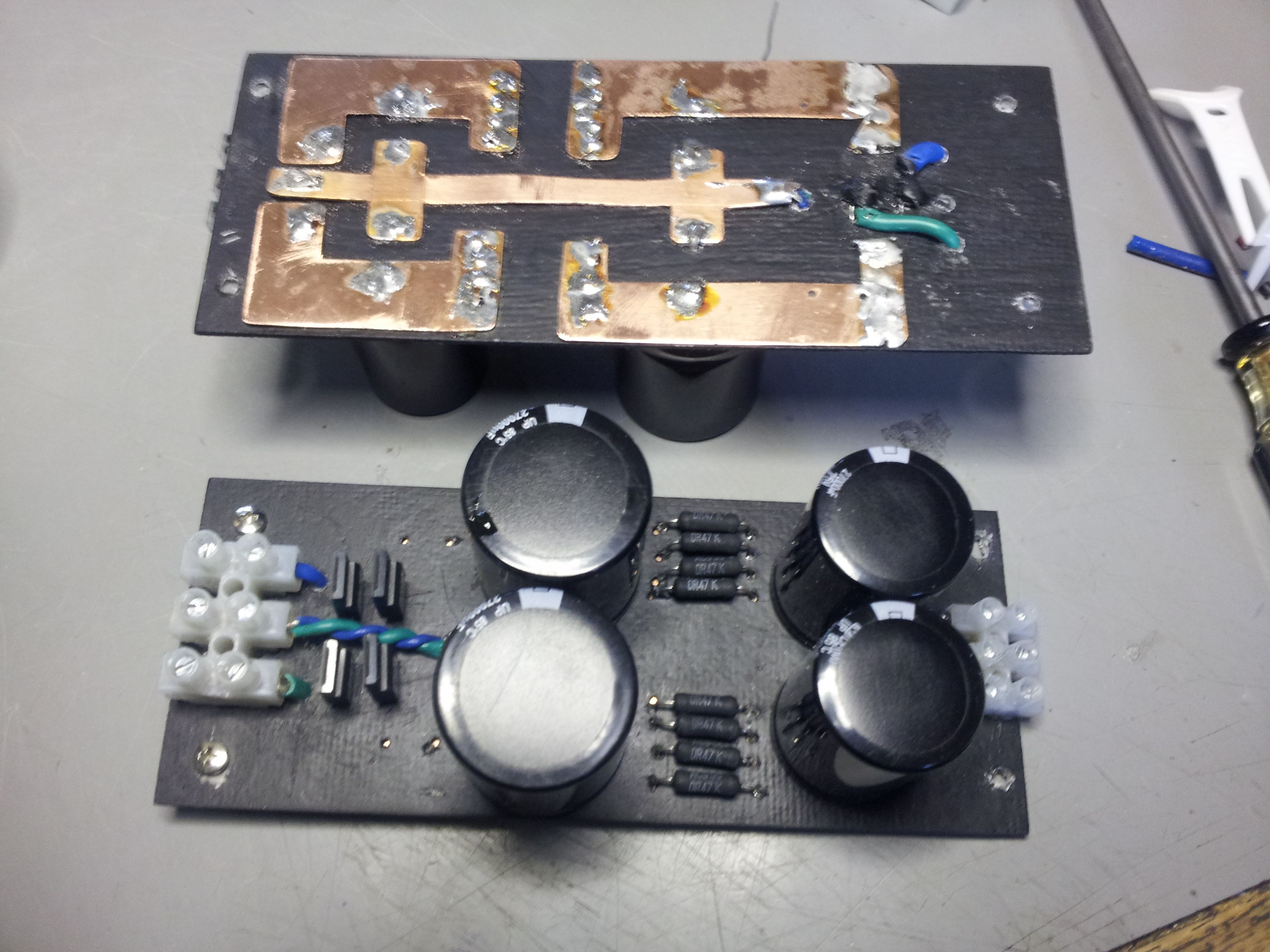

That gets more amazing each time I see it. Love the home made PS PCB!!
++ on the Red Line "water wetter".

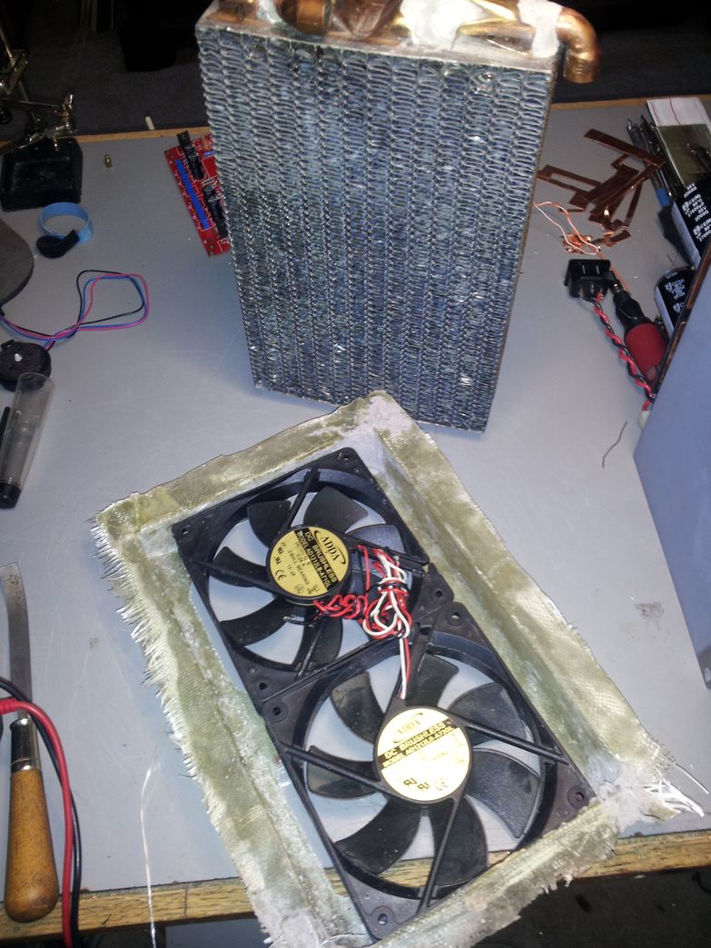

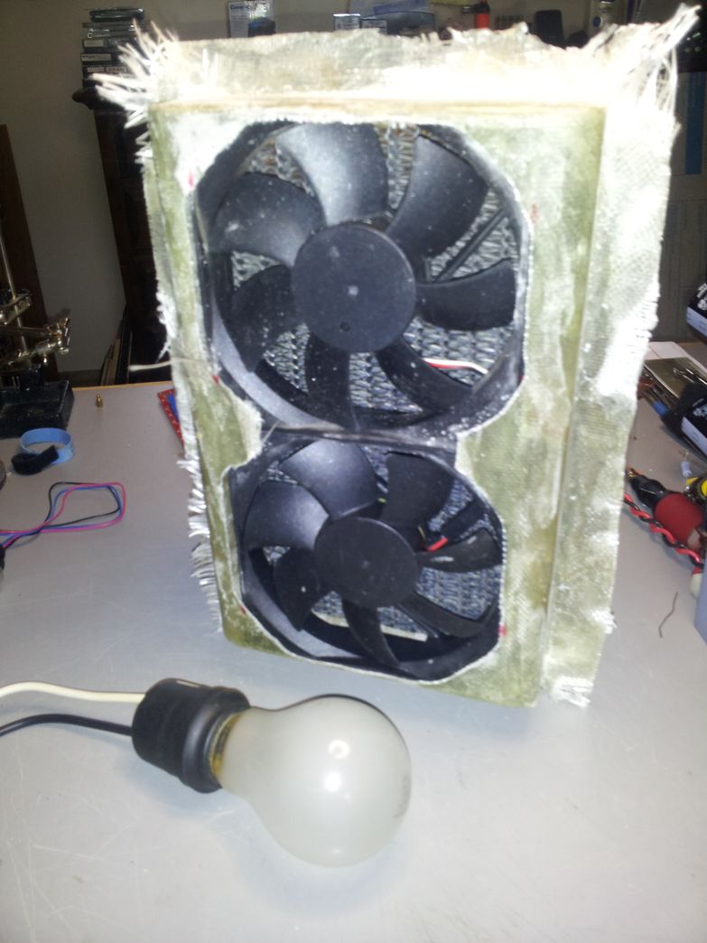

Does that save any space/volume/cost compared to fan cooling or passive cooling?
Won't have a definitive answer till the final build is completed. If I can improve the heat transfer efficiency at the fets, the radiator/fan module could be smaller. Compare: Radiator @ $27, fans @ $9 ea. pump @ $33 = around $75 w/fittings - to the cost of a quality chassis with sufficient heatsinking for 24 devices. The shell will be made from a sheet of aluminum costing ~ $40.
6L6 is correct. It's the last leg of a curiosity based adventure that hopefully might spur some practical developments/alternative in the liquid cooling concept. Received PM from others who have started similar projects. We will see what the future brings.
Edit: Thanks Bill. The CL-60 part was made with the leftovers from the PS construction. I will get the WW soon and report back.
