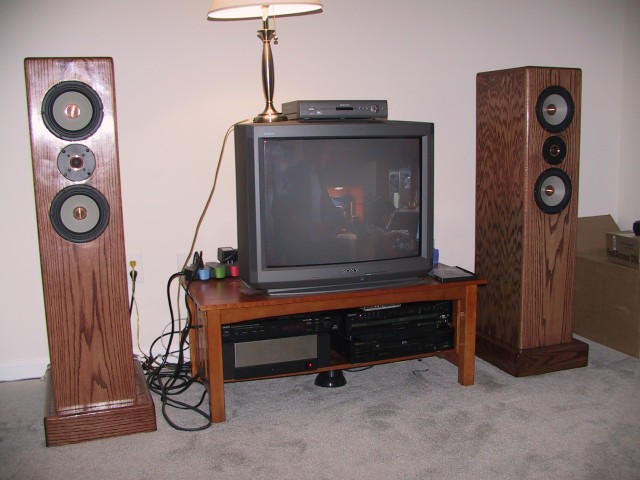

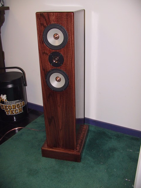

I added more pictures of the first finished pair of speakers. My friend finished his. I am next in line to stain mine (i started last). I am quite satisfied with the sound of Thor... Here is my listening experience:
Room wasn't quite ideal, so I am not sure how the effects of the room had on the sound. When they were first fired up, I immediately noticed the increased detail over my old speakers and my friends old speakers. They are much faster and accurate sounding with great imaging. The initial sound was a little lacking in bass, and was a little harsh on the highs, but quite good sounding. After letting them play by themselves for 8 hours, and going back to them, they sounded much, much better. Most of the harshness was gone, and the bass was now much more evident. They are very accurate and took well to anything that I played on them. They were very neutral, and I couldn't find anything that I didn't like about them. We tried all kinds of music, and I was suprised how they sounded. One of my friends was used to having a sub in his car, so he was quite disappointed at the lack of bass at first, but by the end of the day, and a lot of listening, he decided that they had just the right amount of bass, and that the detail was amazing. I can't wait to finish mine, and fully break them in and try them in my place. There was one thing that I was disappointed at... They really bring out the quality of the recording. Playing some old rolling stones (new remasters), and some led zepplin, you definately could tell the quality of the source was lacking. Nevertheless, there is still great imaging on the remastered rolling stones, and I was quite satisfied. I realize that this isn't much of a review, but I haven't really spent enough time with the speakers yet to accurately judge how they sound. I was really impressed, and I definately find them worth the money and time that I have spent so far on them.
Girlfriend's review.... "all those speakers sound the same... they do look a lot nicer then the old ones though"
They were just powered by a 2 channel leach amp. Once I get mine finished, along with my aleph 2, I will do a comparison of the two amps. I should get my speakers totally finished in a couple of weeks. I have only been able to working on sundays lately, due to the girlfriend getting upset at me spending all my time on my projects... and it is her birthday next weekend.
Here is a picture of a finished speaker. There are more on my site that I just added... just go to http://brian.darg.net/thor

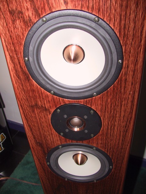

fcel,
The point of this project is something that I spend hours (many hours) and make by myself. I will probably spend over 100 hours on the speakers by the time that I finish them. If I was to buy a cabinet and assemble them in a day, what would this accomplish? I am actually enjoying woodworking more then building amplifiers. It is a new form of addiction, and leads to compulsive spending for new tools... (bought a plunge router attachment yesterday)
The quality of the cabinet that I built is much higher. The madisound cabinet is made of mdf covered in veneer. I made mine of mdf covered in solid oak. It is much heavier and more solid. I really like the finished appearence of the red oak. If I was frugal, I could have finished the speakers for under $1000, and just use mdf covered in cheap veneer, but I wanted something that I could use for many years and be proud to show people as my first speaker.

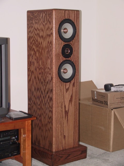

My friend made a couple of mistakes with his that I improved on. First, he didn't sand the wood enough, and the milling marks of the solid oak are still apparent. Second, he didn't quite make the tweeters on the baffle flush.
I kind of like this picture...

For making the mdf cabinet, I just used liquid nails and screws. \For putting the oak over the mdf, I just used lots of wood glue, clamped them together and let them sit overnight. By using lots of clamps, they have a really close fit.
I actually used red oak plywood for the side panels, and the solid oak for the top, front and back.

With respect to finishing oak, the main consideration is that oak has an open grain. The figure running through the oak will absorb more of the stain's particulate matter, making them darker. The darke the stain, the more pronounced this effect. I tend to like Minwood's "natural" color stain (which is very light in color) followed by water-based polyurethane. Another good topcoat is to use a spray-can lacquer. It's not as durable as poly, but it looks wonderful with none of the "plasticy" quality that poly sometimes produces.
An alternative to using stain is wood dye. Dyes are available in water-based or alcohol-based form. I like the alcohol-based stains because they won't raise the grain and require subsequent sanding as the the water-based dyes will.

As far as the staining, the milling lines stand out because he didn't sand it enough. I sanded mine much more, and they are gone. You could see them before the stain was applied. I considered doing mine natural color, but I really like the color of my friends. The pictures don't totally convey the color of the speakers. They are not too plastic looking, and are quite nice. He put a lot of coats of water based polyurethane, and it is quite smooth.
