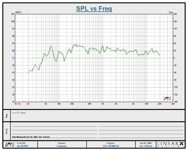

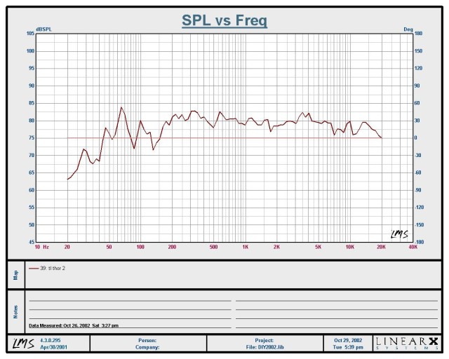

I measured the response of my Thor TL speakers last weekend, and just got the pictures sent to me.
Pictures are in my gallery at:
http://brian.darg.net/thor?&page=3
Brian

This is with only 10hrs of breakin time, and the bass is getting much stronger now, as they are getting broken in more.
Brian
Brian

Brian, your speakers look pretty good as they are! It would be interesting to repeat the measurements in a few weeks to see just how much extra bass has come out of it.
Jan Didden
Jan Didden

MJK said:Were your speakers the ones int he DIY Atlanta eveny? If so, what was your impressions after listening to your Thors and Bob Brines' Peerless TLs.
Yes, those were my speakers. I had finished them 5am the morning of the event, so they were only played a few hours before I brought them to the DIY2002 event.
Here is what was said: "They really sounded sweet,
but the consensus seems to be that the bass sounds a little thin. Maybe the drivers just need breaking in, or maybe that's the way it's supposed to be. I guess keep using them and see if the bass changes."
The bass has since changed considerably.
Bob Brines' Peerless TLs were quite nice, but the quality of the drivers is much less then the Seas Excel woofers and the Milennium tweeters. (he used morel tweeters). I found the highs a little bit harsh. The bass was at the right level, but not as tight as the Thor TL speakers. But, I was really impressed with performance for the lower cost of the Peerless and
My Thor TL speakers are starting to get broken in and the bass is coming out. My friend who I built mine with and he finished about a month ago, his speakers sound perfect. The bass is not thin at all. I think that I just need to let mine play, and they will sound right. They are getting better everyday. I leave them playing all day and when I get home, compare the sound with a known cd track.
Robert Cheng (the guy in charge of organizing the DIY2002 Atlanta event) is considering getting another gathering together in a couple of months, and I can bring the Thor TL speakers again so that people can hear the sound of them when broken in.
I will measure my speakers again in a couple of weeks in Dr. Leach's audiolab and see how they measure up when broken in.

If you do measure the speakers again in a couple of weeks I would be interested in seeing the newer and original plots. My experiences with driver break-in are mixed, sometimes things change and sometimes they do not change. It might also be interesting to get a near field measurement for each mid-bass driver and for the terminus to see if any insight can be gained about the standing waves in the enclosure and if they inpact each driver differently.
Thanks for the complements. This was my first speaker project, and my first woodworking project ever. After I take them in and get them measured again, I will post the new results.
