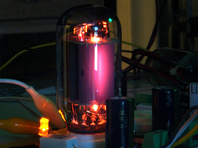

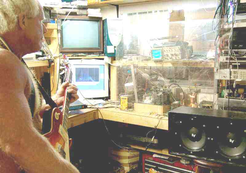

Sometimes my tube amp experiments scare even me. DONT TRY THIS AT HOME.....WE ARE TRAINED PROFESSIONALS!!!! (yeah, where have I heard this before)
This was a test amp that I assembled to evaluate a prototype OPT. It was made by substituting a 500 watt 833A triode for the 100 watt 845 triode in my 845SE amp, and substituting a 1500 volt 1/2 amp power supply for the 1050 volt unit in the amp......all with hamfest grade Chinese clip leads. Note the vice grip and hose clamps tube socket.
I had a 1/4 inch Lexan blast shield between myself and the amp and a fire extinguisher at my feet at all times whenever the amp was powered up, except for one picture session from a safe distance. This guy cranked out 200 watts in SE but didn't quite make the grade as a HiFi amp, so.....I plugged in a guitar preamp and did my best to blow it up.....it survived a week of my abuse and the only hiccups was a tripped 15 amp bench breaker twice. Then my sanity returned, an I took it apart.

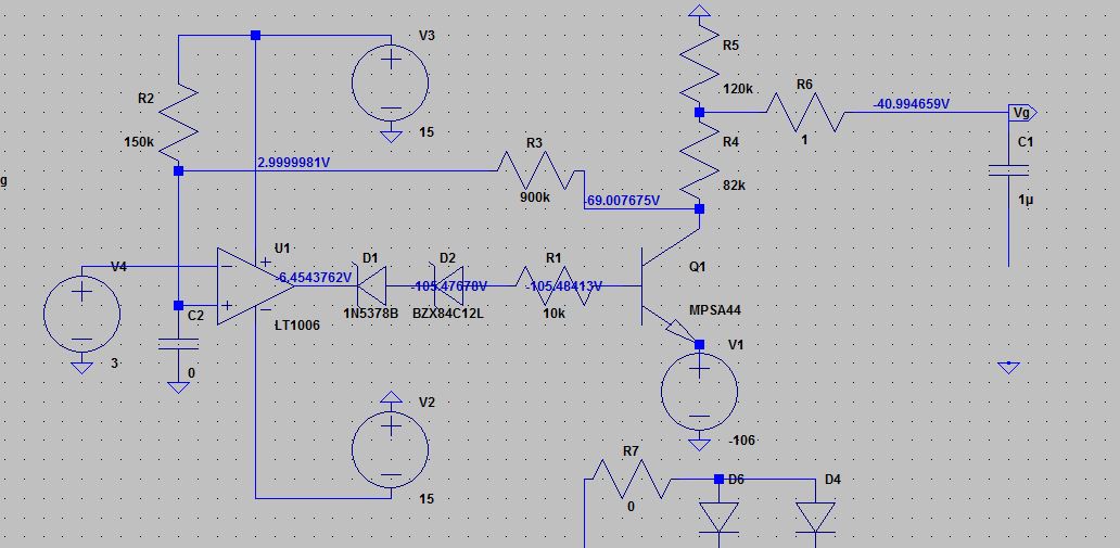

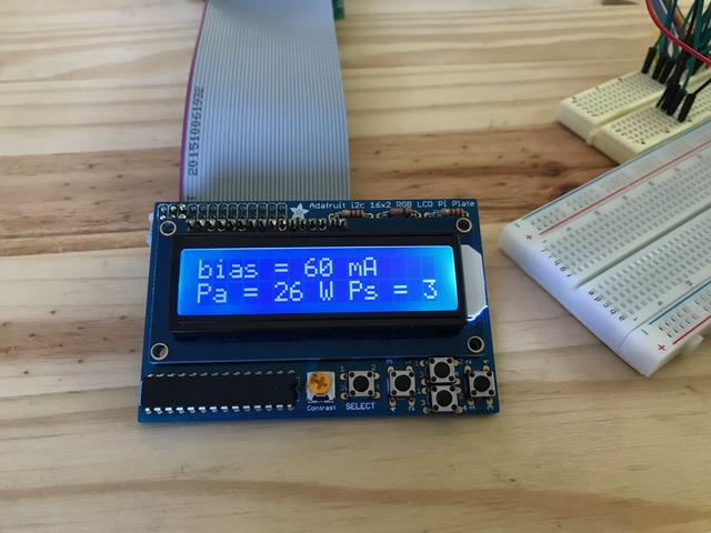

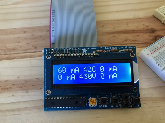

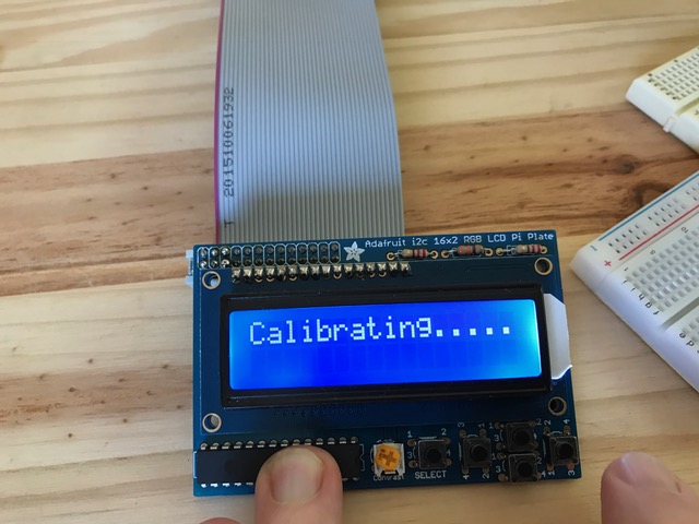

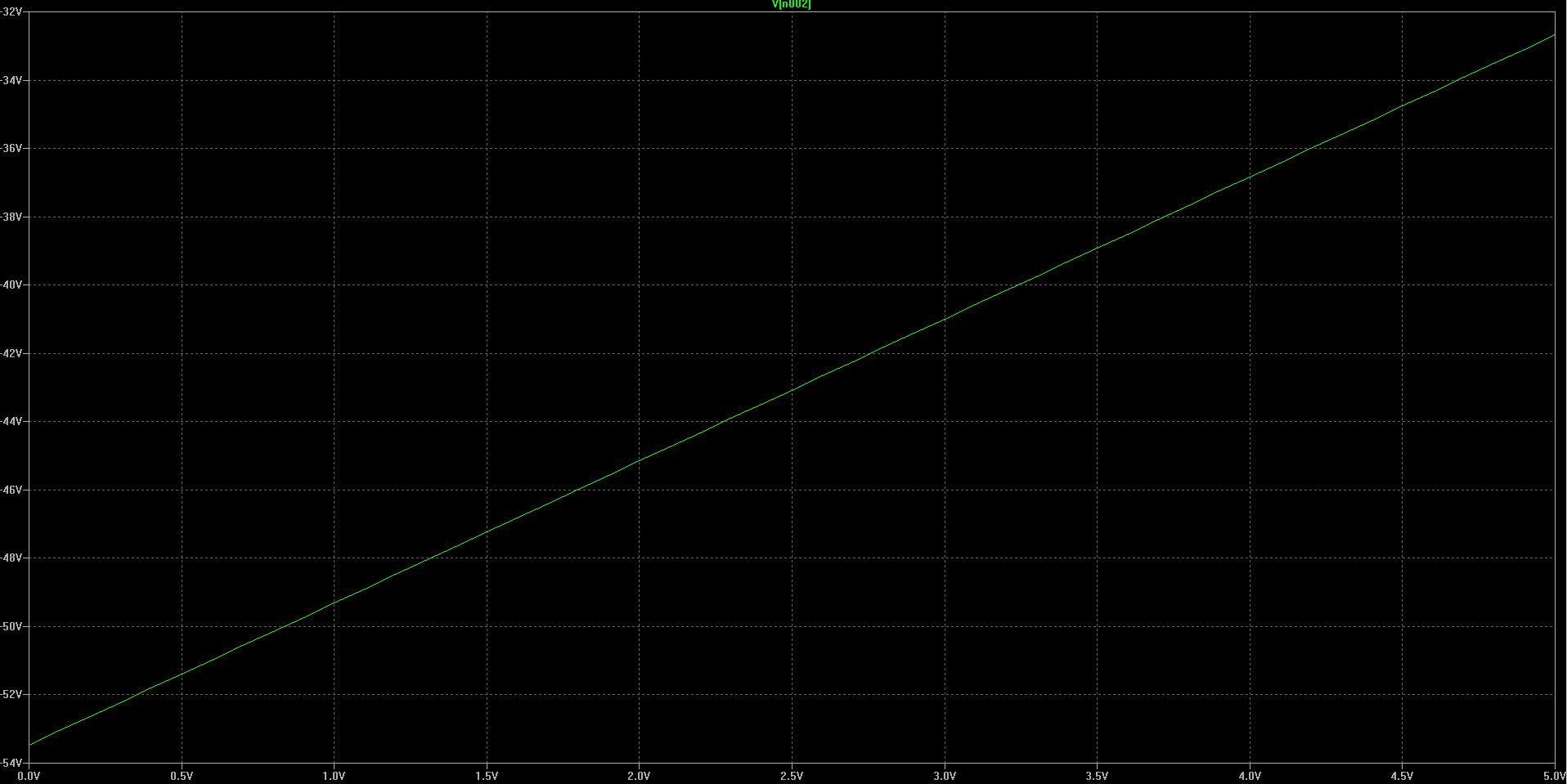

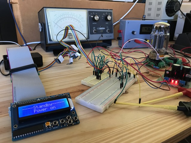

This is to be my first fixed bias PP amplifier, and I was wondering what to do about bias adjustment/control, so have developed this micro based controller that will also end up controlling audio input selectors etc. It is Raspberry Pi based using Python 3 script; 4 ADC's to measure the 4 tube currents and 4 DACs to control the grid bias using a simple level translator circuit.
It works very well - you dial up a new bias and within 2 iterations the new bias is set to within 0.5mA. Only 1 tube is connected at this time. I use the Koren model of the triode connected tube to help get to the new bias point quickly. Also using the measured B+ voltage I compensate for Vg on the fly to ensure Ia stays stable.

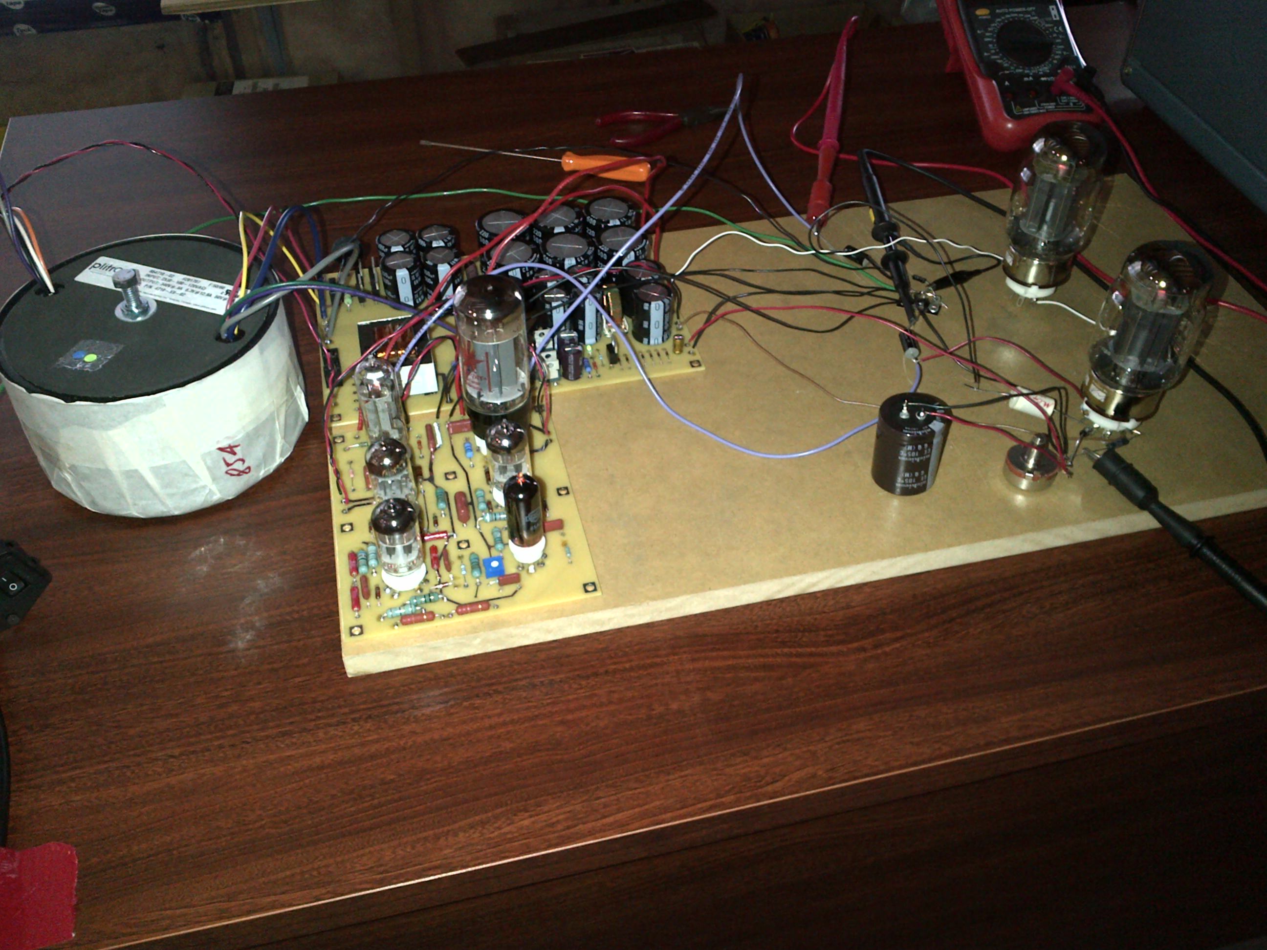

Testing the power supply and all-tube regulator for my PPP KT88 amp. Regulator provides 353V for drivers and 270V for the output tube screens. I was impressed that the driver regulator (that has about 60 dB of loop gain) had very low output noise and very low drift. Heaters are DC except the pass tubes, that have their own transformer on the PC board.

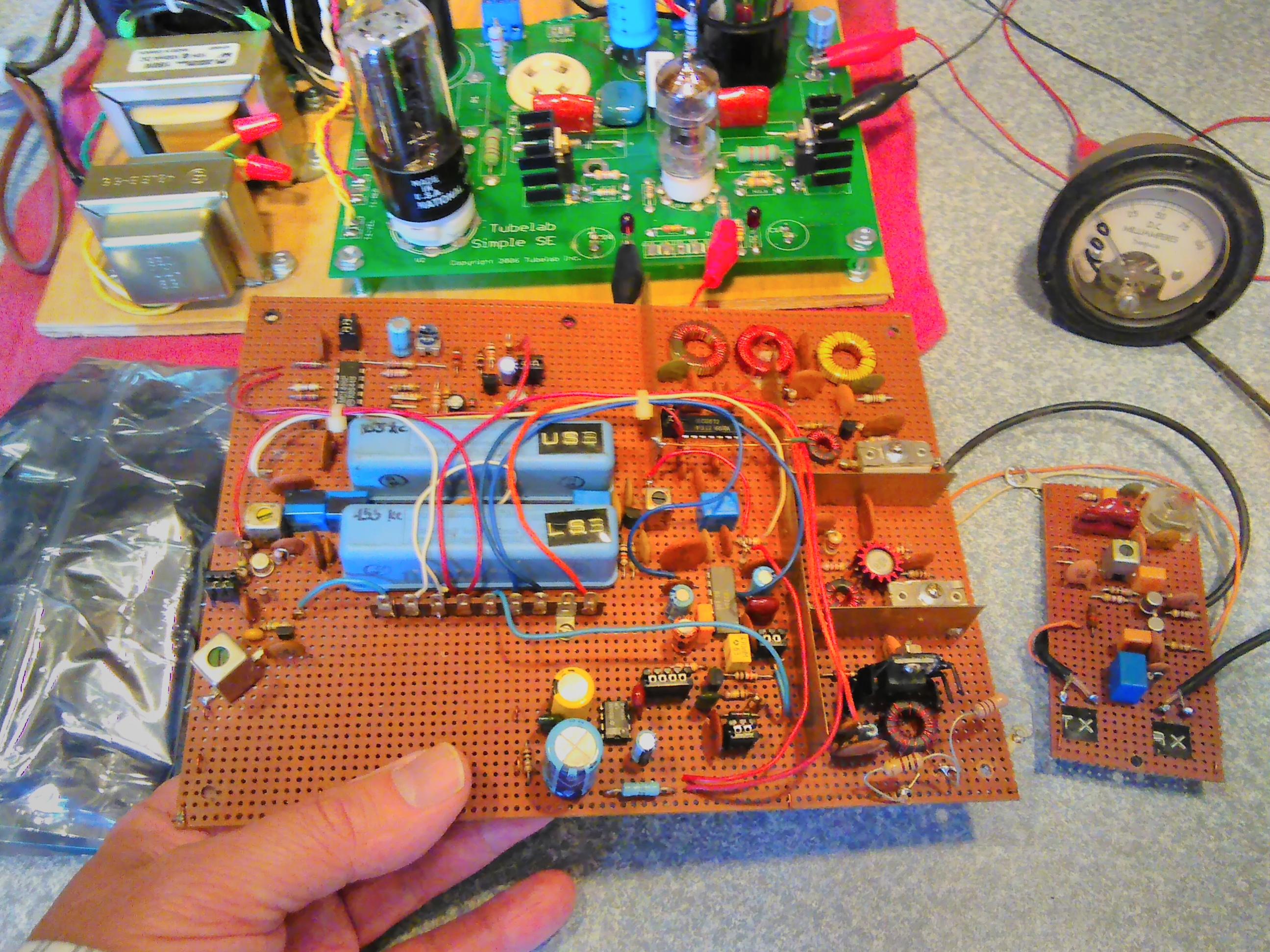

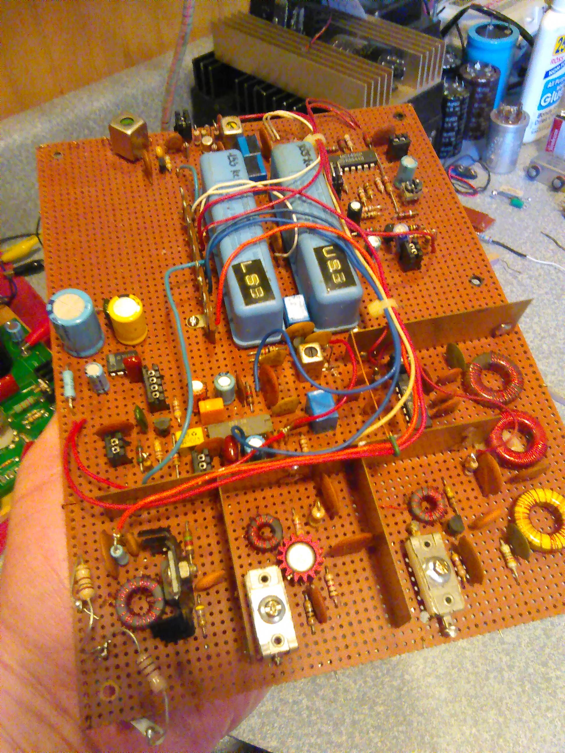

One of my first "complex" projects - most of a single band ssb / cw transceiver. The main board is slightly larger than the Tubelab SSE board. The carrier oscillator board is off to the right, the digital display stuff off to the left in the anti static bag. The HFO is not shown - started with an LC oscillator, and then a "sorta synthesizer" with a VCO at the injection frequency phase locked to a very stable low frequency oscillator.
Pretty straightforward - the matched USB and LSB mechanical filters makes frequency management easy. No need to shift the carrier oscillator frequency or offset the display to read properly. CW is handled by a tone ran through the USB filter. Puts out a couple of watts PEP. The idea was to use this as a low frequency tunable IF for transverters, But most of the RX is on one chip - a Nat Semi LM 373, and I was never satisfied with the signal to noise ratio from it.
I moved on to an FM transceiver, and then some other stuff, and just never revisited this. I didn't need any of the parts, so it never got torn down. I still like using matched filters, but I acknowledge, grudgingly, that SDR is the way of the future, and I have some extremely simple SDR chips and am slowly working on an extremely simple SDR VHF rig.
Oh, this is an audio board? Well then, the mic input is a bipolar 2N2222 feeding an MC1496 balanced modulator, and the audio is another 2N2222 feeding an LM386-4 for the power stage.

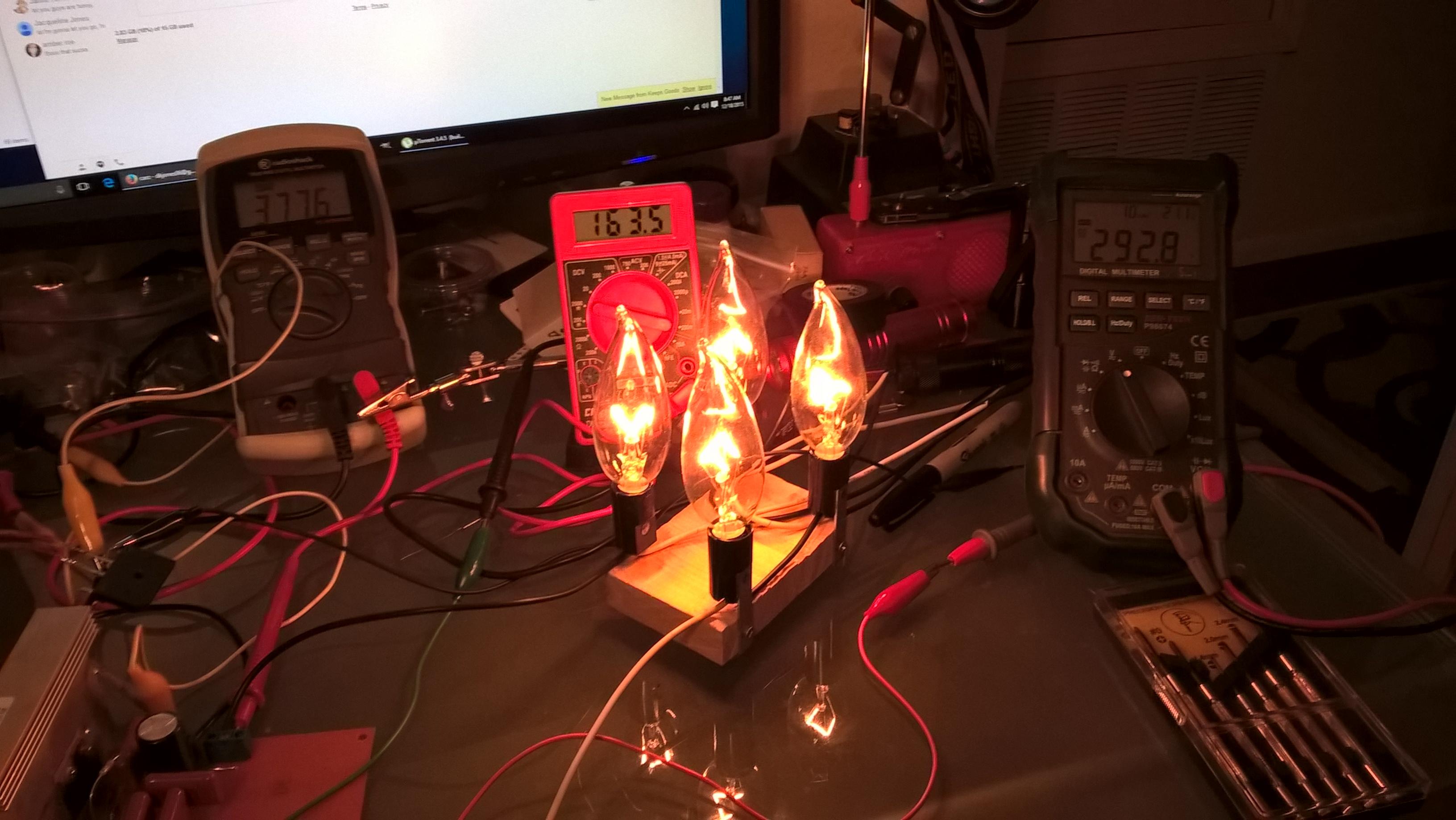

First pic is a solid state high voltage regulator for a tube amp(bottom left corner) driving 4 series 120V 40W bulbs as a dummy load. 377V input(tested up to 600V) and 292V output at 200+mA. Uses a BUF11 around an LM317. Worked well but didn't want the big heatsink so I think I'm going to have the LM317 drive some 7233s instead to make it glow and keep the heat above the chassis.

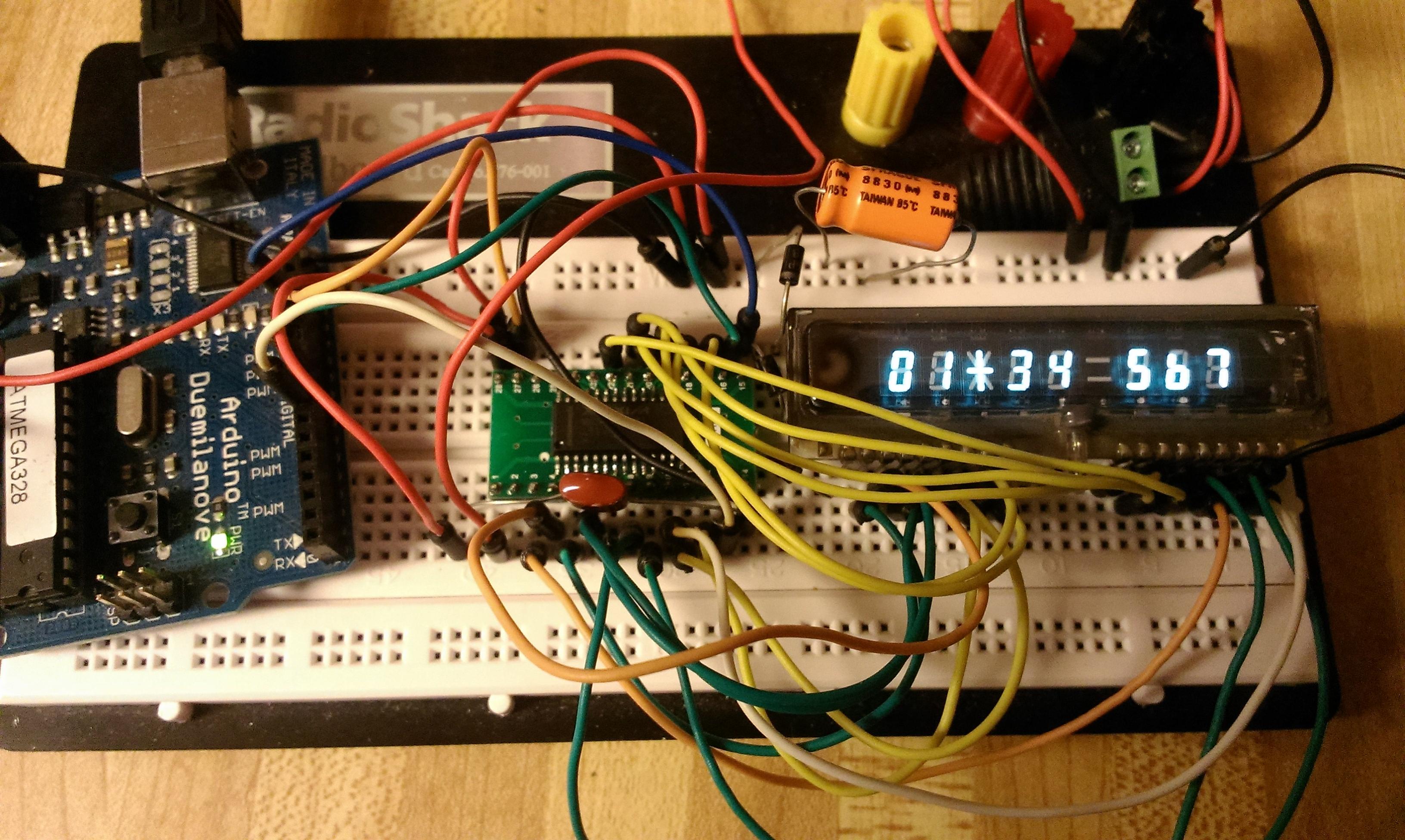

Second pic is an Arduino driving a VFD from a calculator.

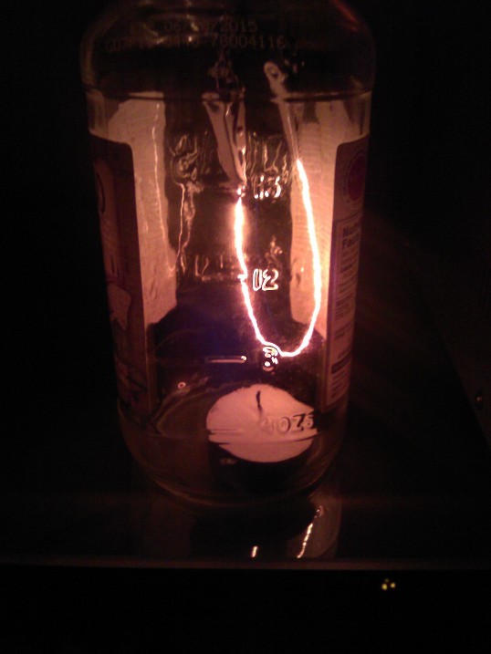

Third pic is me lighting up some nichrome in a jar with a candle for eating up oxygen. Tungsten worked but not for long. Daughter wanted to see what the inside of an incandescent light looked like when it was on.

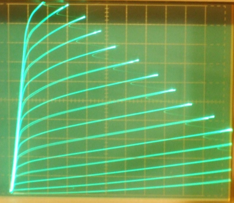

Testing some tube on the curve tracer.

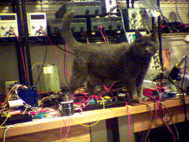

The cat checking out my circuitry for errors.
Powered up, without the cat, she knew better.

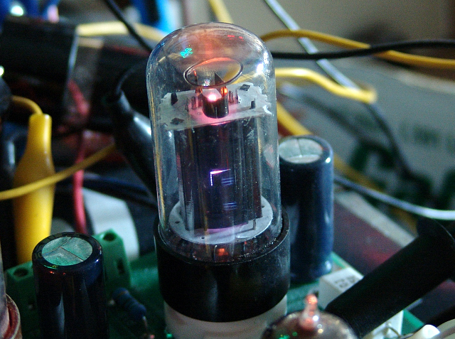

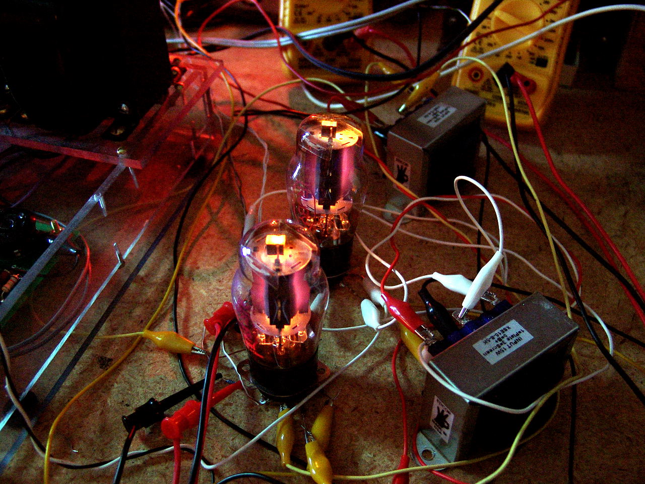

In one of my clip lead experiments I connected a pair of well used Chinese 6L6GC's into a Tubelab TSE amp and proceeded to find their limits. The tubes were pulled out of a Fender Bandmaster when its owner wanted it retubed. This was part of the testing that led to the development of the SSE amp design, so it was at least 10 years ago. I still have these tubes, and they still work, but usually only see duty for extreme testing and experiments where the outcome is uncertain. Pics #1 and #2
Take a SSE board (cathode biased SE amp), wire is as a fixed bias amp, and stuff in some sweep tubes. There was a feeding frenzy on tubes about 9 years ago when AES started clearing out all of their NOS tubes. Other vendors also got into the frenzy and I wound up with about 100 of these guys for an average cost of about 80 cents each......so the ugliest pair of supposedly NOS tubes got "tested." Pic #3 I think I squeezed over 20 watts in SE during this test. You could read by the light coming from the tubes. Some experiments seen here:
http://www.diyaudio.com/forums/tubes-valves/128533-tube-sale-aes.html?highlight=Tube+sale+AES
I ran several types of tubes through the "modified SSE" to find out what is useful for SE, and what is not. Here is a pair of 6CB5's. Pic #4 Only the tube on the right is active since only one channel was modified with the "adapter socket." Note the black chassis mount octal socket sitting on top of the white PCB socket. Note the "pimp my ride" metallic blue color of the Edcor OPT's. All Edcor's came in this color for their first year of direct to the DIY market sales. The response was mostly negative, so the switched to the mild blue that they use today.

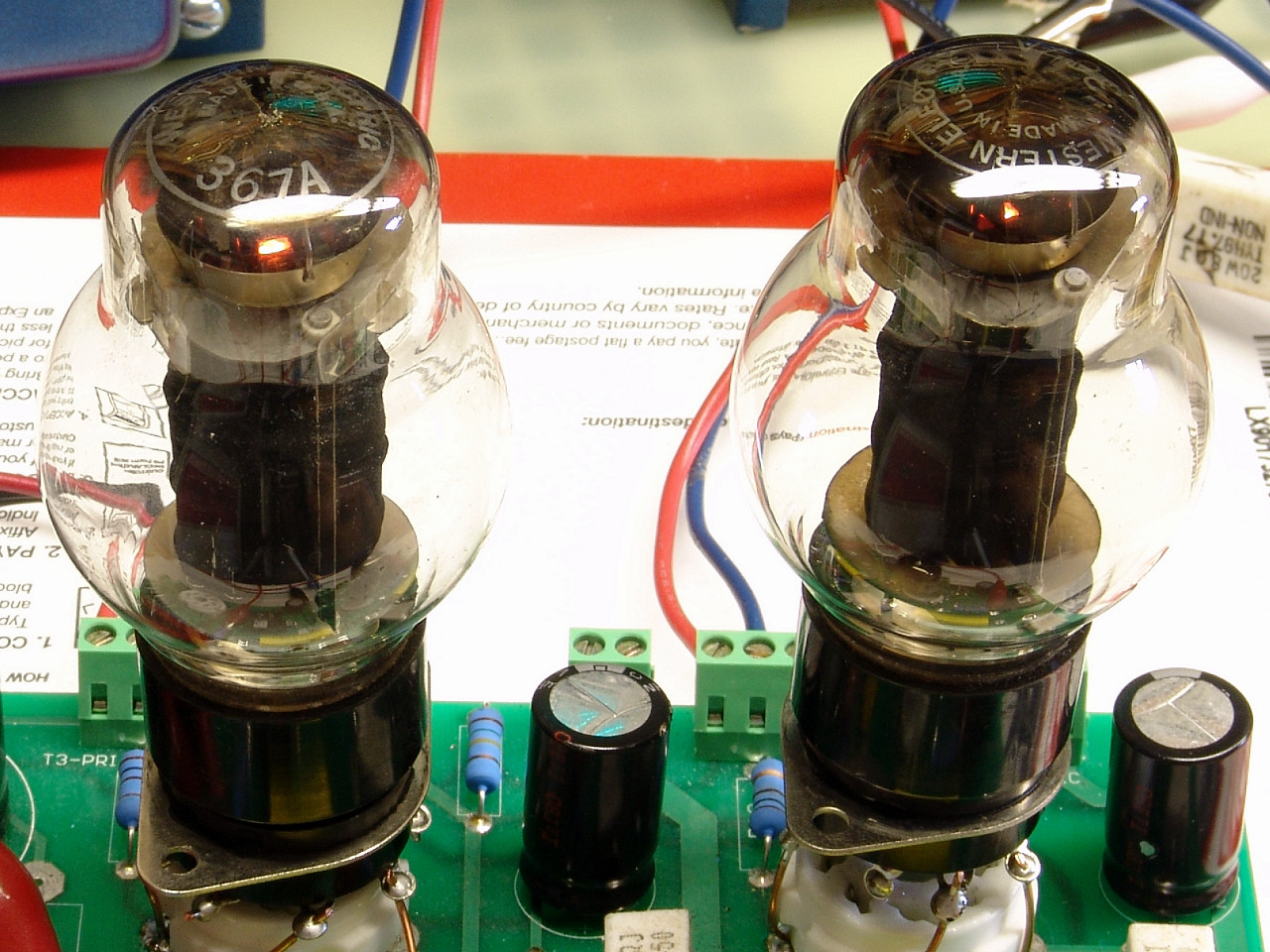

I rewired the adapter to test some WE367A's that I found. I actually wired up an adapter in the second channel so I could listen to these tubes. They sounded nice, but I decided to sell them on Ebay to pay for more experiments.
Pic #5.

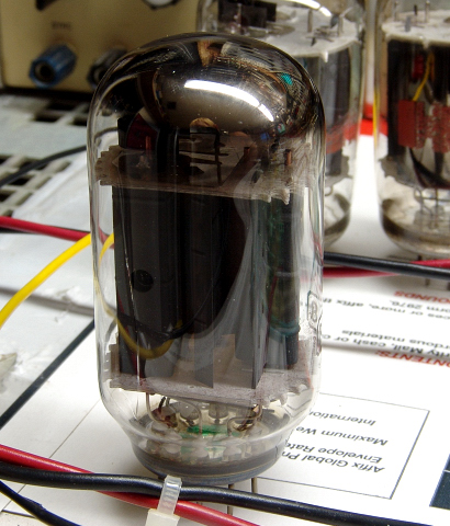

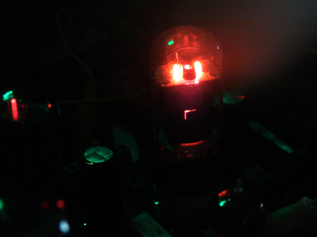

I had bought a sealed bulk pack box of 100 NOS Sylvania 6V6GT's from a NASA auction at cape Canaveral about 20 years ago. Upon opening the box I found that several of the tubes had gone to air and several more were losing their getters. I took the box home, tested all the tubes in a tube tester and tossed all the bad ones (a lot, maybe 30%), then put the box on a shelf in my closet.
A few years later I opened the box to find that many more had leaked. I again tossed the white ones and decided to test some that were silver, but fading in an SSE. Most had high distortion, so I went through the box and kept only the tubes that made reasonable THD. There were about 30 "good" tubes. I decided to test some of the tubes with high distortion in a more extreme manner, AKA death by power supply!

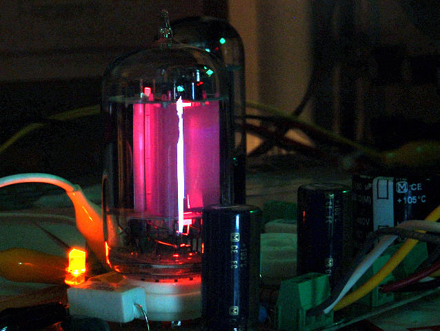

Tube #1 had minimal getter left, and there was obvious blue (gas) glow from inside the plate area. I ran it at 400 volts, above the spec, but good tubes survive this and draw about 35 mA in a SSE configured for a 6V6. This one drew about 50 mA and it started climbing. Pic #6
After an hour it looked like this and drew over 100 mA and was rising rapidly, so I killed the power and tossed the tube. Pic #7
I tested several more with similar results until I found this one. It immediately sucked over 100 mA (pic #8) and within a few seconds a tube arc erupted at the top of the tube which caused the cathode bypass cap to explode. Pic #9

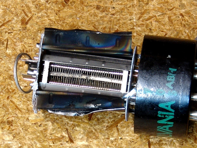

I arranged a meeting between Mr. Tube, and Maxwell's Silver Hammer! Pic # 10
Note the fried grid wires, bent cathode, and blackened plate.
I have since found more bad 6V6GT's in that box, and suspecting that they will all eventually die, I decided to take a pair of tubes that worked good last time I opened the box and subject them to some extreme, but not lethal (to a normal tube) testing. I put a pair in a P-P breadboard that I'm working on and cranked them......40 watts RMS at 2% distortion on 450 volts plate and 275 screen isn't bad for a 6V6GT and there was no glow or ill effects from about 15 minutes of testing. What's up with this box of tubes? I don't know.

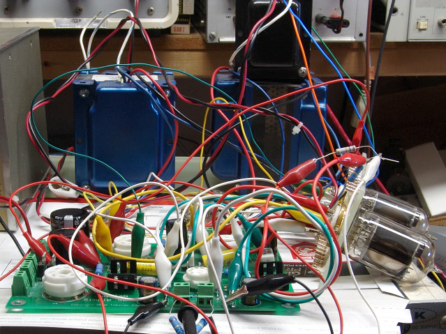

Can you build a tube amp with cheap Radio Shack clip leads? Most people will tell you that you can't, you will either make an oscillator or a box full of hum. That didn't stop me from taking a working SSE board minus the tubes, a turret board with two novar sockets in it, and a box full of clip leads and building a "spud" amp.
The idea was simple use the SSE design, but substitute the triode section of a 6LR8 for the 12AT7 input stage in the SSE, and substitute the pentode section of the 6LR8 for the output tube in the SSE. Add a variable bench power supply to find out how much voltage it will eat, stir well and crank it up.
Pic #1 shows a "furball" of clip leads connecting the pair of 6LR8's into the SSE in place of the original 3 tubes.
Pic #2 shows the entire setup operational. It really worked the first time I flipped the switch. Don't try this with high Gm tubes though, you will create a great TV jammer......experience speaks!

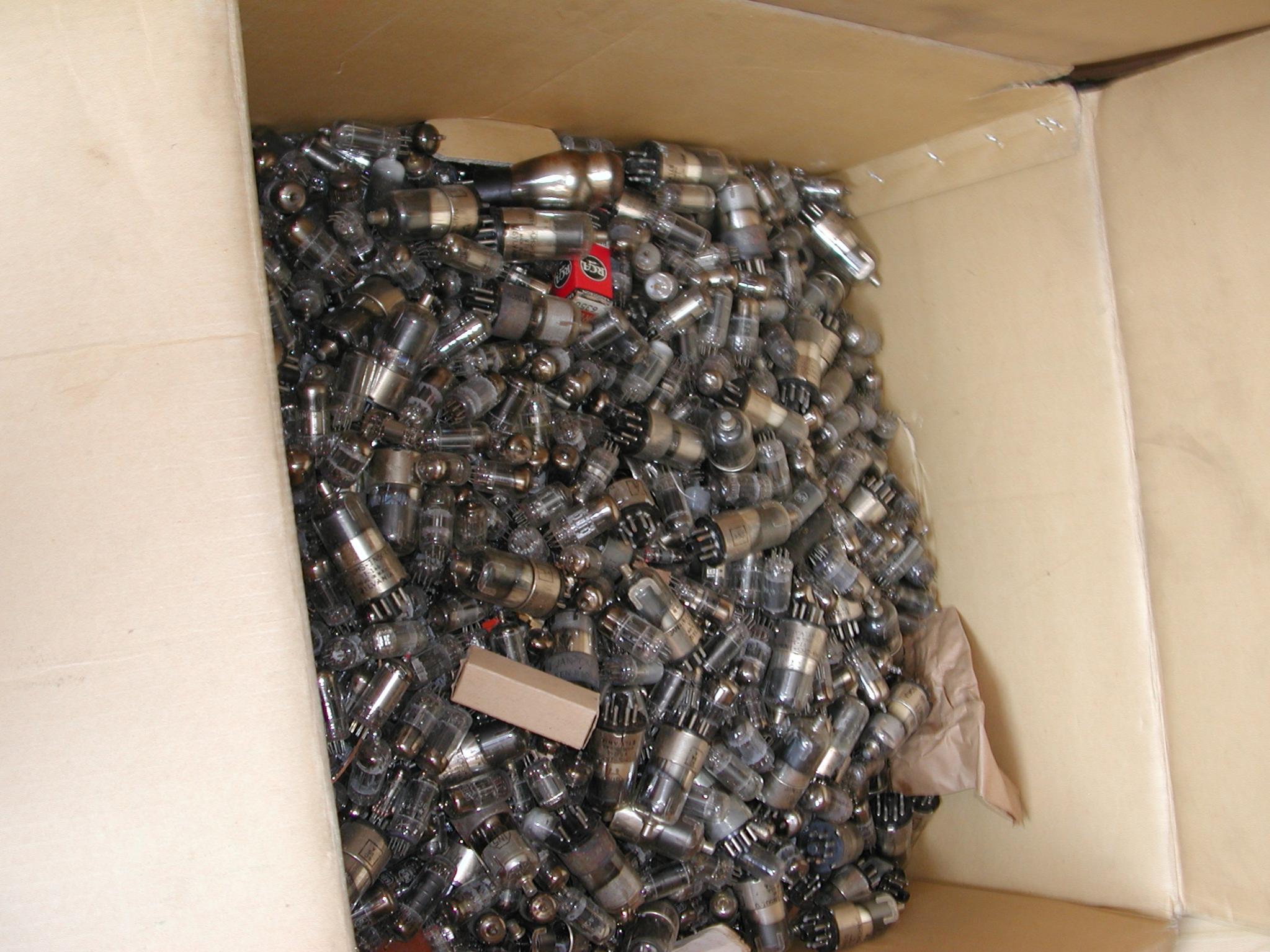

There were about 50 boxes like this, random loose tubes in mostly usable condition. So far they have been about 80% good. Pic #1

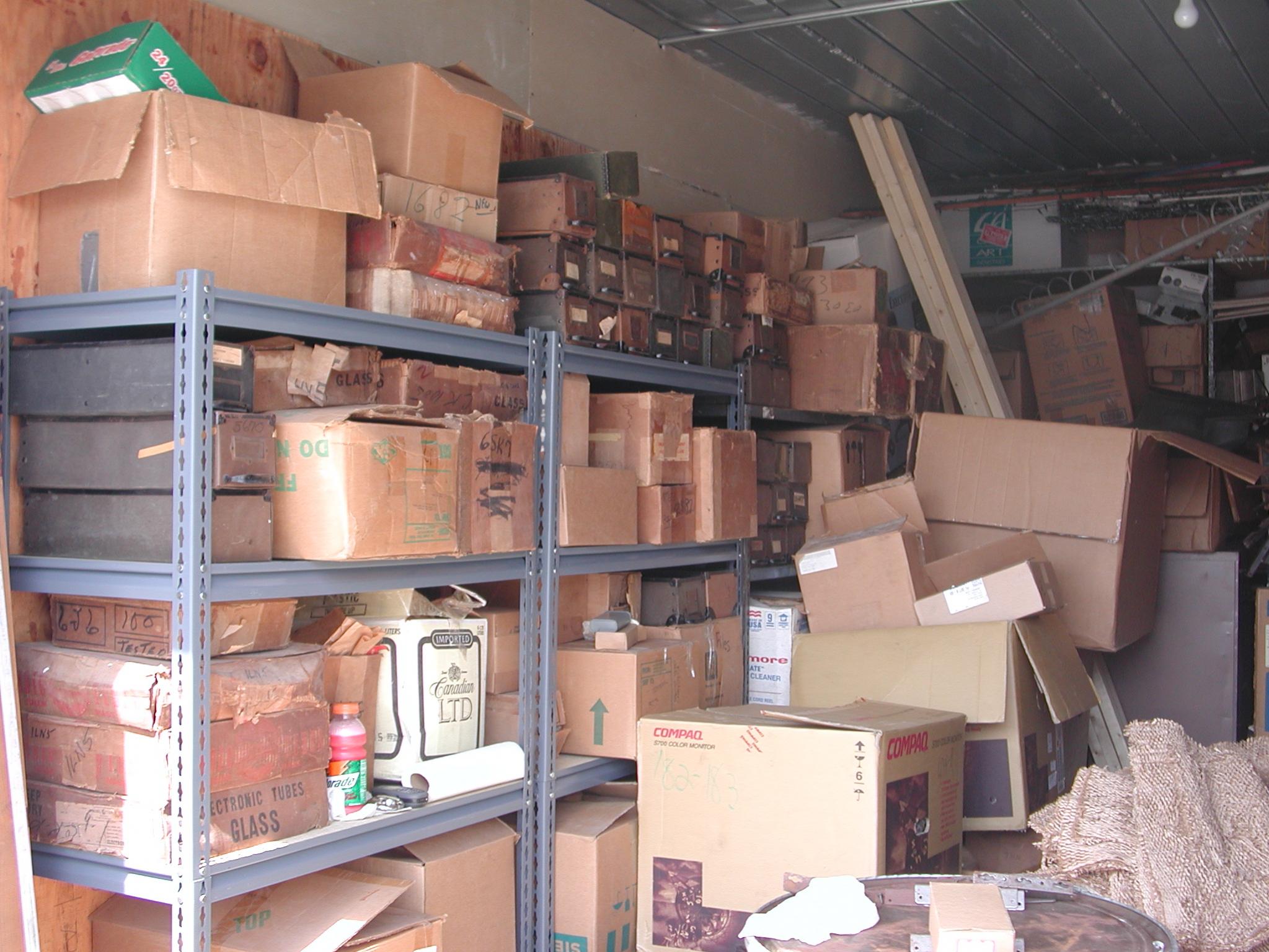

One corner of one (of three) storage bay. Pic #3

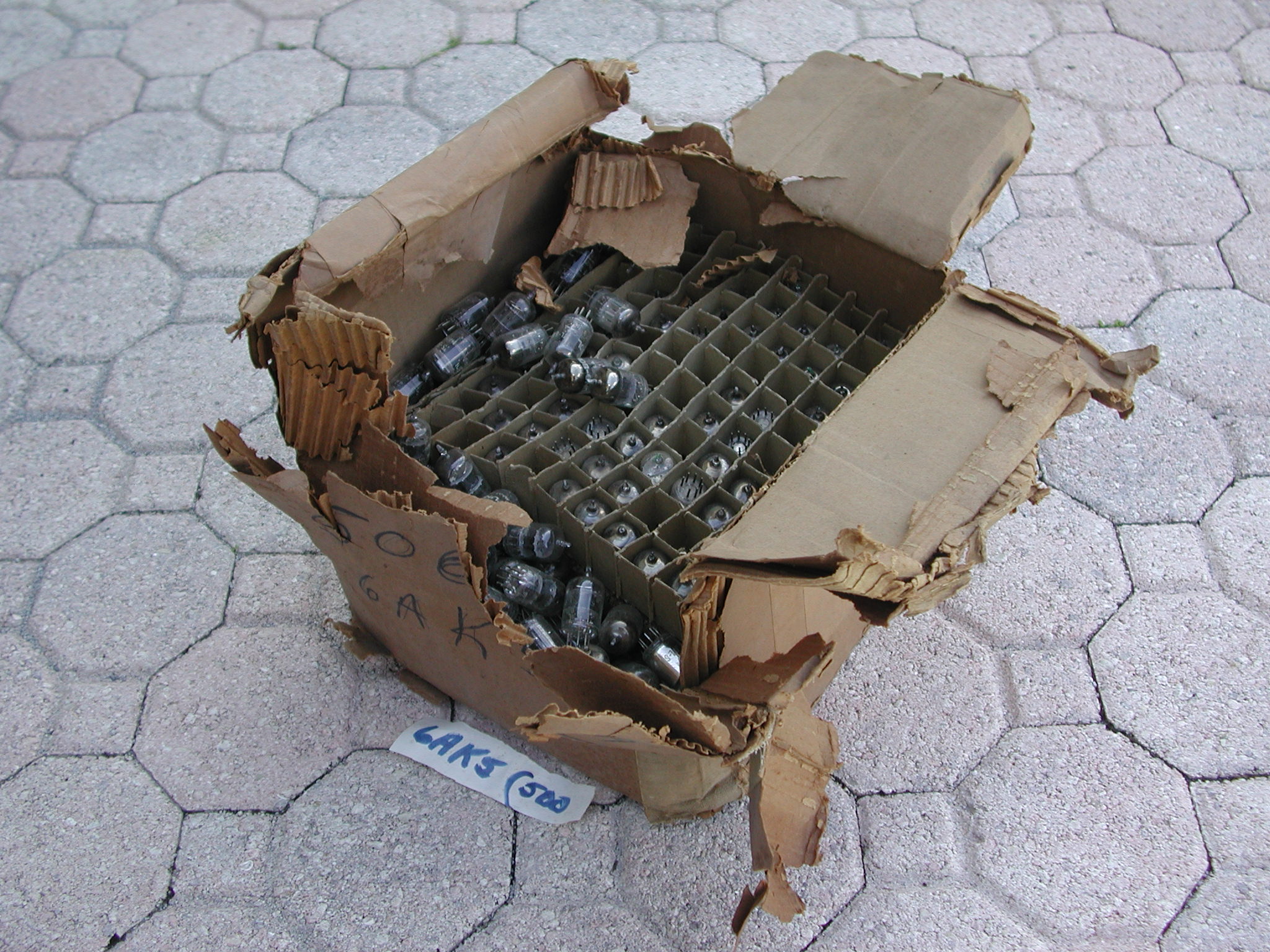

There were unopened boxes in relatively untouched shape from a long time ago. This one is from 1937 pic #4
This box weighed in at about 60 pounds, all little tubes, mostly 6AL5's 6AK5's and 6AS6's. About 40% of them were trash (broken pins, broken glass, or corrosion). Pic #5

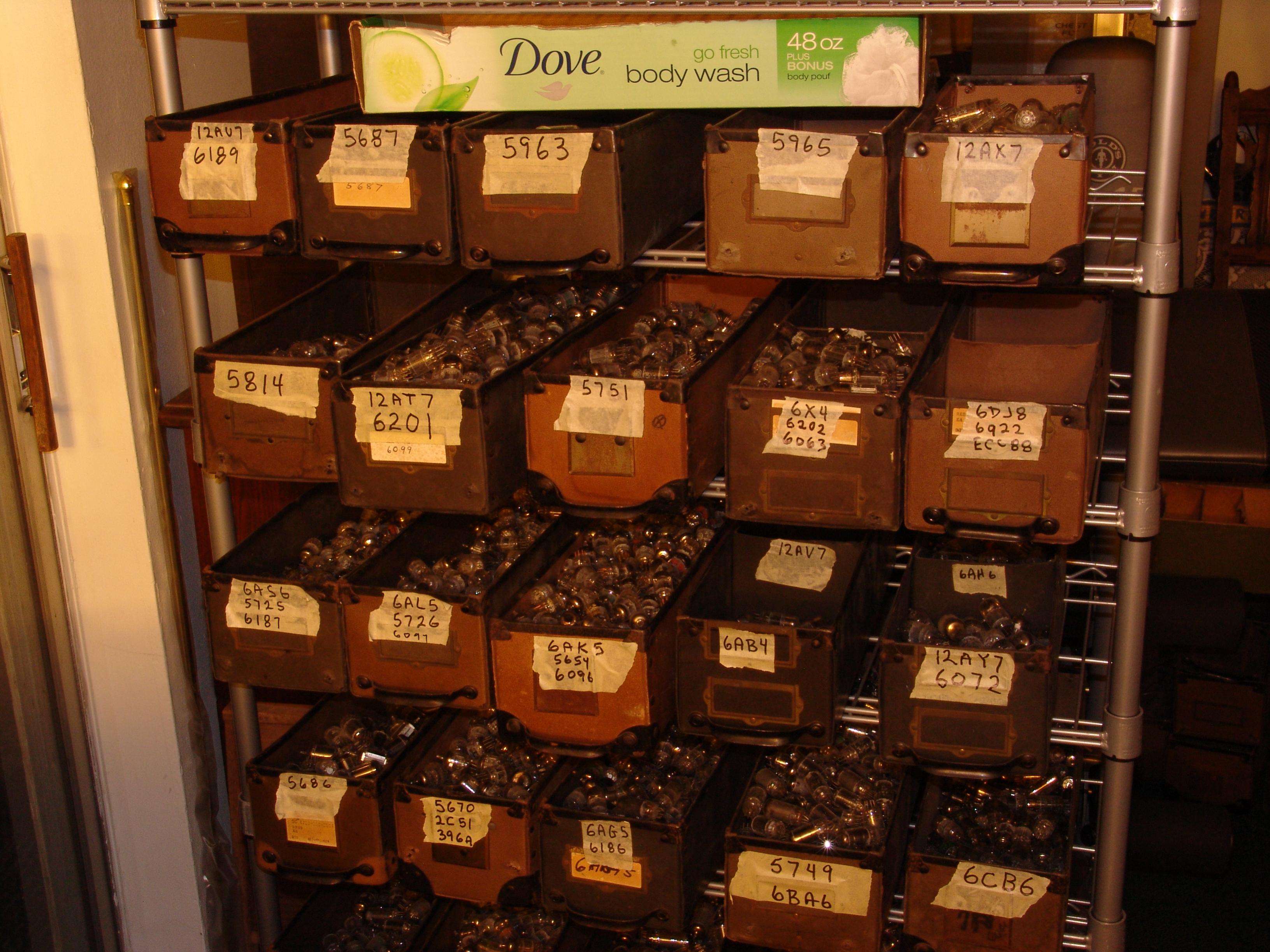

I set up racks to sort them in, and worked outside during good weather. Some boxes were full of rat or bird poop, bugs and roaches. Pic #6
After sorting I had several hundred 6AG5's. What are the odds of finding one with the ultra rare spare heater option.........what are the odds of finding TWO!

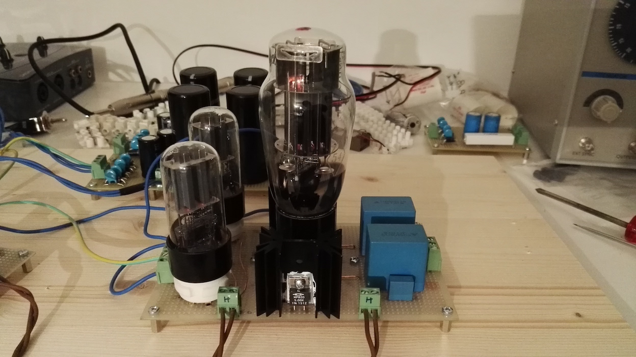

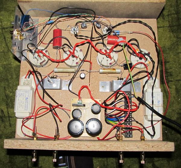

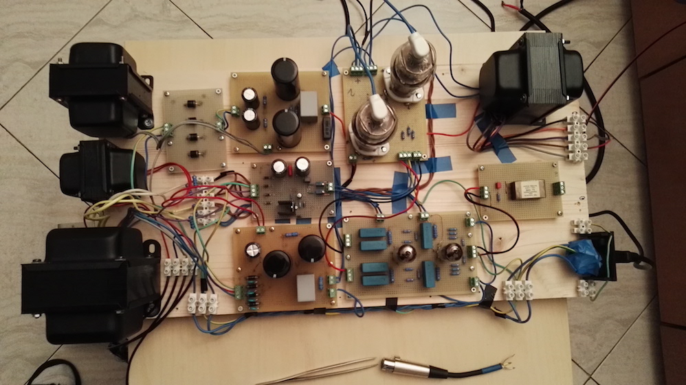

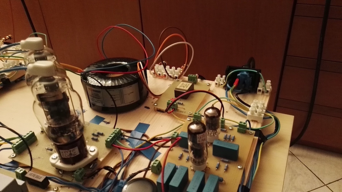

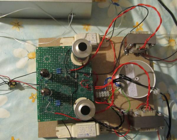

Fully balanced power amp: 6N1P 6N6P and G-807.
First test with normal output transformer, second test with toroid output transformer.

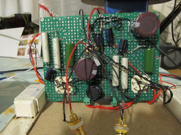

Fully balanced preamplifier: 6H8C (or 6SN7) and 6H13C.
