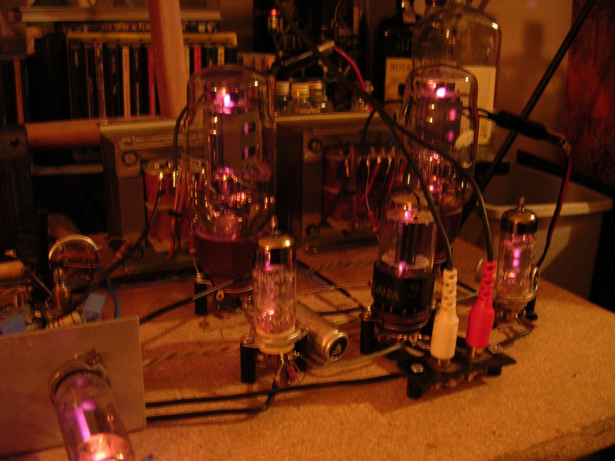

A ~3W all-compactron SEUL 21LR8 amp. DC heater supply for 4HC7 preamp on the right, the latest tweak. Dual voltage PS on the right on the bookshelf, 300V cap input (preamp) and 250V choke input (output) from a regular industrial-type power xfrmer with two windings, nice setup for testing, and cheap, but too bulky for a final build.

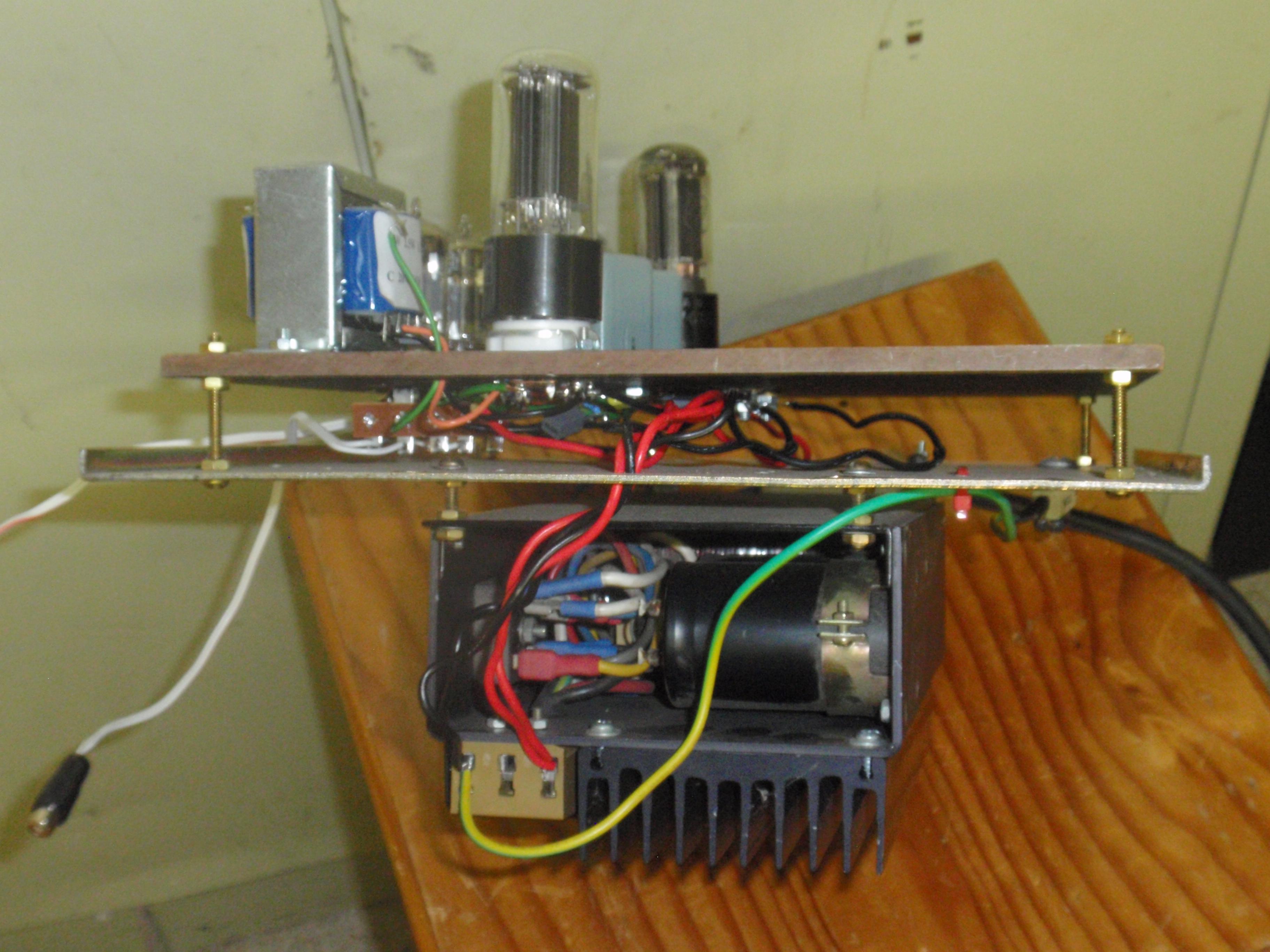

On the left is a 30W horn driver I just hacksawed out of a PA speaker tonight. Have some ideas for what to do with this, most likely to not work.

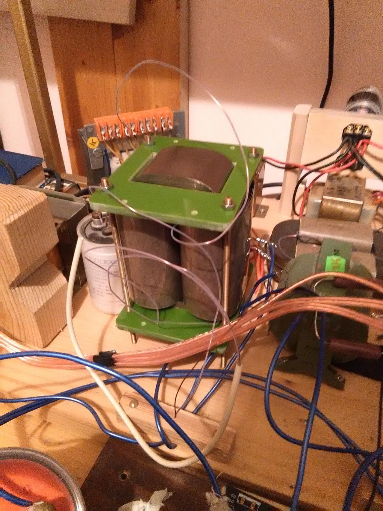

2. Testing an amorphous choke in the DAC power supply

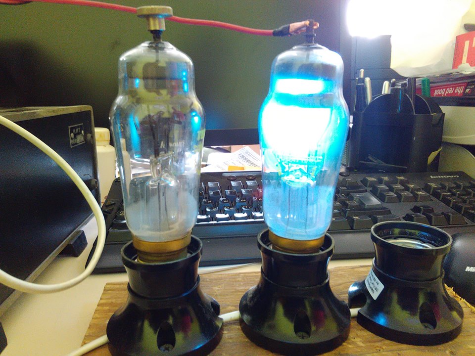

Pics #1 and #2 are of a pair of 823's driven by one of Pete Millett's driver boards. I didn't really have enough power supply to make these tubes sing. They want 1KV+ and I only had 650 Volts.
Pics #3 and #4 are a pair of 4D32's being driven by one of my driver boards. These tubes were operating from 650 volts into a 2500 ohm load, and driven to the edge of clipping. About 250 watts of power resulted. The picture taken in a dark room shown no apparent distress in the tubes despite being pushed well beyond their ratings, but the amp was more efficient into 3300 ohms making about 200 watts.

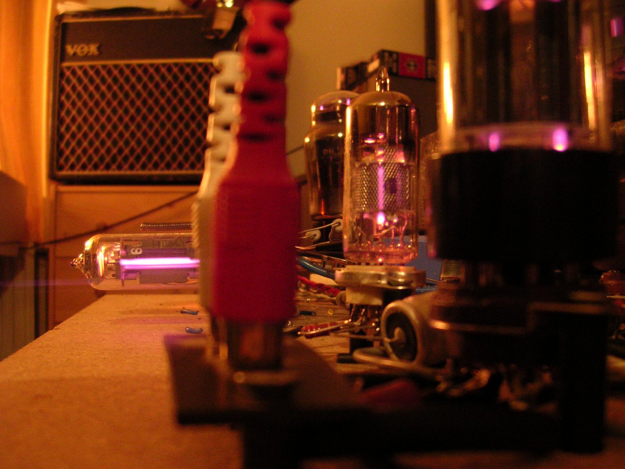

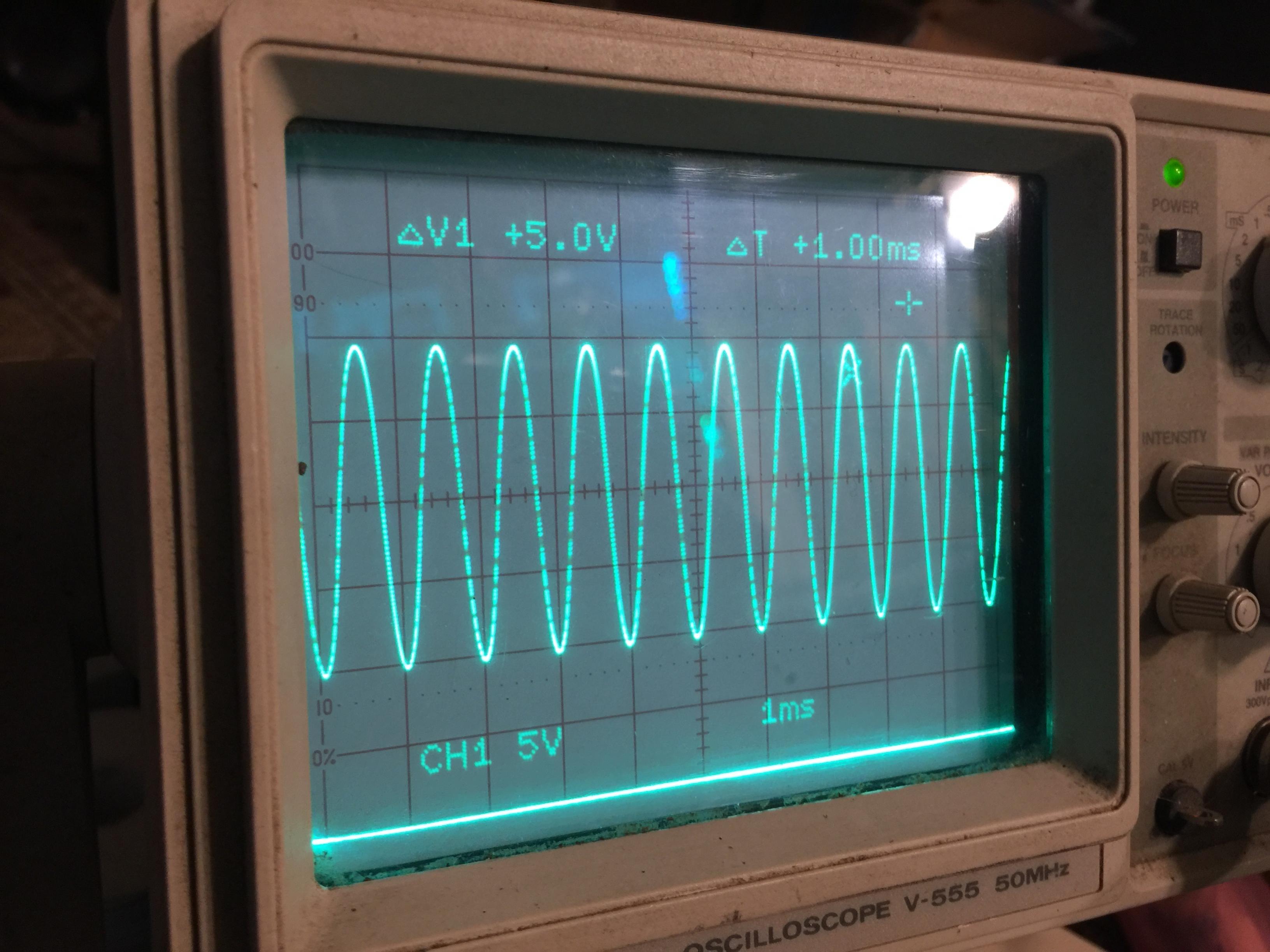

Pic #5 is of a pair of unmarked mystery tubes that I believe were 25L6's driven by the same Tubelab driver board in a configuration called "crazy drive" where both G1 and G2 are driven.
...pair of 823's...
-I haven't eny data for tubes 823 !? Looks like 813 ?
...unmarked mystery tubes that I believe were 25L6's...
-Looks more like 5824?
Indeed 813's. My fingers don't always go where I point them anymore, since the year of pain and numbness I had left it's permanent mark. Really makes playing the guitar a frustrating experience. It also means proofreading everything I type since Microsoft and Google have some strange humor built into their autocorrect algorithm.
The "25L6's" could have been anything really since there were no markings on either tube. They did eat almost 400 volts on the plate and cranked out about 30 watts without complaint.

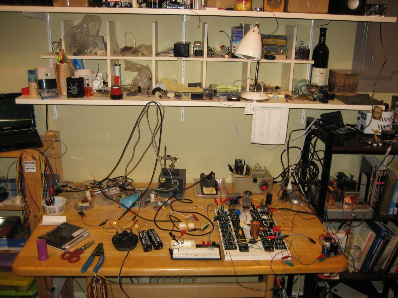

This is fun. Here's a few of my own breadboards, although I've salvaged the output transformers off a couple of 'em. The first two are my CatSkin project, which has been fully described elsewhere in this forum. It's a 10W hybrid SET with OPT secondary side flux cancellation. #3 is Bonseki, a hybrid 20W PP triode design with 38HE7 finals and 6BH11 input section. #4 is Parsimon, an extremely low cost design that gets about 5~6W from a PP pair of 25C5s and a conventional 9GH8 input section. Parsimon uses a $4.99 line matching transformer from MCM as the OPT. The power transistor is part of a screen voltage regulator.
First attempt to build a valve DAC; first attempt that actually produced sound, that is.

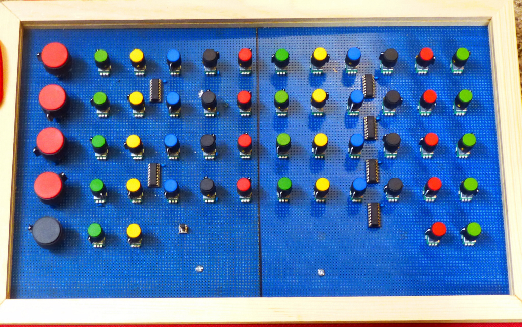

I however could not bring myself to toss those early tone boards that took me so much time to make. (pic# 1) They were all made with RTL logic chips That were taken from scrap boards obtained from the trash dumpster behind the Coulter Diagnostics (blood counters) plant in Miami. RTL logic hasn't been used since the early 70's, having been replaced by DTL, then TTL, then largely by CMOS. Each chip is a single gate or flip flop, so it takes a lot of chips to make something relatively simple.
The green board is my 1971 version of what is now called a "top octave generator" like the Mostek MK50240 chip. The large brown board is top octave generator / frequency divider. The other boards are also tone generators. None of these have seen power in 45+ years, but I plan on powering them up just to see what happens. Each board needs 3.6 volts at several amps.
Fast forward 45 years, and I have started down the road to a big DIY modular synth. As before it will be a mix of analog and digital tech, with the tone generation being mostly digital, and the filtering a mix of digital and analog.

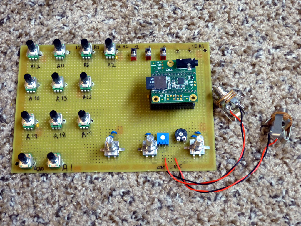

My first new synth breadboard attempt was a little Vector board with some pots, rotary encoders, push buttons, and a Teensy microcontroller with an audio adapter stacked on top of it. The Teensy series are Arduino compatible boards in a small form factor, some with 200+ MHz of 32 bit ARM Cortex power. Pictures #2 and #3
This thing blew me away with it's sound, so I just had to build a bigger one. About this time a newer, faster, and bigger Teensy was announced that I wanted to use, but it wasn't available yet. I decided to put the CPU and audio adapter on one board and the controls on another. This way one could be changed without doing both over again.
The new Teensy's specs weren't final yet, however "compatibility" with the old one was promised, but not totally defined. I decided that I would make a Vector board CPU for the old Teensy that should be compatible with the new one, but be ready to make a second CPU if the compatibility thing didn't work out.

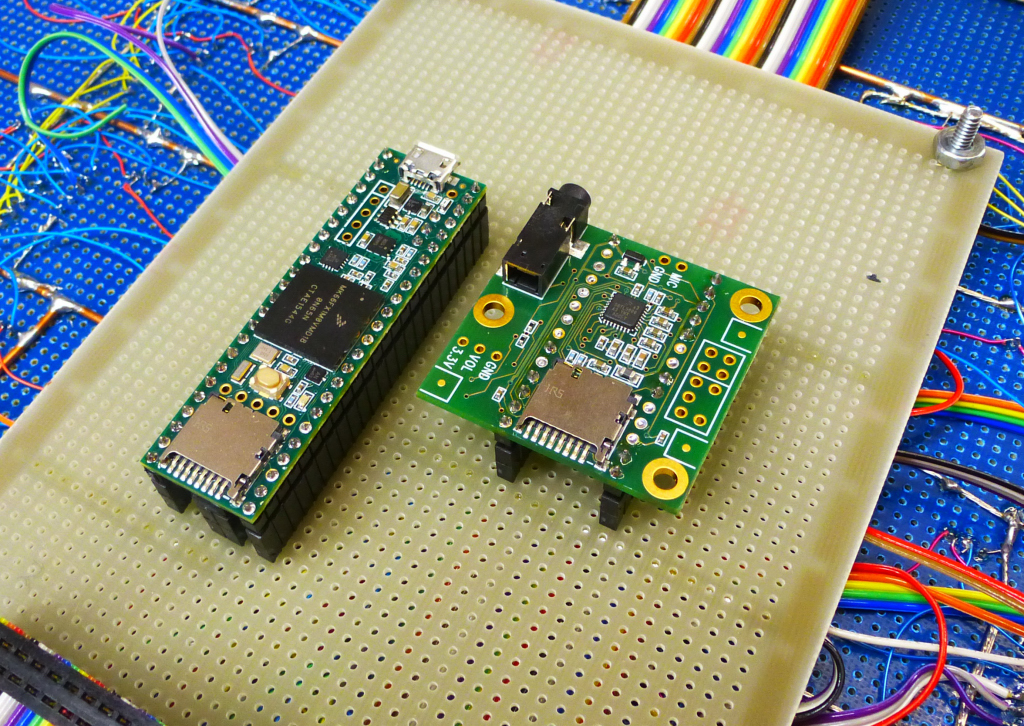

The board here is shown with the old Teensy 3.2 and audio adaptor, same as the last breadboard. Pictures #4 and #5. I could play some sound from this board by loading sketches (Arduino programs) that didn't need controls, so I had some confidence that it would work.

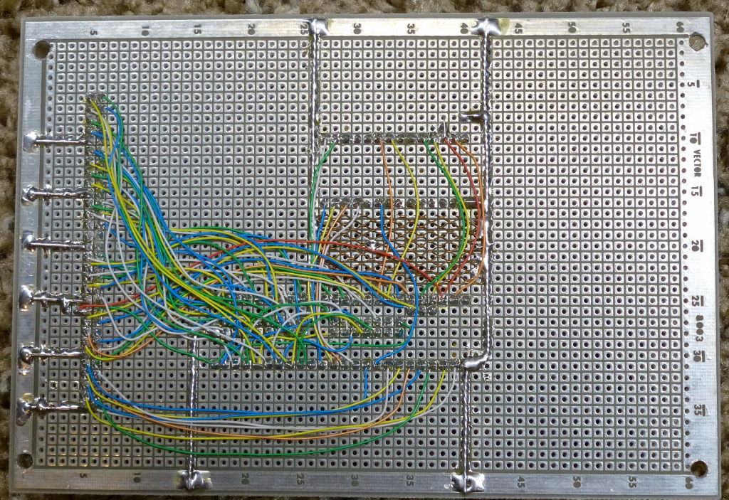

I had the CPU and sound generator, but it couldn't do much without some knobs and a keyboard. I grabbed the biggest piece of perf board that I had (about 8 X 10 inches), slapped on 8 pots and 2 encoders, added a multiplexer chip to connect 8 pots to 1 analog input pin, added a connector to plug in the CPU and fired it up. I rewrote some of the sketches that I used on the original breadboard to work with the new hardware.....and they worked.
Before too long I had added a second piece of 8 X 10 perf board, swapped out the connectors, added many more pots and encoders, and built a simple wood frame to hold it all together. Pics #6 and #7
When the new Teensy 3.6 was available (I got pre production unit #2 via the Kickstarter campaign) I popped it into the board, recompiled the sketches, fixed a few problems and started making some cool sounds. Pic #8
I still haven't conquered MIDI yet, nor do I have a keyboard capable of generating the 1V/Oct control voltage that I need to play it, but an interface is being built to generate the necessary control signals from a standard MIDI keyboard or sequencer.
