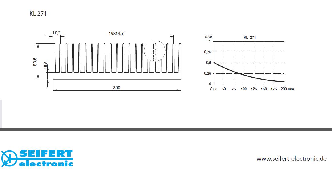

BTW, using the same KL271 on my AJ.
that thermal resistance looks a little optimistic.
you do not get half the thermal resistance with doble hight. you need 4 times the hight to half the thermal resistance. and at what temp are this numbers? 80c above ambient? that is a sink temp of 120-125c. and that you don't want🙂
i moved to A60 thread heat sinking is to offtopic here
http://www.diyaudio.com/forums/pass...ed-guide-aleph-60-builders-5.html#post3663368
ticktock. whats the hight of your sinks? and what is the sink temp on your aleph J?
150 height x 300 mm long, 85 mm deep. Still don't have IR thermo yet, but I can touch it.
From what I remember K/W is about 0.12 or so. This seems to to correlate with the above graph.

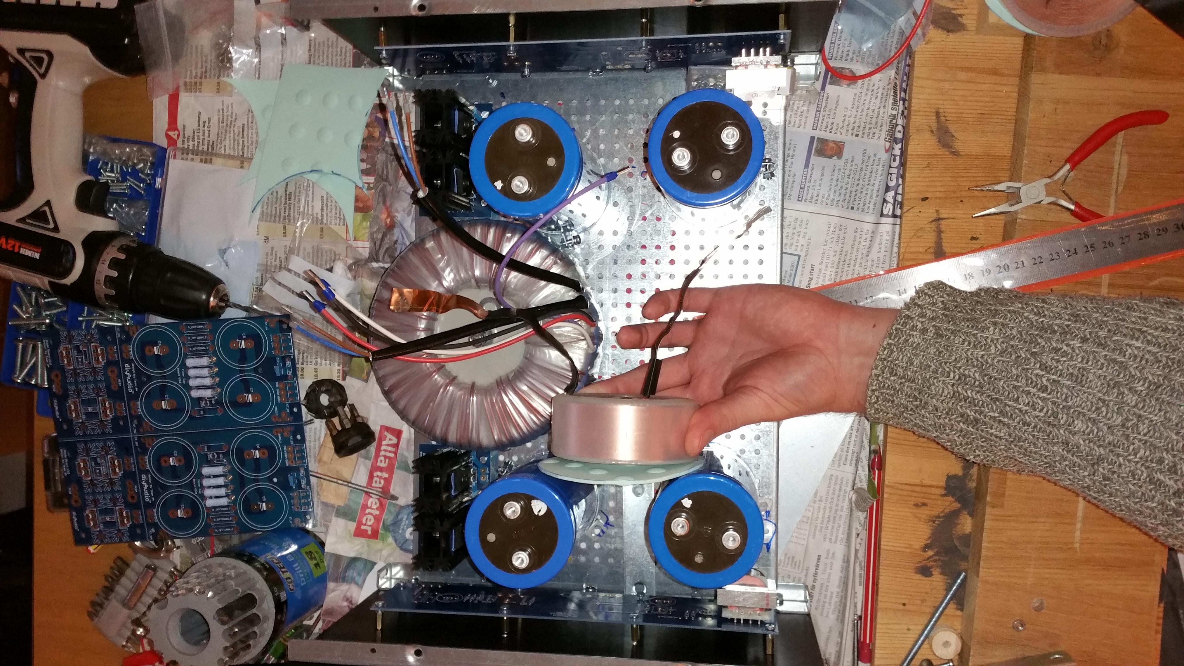

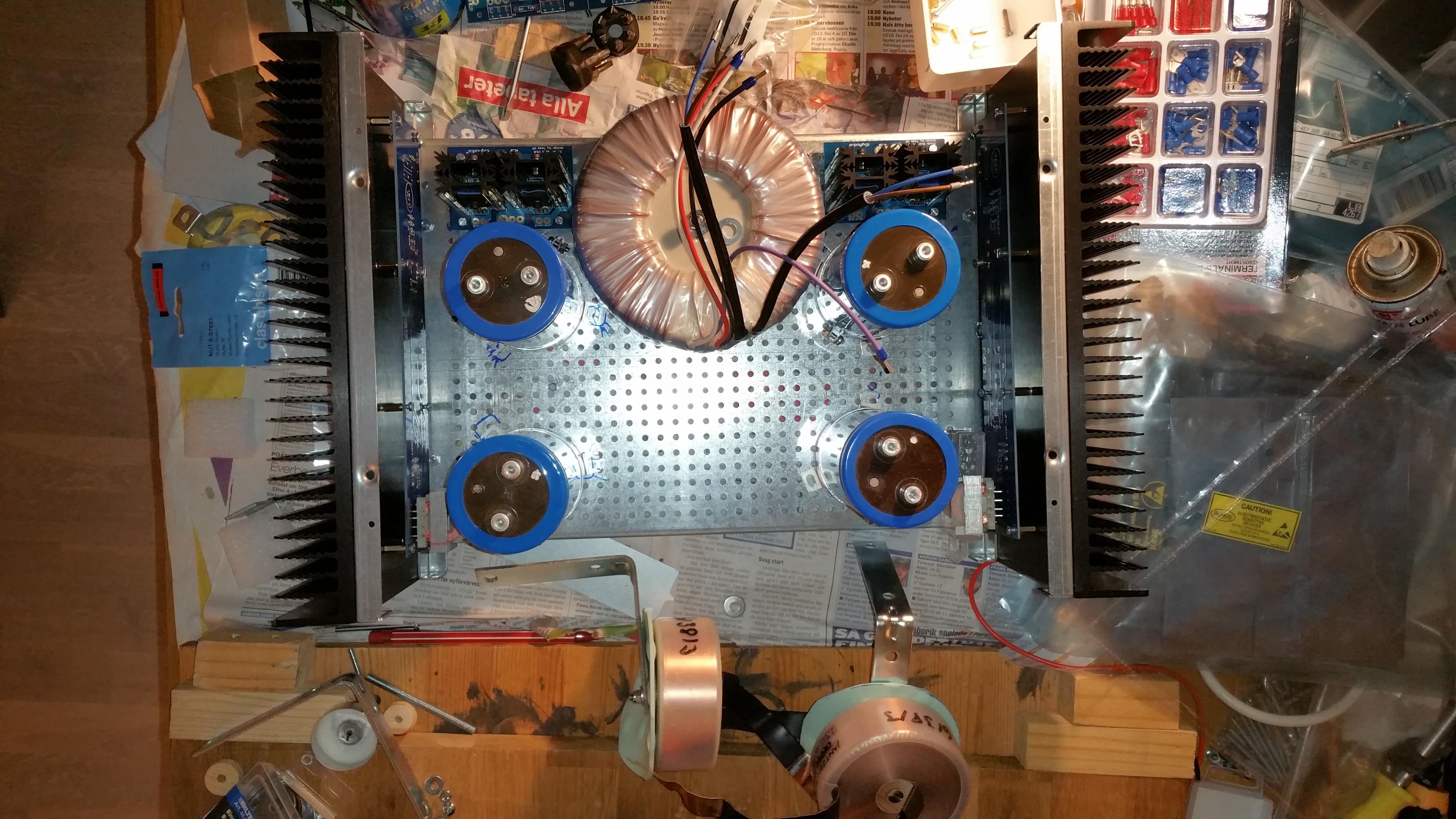

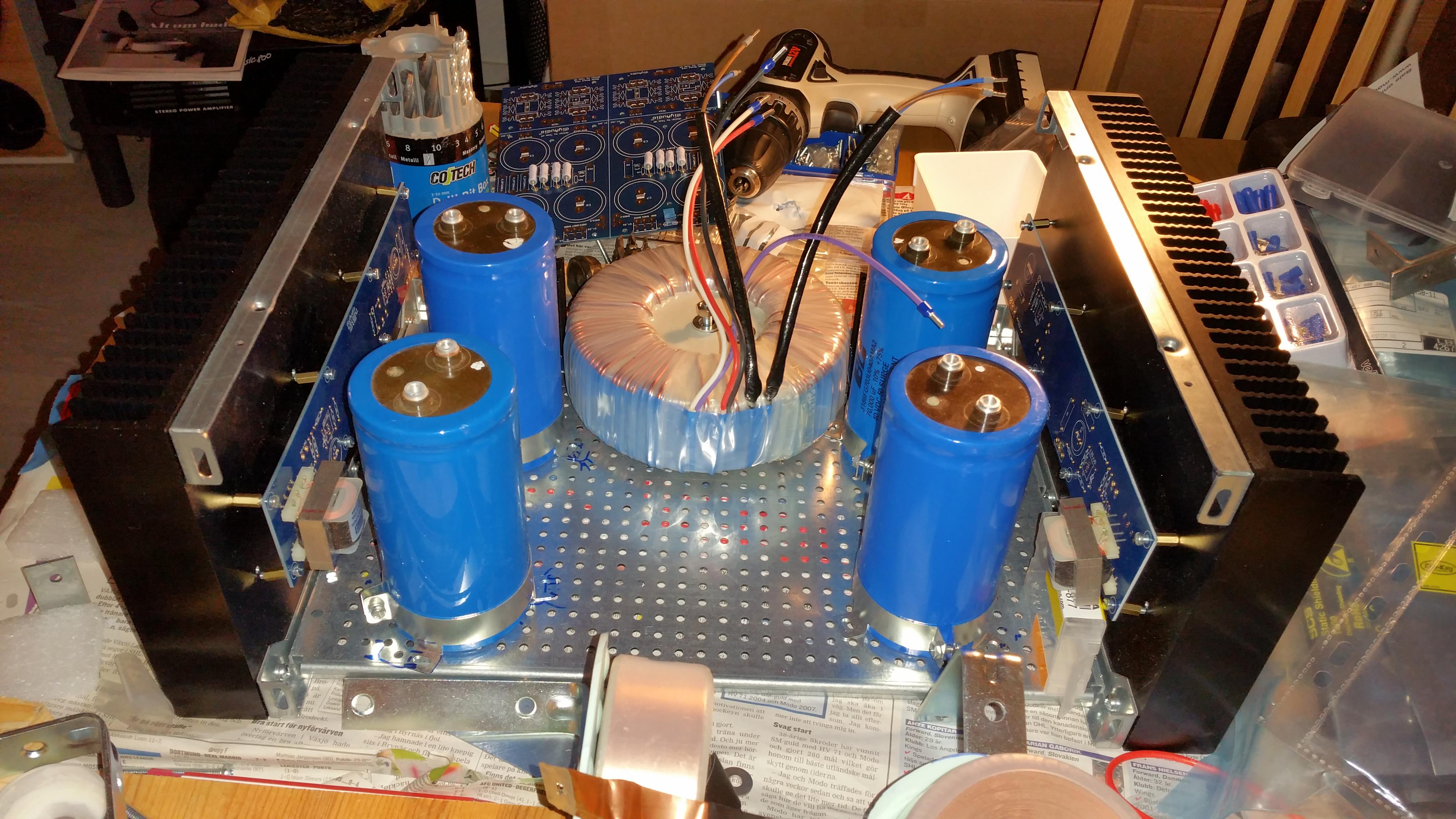

I am building a Firstwatt F6 with a CLC. There are so many things to consider, and so tight space. This is how far I have come in a few weeks. 70.0000uF - 2.7mH 0.45 ohm air coil 70.000uF, bypassed by 10uF film cap on each side. The amp is stereo, not mono, and I am basically replacing the reisistors in a diyaudio universal psu board with the coils. How am I supposed to mount them, with regards to power trafo, F6 audio transformer and each other ( the coils)?
have you any choice?
I would try to squeeze Donut vertically , behind front panel ....... if height of case permit
then chokes (lil' Donuts) laying between caps
I can fit it but the Sedelbauer power trafo would pressed against the lid making a small bump in the lid. It is quite huge. Can the hamburger sized coils (not a donut fan) be placed vertically between the blue caps, facing each other with a 5 cm distance from each other? They would be 0.5cm away from the power trafo, which is a BIT CLOSE. Distance to audio trafo would be 9cm which is nice.
Imagine the right coil. I needed my other hand to take the picture.
I am thinking I want to keep them away from the audio trafos on the F6 boards. You can see them in the lower corner.
