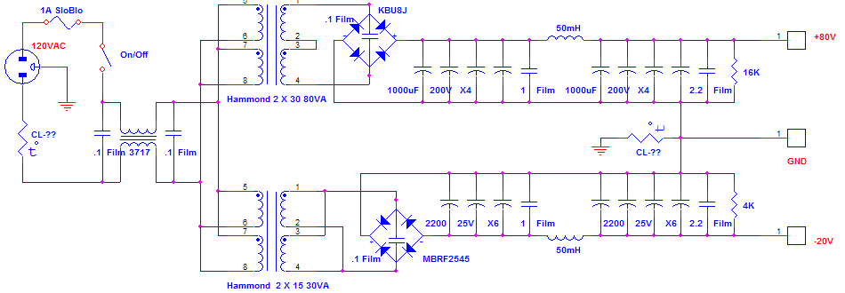

Stefanoo said:
thanks a lot for the suggestion Mr Pass.
I was using the following topology CLCLCRCC with R=3.3ohm.
So i'll try to lower this value 😎
I would like to ask you guys, this things:
Since i was suggested that a regulated power supply is, in general if well done, better for a preamplifier
in case, would it be convenient to put the stab stage after clc... section or before?
To me, it lools more convenient t oput it after.
Do you guys have any suggestion on a good topology to implement to stabilyze the rail voltage (without using LM or any chip)?
The rail voltage that i should have is about 60V (the supply for the P1.7).
What ripple value can be considered to be VERY good?
Thanks a lot in advantage.
Best,
Stefano.
now read just two words:
SHUNT REG
few tips:
use CCS in front of shunt element
burn minimum same amount of current in reg -as load is
use minimum capacitance you can after reg
use one reg per stage
for preamp - if you make decent reg ( shunt or series,your choice) ripple value is already negligible , so why bother with numbers.......

pardon me for saying this, but as a powersupply for a P1.7 your schematic is silly.
Why? do yu see any evident mistake? or you are just saying that because you think it's too exagerated for the P1.7?
I'ts quite a bit exagerated to use your own words.....just use the egulator from the BOSOZ article and be done with it.

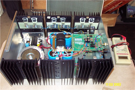

Well 😀 I have a P1.7 type variation that Iv'e been rebuilding into a nicer package... I'm still working on my silly supply too, but it's almost done 😀 I don't use a regulator on the -20V rail but it has good filtering ("a bit exagerated" maybe). It also is connected to a current source wich will reject the supply noise further. I'm thinking of trying to build a regulator using an LU1014D on each positive rail though. Haven't seen anyone doing one of those yet??? I don't use the upper current sources like the 1.7. My circuit draws about 100mA per channel.
I have included a pic.. As you see it here, I can't measure any ripple with my scope on the 80V rail, (20mV/Div), (too small?). Using the DVM set to AC Volts it bounces around 1-5mV? I didn't actually have final grounding connected during those measurements...
