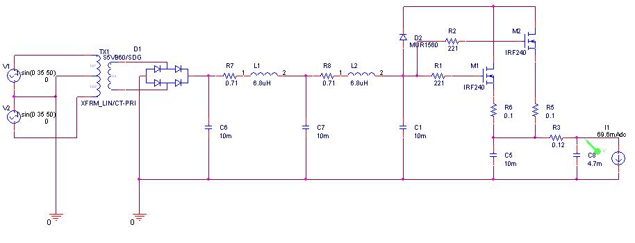

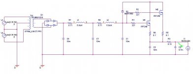

i would like to have guys your opinion on this power supply design.
It's for the Aleph P1.7.
Since the preamplifier absorbes a constant current (correct me if i'm wrong) of about 69mA, i place the constant current source as load.
If i'm mistaken, plese correct me.
Here's the schematic

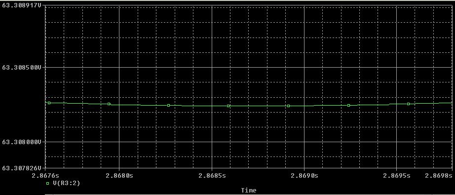

here a screenshoot of the regulation capability of this circuit.
I simulated it with a good resolution (5usec as maximum step size).
The rail voltage for the P1.7 is supposed to be 60V.
As you can see with this specific it's 63V.
This is because i picked out the Plitron transformer attached on the link
http://www.plitron.com/shopping/shopexd.asp?id=170
I would you use two of them for the two channels. (i still have to figure out a way to get them without paying this high shipping expences).

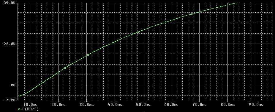

this is a zoom of the initial part.
There is a negative peak.
Could it contituite a problem? how is it possible to eliminate, in case?
Here's the screenshoot.
Thanks in advance for your kind advice guys.
