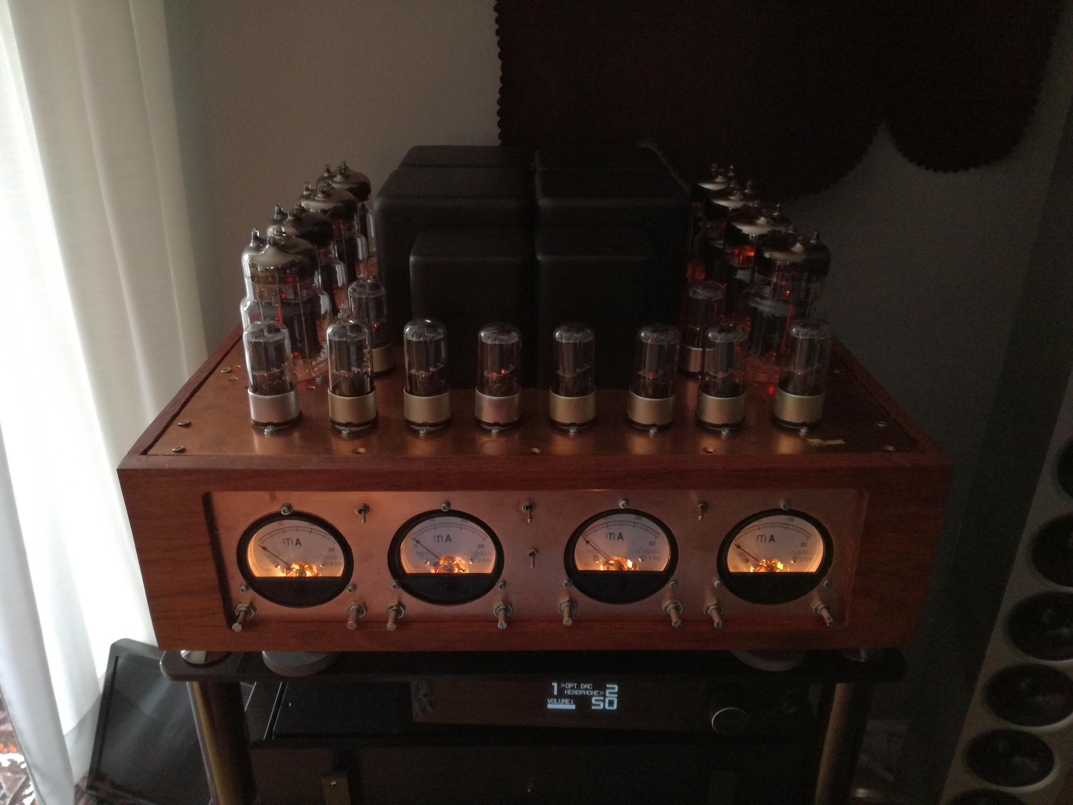

@drteming, Nice build. Interesting ground wire. How does it sound? HeyBill

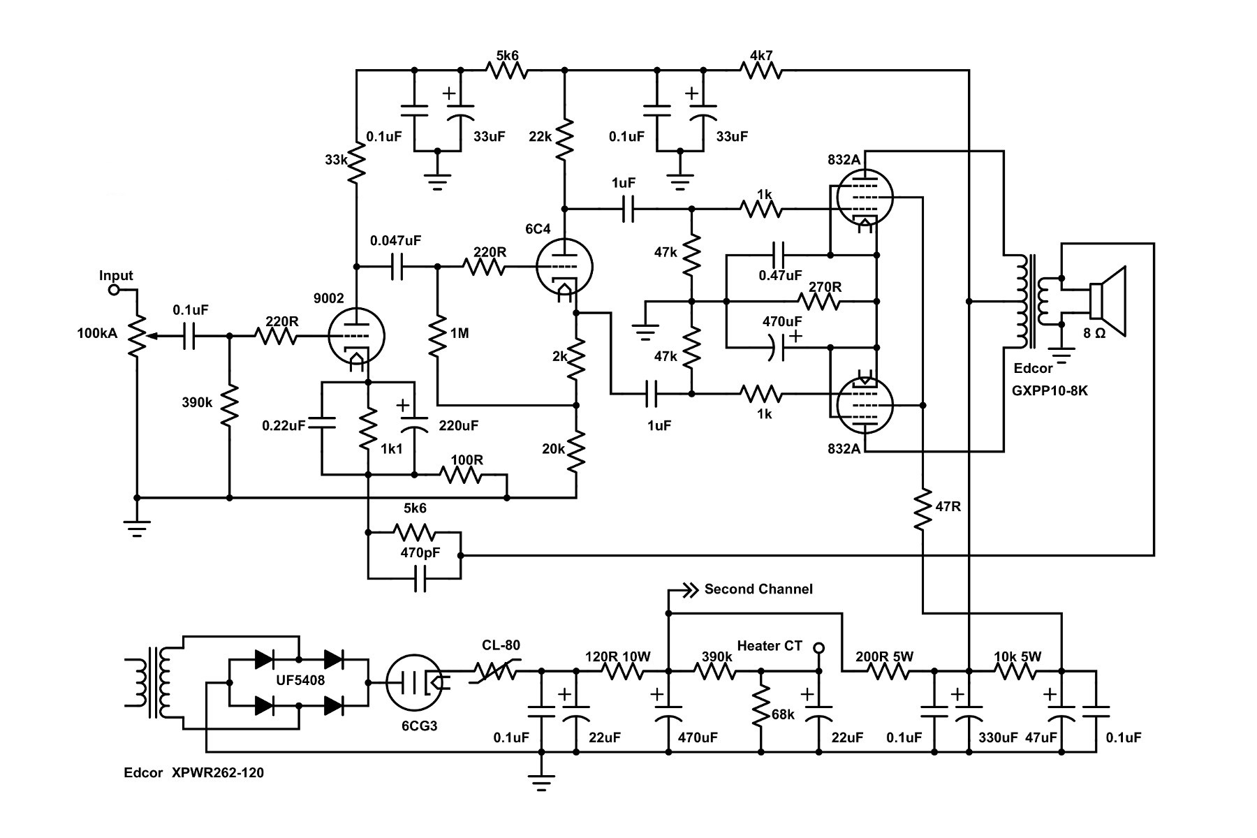

Thanks for the kind words. This is my first push-pull "hi-fi" build. The amp sounds...fun. I just have a smidge of NFB (-1.3dB, seriously, why bother), that I tuned by ear with a 10k pot. I'm sure the THD is through the roof, but it sounds nice and warm. It has a lot nicer bottom end than I thought possible with the dinky Edcor output transformers. My audio snob buddy was shocked by the sound stage, but he poo-pooed the top end clarity. I though it was pretty good. Then again, he's the dude who sprang for an "audiophile power cable".
The amp is dead quiet at idle, but there's a very slight mechanical buzz from the output transformer. I think I need to tighten the bolts on the bell housing.
The damper diode is there to drop some volts and to provide a slow startup. Plus it increased the tube count. More tubes=more better, right? I also got 2 of them for 99 cents, so that may have something to do with it.
Oh yeah, schematic:
@drteming: That is super-cool! I admire amps built using quasi-obscure (read "non-audiophile") RF-types. What did you use for the top cap insulators? I feel like I ought to be able to recognize them, but I don't. They look as if they're made of some sort of unglazed ceramic.
Yep, those are unglazed ceramic caps. I got them off eBay. Just search 832 anode cap.

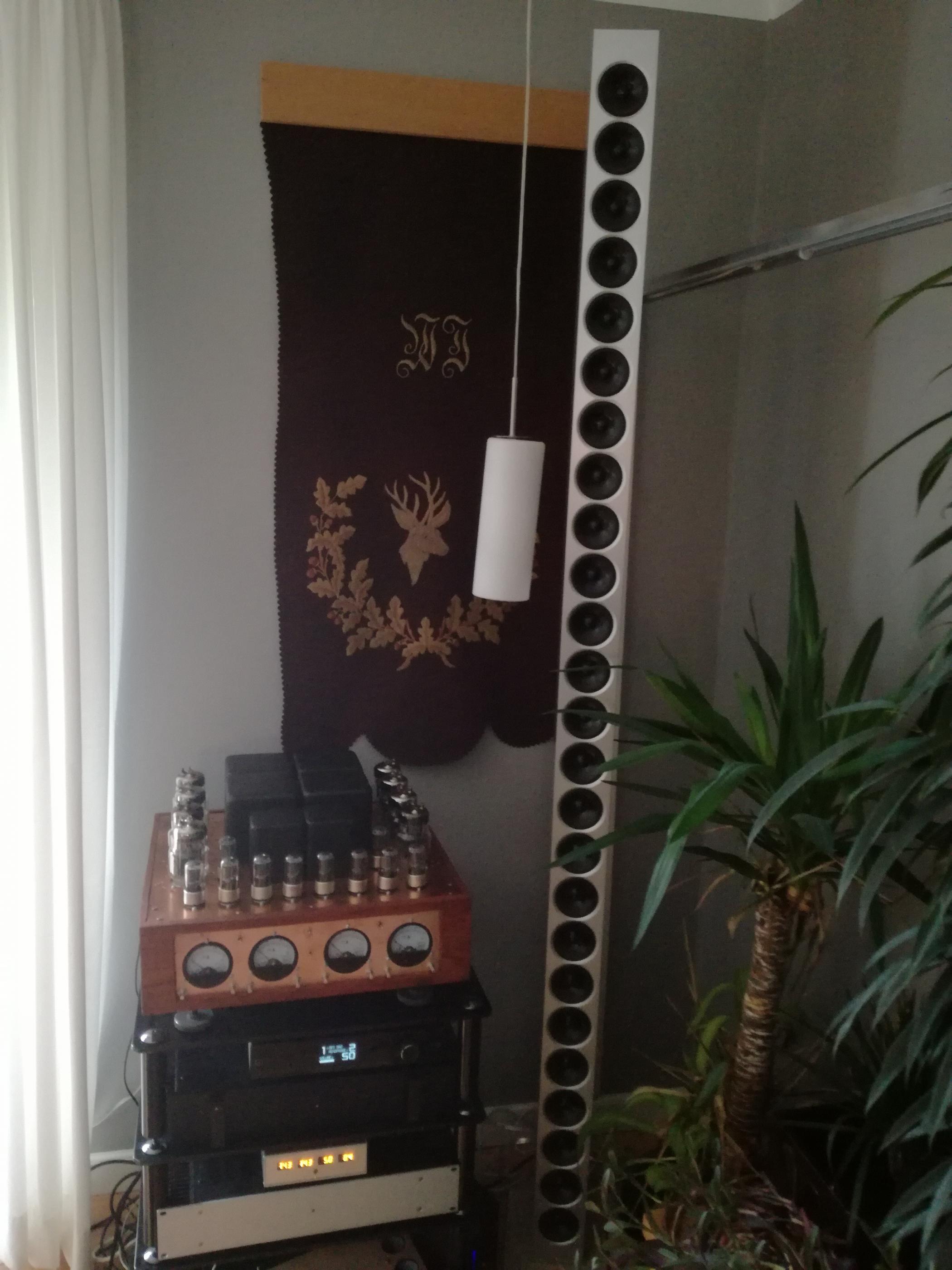

Here it is next to the speakers it is driving.....
Egads, that's some extreme kit. BIG amp, BIG speakers (OK, big as in tall...) Always wanted to try a line array - one day! Nice gear.
Thanks. You wont regret trying line arrays. You will regret you didn't do it before.........😀
how did you construct the speakers?
Hello, wonderful setup! I have built a 2x 6C33 Circlotron driving horn speakers (over low-impedance output transformers, so its not OTL), but I'm sympathizing since years with constructing such a speaker column, too. How did you build it? Would you share some more details with me?
Do you drive them in OTL mode?

I drive them in OTL mode. No iron in sight. Only a LOT of iron in the PS 😱
Here is a link where you can see how I made my Line Arrays.
Stupid Cheap Line Array
And here a guy that partly got inspired form my build:
The making of: The Two Towers (a 25 driver Full Range line array)

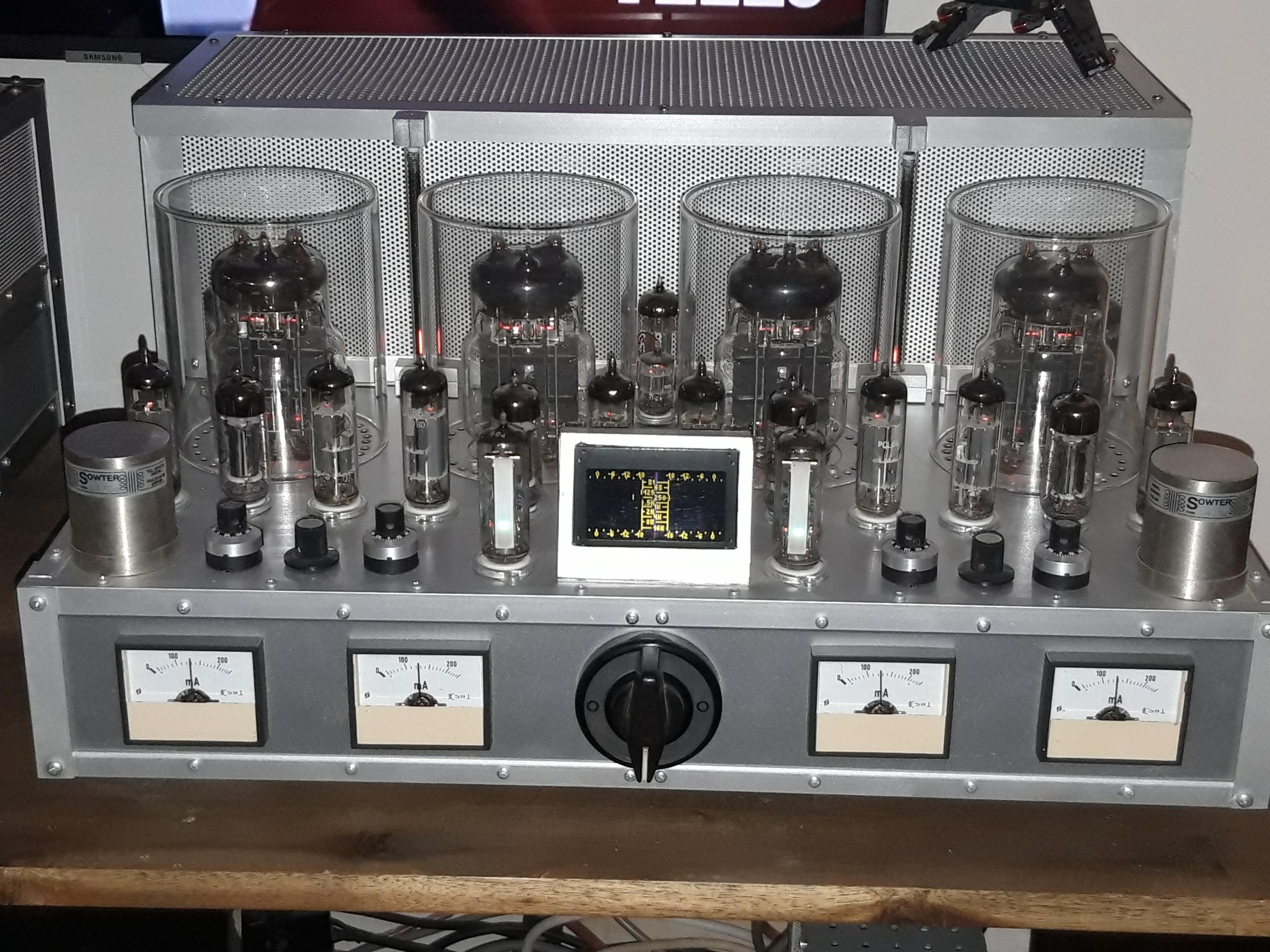

Where did you get those glass protection things? I'm wondering if they help cool the tube due to a chimney effect or that they heat them up more due to catching radiant heat and hot air?

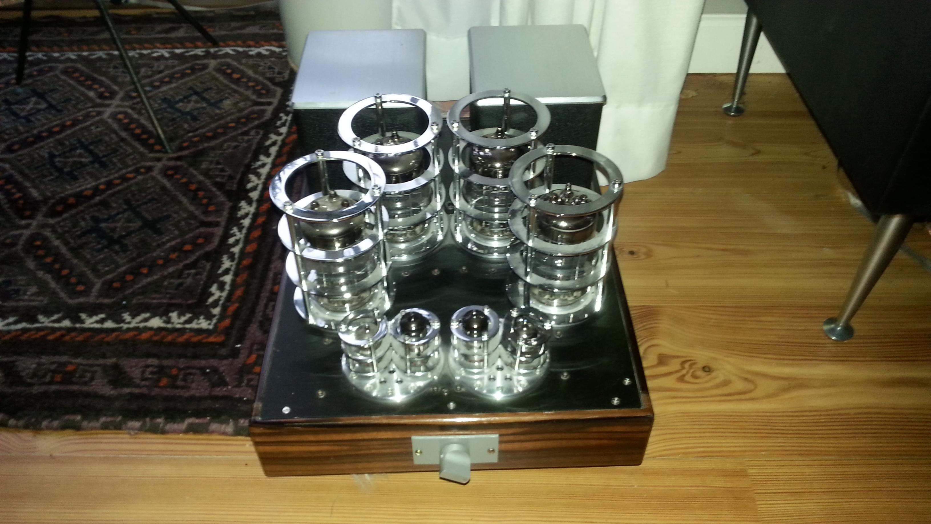

Nice amp koldby. I am also using 4x6C33 OTL monos. Love the sound. Mine is Transcendent design. No doubt similar.This a 4x 6C33 OTL circlotron. 2X 60 Watts conservatively rated. Idels at about 700 Watts......
Hello Gideon,
I buy them from a factory in Germany (Glasbläserei Stauber, Passau, Bavaria), they offer a broad range of these glass cylinders. Sadly, the site is in German only:
Glasblaserei Armin Stauber - Glaszylinder klar aus hitzebestandigem Borosilikatglas 3.3
My amp has an active cooling using a slow running fan (120mm 12V fan running at about 8V) in the bottom plate of the main chassis, and the air is blown out over the power tubes - their sockets sit about 5mm below the chassis, with a ring of additional holes around each tube. The boron silicate glass of the cooling chimneys absorbs very well the immense infrared radiation of the tubes, so the heat stays within the chimney, is almost completely carried away by the airflow and does not heat up the surroundings. So the amp remains very cool at all times. To fix the cylinders, I drilled small holes into them (diamond head) and fixed them with small wire hooks at the chassis.
best, Uli
