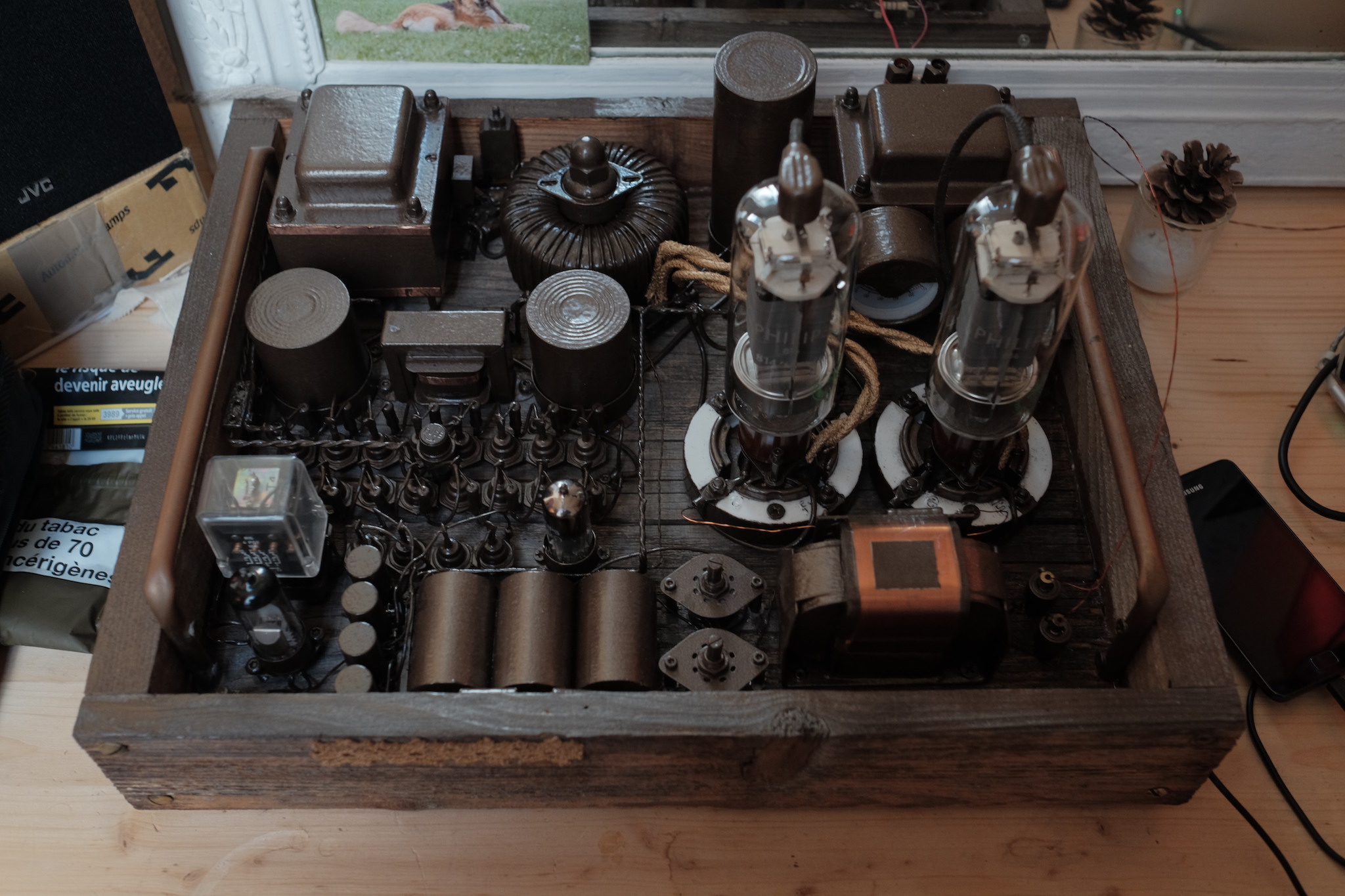

Thank you for your kind words..
Far from perfect but ok for me, no spray, only a small pencil and hammerite paint.
It takes some time..
Bridge rectifier made with 16 x D302 Ge diodes and balancing resistors.
The venerable EF80 is wired as a diode between wiper and ground of negative supply. At switch on 814's current is about 14mA then 56mA after EF80 conduction.

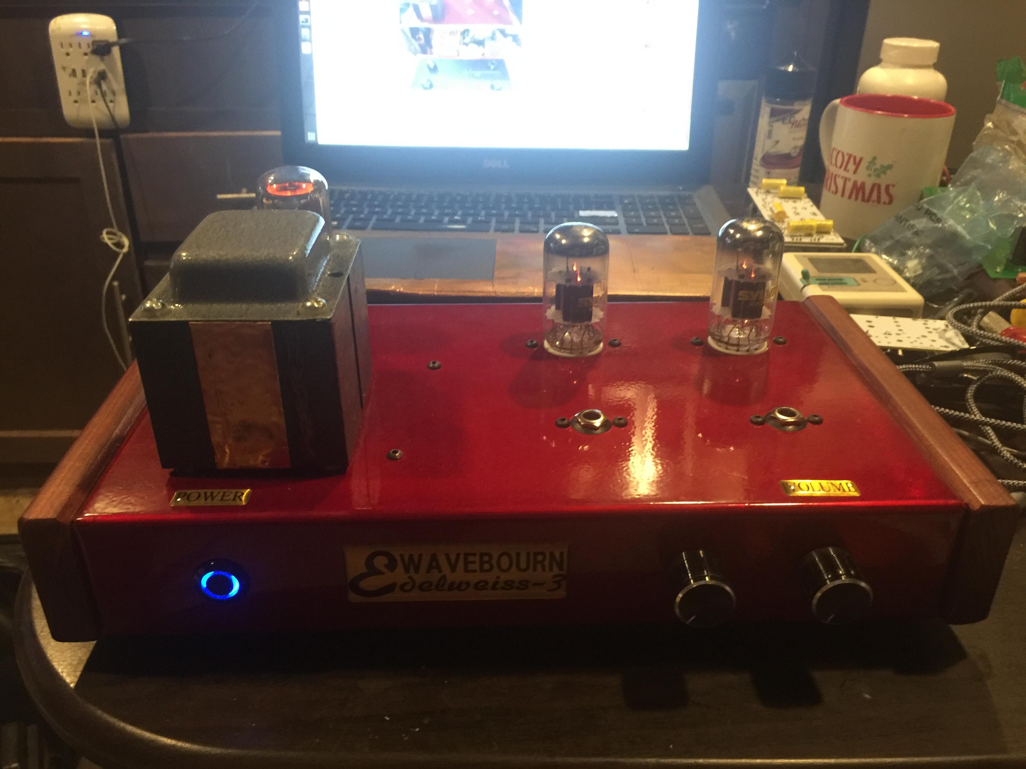

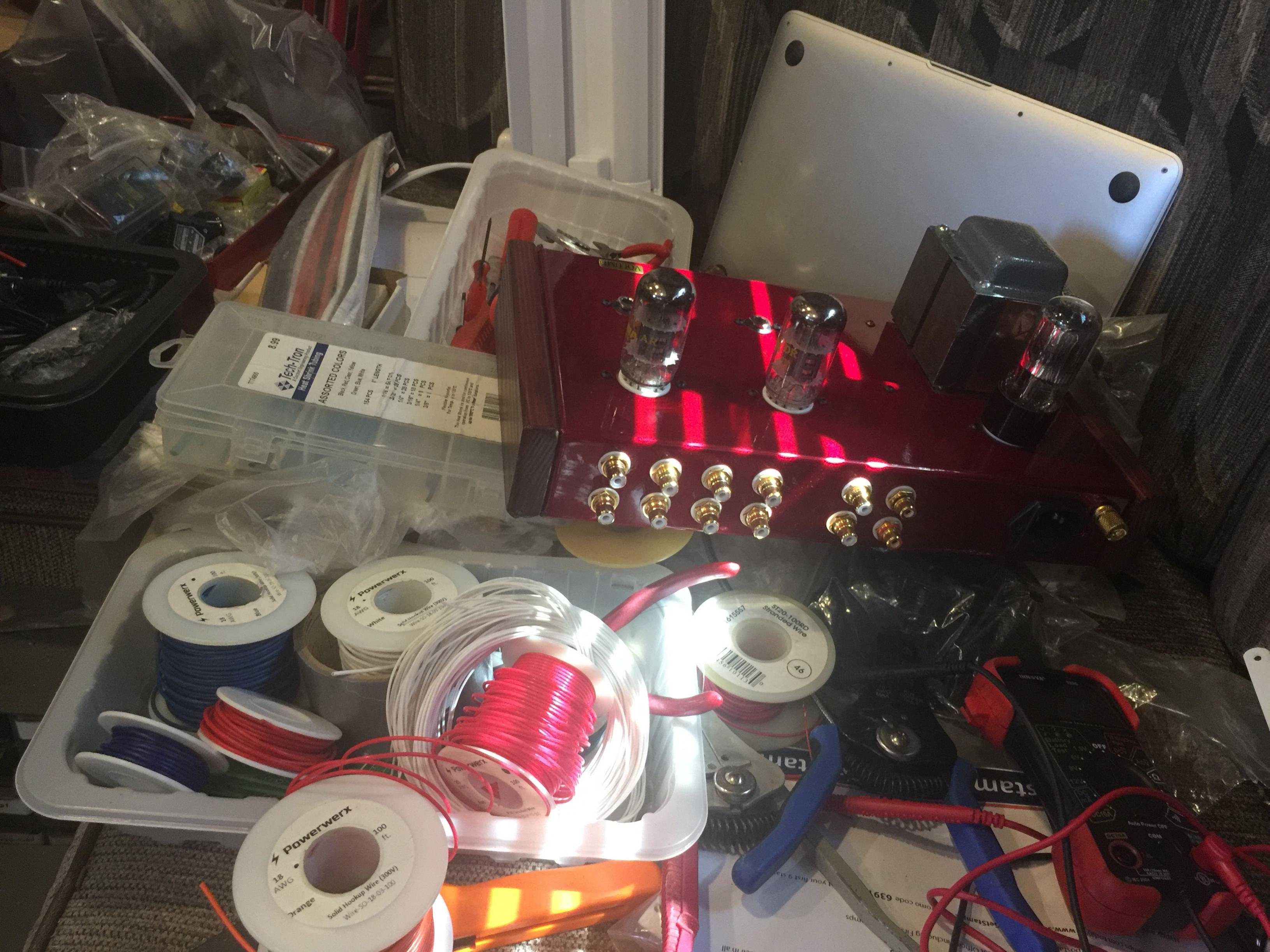

Finishing assembly of the first pre-production Preamp+ in my trailer. I still have few available layers of space to keep parts and tools. 😀
Well; it looks like everything is properly connected now. Let's power it on and check that no magic smoke escapes. You know that electronic devices stop working if the magic smoke escapes from them, right?
Yes. In Canada, some forms of magic smoke are legal. ��
Well; it did not escape. 🙂
Like the color! I also use this red color for my preamps!

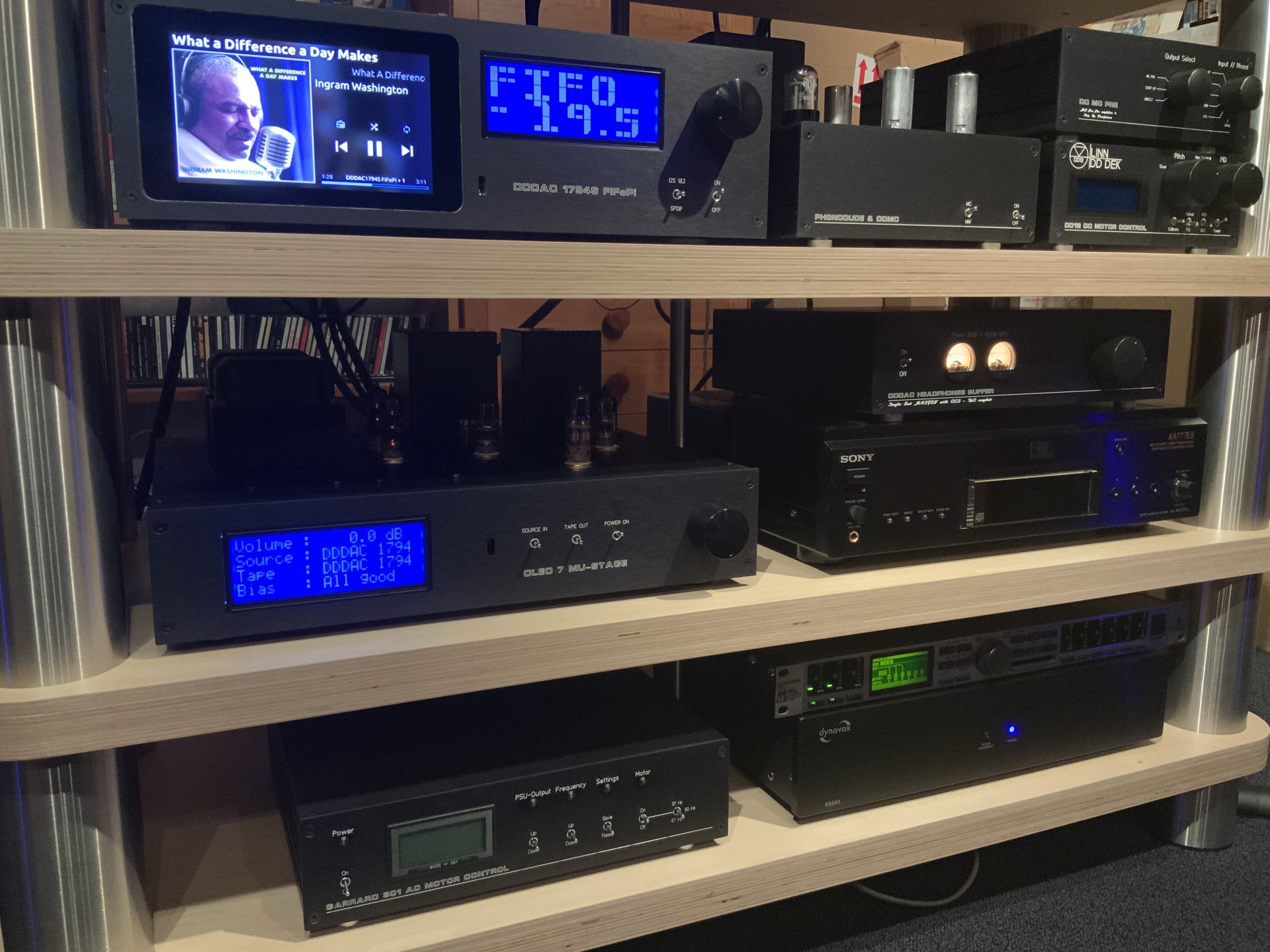

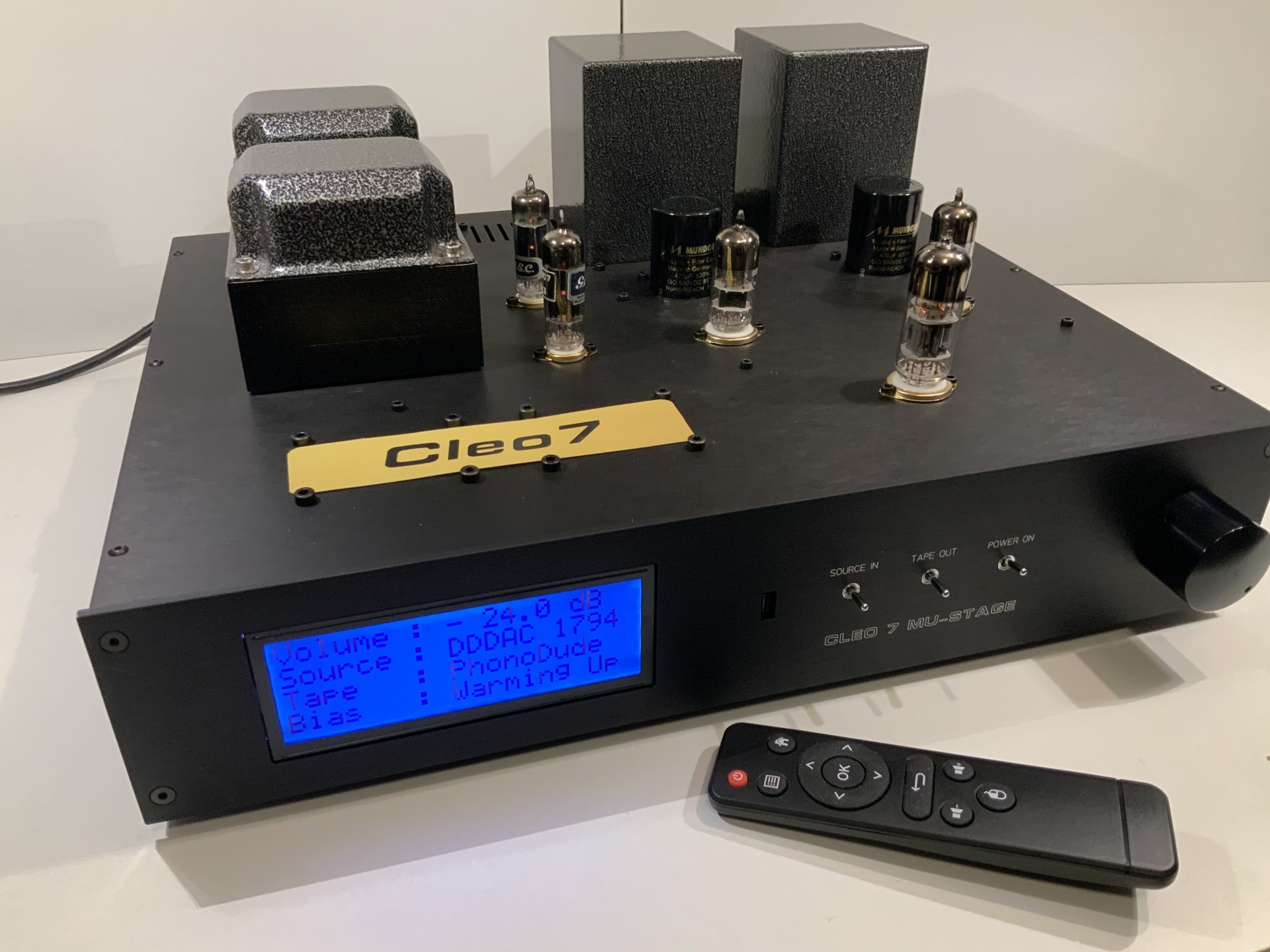

Cleo 7
I just finished my 6N30P MU-Stage pre amplifier. It is called the Cleo 7 (for those who remember the tube amps from Triodedick 😉 )
This version has an Arduino controlled GPIO, bias checking and Volume Control on board. Front panel and IR remote driven.
here you can read all about it including circuits, pictures, measurements and Arduino Code
Check my blog website on the Cleo 7
next project is true Tape playback Head amplifier based on Mu-Follower 🙂
