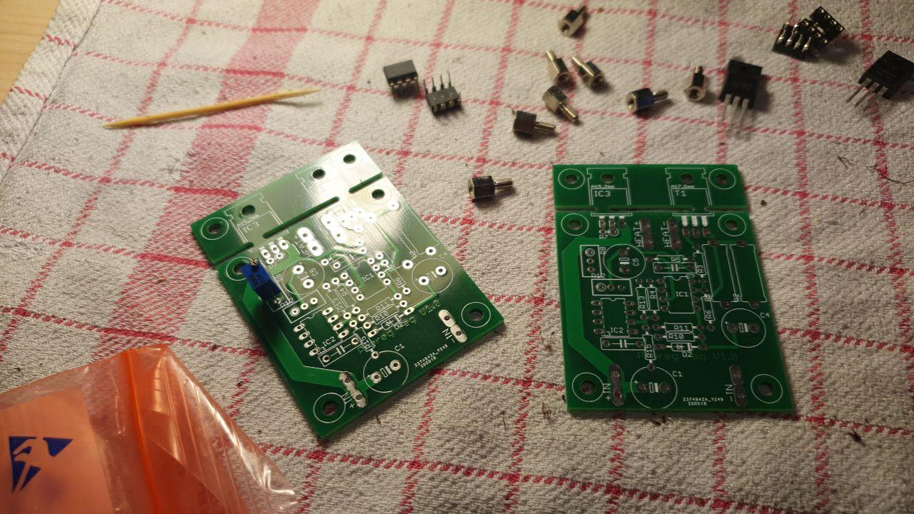

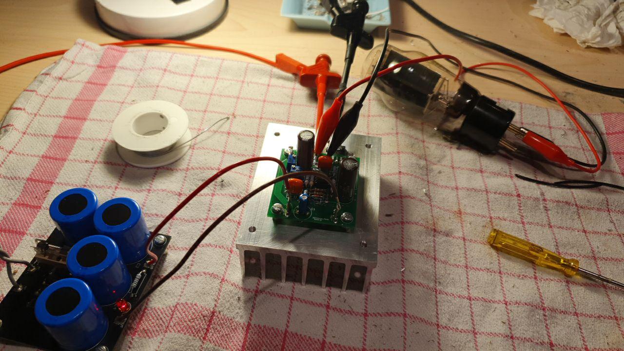

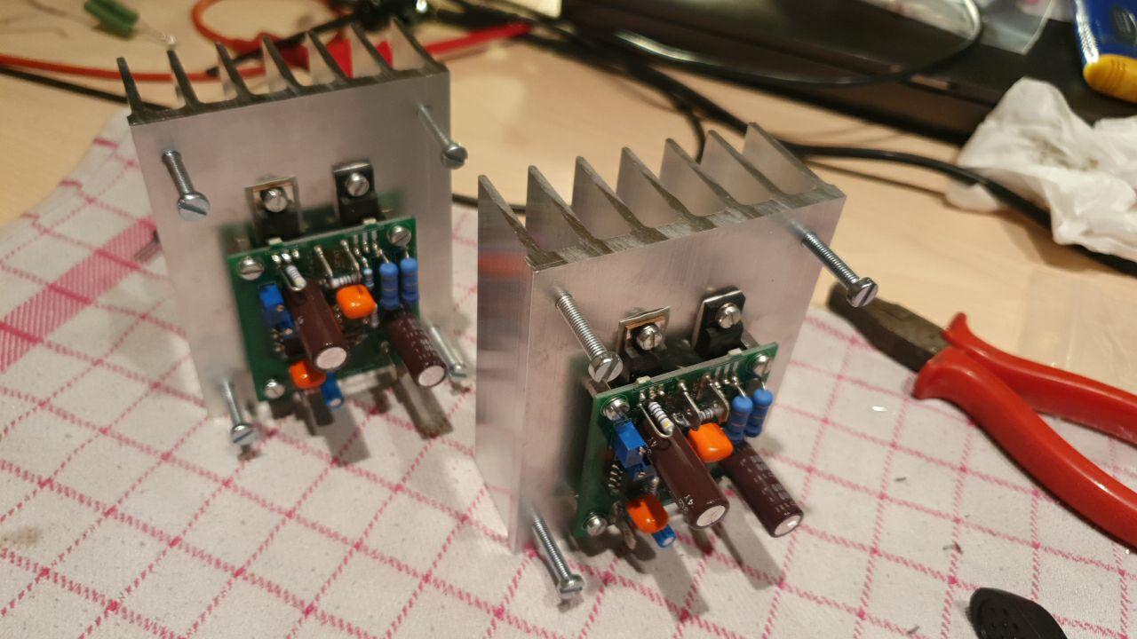

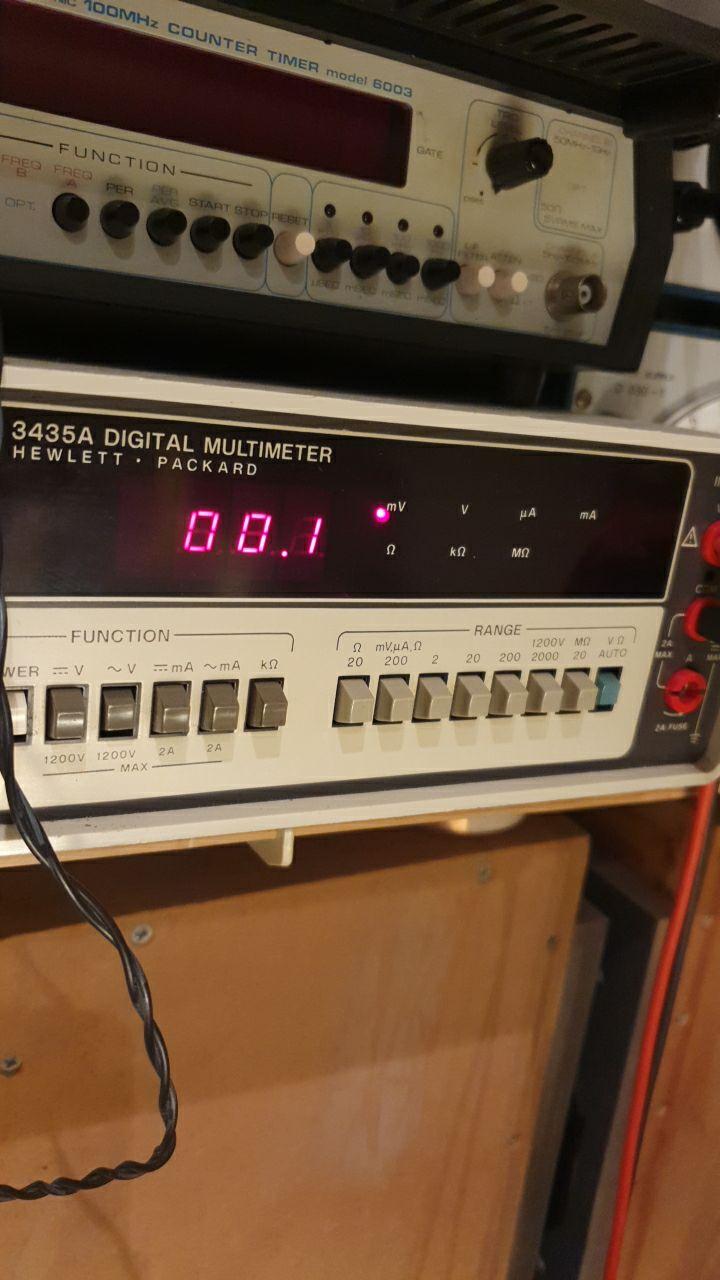

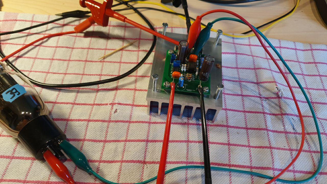

Not an amp however tube related.
These are pics from a friend of mine that builds a lot with my PCB's.
These are little regulator boards for the heaters of directly heated tubes, he is rather pleased with them.

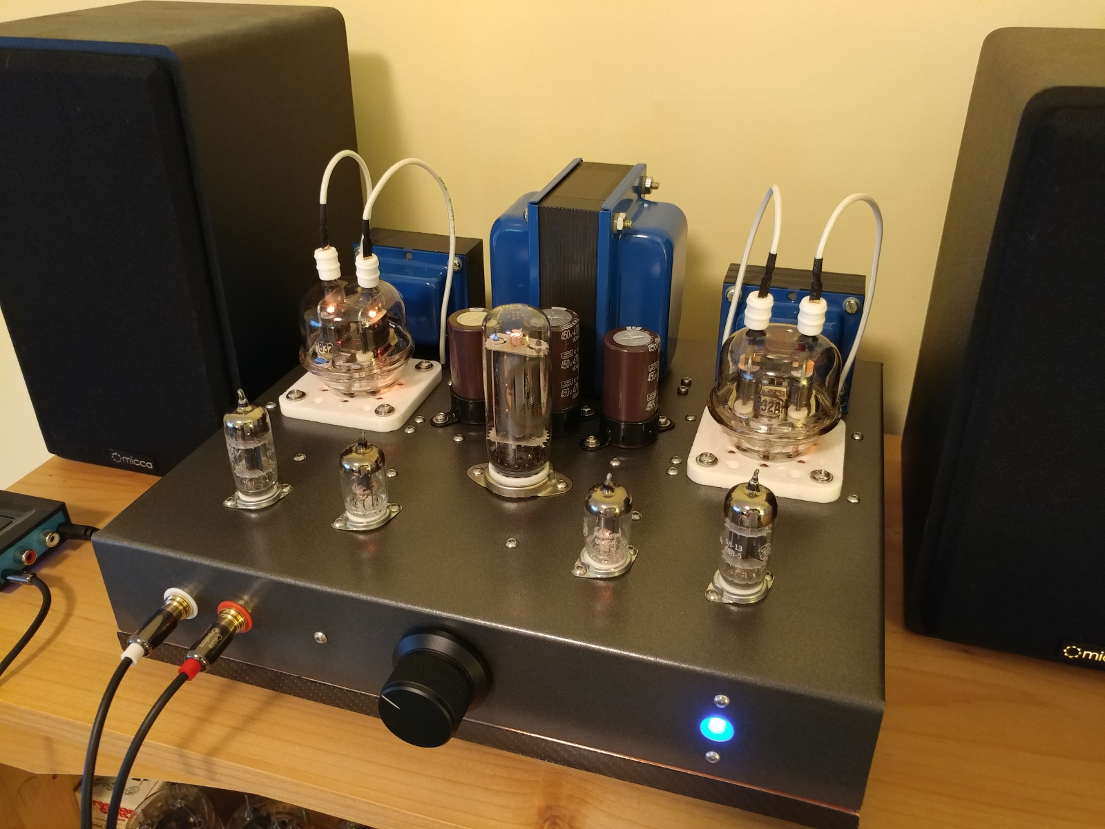

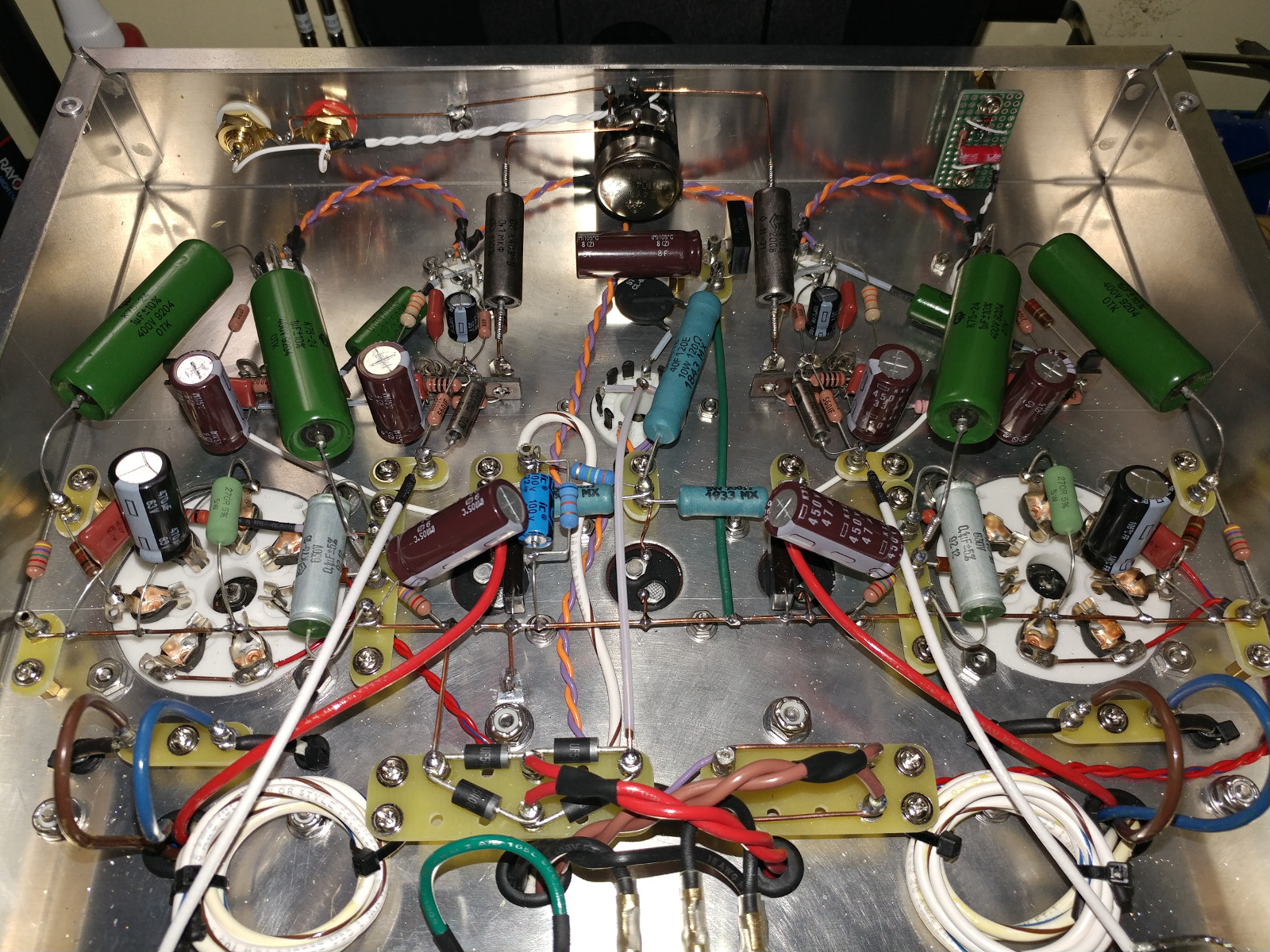

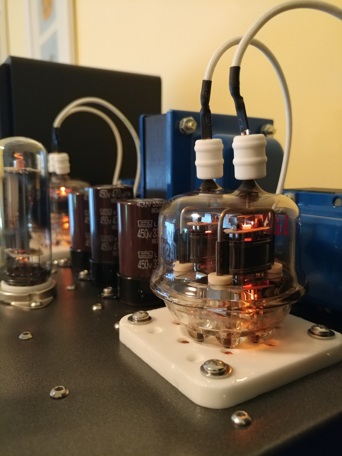

drteming,
What a beautiful amp!
Is that a Damper Diode there to give Slow B+ startup?
(Soft Start?)
