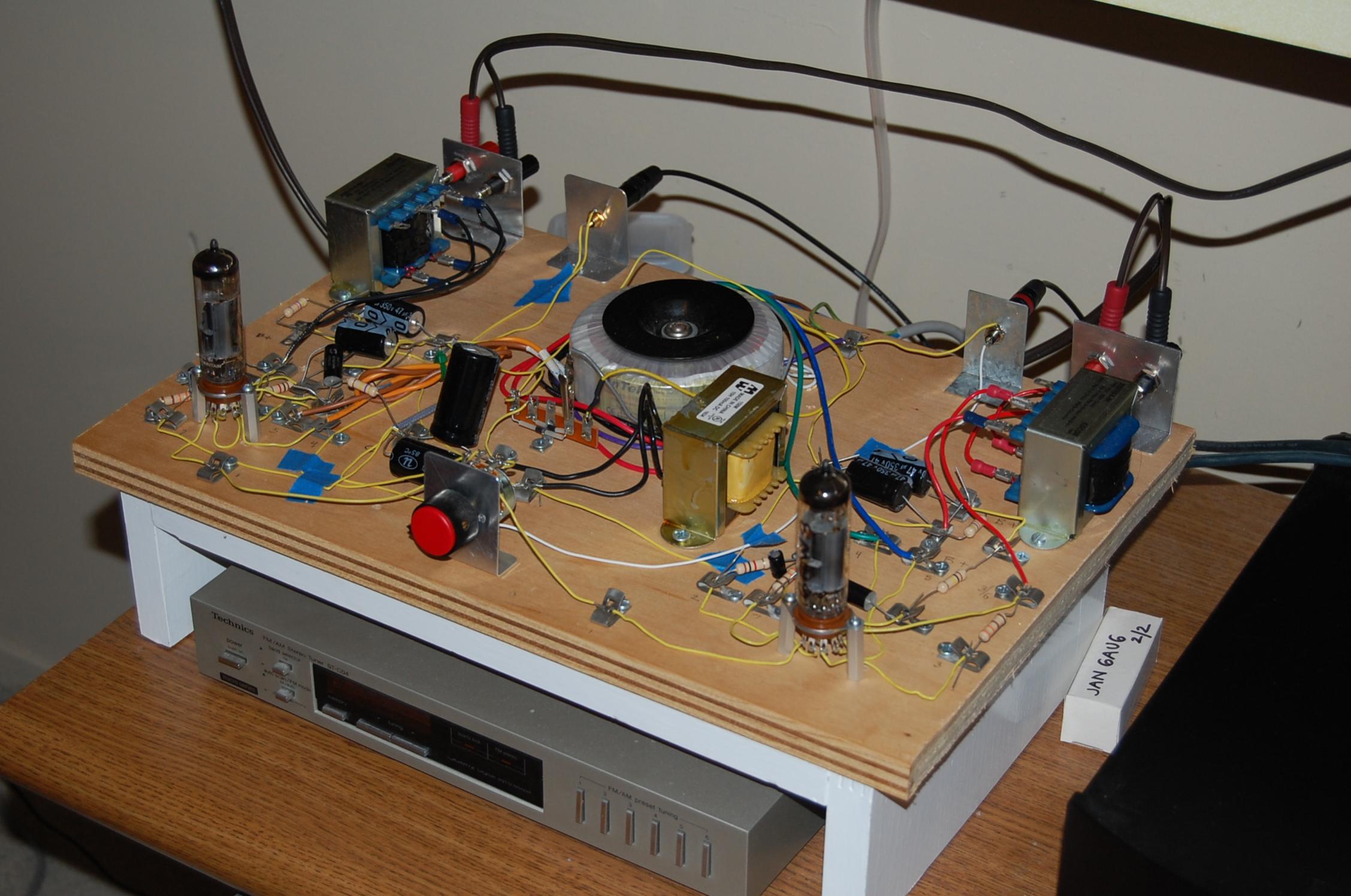

Single ended 6GW8 amplifier breadboard using on hand parts on a piece of wood. The amp produces a very forward sound.

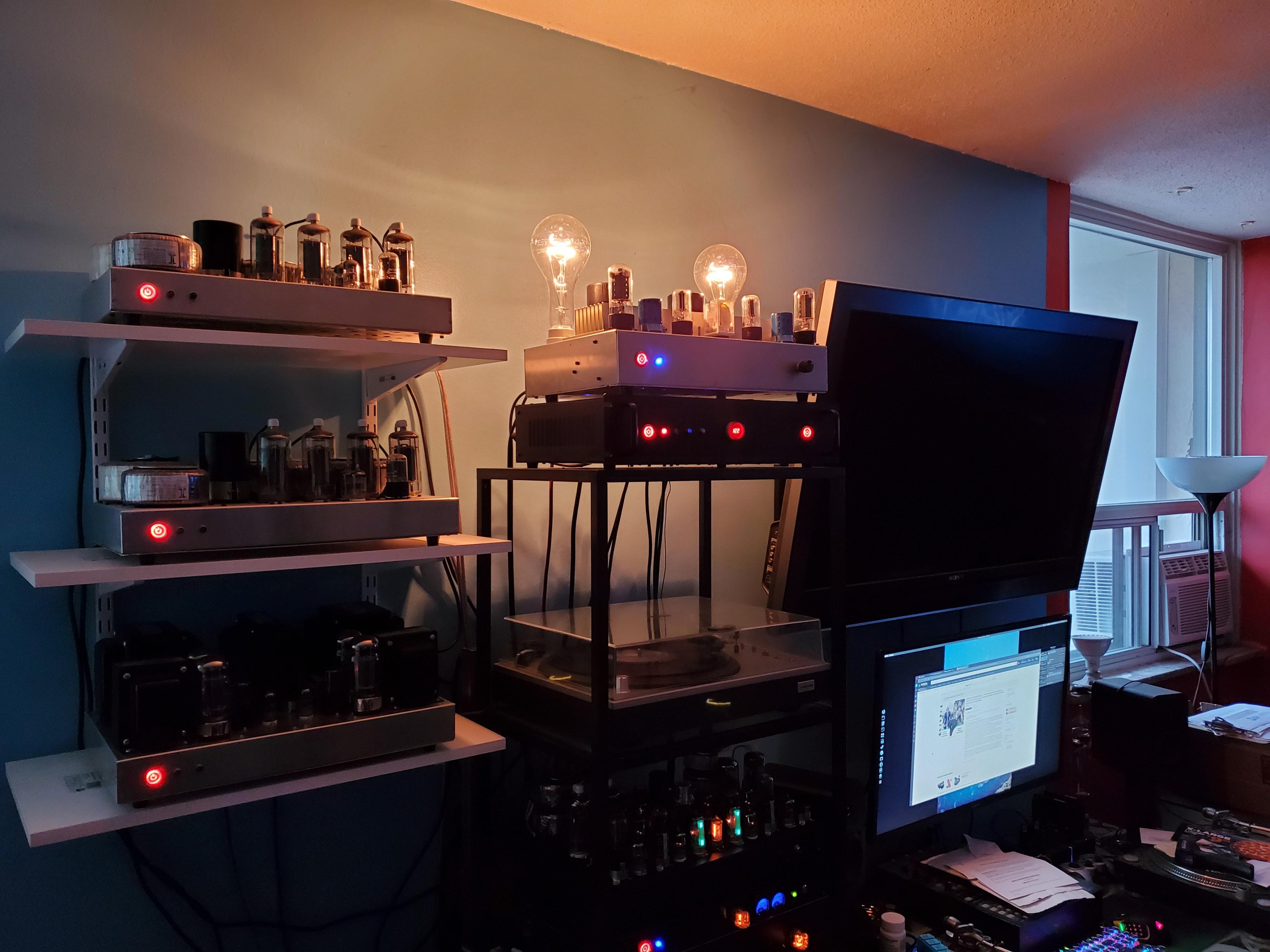

I changed the bulbs for the (rare now - 100km trip to buy the last three of them) proper 120V 300W Sylvania ones... Now listening to an old Elton John record.

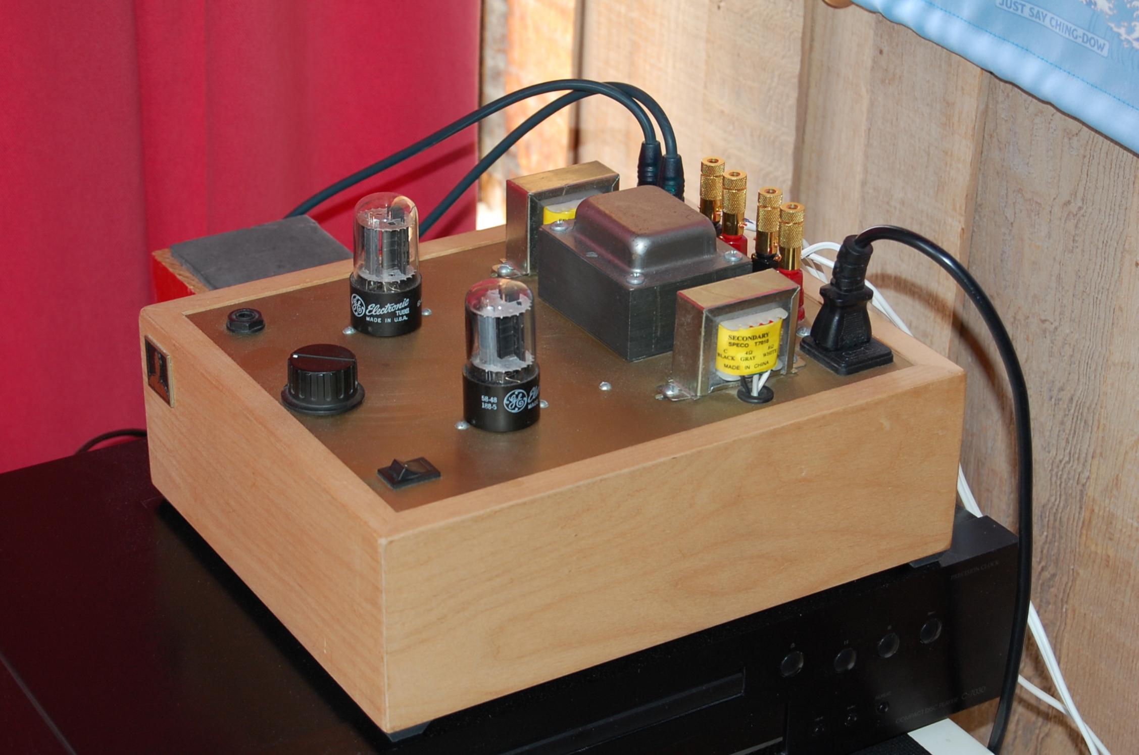

Nikon f, what do you think of your SEX 2.0 having lived with it for a couple of years? For a time I was tempted to build one, then the DRD 45, then I spun out into the deep end of the home built amp pool where I both swim and sink depending on the day 🤗
I love the SEX amp, in fact I also have the 2.1 version. Both have upgraded caps, the 2.1 has the C4S board. The amps have a neutral sound to them, I use them as both with headphones and speakers. Two watts powers my ADS L470/2, Allison CD6 and Fostex FE103en bass reflex speakers. Check out the Bottlehead web site for more info and opinion of others. My amps have been in Burning Amp, meets, and headphone shows for over twelve years and they always put a smile on everyone face. If you lived closer I would invite you over to head them.
Thanks Nikon f, it’s encouraging to hear someone so pleased. I’ll investigate the circuit ��

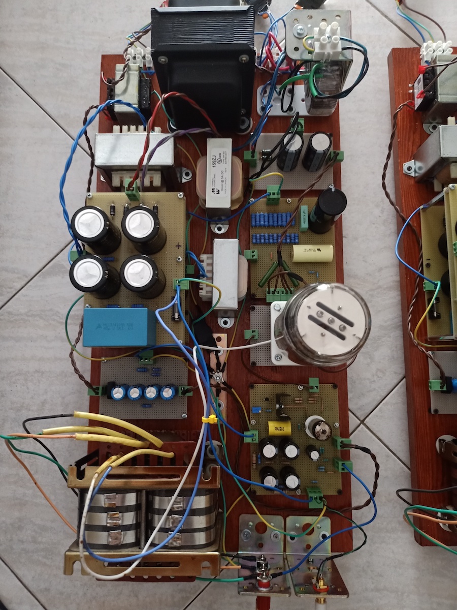

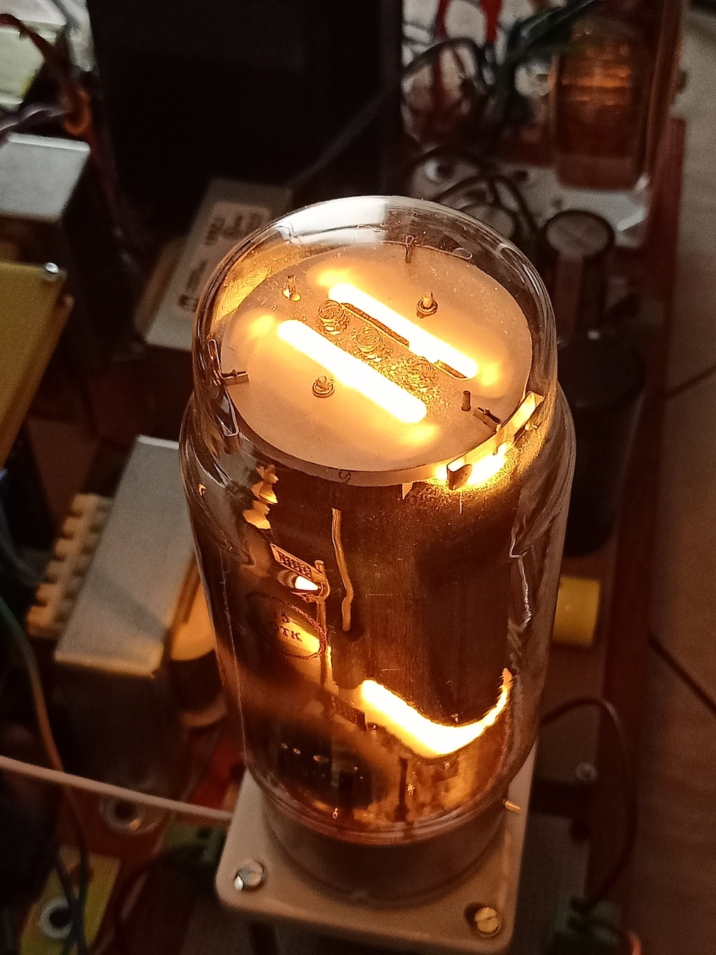

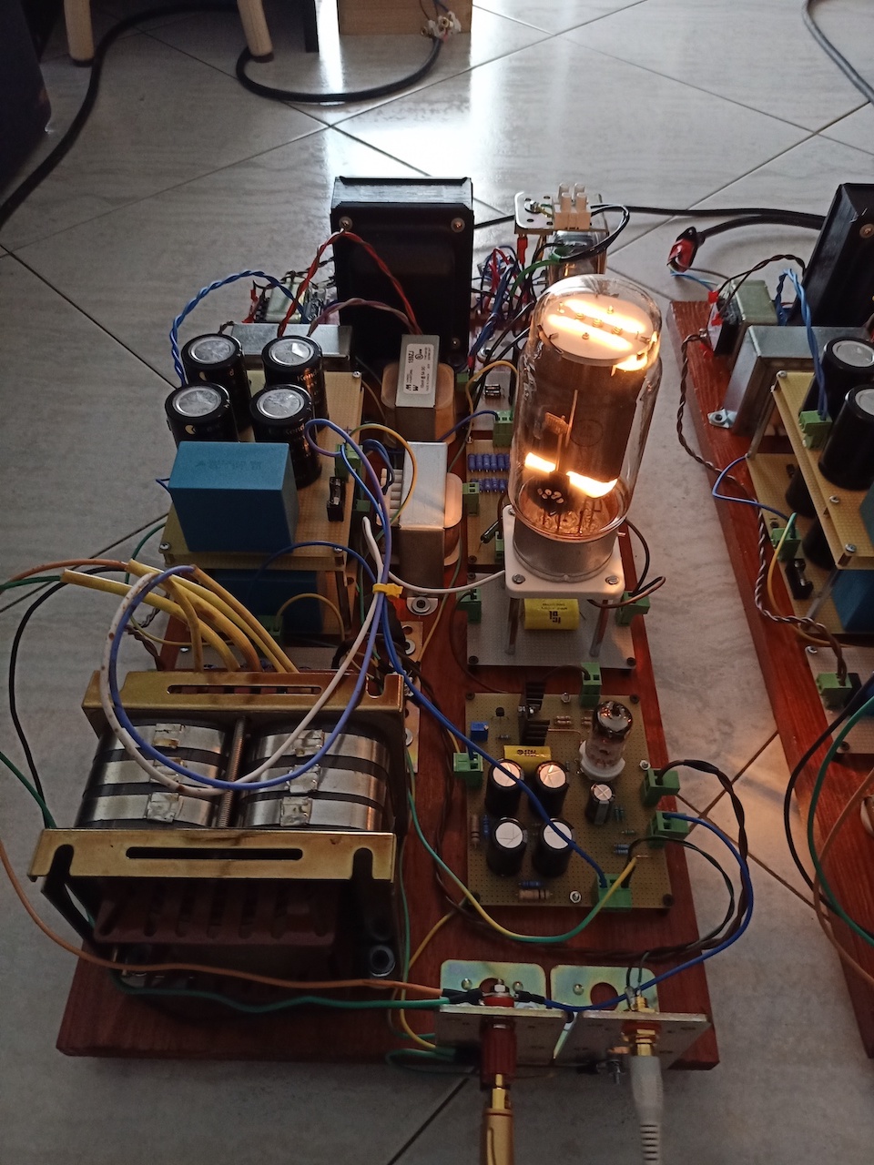

Hi all, here are some images of my new GM70 Single Ended Monoblock. Only two tubes, E86C driver and GM70 output. 25 W on 8 Ohm.
The case will be completed with a cage. The GM70 will stay out of the cage, due to the huge amount of heat.
Danilo

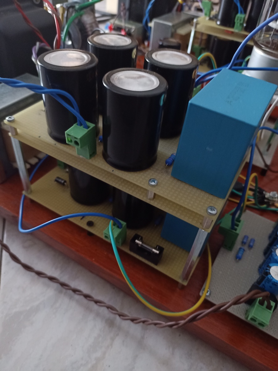

I have some GM70 laying around, do you happen to have a schematic? Maybe I can draw some inspiration from this one 😀

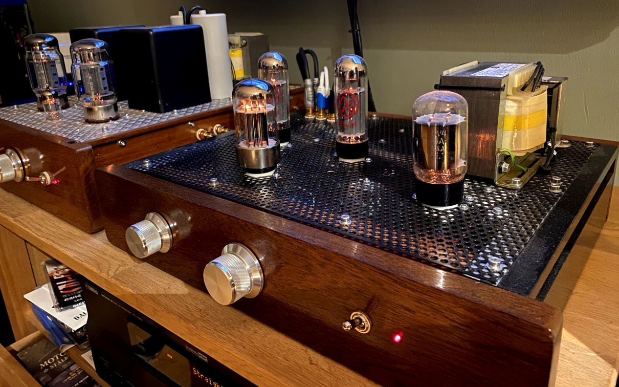

Got some 7236 tubes for the low-mu preamp, a Sylvania and a Tung-Sol. Trying out the Sylvania here. Both of them sound a lot better than the 6080 I used before. I'm even more happy with it now! 🙂
I like those knobs very much! Browsed several (Dutch) websites to see if they are available without success.
Where did you purchase those if I may ask?
I got the knobs from AliExpress:
hifi amplifier speaker Aluminum Volume knob 1pcs Diameter 44mm Height 25mm amplifier Potentiometer knob black silver gold|audio amp|amplifier knobsaluminium volume knob - AliExpress
I have a 44mm for the volume and a 38mm for the input selector, they're solid aluminium and really nicely machined.
Thank for the link showdown. Much appreciated. Bookmarked this site.
Have you experienced any (delay) problems after ordering?

Hi, here is the schematic. The measured quiescent current for the GM70 is 82 mA, 90 W, and for the E86C is 7 mA. The dual supply is to avoid problems with the output transformer. There are 6 dB of NFB just to lower a bit the output impedance. Anyway it can run without NFB.
Danilo
P.S.: I don't know if this is the wrong place for posting schematics, if so please apologize me and remove the schema.
