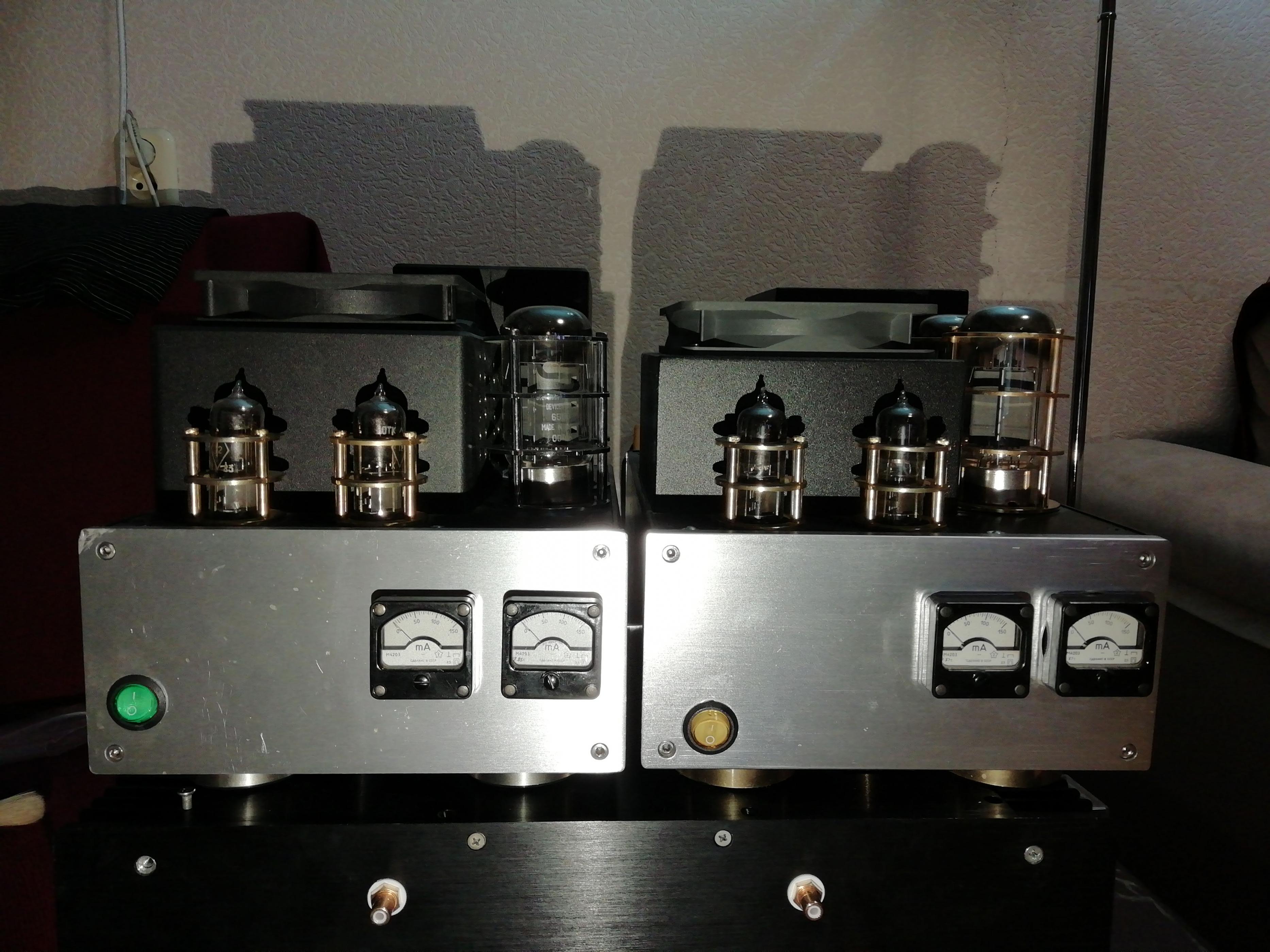

I've listened to a few of Lampie519's amplifiers late last year. He gets a very impressive bass out of a really tiny valve amplifier with this technique, that boils down to modulating the signal on a square wave carrier before the transformer and back again after the transformer.
Good morning Marcel!
Your tube D/A converter is also very convincing !

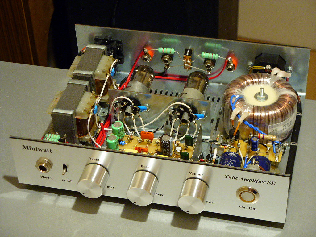

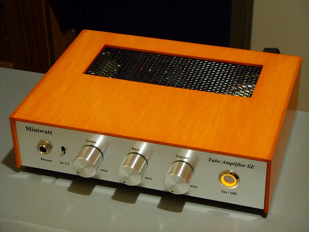

My former "production". Tubes 2x EL95, power out 2x 3W.
I have but another ...
Hot damn, that is gorgeous mate.
Certainly seeing a lot of very nice attention to detail.
It’s looks like a high end retail amplifier straight out of the 70’s (give or take)
Any chance you might have a higher resolution of that shot of the internals? Happen to have any more photos of it? Another of the inside would be rad.
Regardless, congratulations mate.

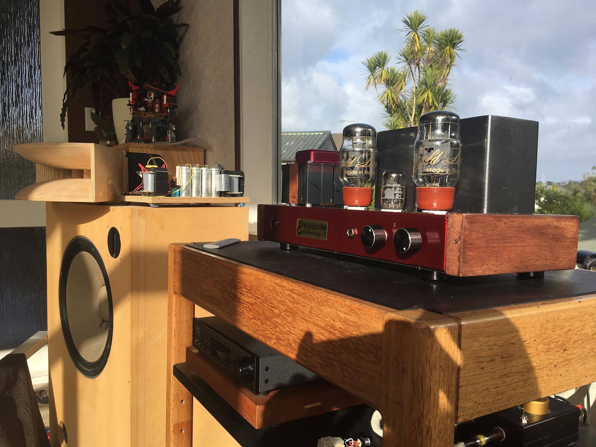

Were those KT66s?
Or Kt88s?
I am glad to see some of your amps going down under.
I hope you are being paid at least a little for your labor of love.
You have settled on a good topology, and seem to be able to make it work well, for just about any Beam/Pentode output tube.

Thank you.
Yes, my prototypes are getting popular, and each new one improves usability due to suggestions from people who buy them. Here is what he wrote:
"Thanks to Anatoliy for all of his help and patience creating this combined Headphone/Speaker amp.
The Edelweiss absolutely delivers on it's promise of high end sound on a budget.
This wee amp's 6w can drive my 96dB speakers to well past normal listening levels and sounds fantastic.
The switched headphone power and speaker switching works perfectly and I'm still amazed at how quiet the amp is on any output, dead silent!
The Edelweiss is also a tube roller dream, I have tried - EL34, KT77, 6L6G, 6L6GB, 6L6GC, 5881, KT66, KT88, and all work perfectly. My favourite is the KT66 pictured."
