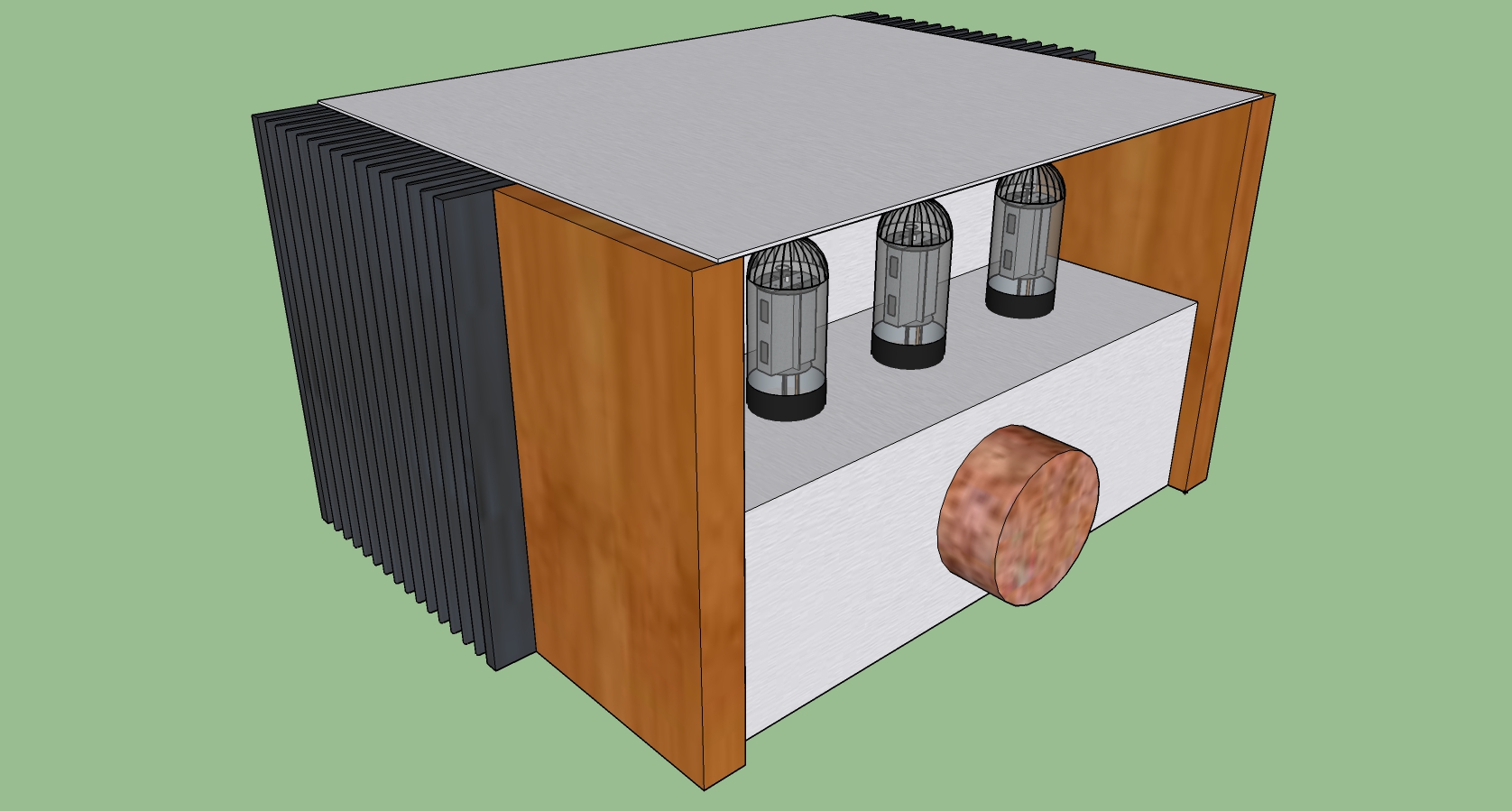

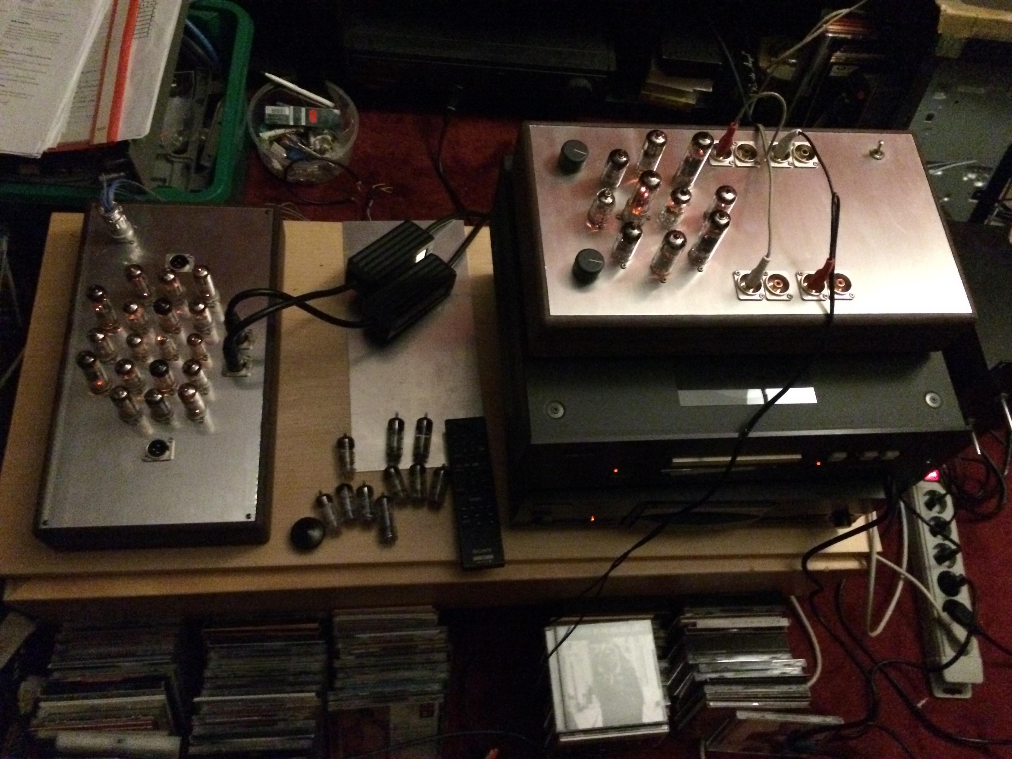

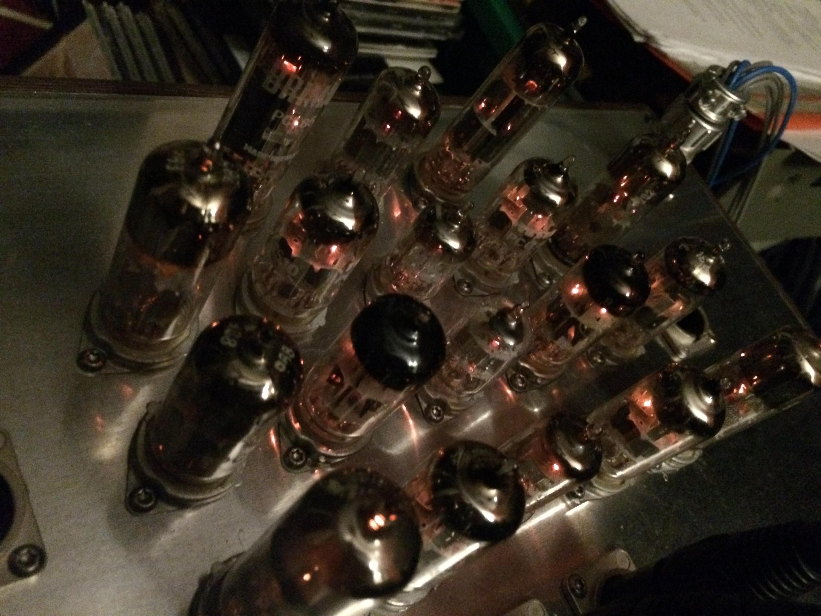

I have seen that the case of this amp is beautifull, I have work with a hybrid circlotron and I want to try build this in a nice case, if I want it small a hybrid class D is nice, problem, class D is not yet interesting for audiofieles.
Do you buy the case? or make them yourselfs?
I had idea as on pic, have buy me a metal lathe already and a precision woodsaw etc, I can then after the summer starting with that.

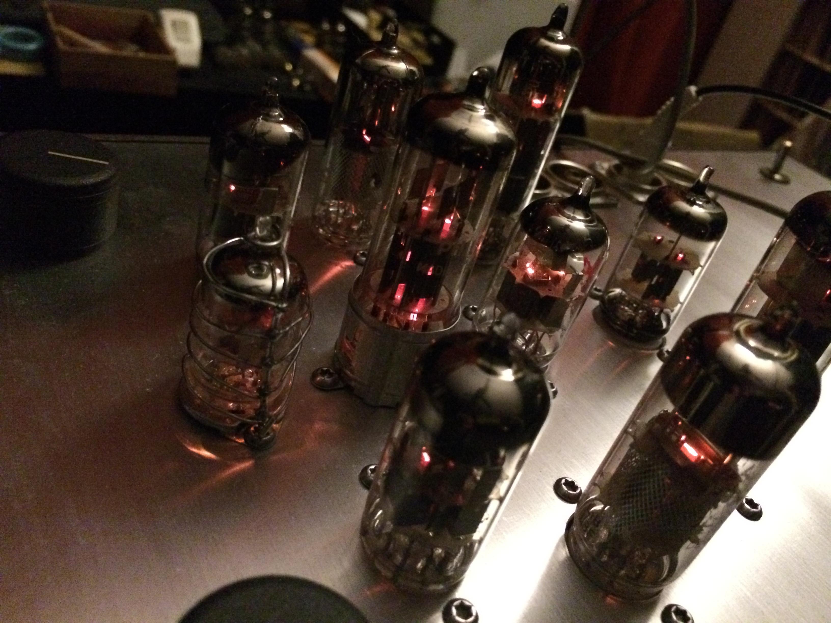

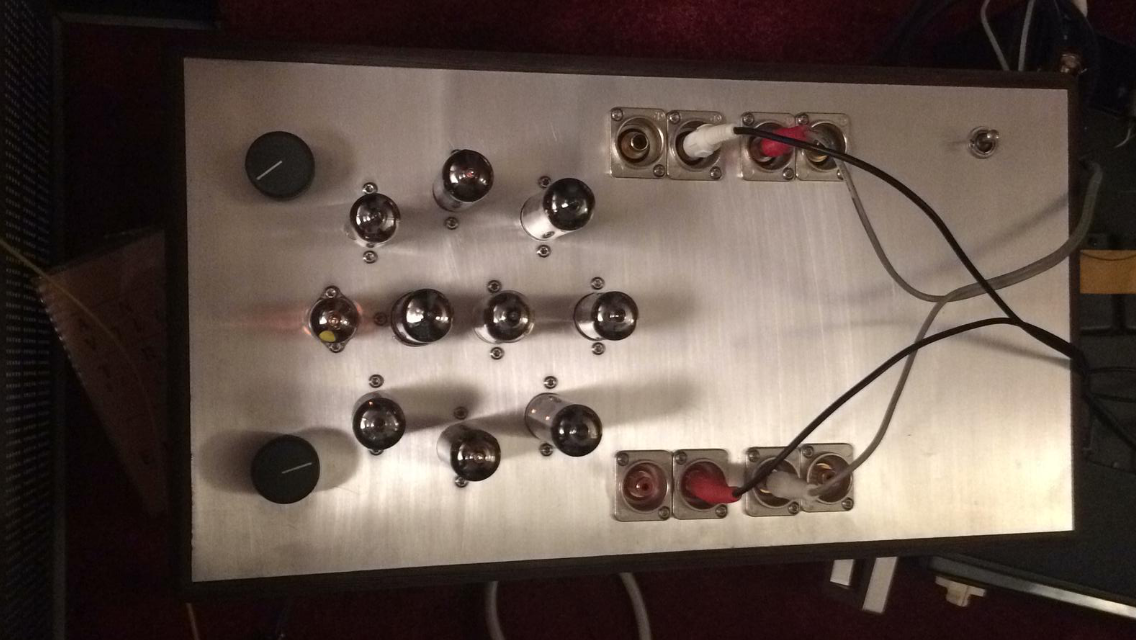

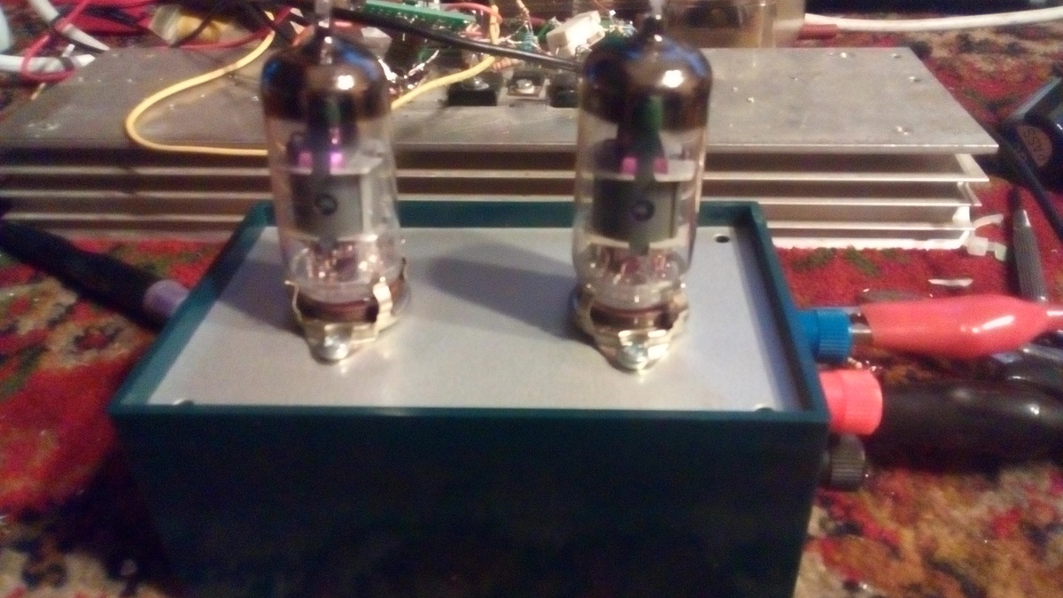

Very nice and compact design, looks good with tubes. on pic a two tube driver for testing circlotrons.
Go on with this beautifull work.

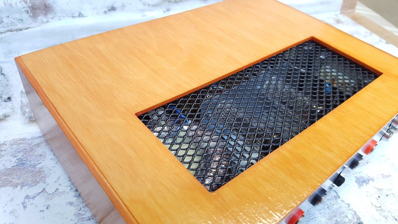

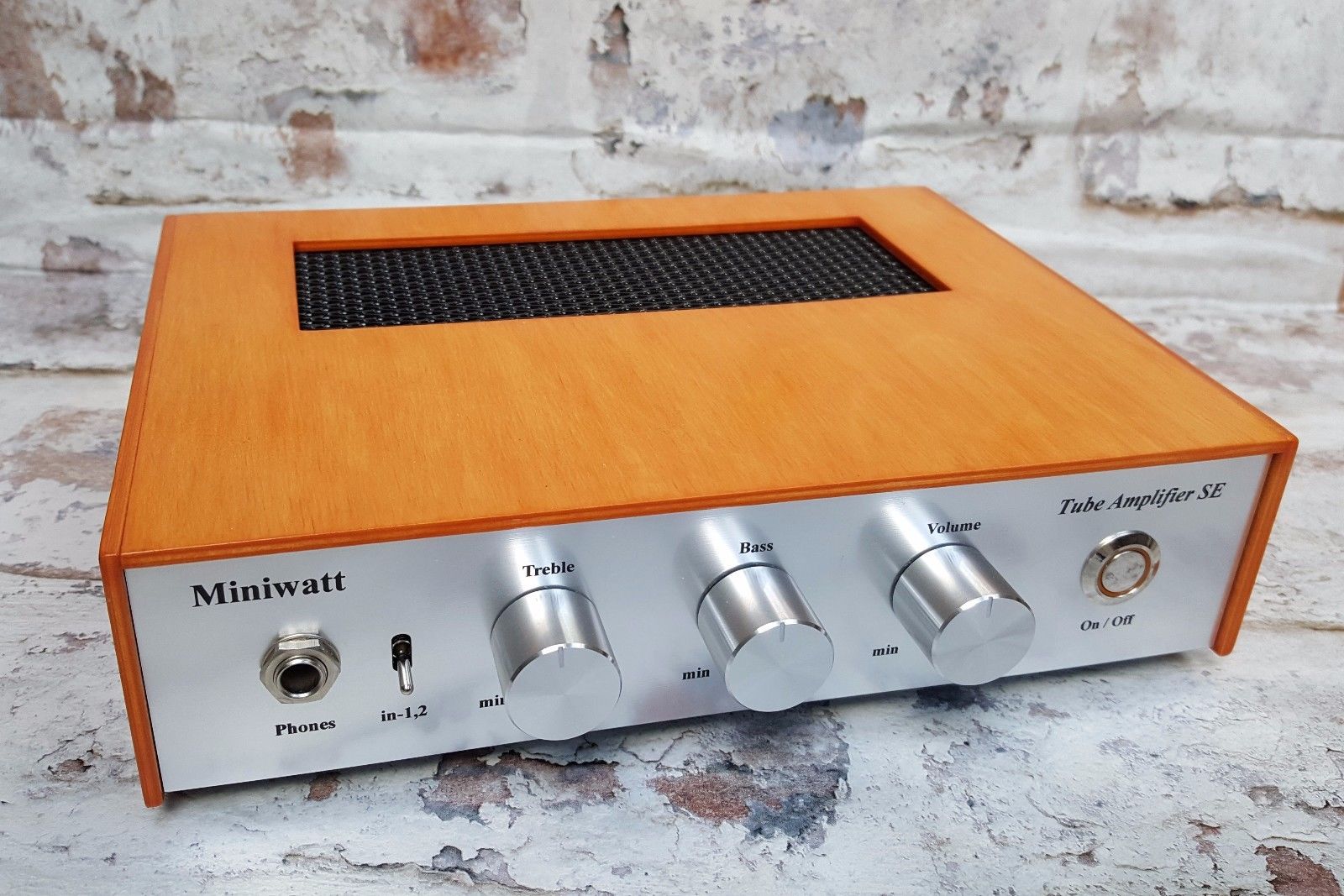

Did some ebay browsing and found that case, but no information is given about its size. At least I couldn't find it.Thank you all

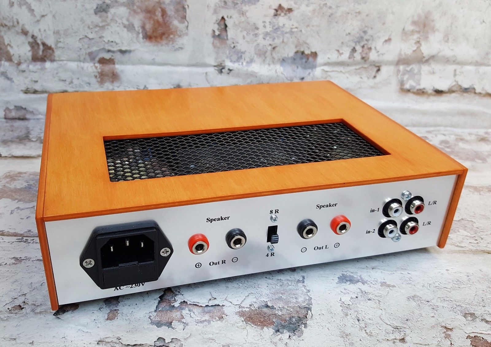

The housing is available on eBay under the slogan "A0609 mini amplifier". Supports headphones from 32 - 600 ohms, columns 4 or 8 ohms. It is currently for sale.
I used myself this case here the size:Did some ebay browsing and found that case, but no information is given about its size. At least I couldn't find it.
External dimensions: width 70mm Height 100mm Depth 160mm
Internal dimensions: Width 62mm Height 90mm Depth 150mm
Front panel 8mm. back panel 3mm, Top and Base plate:4mm
My former "production". Tubes 2x EL95, power out 2x 3W.
I love amps where the tubes stick out, but damn that is a good looking amplifier that proves you can do otherwise!

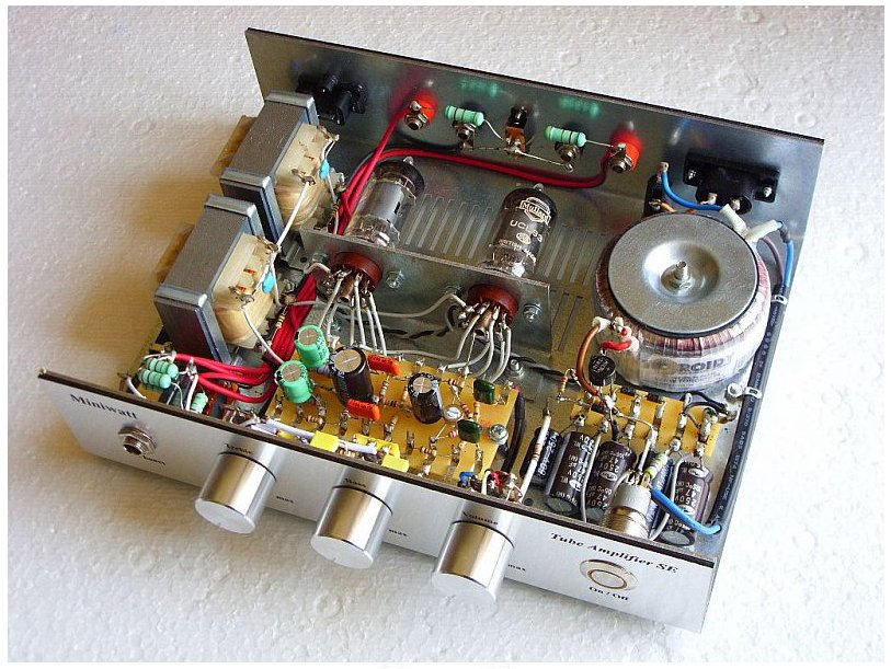

do you have pictures with the lids off?
That looks very clean....what is the design based on? looks like DHT with maybe 300b?Hi there,

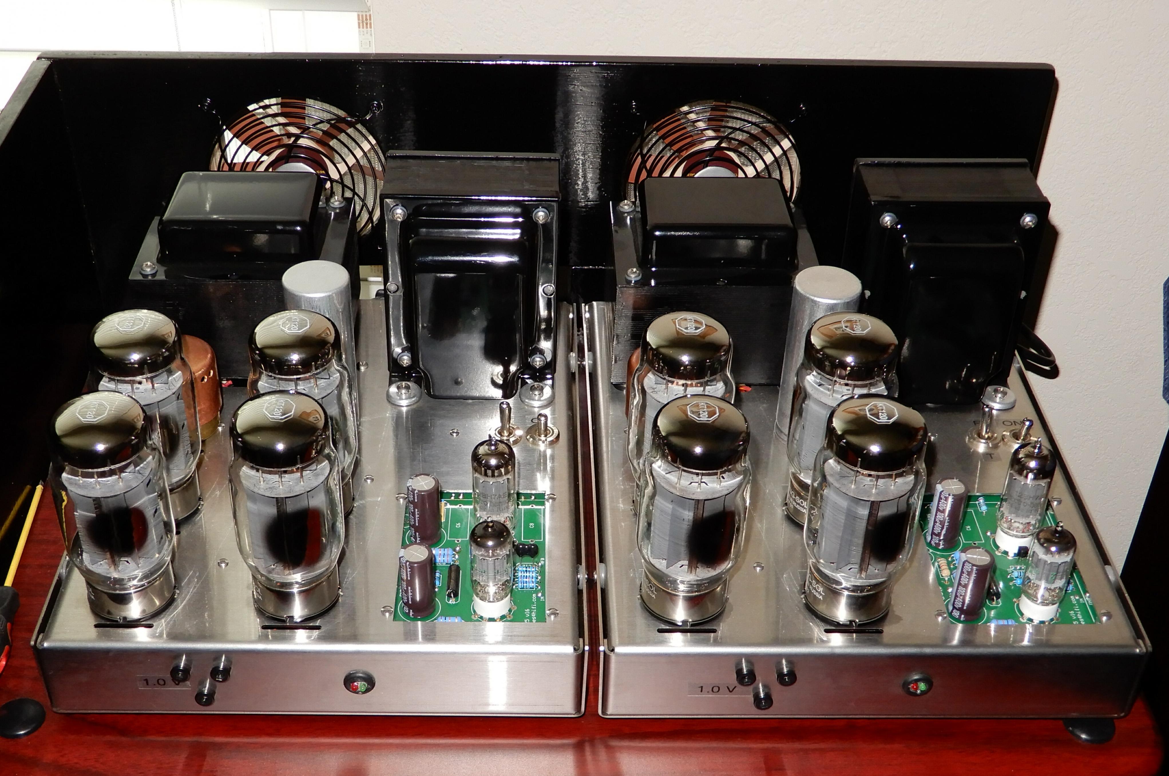

my very last design
I have but another ...
On the right tube I detect "UCL 93" from Mullard, is that correct? Never was aware of this tube.
Definitely a very nice looking amp congrats, just curiosity I can see the power supply is very simple and looks like no chokes are used,I am right? So you do not had any problem with it? .....all the best
