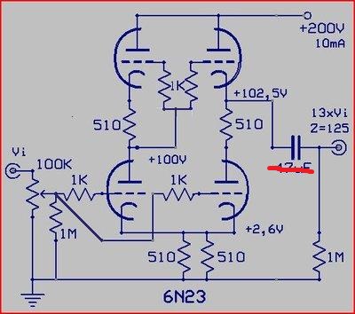

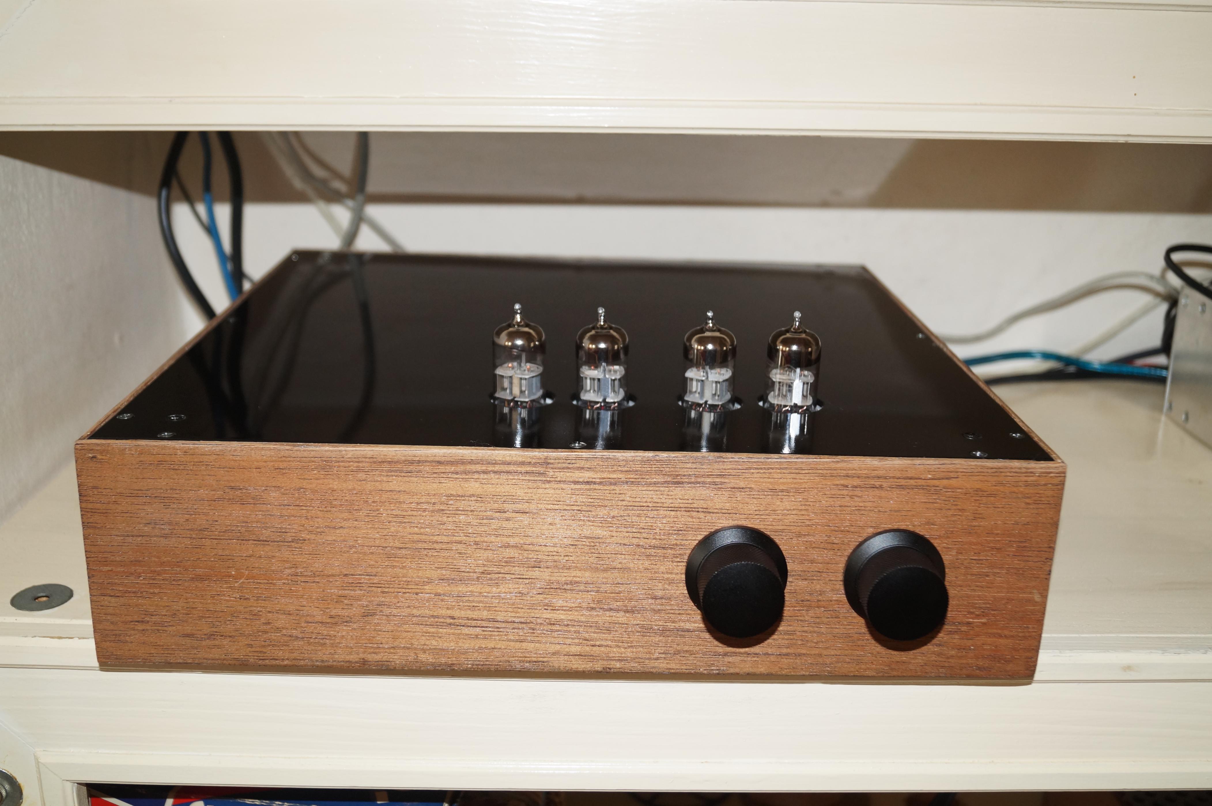

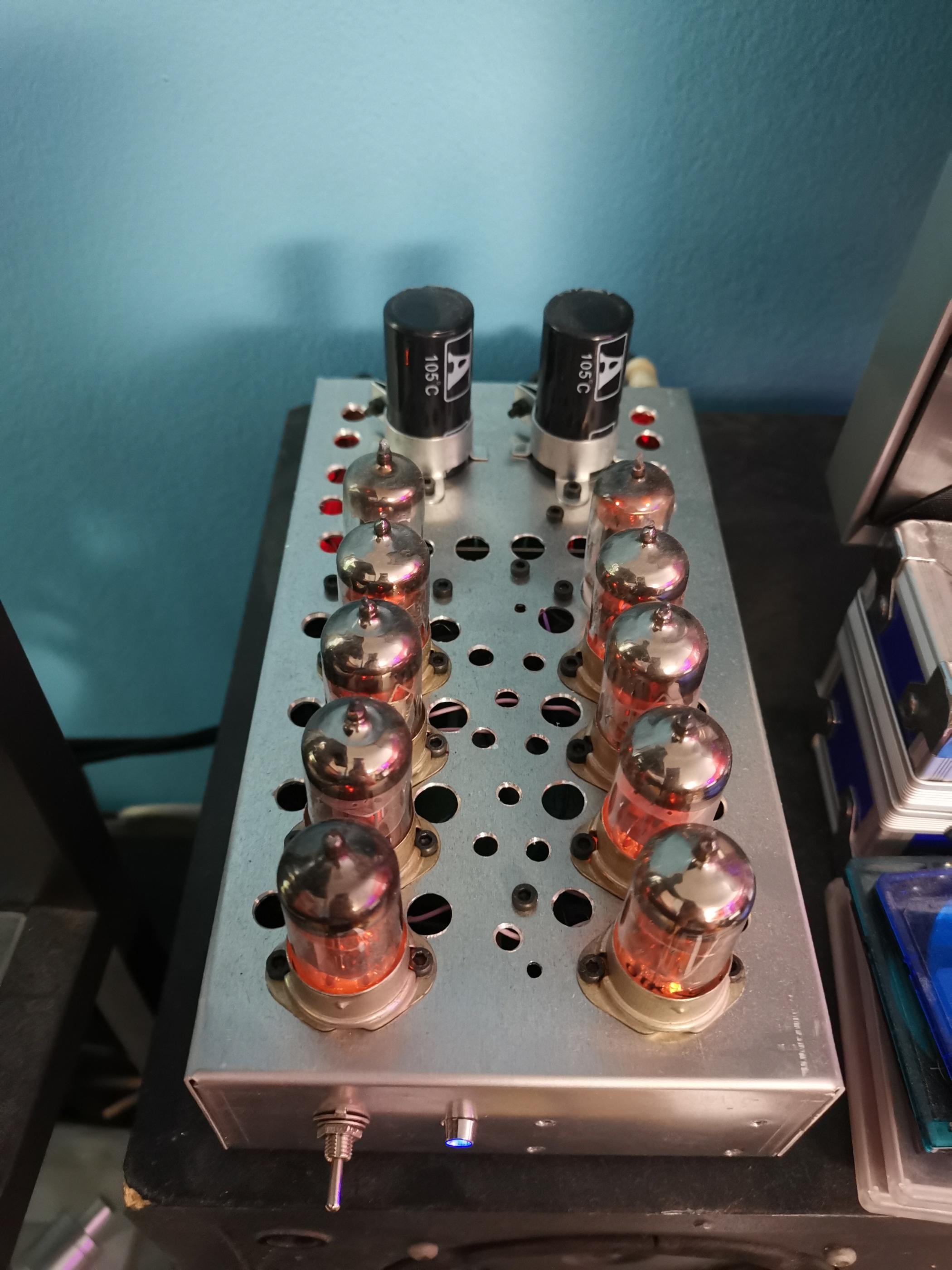

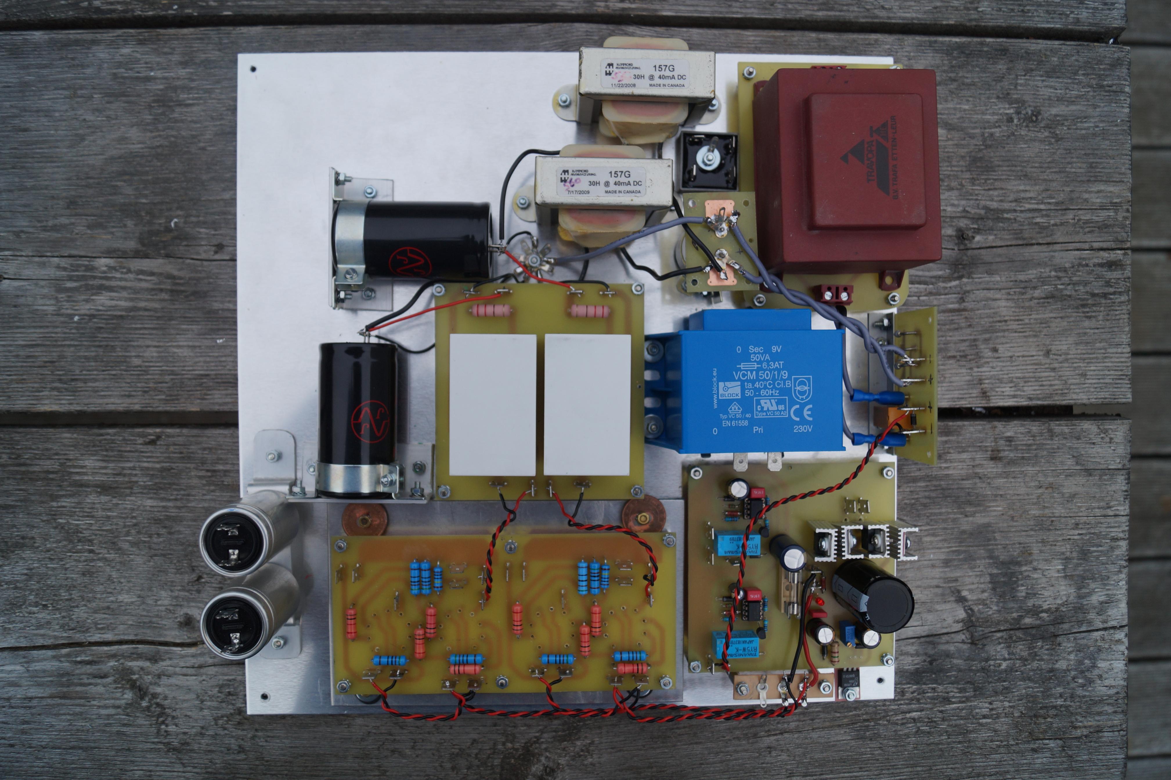

6N23P preamp
PCB hanging in rubber,DC filament heating,HS delay,mute,all components mounted on subframe.

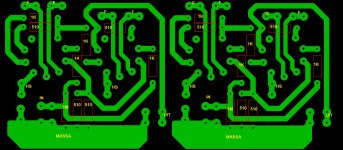

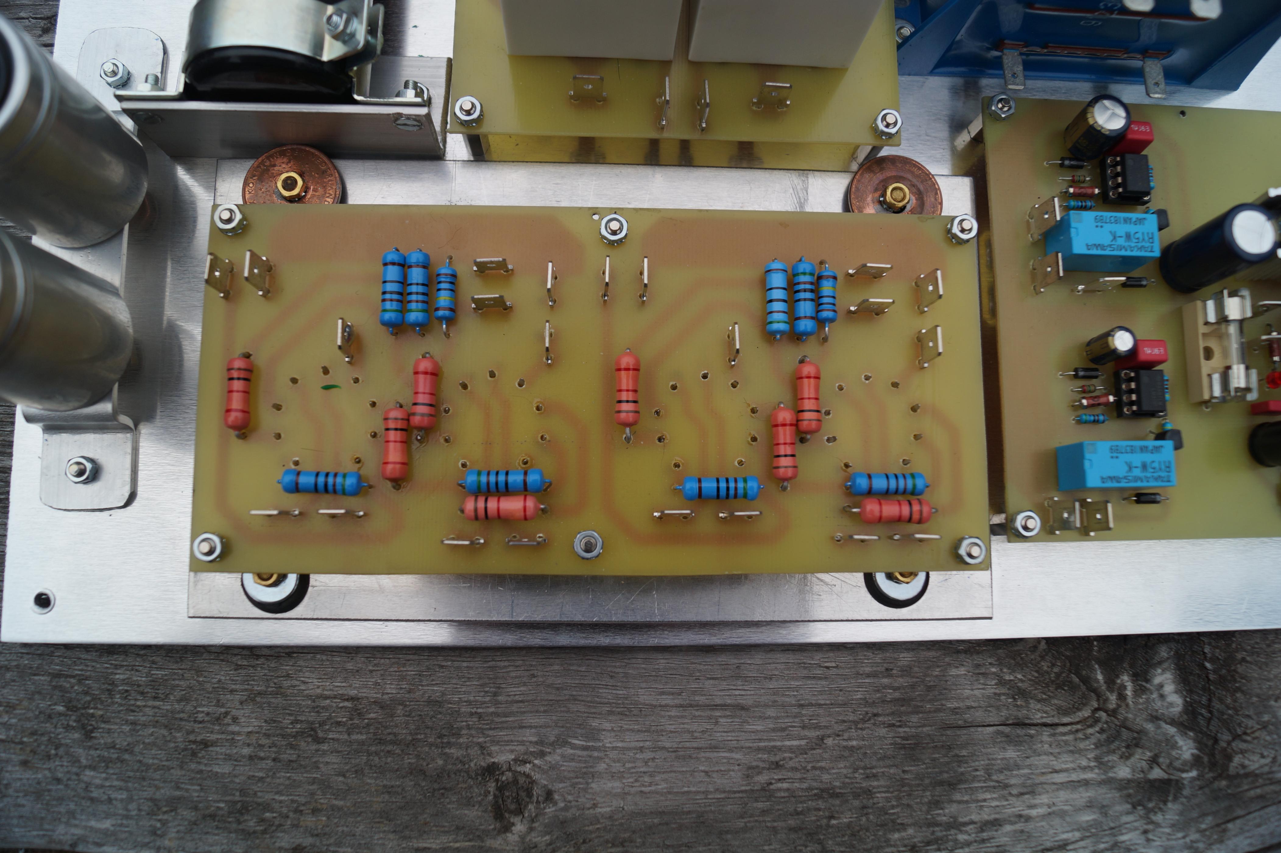

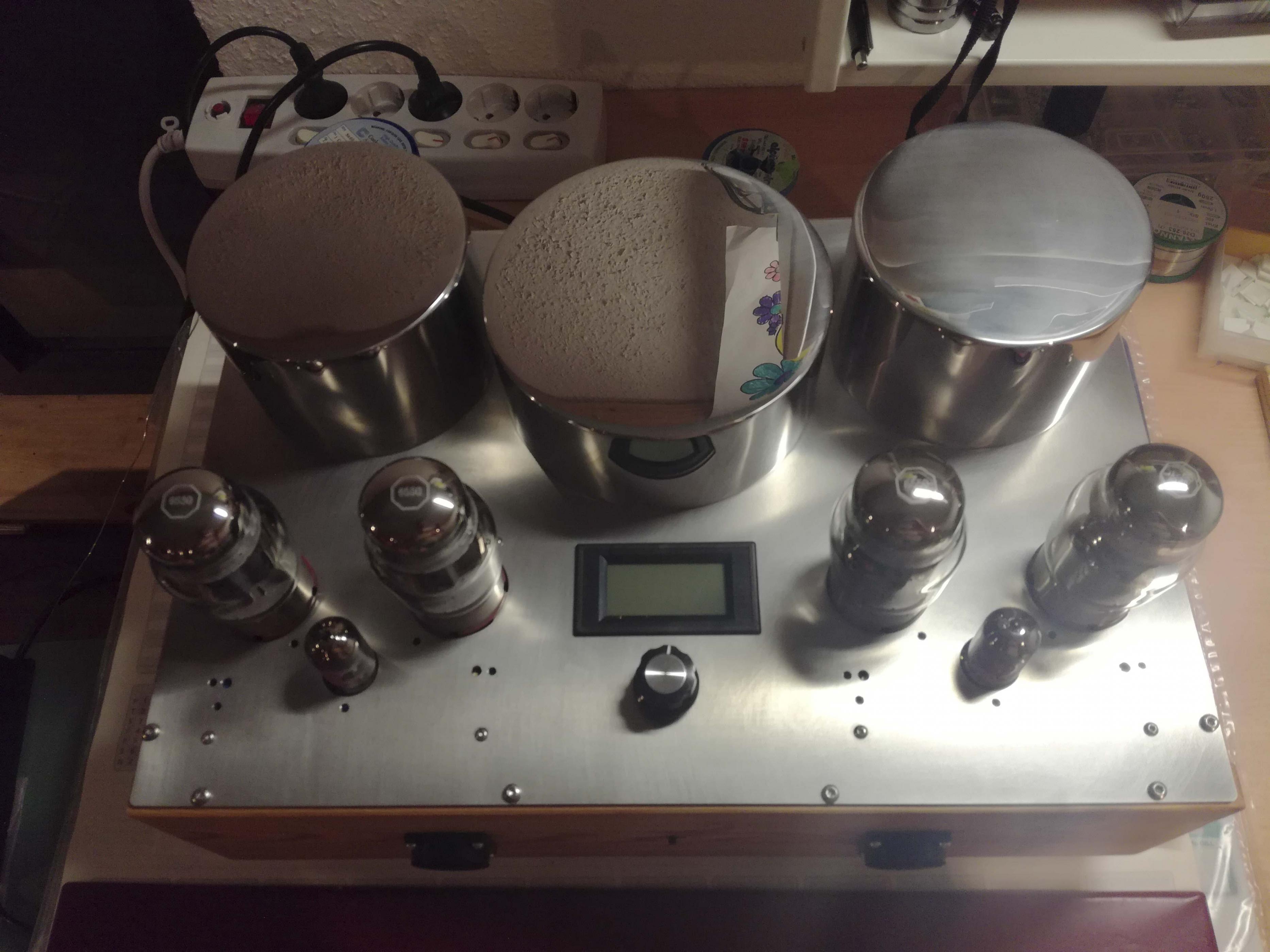

BH 6550

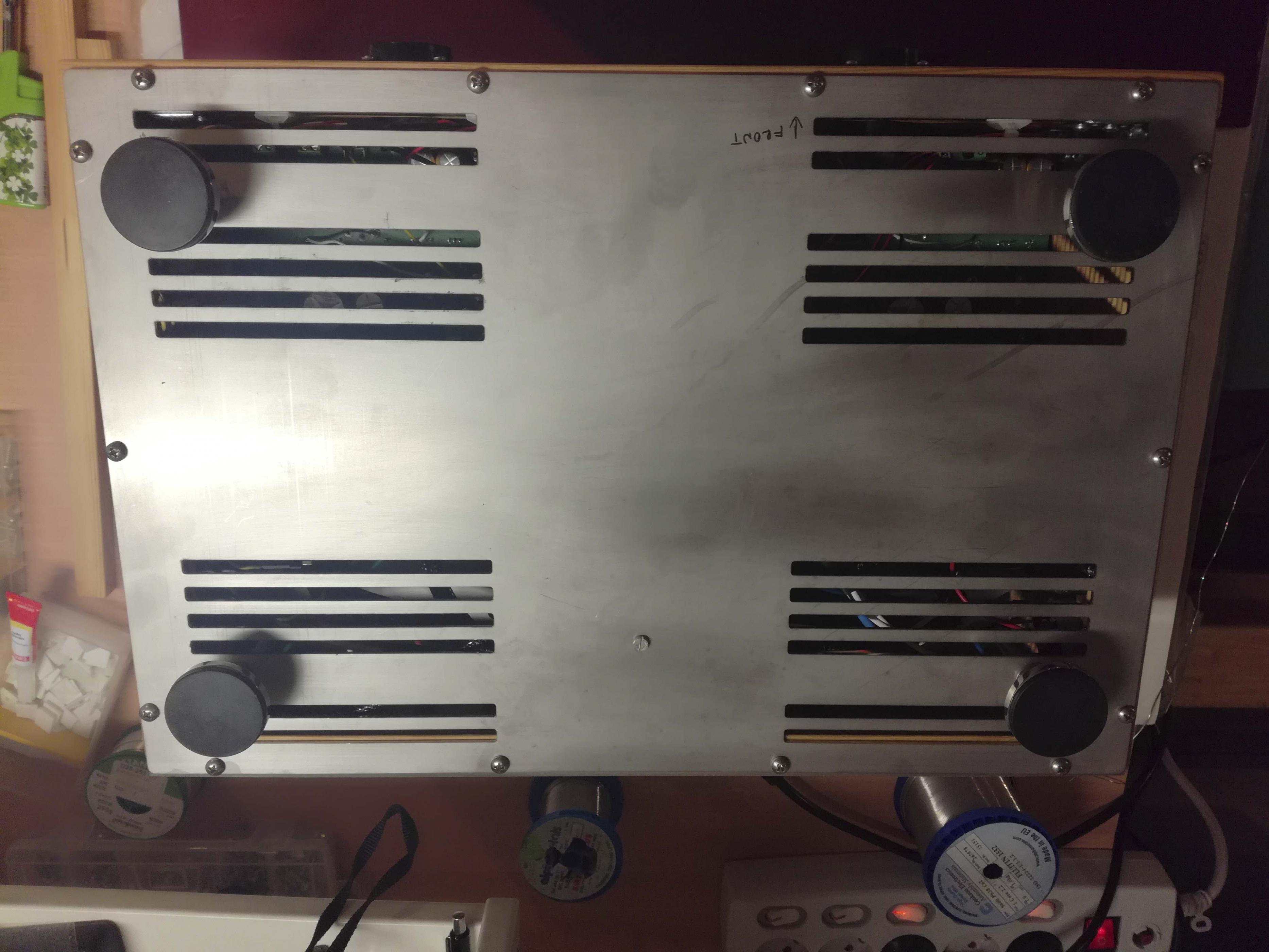

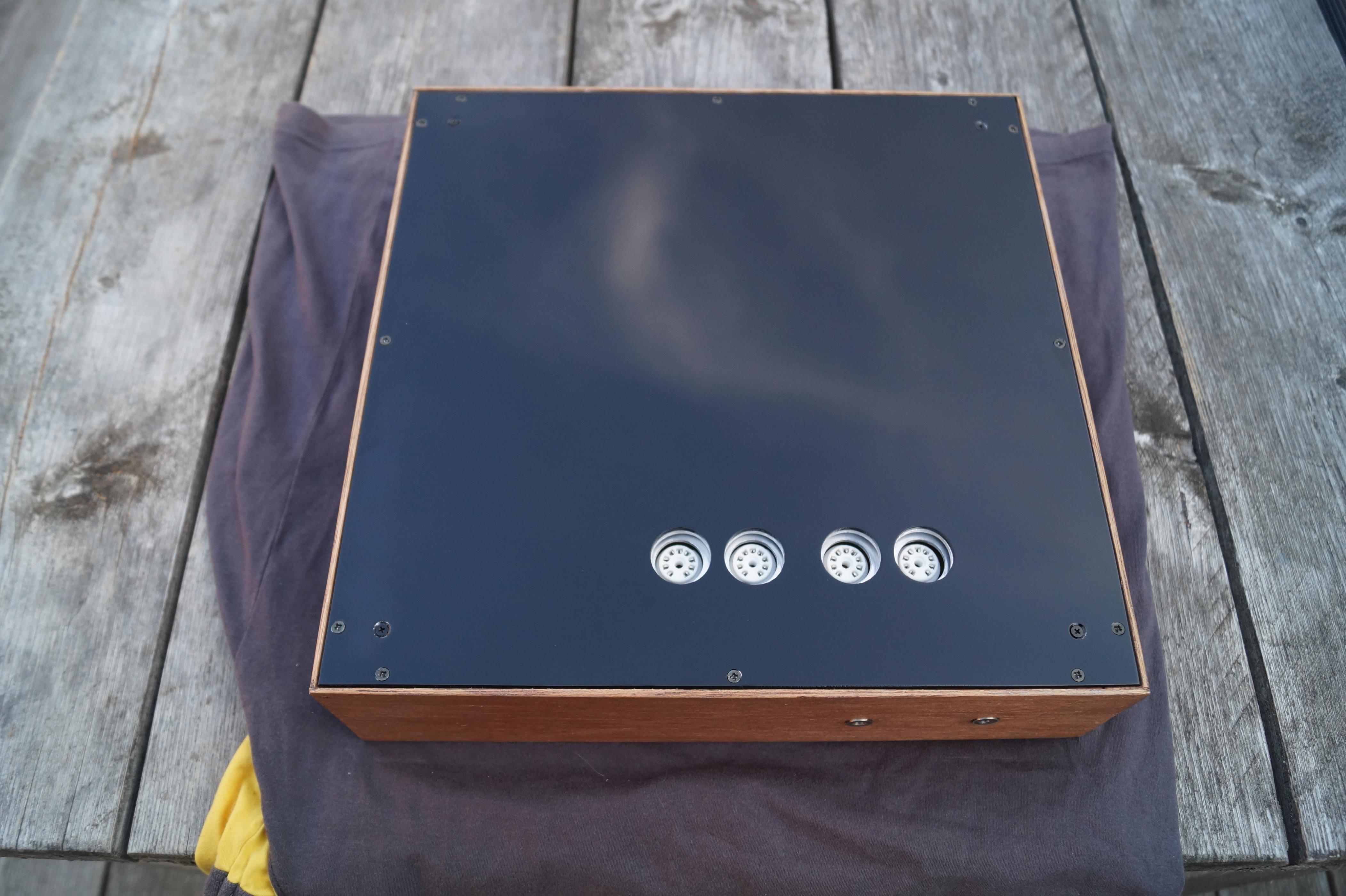

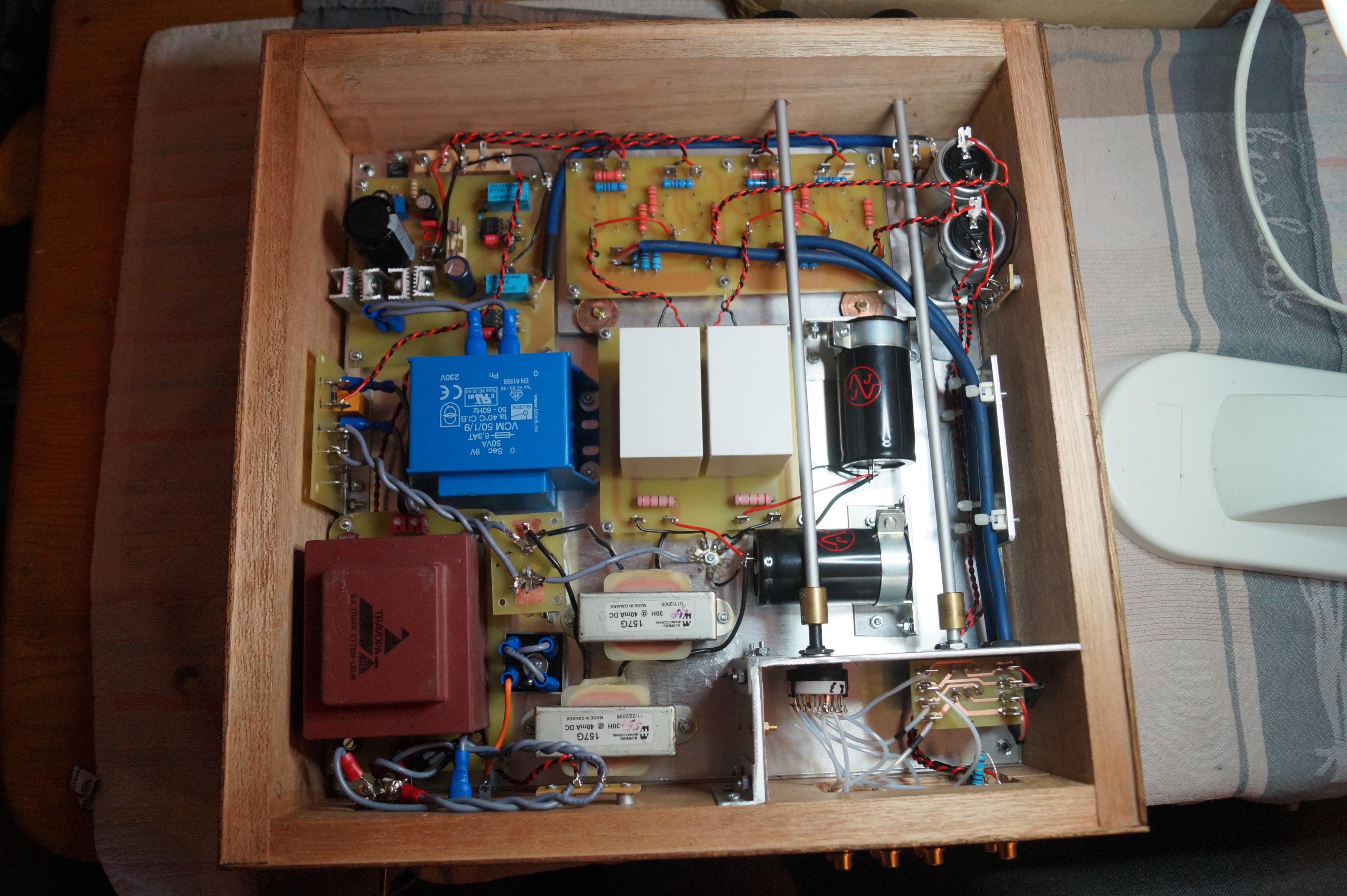

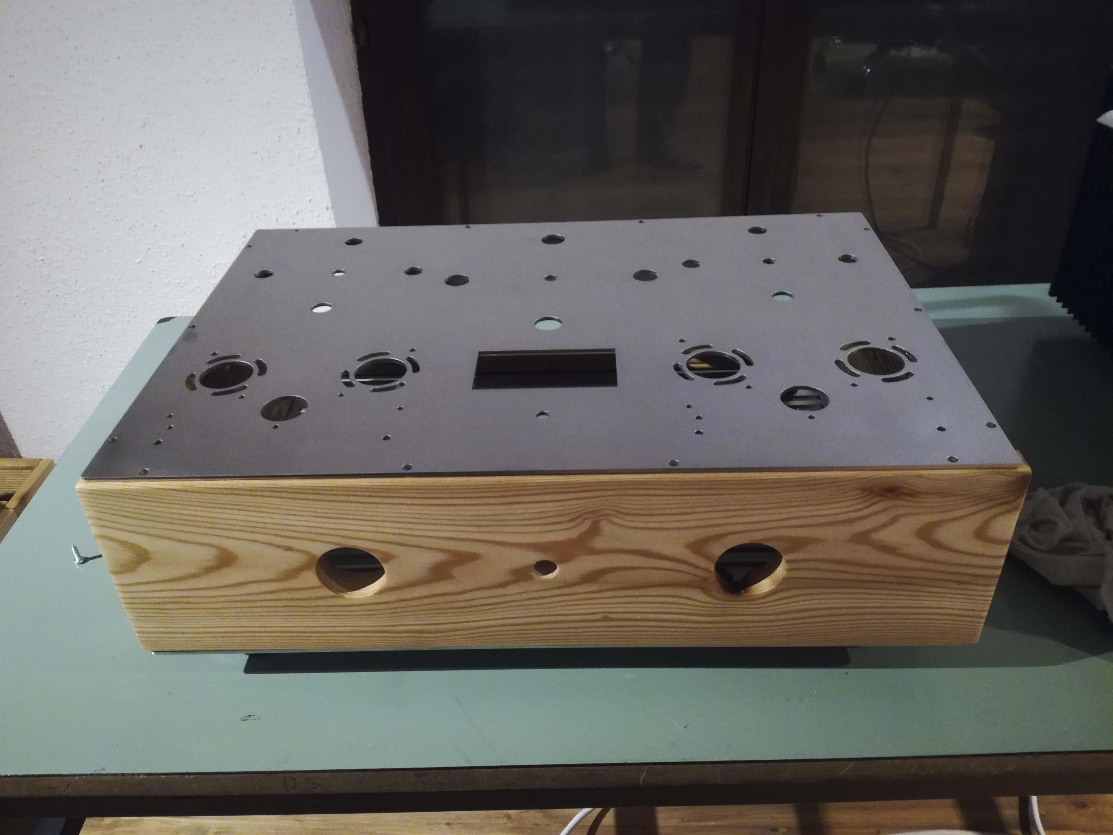

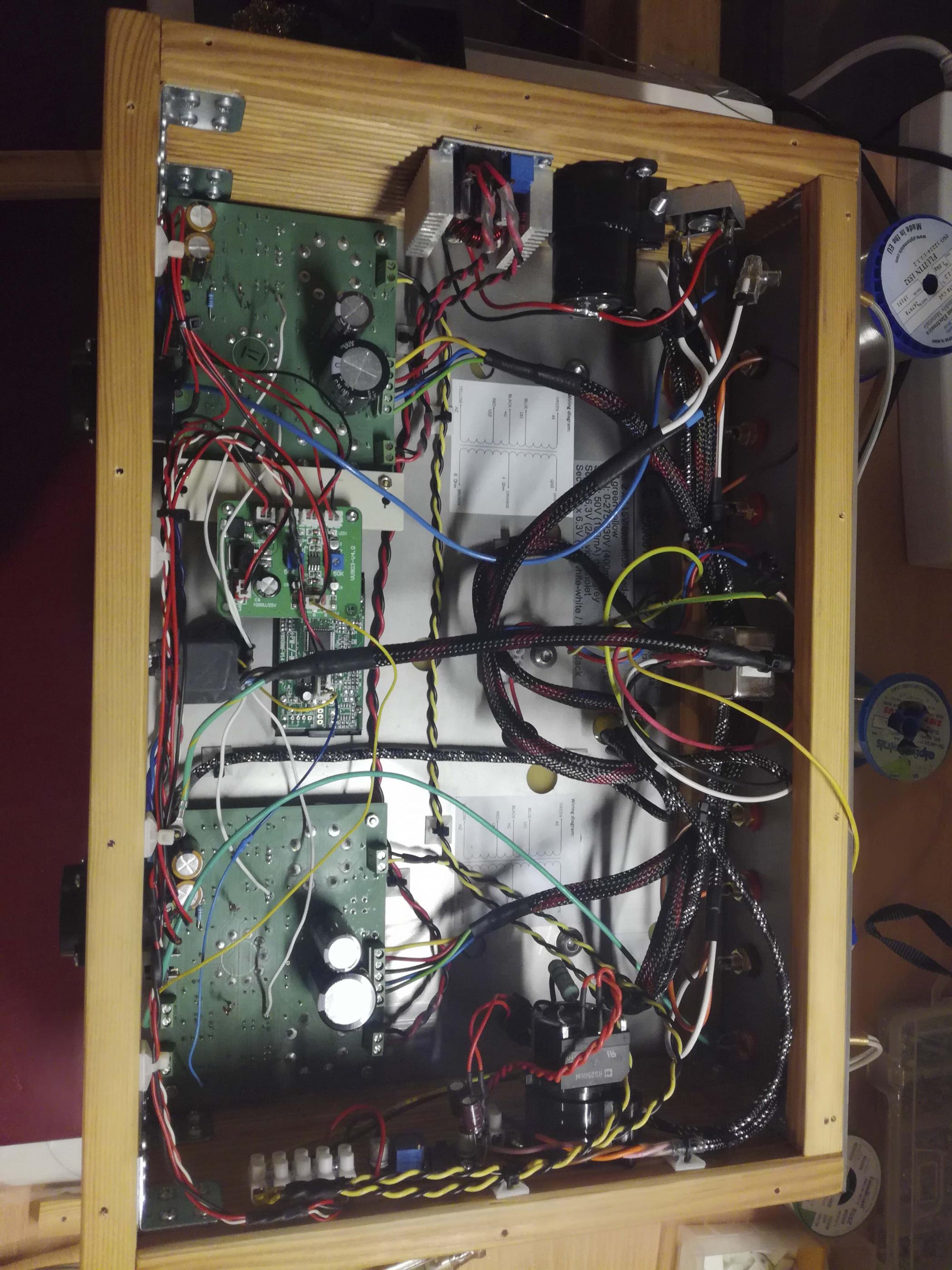

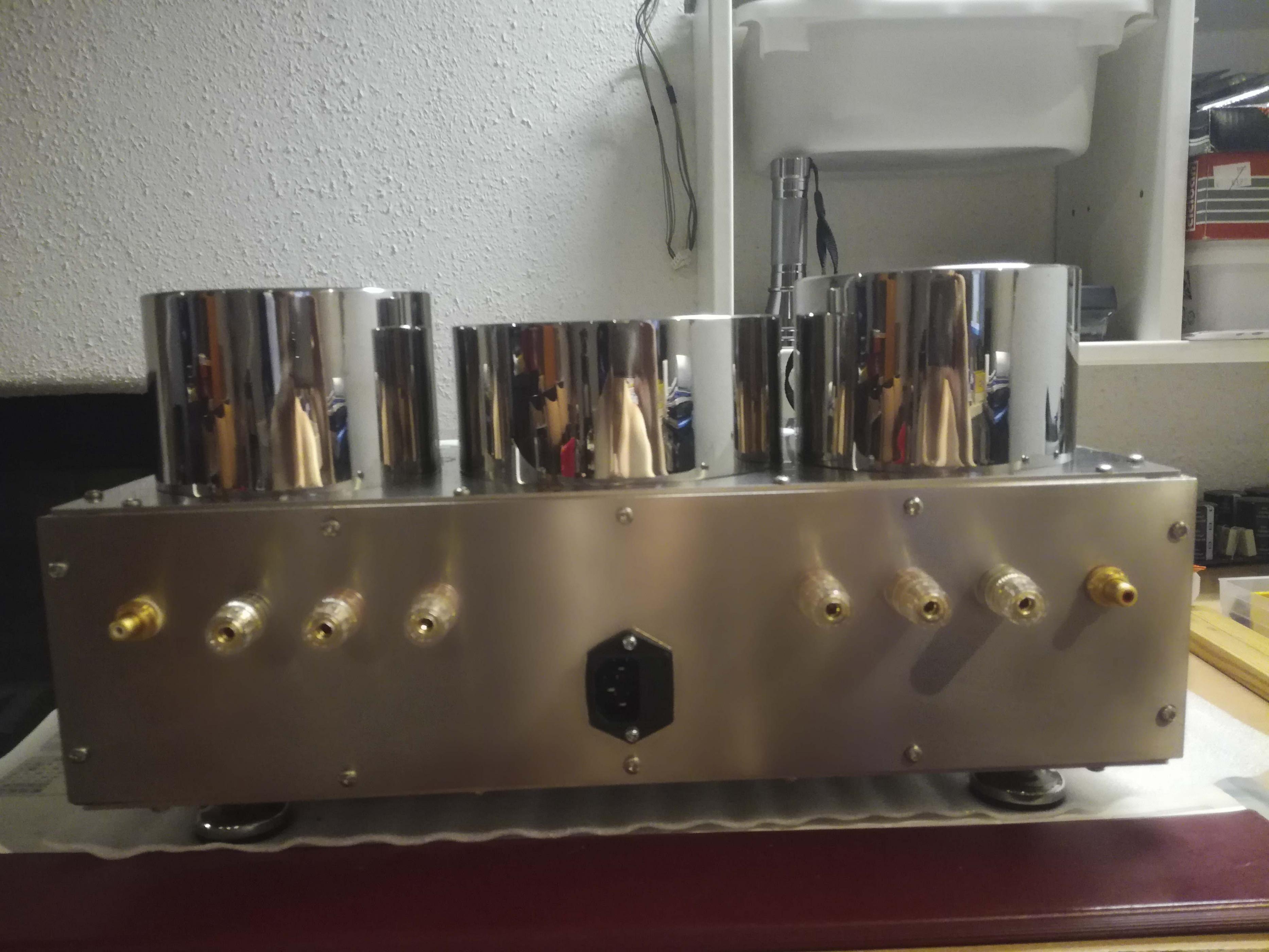

This is my first tube amp ever and I love it.🙂 Need to finish some minor details... Many thanks to Bandol83, gingertube, prasi...for their work and devotion 🙂🙂

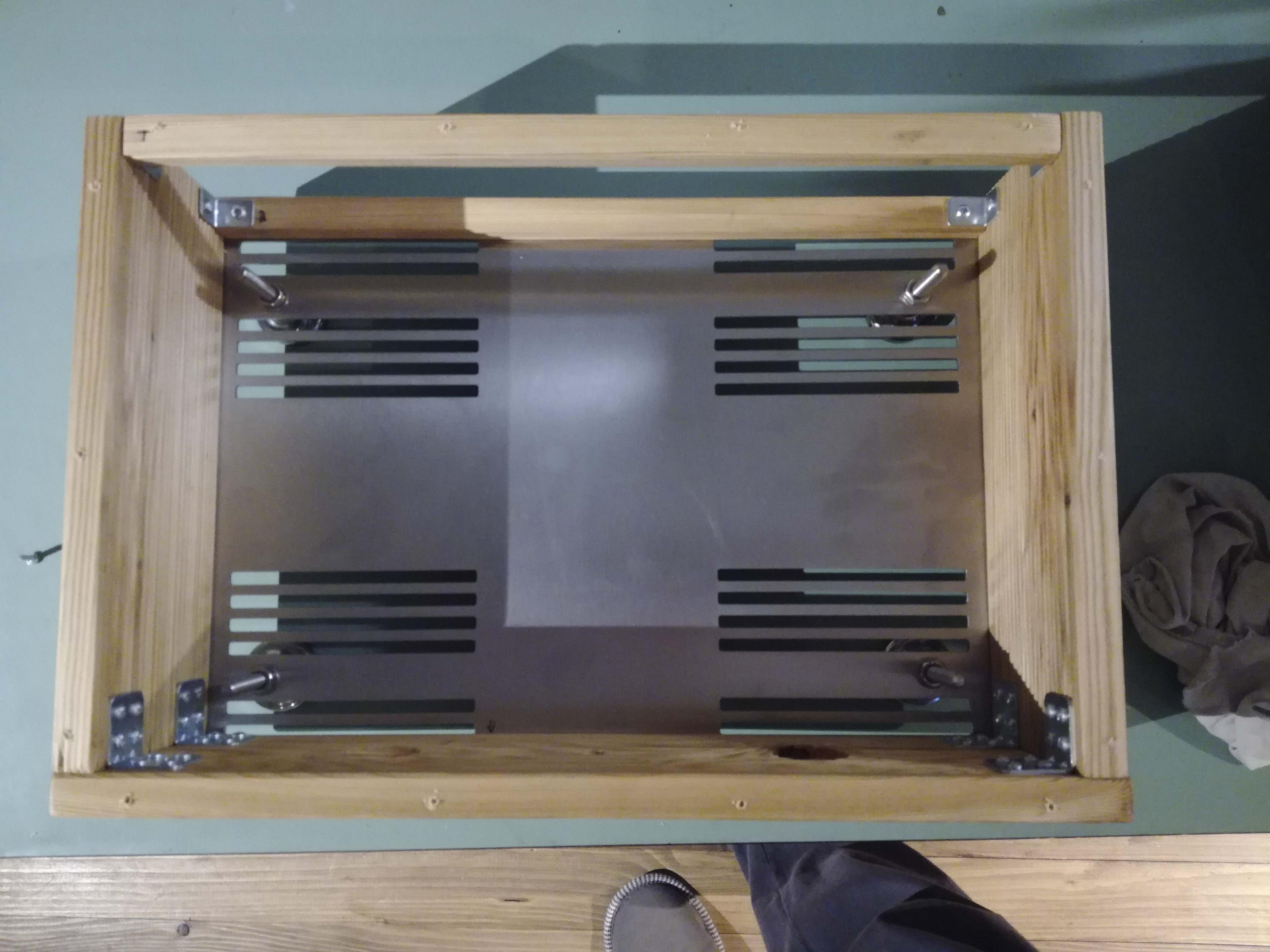

That looks fantastic. Can I ask how you managed the machining of the top plate?
6N23P preamp
COOOOL🙂
5 tubes for each channel or....?
Four tubes per channel, the other 2 tubes are in the power supply 🙂 I use a 12AX7 and a 12AU7 instead of two 12DW7...
6N23P preamp
Very ingenious circuit and aspect

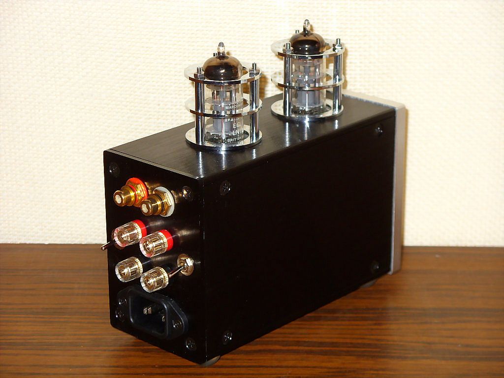

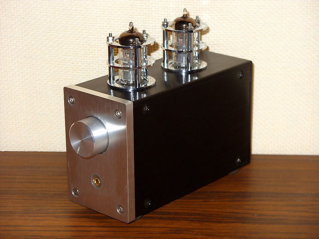

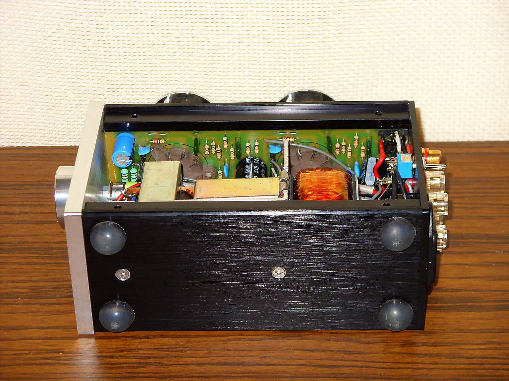

Beautiful!This is my project on two tubes ECL80... mini amplifier for headphones and speakers, power out 2 x 1.5W.
Did you make the enclosure yourself or ......
BTW : What is the headphone impedance?
Thank you all🙂
The housing is available on eBay under the slogan "A0609 mini amplifier". Supports headphones from 32 - 600 ohms, columns 4 or 8 ohms. It is currently for sale.
Nice and compact build. I love this kind of constructions.
