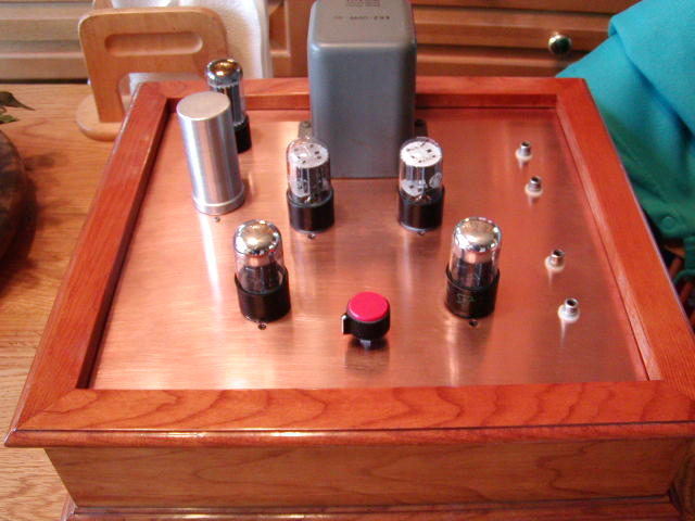

The wood base, I wanted to have something like Chris Brady's 845.
This one is with power transformer! I was lucky to have a woodworker who did this for me. 🙂
The circuit..
Hi Dhaen and Stalker,
This 45 SE was for a very sensitive horn system with active woofer below 150Hz, Oris (something like Avant Garde). So I am not sure this circuit is for the higher ouput, but it was good in quality to me.
OPT is Sowter parafeed 5K, 45 active load is Gary Pimm's EL84 CCS, and load for 6H30 (each section per channel) is DN2540 CCS. 45 can be AC heated, but I was worried about the sensitive horn...
Chul

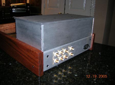

OK, it's not 100% finished yet, (nothing of mine is) but it looks it and I can't wait any longer to share it.

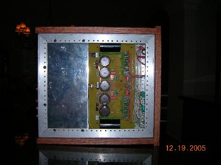

It's a headphone amp/Pre amp. Long tail pair 6DJ8 and 4 triodes paralleled cathode follower output 5687. Drives my 64 ohm Head phones beyond sane volumes, and sounds great. The PSU is 100W isolation transformer-20 ohm resistor-SS bridge-6000 uf Sprauge DX cap-.6H choke-2000uf cap-various resistors and 2000uf cap to each stage.
Bass is a little rolled off, but sound better this way than with the 'lytic cap parallel to the 33uf film. There was a weird 10 mv squareish wave across the output caps when playing that sounded harsh. I may try some boutique 'lytics some day.
I used up almost all of my 1/4" aluminum plate that I found in the scrap yard
I've gotten good at drilling and tapping into the edge of 1/4" with 6-32 cap screws.
On to the picks.

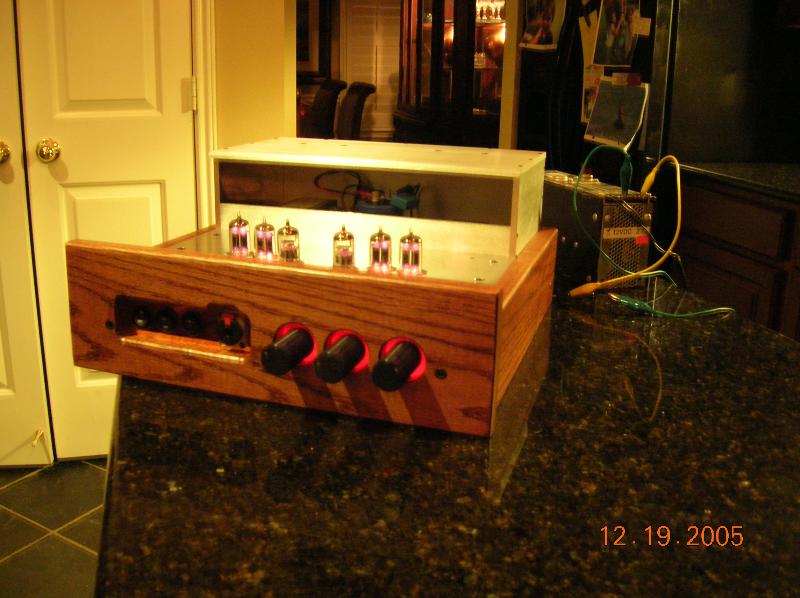

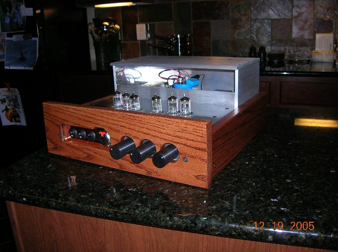

The front controls. I have seperate Heater, B+, unmute so I can let the cathodes get good and hot before I put the juice to it. I still plan to make a mute board to be sure that the outputs are shorted for a few seconds after B+ comes on. 10V into a power amp is not good form.
Check out the night view. Behind the knobs id 1/4" plexy that I sanded and edge lit with red LED's (blue and tubes go together like pickles and chocolate milk) There is also a peice of 1/2" glass that I need to order through a friend that will clamp to the bottom of the top plate and extend over the tubes and be edge lit.
