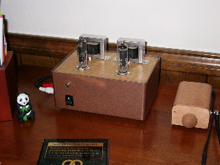

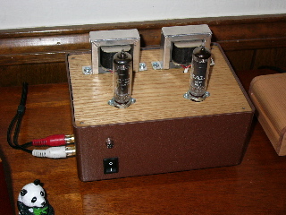

Here's a humble little project amongst all those super-amps!
Still awaiting real OPTs, connected to my DAW, the 50EH5 "Daddy" amp.
http://www.geocities.co.jp/Milano/1988/radio/50eh5.htm
Note external passive volume control, amp will eventually be on a shelf.

philipbarrett said:Still awaiting real OPTs, connected to my DAW, the 50EH5 "Daddy" amp.
Your OPTs are bigger than mine -- by a fair bit. You running these in pentode?
dave
Those OPTs look OK but I'm reading less than 1K across the primary! Click on the web link in post 1 for the schematic. Very simple, does sound sweet though, considering it has to beat it's way through those transfos!
BTW - in deference to another thread, "yes Virginia there is an iso transformer in there." Actually 2 of them, I sneaked 100V by doing 120V to 15V fed back into the 17V secondry of #2 and back out the primary, made about 105V for less than $7!
