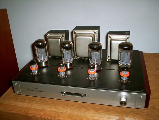

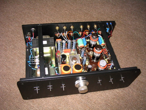

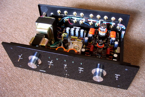

Here's my Tri-Amp 😀 It can take 10Y, 50, and 300B tubes. 417A drivers, Lundahl Power Transformer, Hammond 1628 (the older, better one) OPT.
It is shown with Hytron VT-25 power tubes, Amperex gold-pins 5842 drivers.

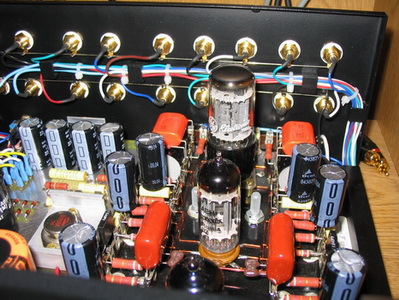

It took a lot af time to put these together... it seems a never ending process, mainly in a country like mine, where the valve art (tube factories, tube inventory etc) was sent to the trash.
It's difficult even to find sockets!!

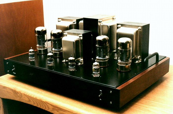

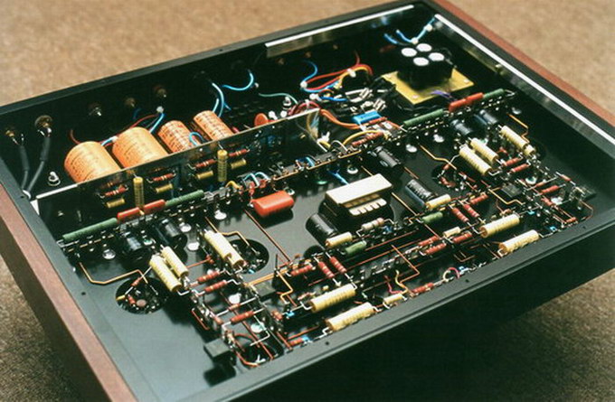

Perfect work,rwellerson . I haven't seen such a prezise assembly yet.rwellerson said:Before any wires "messing" the space....
ddd: thanks for your kind words...

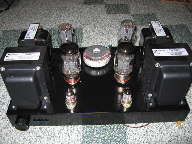

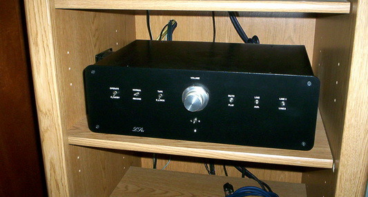

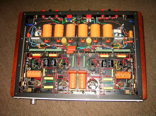

See these two other pics: ultralinear amp, cathode bias, chokes for main B+ and another one for B+ input section branch.
Using 6550C Svetlana for about 40WRMS per channel.
Very nice sound.
Ricardo

10x, rwellerson. Just the small choke is below 🙂 I put all your images in my "DIY cases" folder. Many ideas could be used from these constructions, indeed!

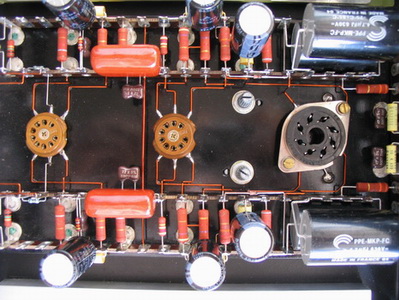

Point to point wiring/circuit build-up (my way....)

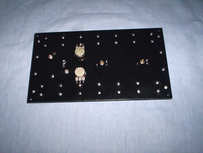

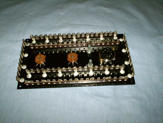

Hello
Just wondering if the way I build my circuit boards would be of any help/interest to the DIY tube people...
The support plate is made of fenolic resin (very tough...), 2 mm thick, the tag strips are fixed through holes and copper rivets to it.
After that I solder the rivets heads onto the terminals (tag strips bottom eyelets) to provide good electrical contact and rigidity.
I paint my plates black.
The rest is pure hard work... days and days of it!
Ricardo
