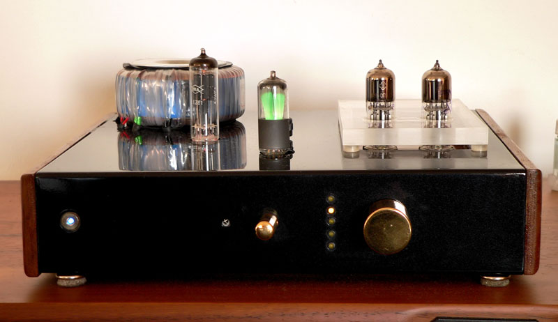

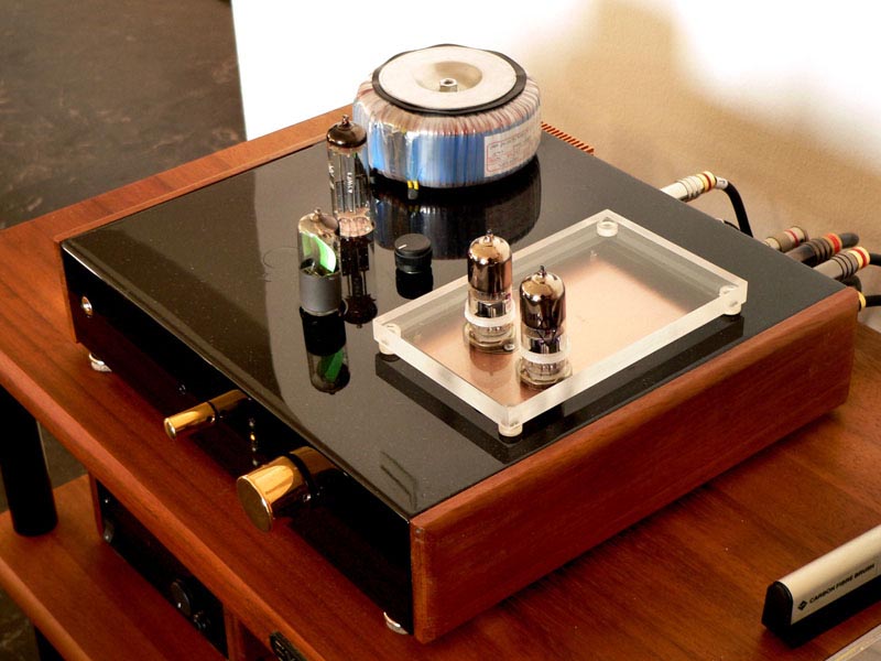

Here's my just finished line preamp
I have put in all the gadgets I could think of 😀 like
- a single contact touch switch to turn it on & off
- remote controlled volume and inputs (dear couch, here I come 😛)
- an EM83 'magic eye' to play to the music - really beautiful to watch. I made it switchable so I can turn it off at will

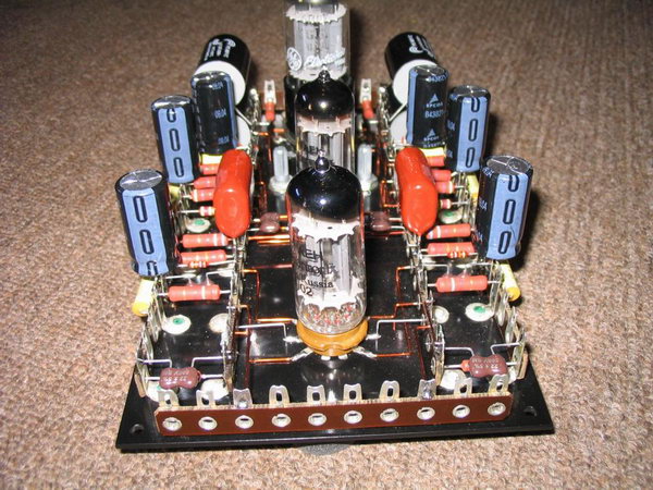

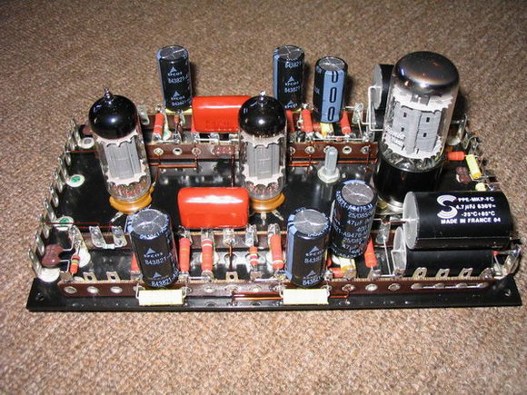

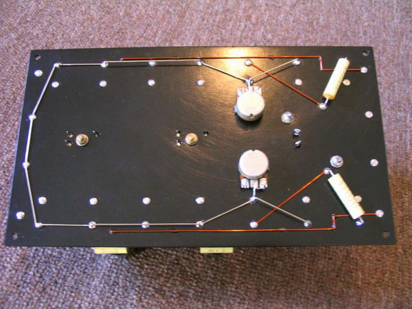

As most of the fuss in building a preamp is the peripherals, the main circuit is housed on an removable epoxy board so I can try several tubes/circuits in the future
Currently I am using 6H30p in a srpp configuration but I have already started building a board with 76 / 6SN7 (CF)
It drives beautifully my 4-year old 6C33 OTL which I had presented here

the heatsink is cannibalized from an old Pentium processor and cools an LT1084 regulator that I use for the filaments
