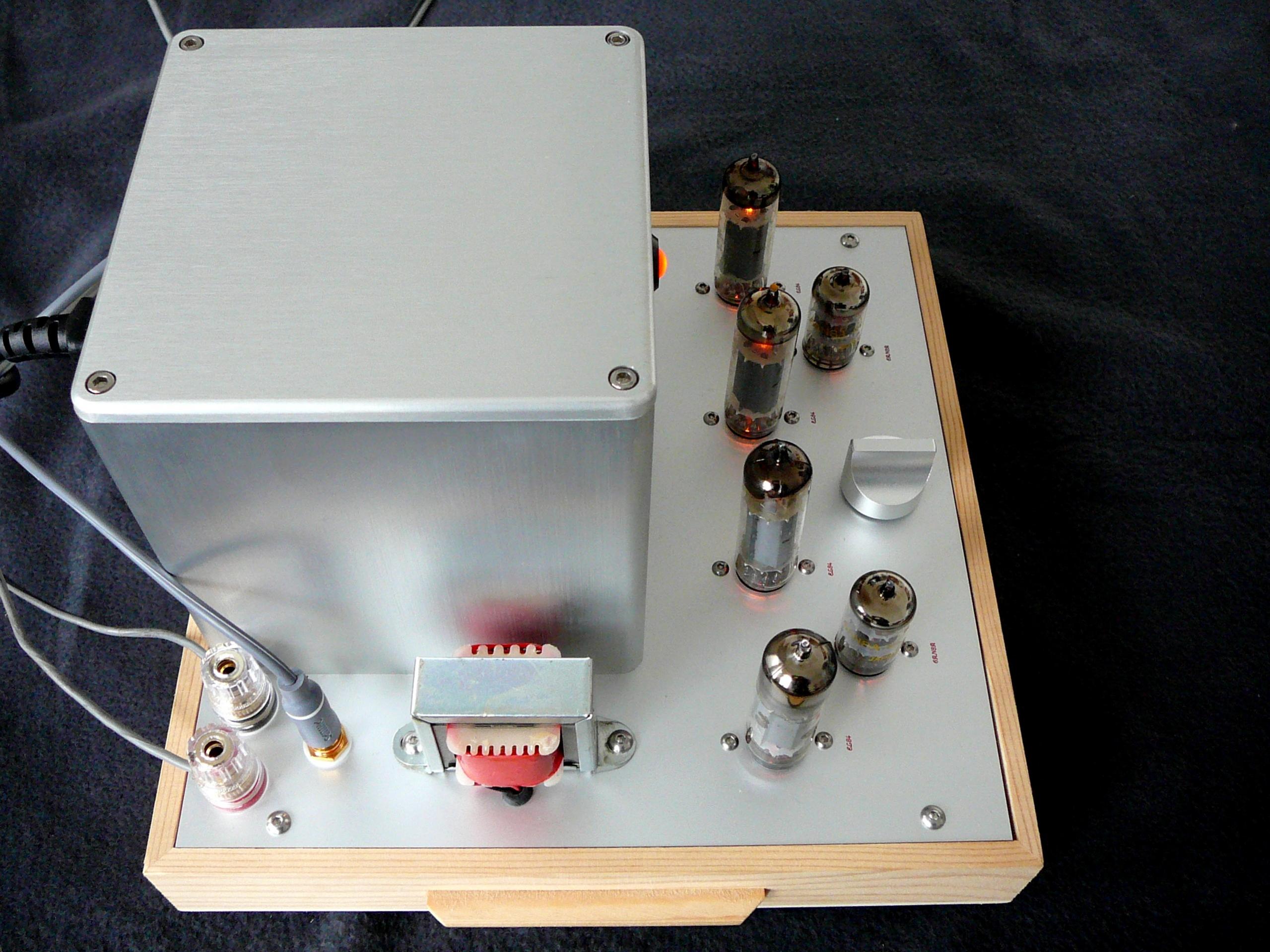

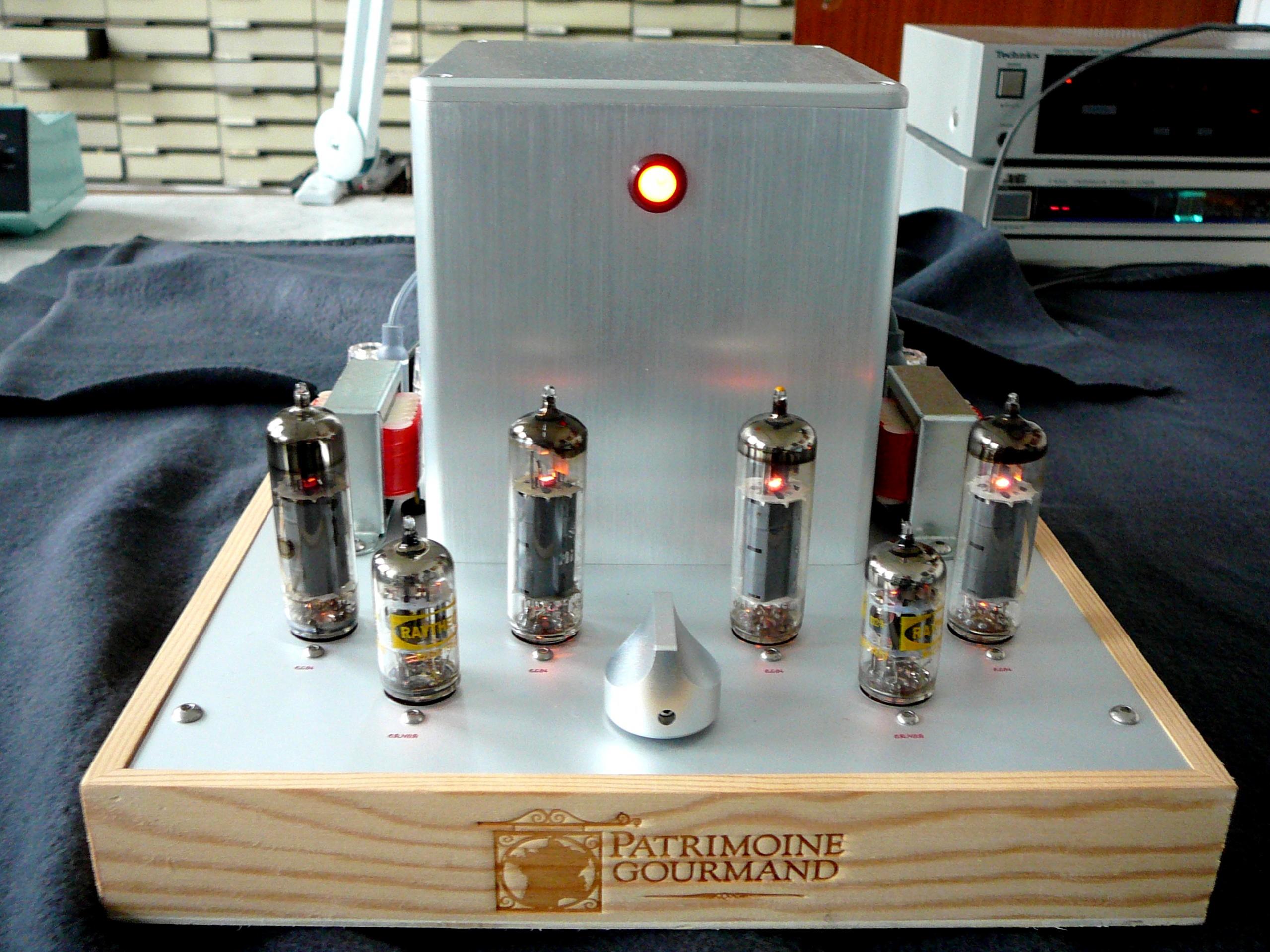

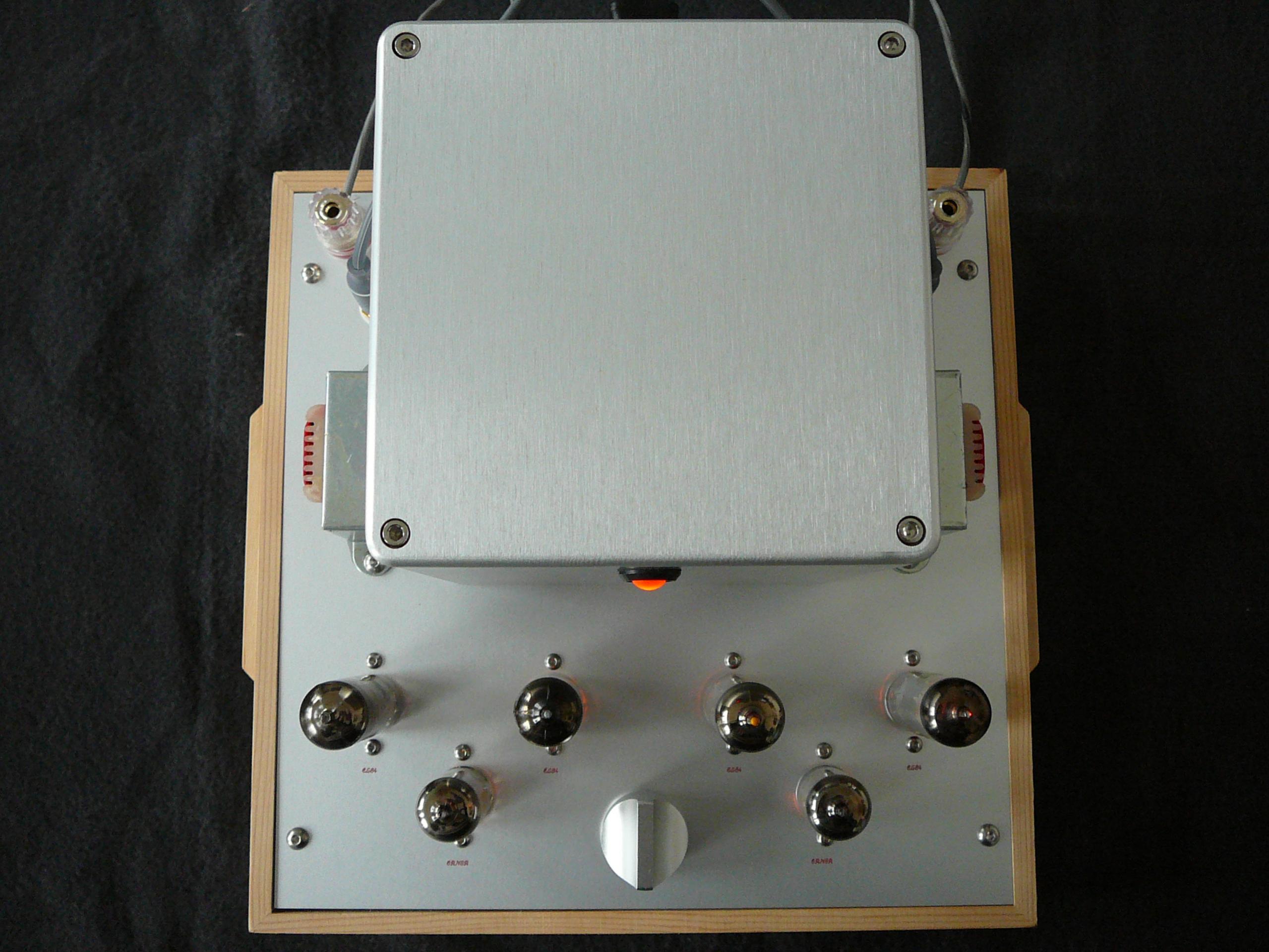

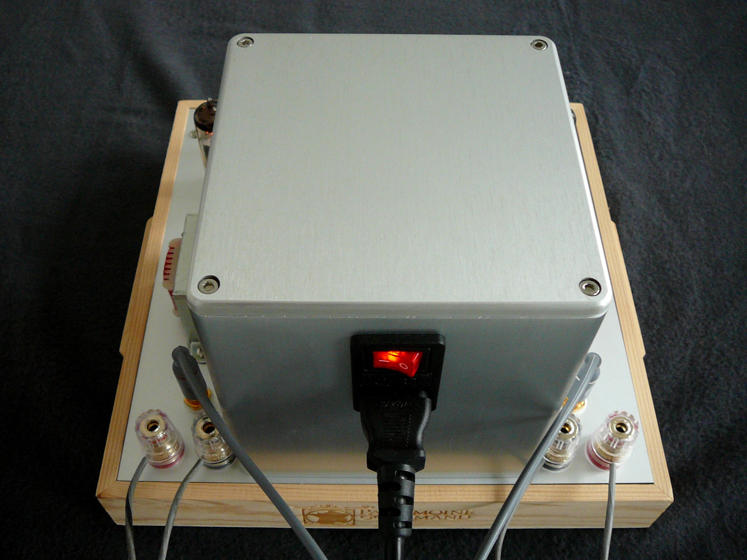

Cheese box amplifier
this is a stereo push-pull amplifier built in a cheese box.
The top plate was made by Schaeffer in Germany.
Tubes are 4 x EL84 and 2 x 6AN8.
The main goal of this exercise was the use of 100V transformers as output transformers.
Despite the small 100V output transformers, the amp is powerfull and the sound is not bad at all.🙂🙂🙂

I like the use of the power inlet on the transformer housing instead of below with other wiring. Isolate that from OPTs and that would SEEM to be a good approach.
Cheesus! Nice build!😉Hi,

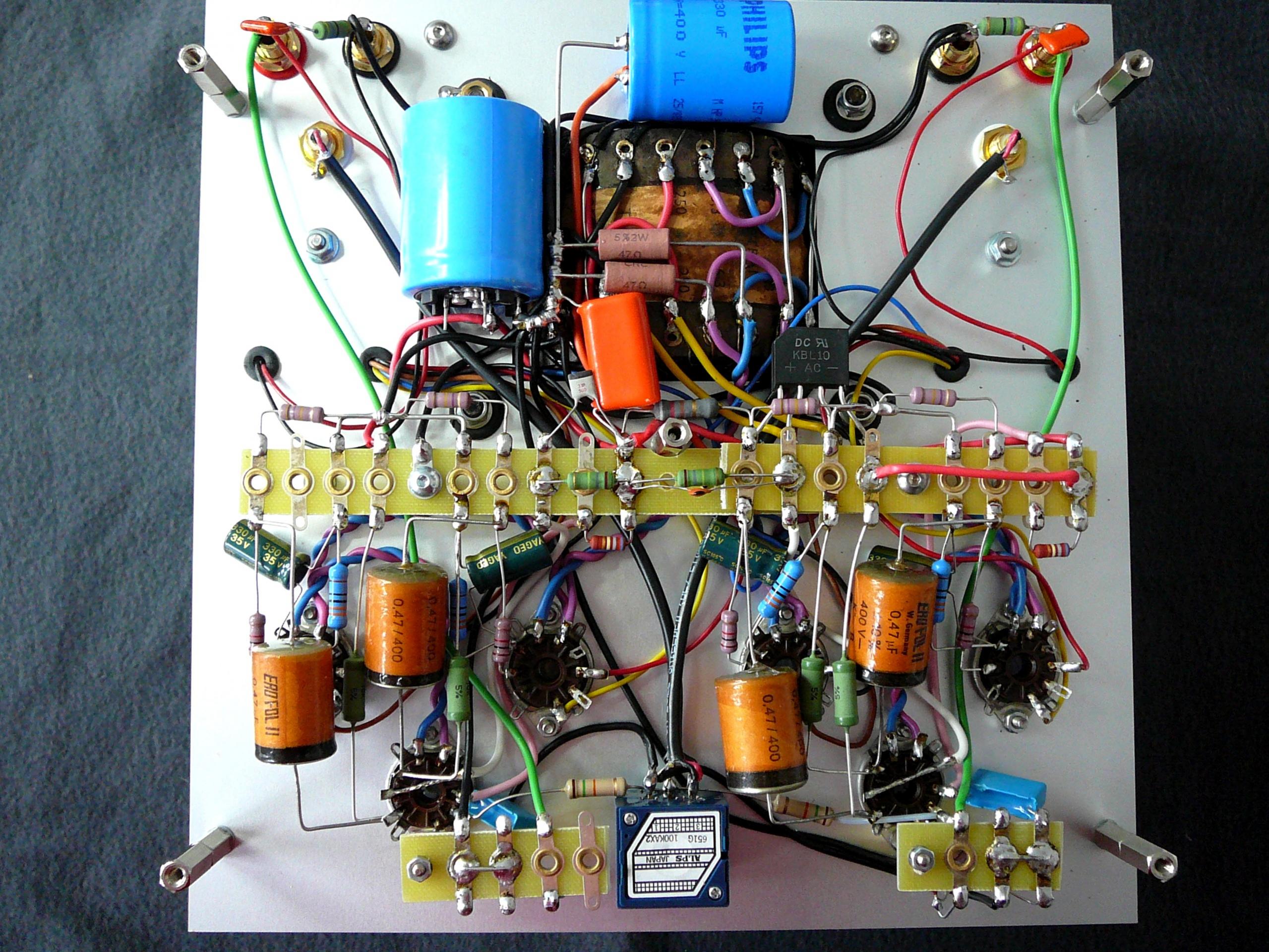

Yes, all power connections and transformer primaries are under the transformer cover, all secondaries are under the chassis plate.
The size of the cheese box determines the dimensions of the chassis top plate,
and the layout leaves no place for the power input and power switch.
The amplifier produces no audible hum or noise, but I doubt that this is the result of the aluminium transformer housing.
Best regards, Frans.
