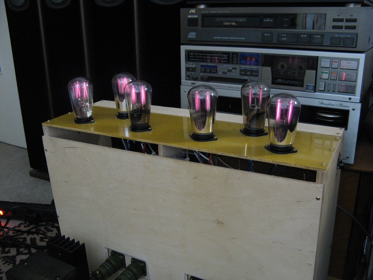

Here is one more, 5W per channel. Military sweep tubes, were classified. 🙂
Interesting tube. Elements look different from any tube I know (but my experience is admittedly limited). I'm enjoying all the work you're doing!

Thank you!
They are similar to Mazda Pen46. I suppose Raytheon and Mullard used own tooling and parts to get tubes with given properties, while Soviet plant used original Mazda blueprints.

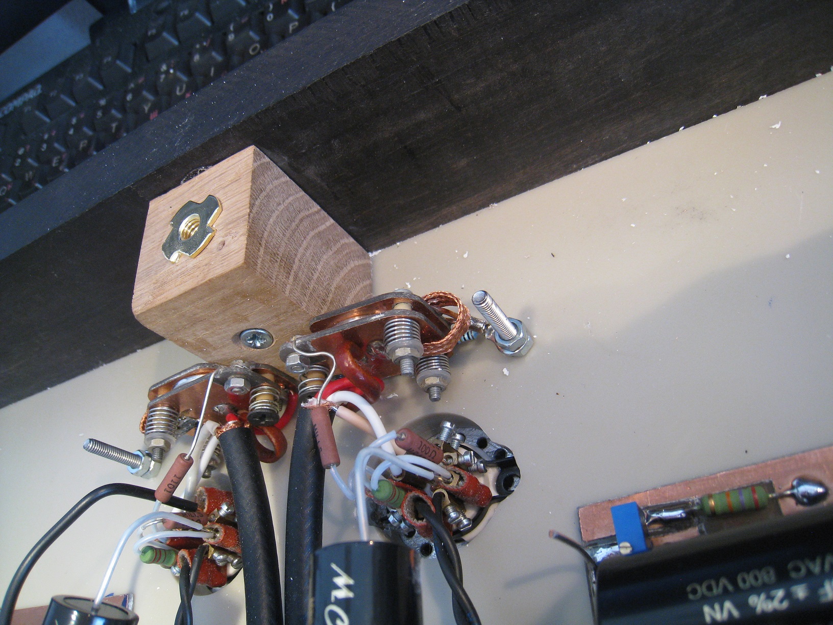

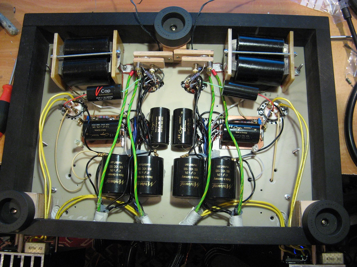

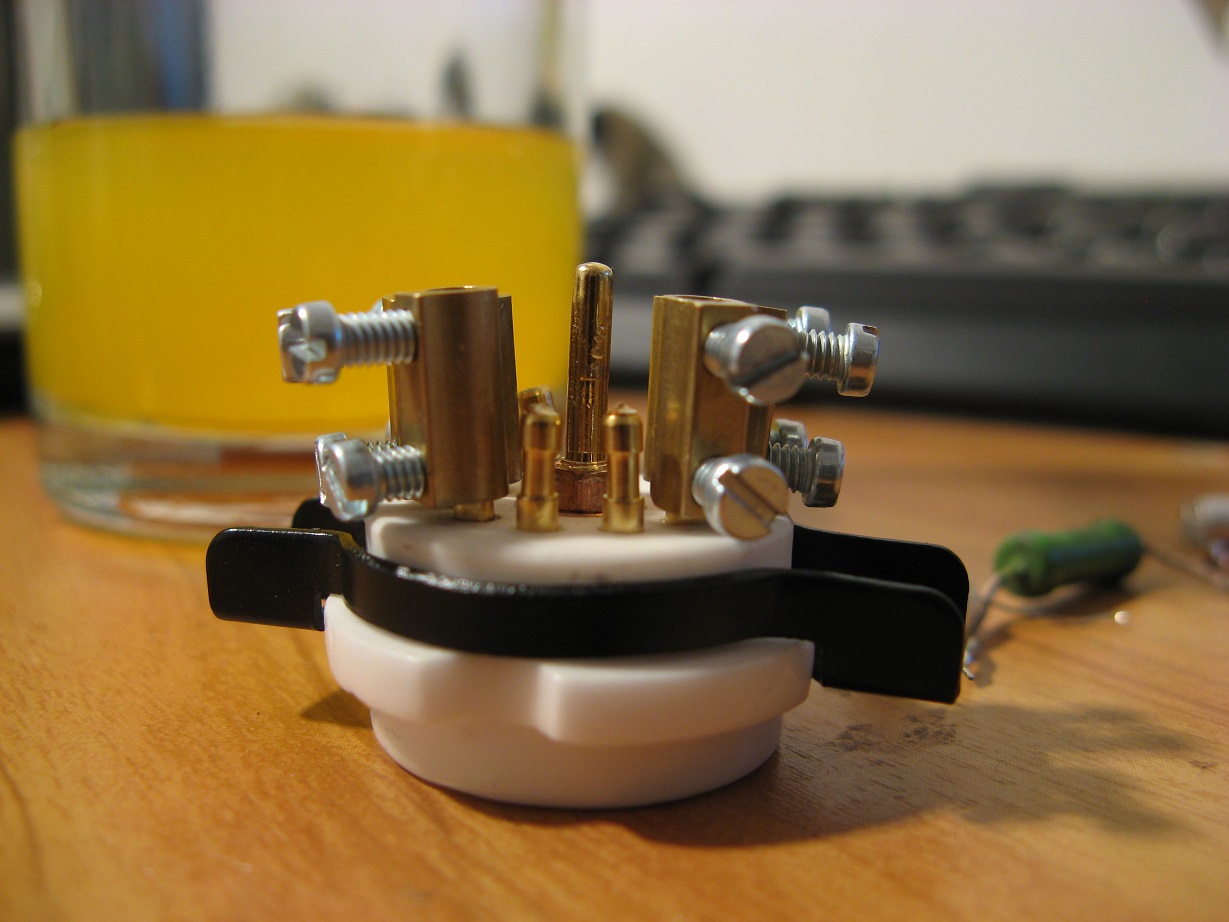

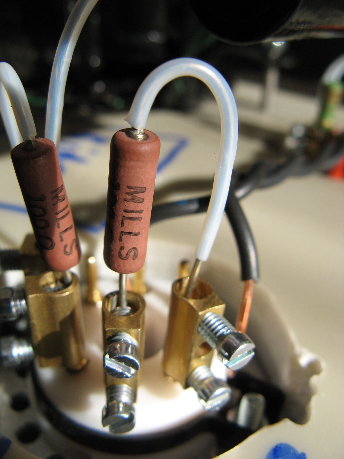

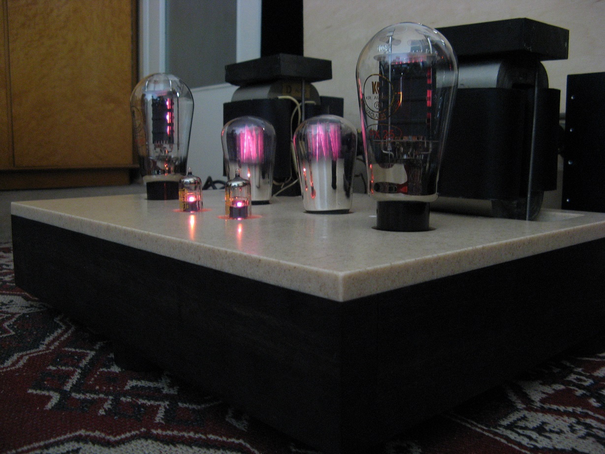

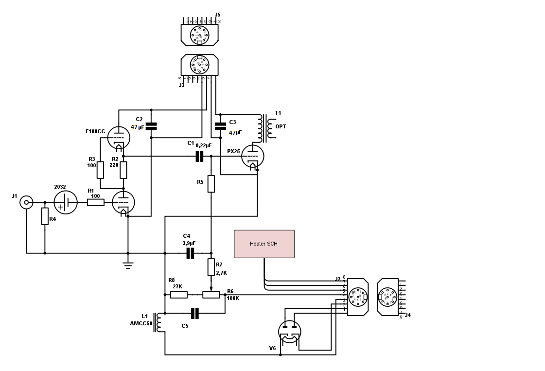

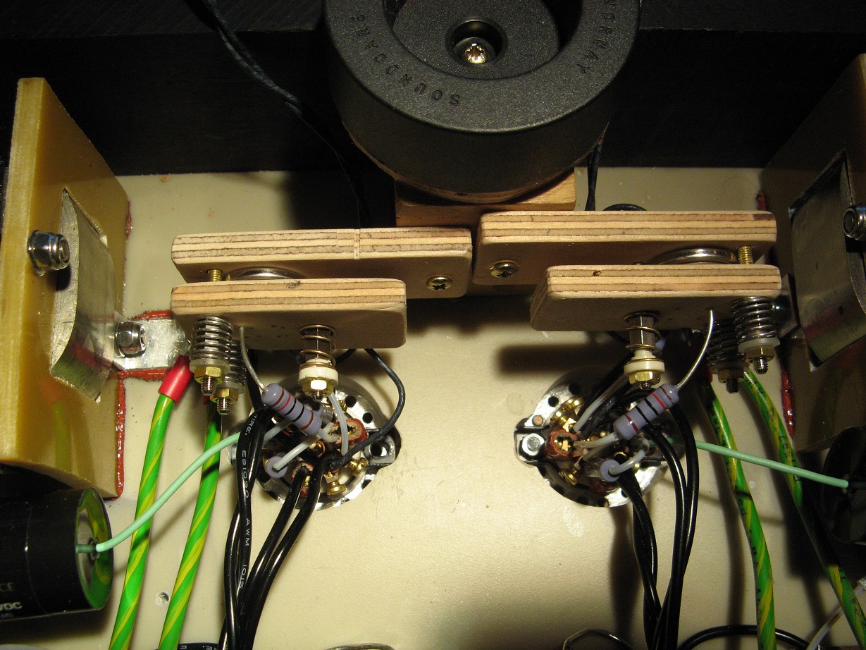

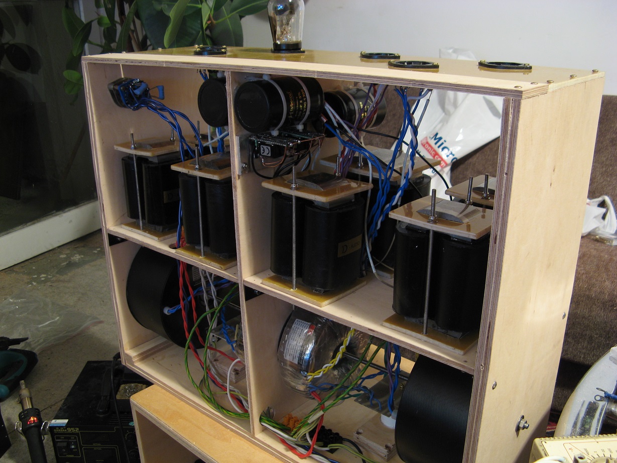

Dario Miniwatt E188CC + PX25 KR Audio, rectifiers - AZ1 Philips Mesh Plates.
Toroidal power transformers (heater/anode separate), 10 sectioned chokes on amorphous core, LCLC for anode supplies, LCRC for the bias. Output transformers - also on amorphous core (AMCC400).
Mundorf Mtubecap for the supplies (4x100uF/550V + 4x47uF/600V), Shinkoh TAF resistors, decoupling caps are V-Cap Elite Reference CuTF 0,22uF.
CCS/VCCS + shunt PSU for PX25.
Input tube - SRPP with battery (fixed) bias, output tube - also with fixed bias.

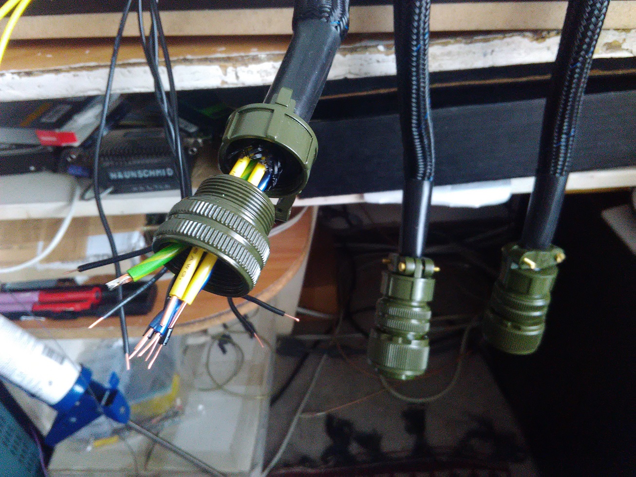

Wiring - Neotech UP-OCC monocrystal solid core copper, solderless where it is possible.
The best amp I have ever made!

Hi Milen,
Why did you use a solderless method? I think that it is kind of cool and would make substitution of parts really easy, but curious about your reasons.
Hi Milen,
In Bulgaria they believe in magic, like no FB, no capacitors, no solder, etc...

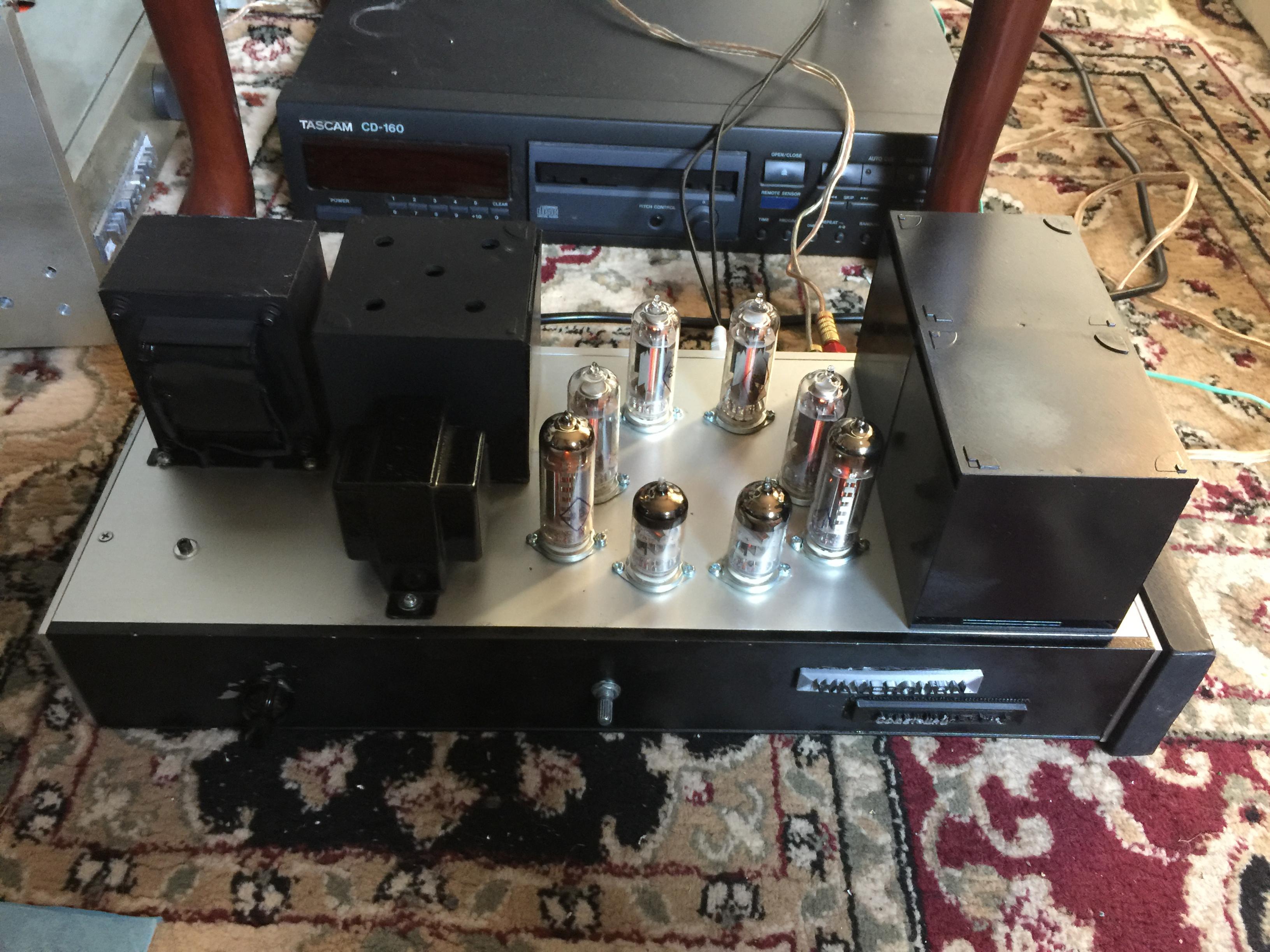

New amp is playing: 10W/Ch triode PP, class A1. The result of an experiment with driving 6S19P tubes. 🙂
https://www.facebook.com/Wavebourn/videos/1380727271985570/?hc_ref=NEWSFEED

Very nice, I enjoy to listen...😉
no wonder... Transylvania is around the corner there... the vampires sucked all the... solder from their tube amps! The only working protection is the tubes by Sylvania.In Bulgaria they believe in magic, like no FB, no capacitors, no solder, etc...
Unfortunately iPhone compresses, but there was no tone change when I increased loudness to maximum.
