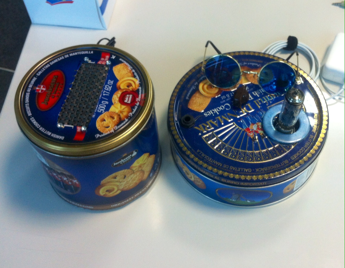

My PCL86 SE mono block
Hey guys, i had build a new one of a kind amplifier, it is builded with a PCL86 single ended, and encased in a nice Danish Cookies metal box, i had made for it a speaker cabinet in a different type of same Danish Cookies. here come the images, ahh, the amp is made on pcb.

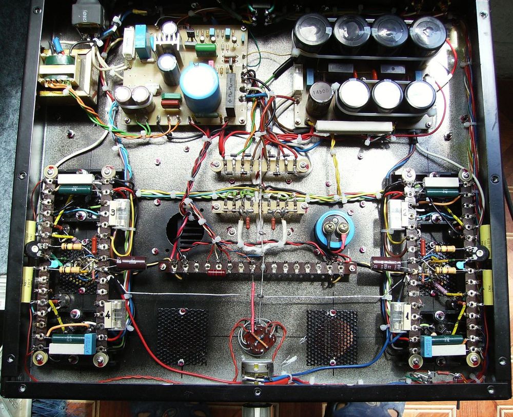

My Bi-Amp Monoblock
Finally finished my 2 Bi-Amp Monoblocks, with quite some technical support from some good people in this forum - thanks once again.
Monoblocks with two sections, 6SQ7 (voltage amp) - 6SN7 LTP Splitter - 2pair 6V6 push pull output stage. russian capacitors for decoupling jobs.
PSU: 5U4G, CLCLC 60uF - 6 Henry - 100uF - 16Henry -60uF per section
Signal fed by Parasound P/FET-900 preamp mono to each Monoblock and there divided to the two sections.
Simple hammond housing.

Nice build Thomas! is it your first? Great job!
I don't mind soldering. It's drilling which gets me down. Hard to build a tube amp without drilling a couple of dozen holes.
Hi soulmerchant
Yes, it is my first build, just realized how difficult it can be to get something running with only such a small amount of parts... I expected it to be easier.
Next time i would probably use an existing schematic for the start.
But it works, lets see what comes next.
Still have a bunch of tubes and stuff.
