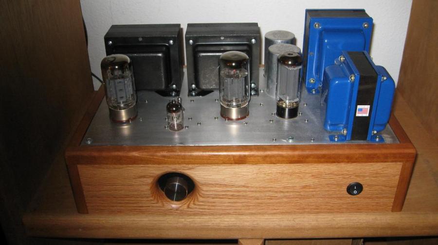

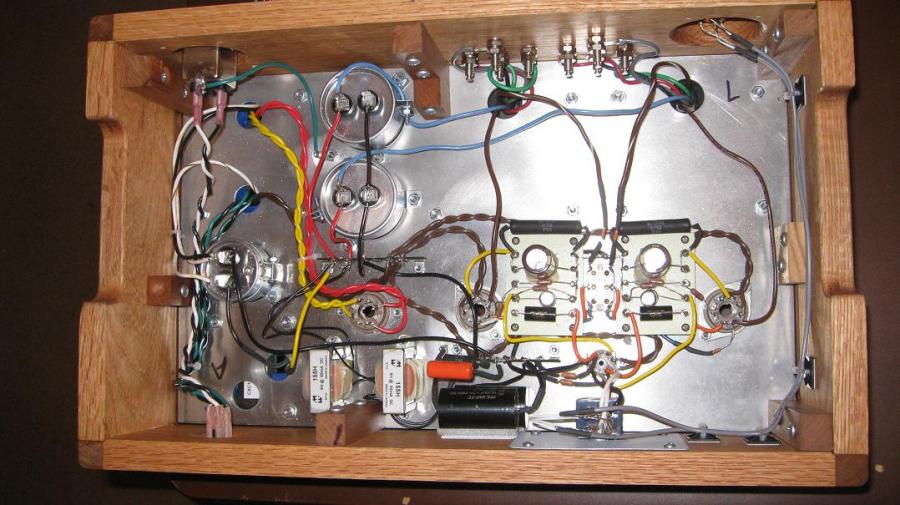

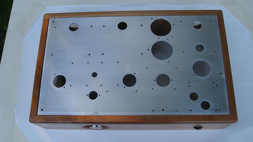

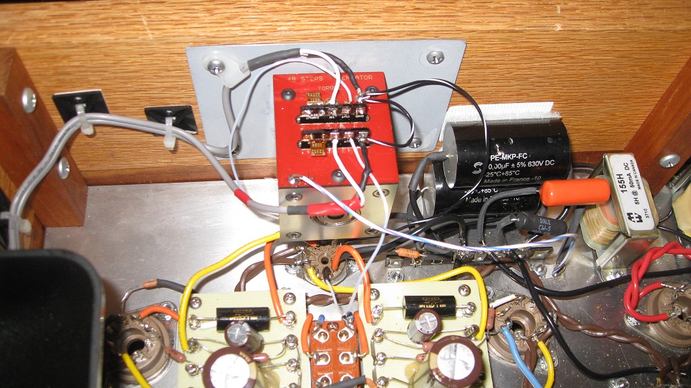

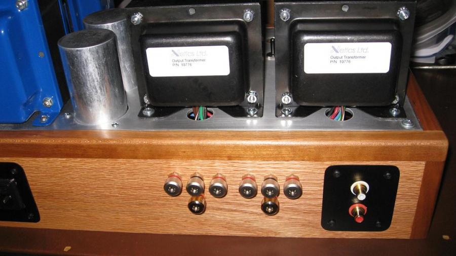

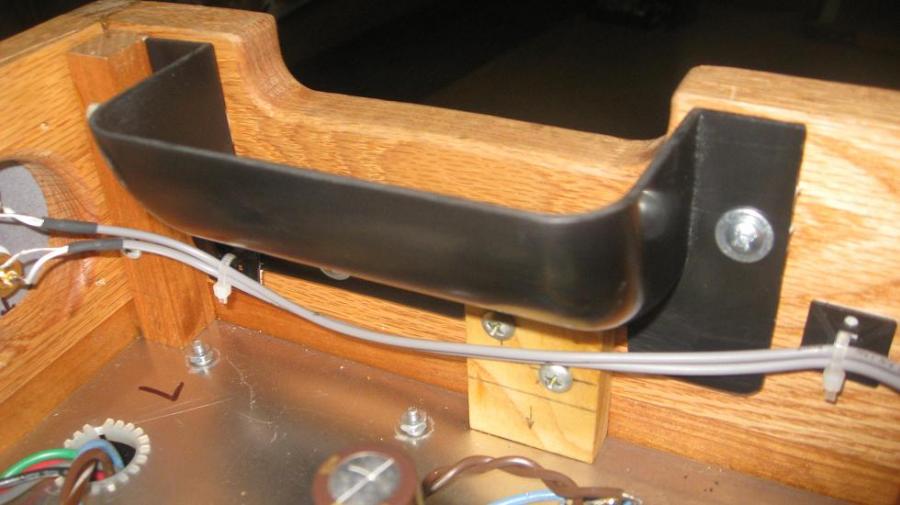

Here are some pictures of the SET amp that I built from a basic kit offered by a diyaudio forum member several years ago.
http://www.diyaudio.com/forums/vendors-bazaar/180897-kt88-se-basic-master-kit.html#post2428752

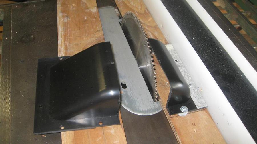

I like the natural beauty of wood, so I built my own case from oak and cherry, with an aluminum top plate.
KT88, 6550, or EL34 can be used. My preference is 6550 Winged C. Output transformers have 4-ohm, 8-ohm, and 16-ohm taps (not from original kit). Output is around 6-8W in triode mode, and probably 11-13W in ultra-linear.
I've replaced the ALPS pot with a Khozmo 48-step attenuator. The shrouds around the hand holds were made from a PA speaker handle recess.
I've really enjoyed it over the years.

Dave R,
Nice build. I see the volume and power button have swapped places in your amp?
Thanks. Actually, the volume and power buttons are still in the same place. The wiring pictures were taken from opposite sides of the chassis.

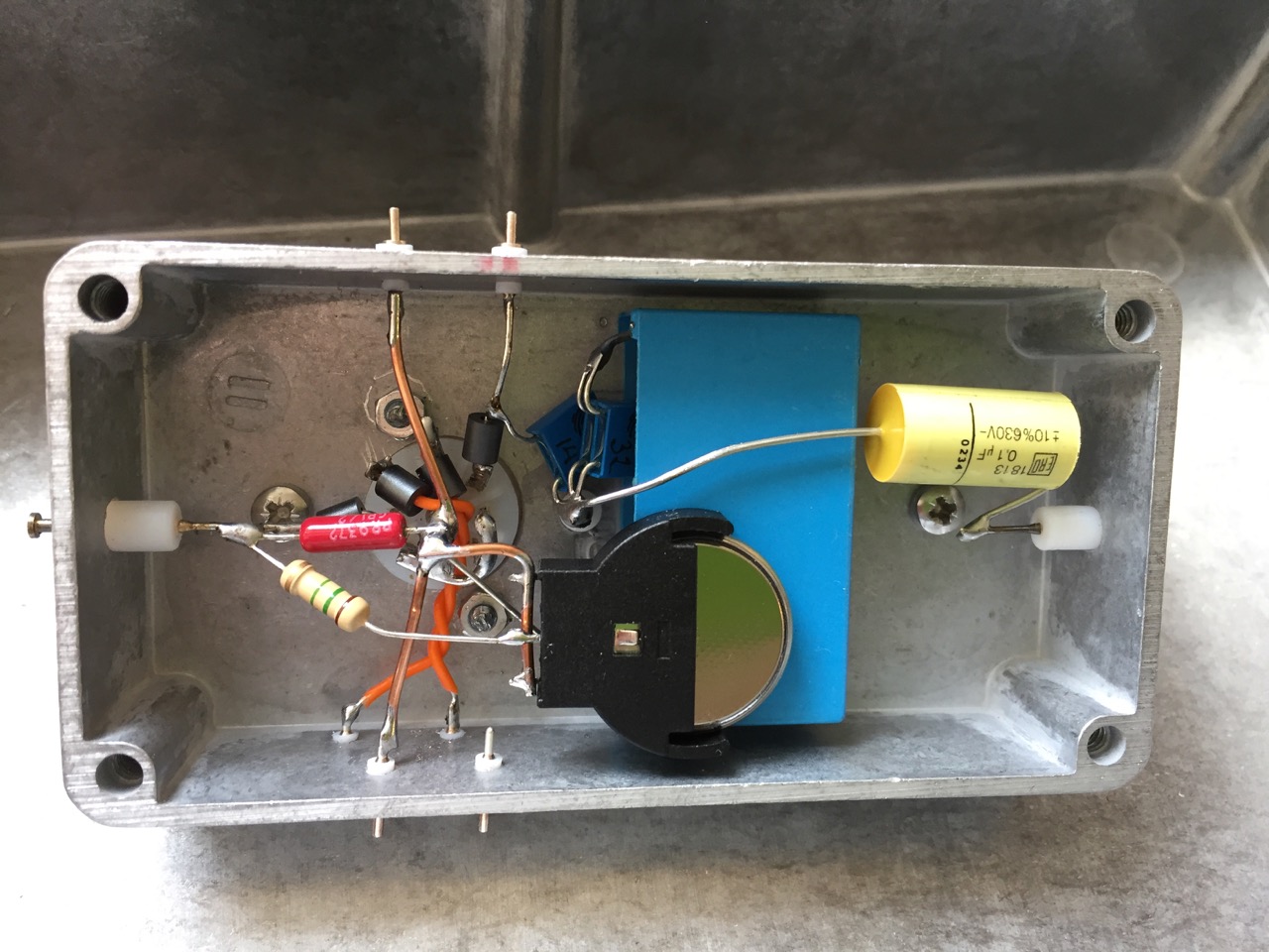

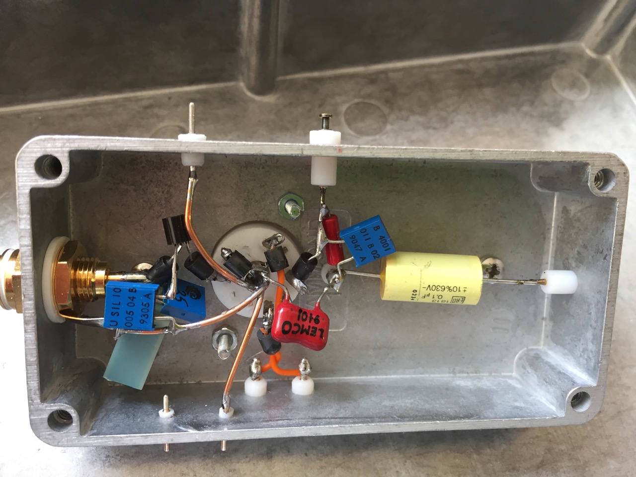

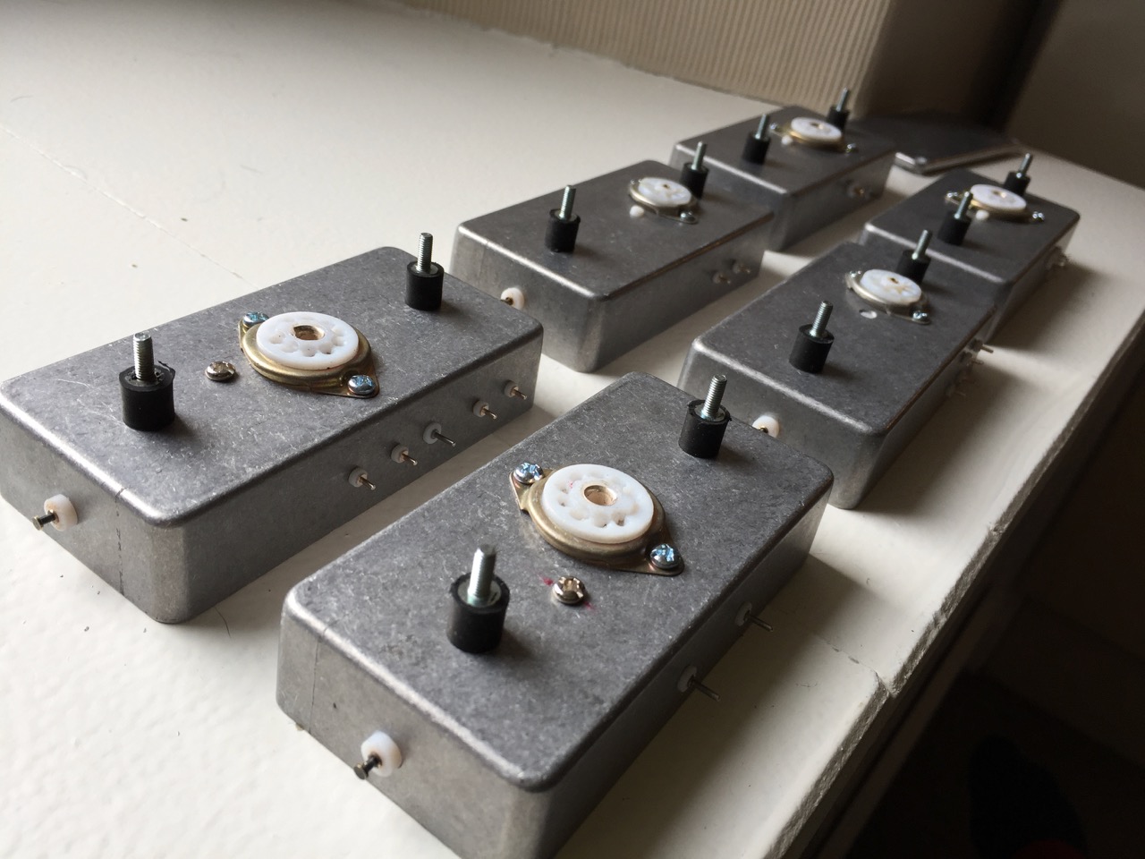

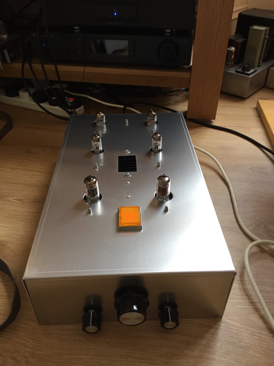

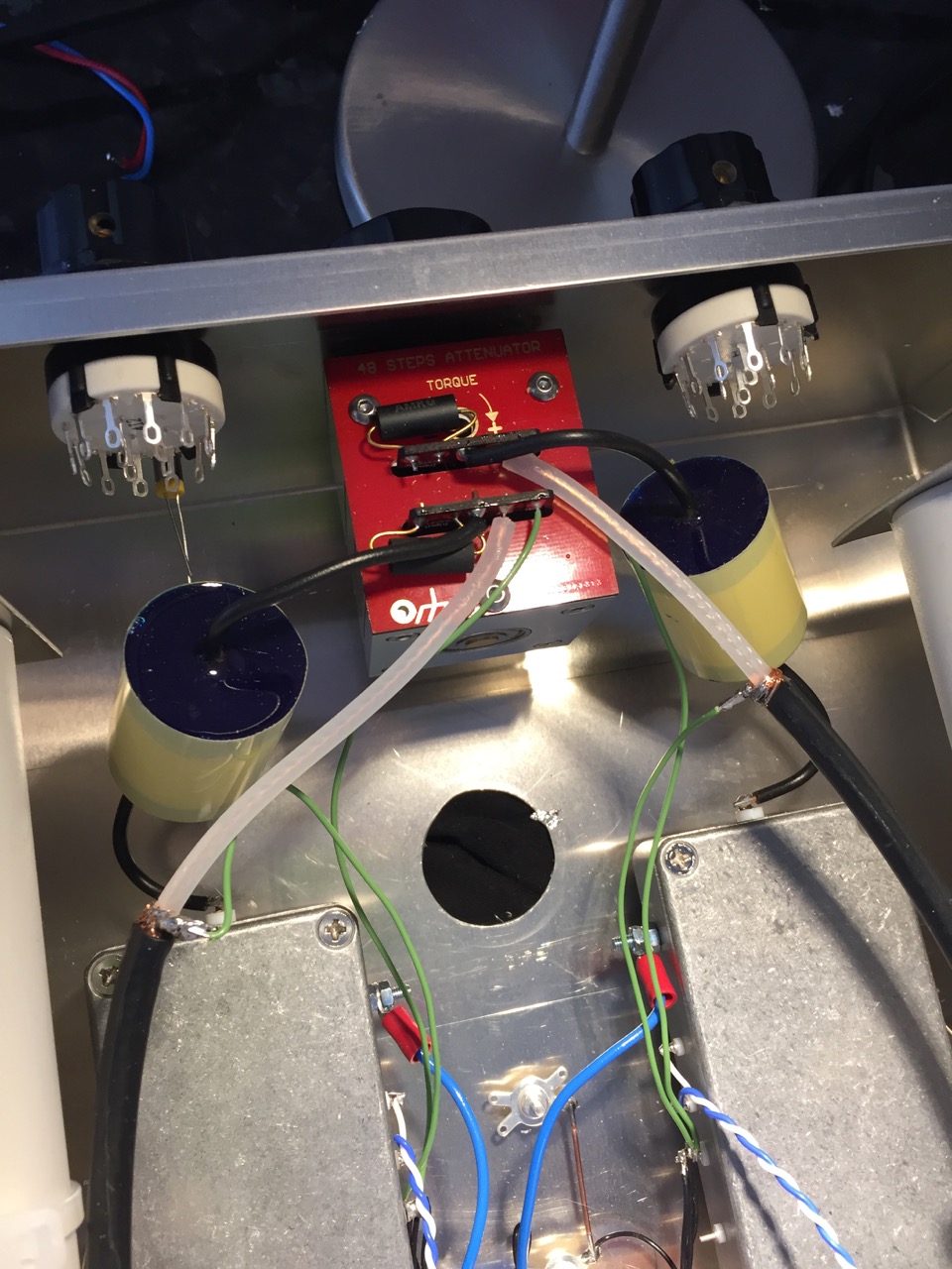

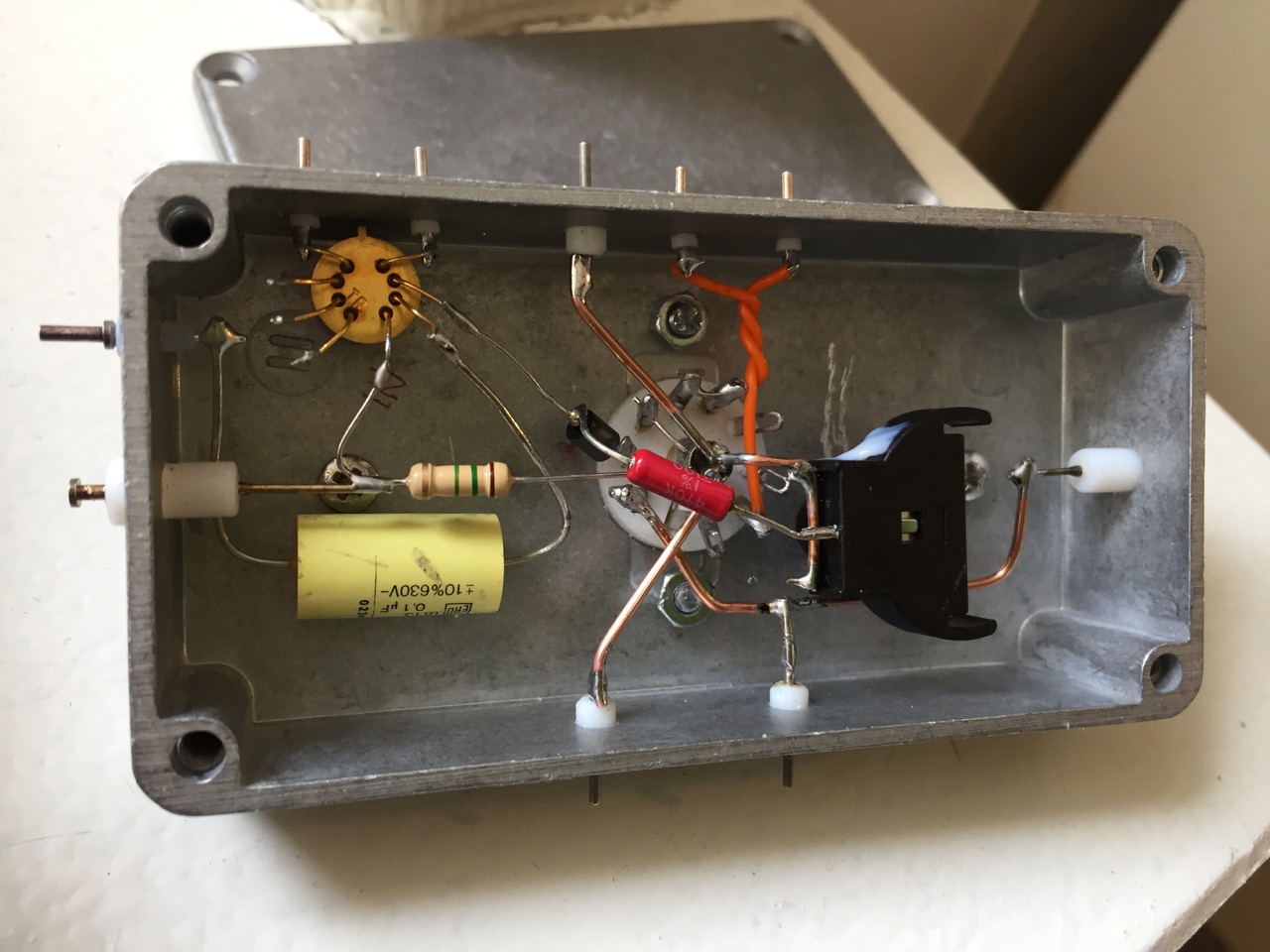

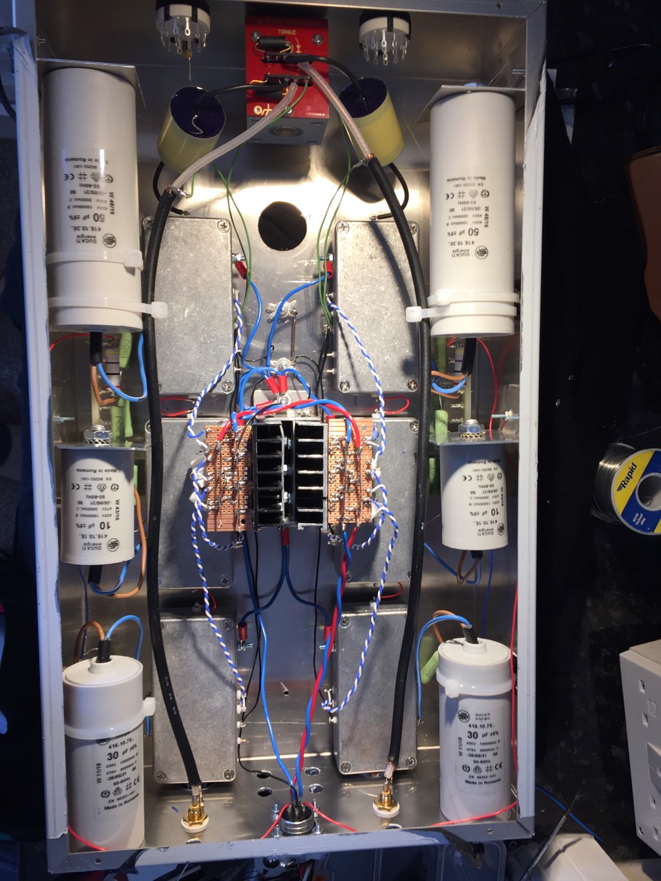

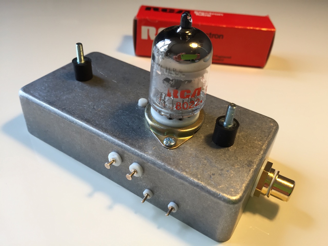

Toccata 417a/6GK5/5842 Phono Stage
This is a well known design originally by Arthur Loesch and updated by Thorsten Loesch. Details of Thorsten’s version and build here.
I have more or less followed the design but decided it would be interesting to give each stage its own diecast box to improve screening and reduce potential interactions between the different amplifier stages. I used matched 2SK170s rather than the 2SK147 in the schematic due to availability.
Sounds really good so-far with my Linn Krystal. Very quiet, good at resolving fine detail and able to carry a tune. I had none of the reported oscillation issues with the 417a so cutting off spare grid connections on the valve socket and using ferrite beads seems to have worked.

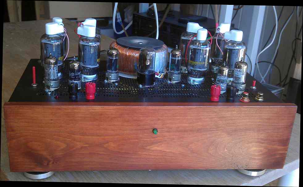

Futterman OTL
I have just completed a new Futterman build. I more of less stuck to the schematic attached, but replaced the cold cathode voltage reference tubes with 5w Zenerdiodes. They start regulating at around the same current flow as the reference tubes and they are much easier to fit.
It uses 4 6gy5 tubes pr. channel - and delivers around 20 W into 8 ohms. I have experimented a little with the bias setting. Originally Futterman ran his output tubes up to something like 70-80% of their capability, which is very hard on the tubes. I run them at around 50mA pr. tube - and can't detect any downsides to this. The THD is still around 0.1% and sonically I can't detect differences either.
I mostly used off the shelf toroidal transformers, but added an extra 150Vac winding for the screen grid voltage and a 30Vac winding for the bias (I use a voltage doppler). The heather transformer in below deck - the B+ on top.
The amplifier is built on the remains of a Technics integrated amplifier I butchered some time ago.
In the bottom there is a slow moving fan which keeps the whole thing quite cool.
