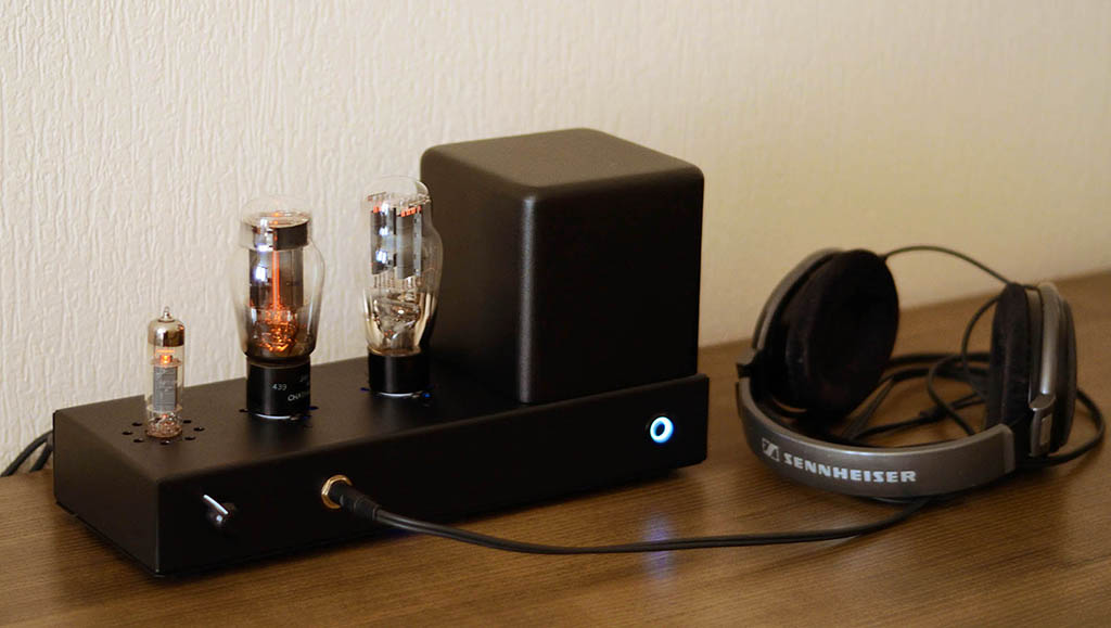

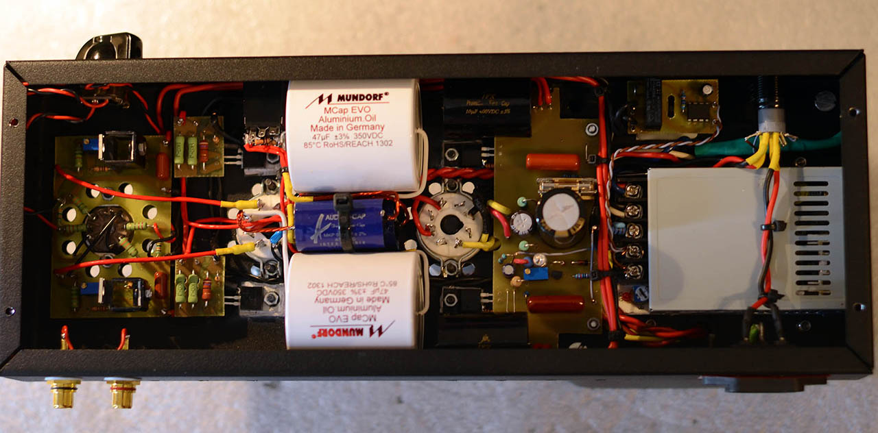

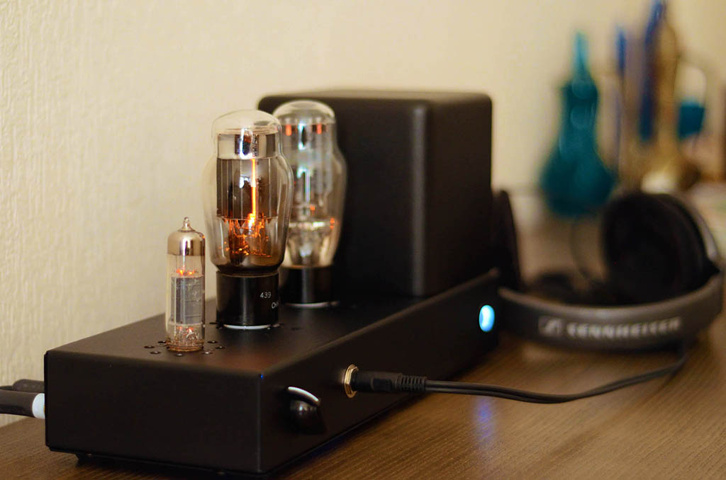

Hello, this is a headphone amp that I've built. It's the classic 6AS7G cathode follower OTL, with a few improvements.
The voltage amplifier is a E80CC (very nice tube), depletion mosFET CCS loaded, DC coupled to the cathode follower, which is also CCS loaded (bonus - the CCS avoids bias problems on startup).
The outputs are coupled through a pair of Mundorf MCap Oil + Audyn true copper to my 300 ohm HD650.
The PSU is a double (one for each channel) stabilized source follower with 2x10µ MKP on the output. The rectifier is a russian Svetlana 5Tz3S (5Ц3С). B+ is delayed by a 555 timer.
The 6.3v heaters are supplied by a small 4A soft-start switching PSU.

very nice headamp Vincent, your choices have worked well - I love the large bottles and their glow against the black chassis.

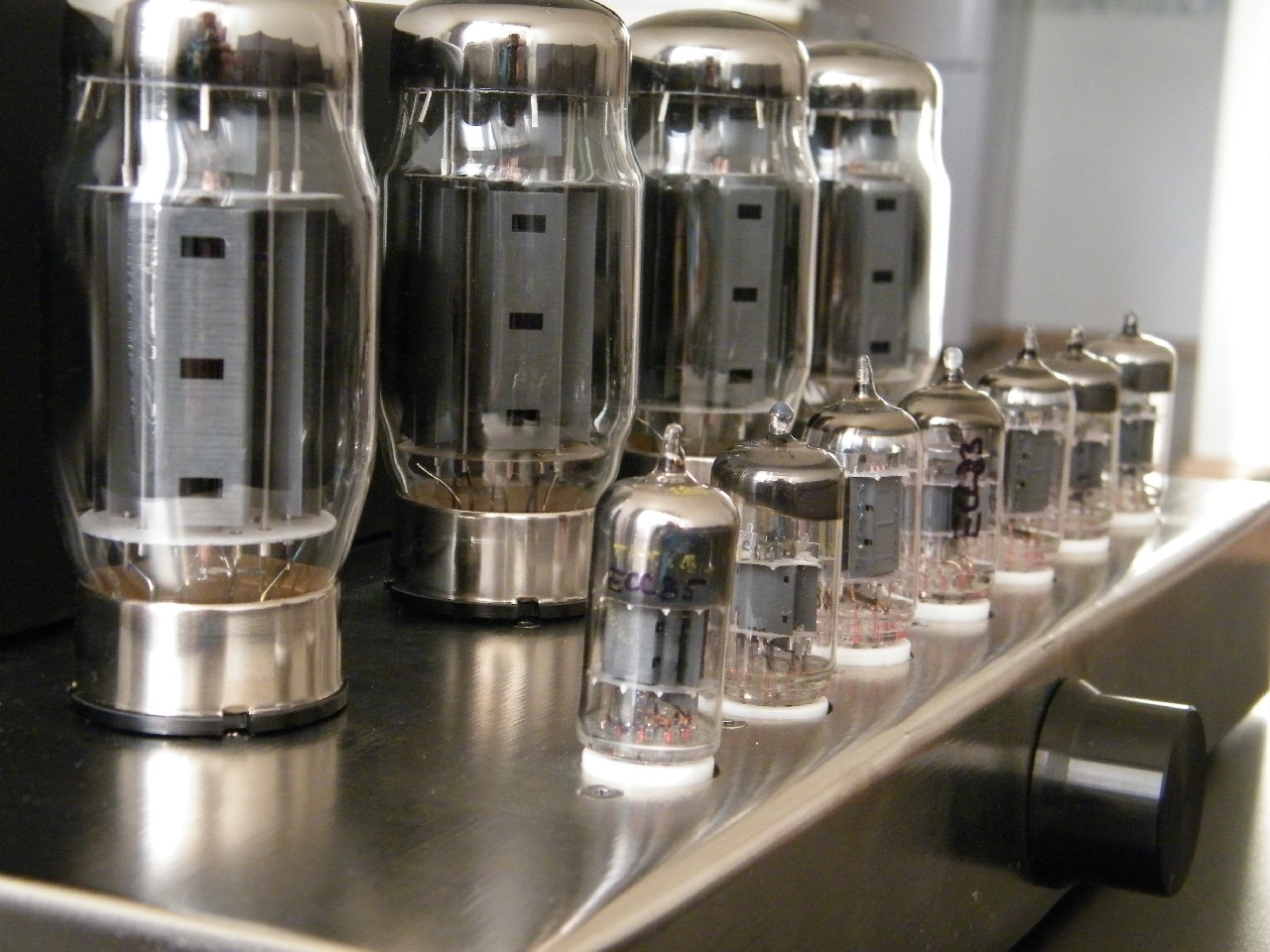

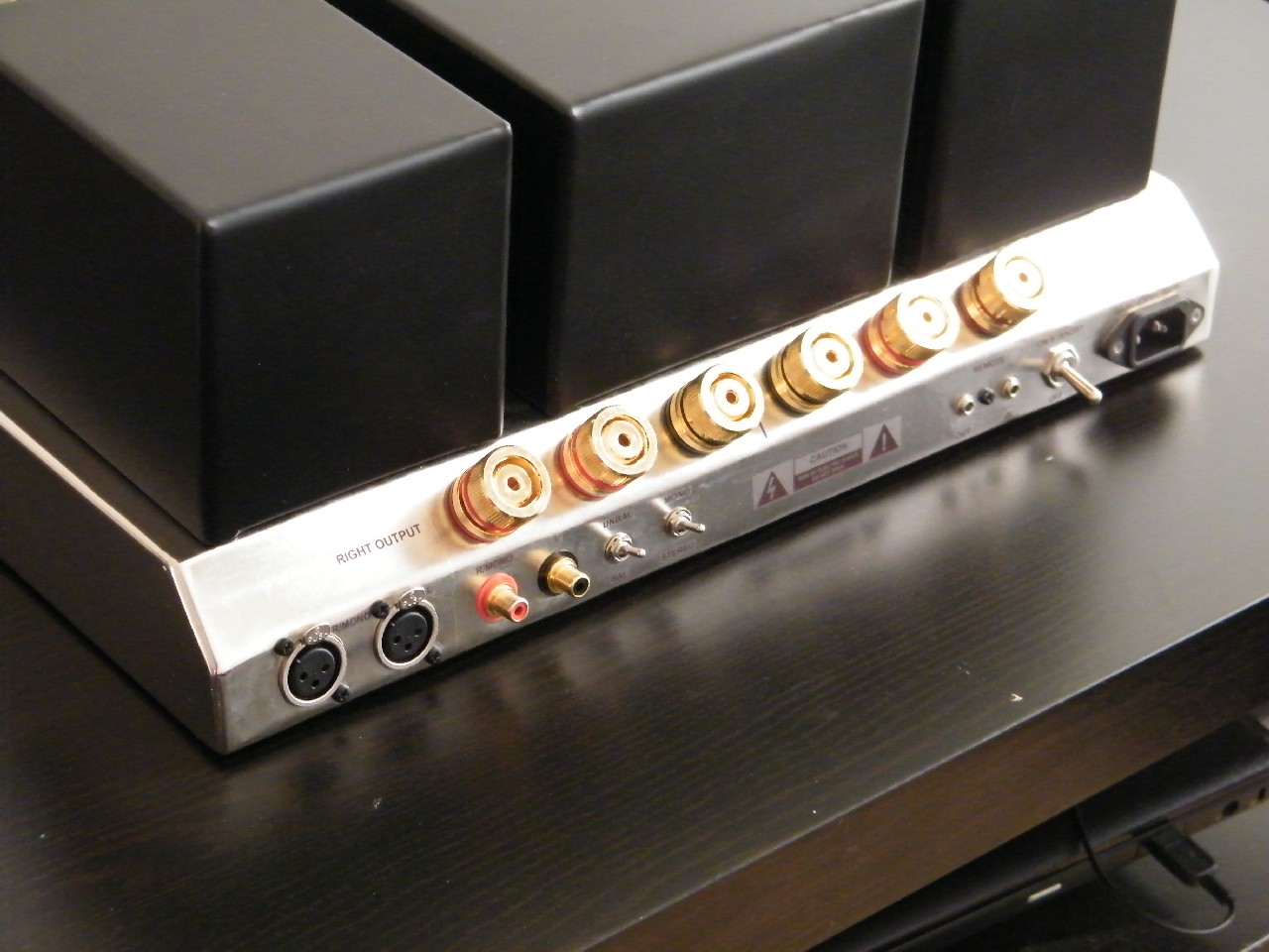

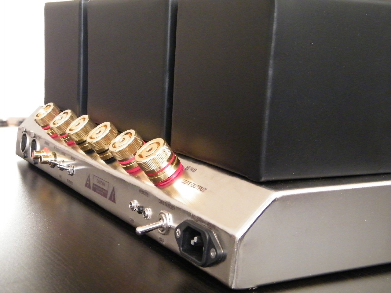

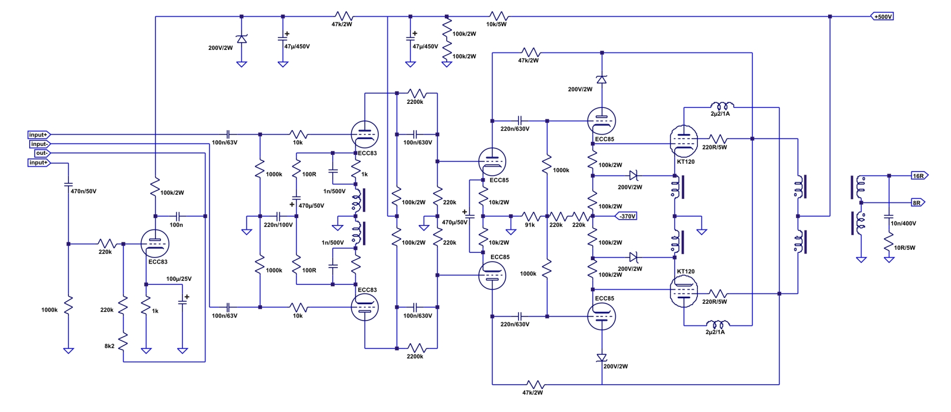

Hi guys,

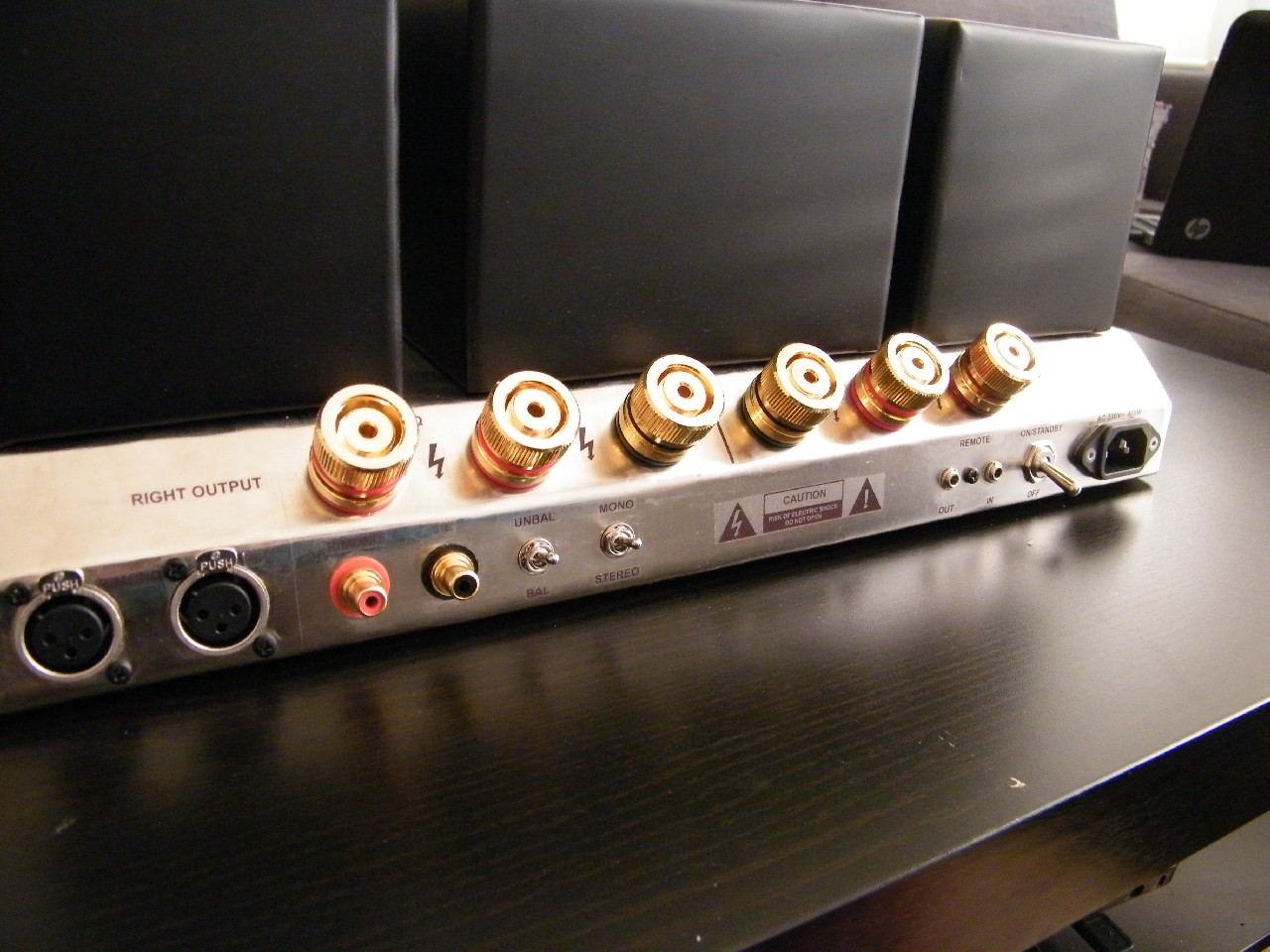

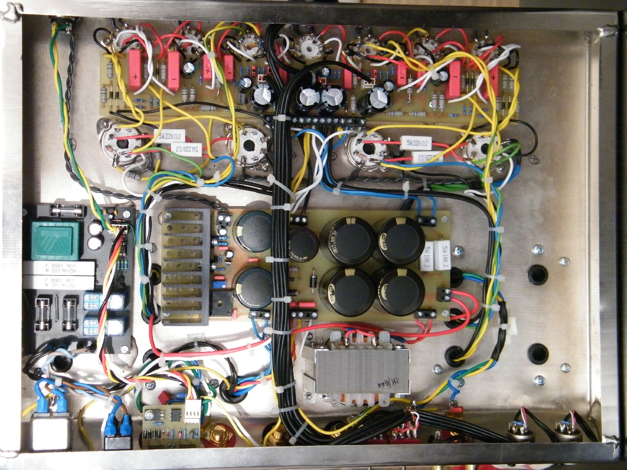

since there was no McIntosh MC275 clone on the web (at least I think so) I have decided to build one from cratch 🙂

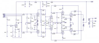

Schematic is some kind of MKIV version of this amp with some modifications and inproovements, meaning that it is full-symetric from input to it's output even including full-symetric global feedback implemented to cathodes of the first stage. I have used 4xKT120's Tung-Sol for the output stage, 4xECC85 Tesla (12AT7) for driver followers and amplitude driver stage and 3xECC803S from JJ for pre-amp stage. The biggest problem was output transformer design, because there was very little information regarding this issue on the web, so after few months of study how this whole thing works I calculated a lot and designed mine own output transformer from scratch for this purpose.
Output transformer includes 2 bifillarly winded abosolutely separated symetric primary windings with Raa=750R winded with dual isolated wire to handle 500V DC potential that is between these wires. Because of price and simplicity it has only three sections of primary interleaved with two secondary sections and two feedback winding sections. The feedback winding is winded bifillarly and connected symetricaly for better "covering" whole surface of the winding for handling the high frequency characteristics with both halves of the symetric sine wave of feedback. (high frequencies transmitts not so much throught transformer core than through local electromagnetism on the surface of the wire). Secondary section is standard with 8R and 16R taps. The transformer core is 40x40mm made of high grade silicon steel.
Measured technical parameters:
RMS Power = 100W (one channel driven) or 2x72W (both channels driven in stereo mode)
Total THD = below 0,1% until approx. 25W, 0,18% for 50W @ 1kHz.
Frequency response 20Hz-20kHz with no drop over the range (maybe +-1dB max.). I was unable to measure higher frequencies due my hardware. I will measure this somewhere else at least for 100kHz, because I am very curious how far this amp can go...
Below you can see some pics of the amp 🙂 enjoy!

That is an awesome build Wiliks!
How long did it take you from start to finish? And would you do it all over again? And if you did, would you change anything? Just curious because I haven't seen anything like this here or nearly anywhere else.

Thanks 🙂
It took whole about 4 months, I mean all from designing things to realisation. Some things went faster - some slower, because I had to wait sometimes to get parts etc. Probably took longer also because I was doing it over evenings after my work...
And yes, If I had time, I would do it over again 🙂 but probably I would change some things. I have used only 400W toroid transformer, which is obviously not enough for max power (I used that one because I already had it from another amp). Also my transformer has symetrical secondary for anode voltage, this is also disadvantage that only rises internal resistance of the transformer so power is not so tought as it would be with only one non-symetric winding. Probably filter choke is too overboosted (1H/600mA), maybe better would be 0,5-0,8H / 800mA. Also stabilised heating power supply for small tubes with slow turn-on is very great high-end thingy, but it is kind of overkill and it just produces extra heat in chassis. Standard filtered psu without stabiliser would be enough for this purpose. And to the last, I would probably not do that via the same style as PCB-wire-socket style, but all-PCB style. Because it is really sick to wire so many sockets with PCB board and mainly the output tubes where are many wires not even between transformers but also between the sockets, so I think all-PCB solution would be probably better but more difficult to design PCB. But I didn't know if the amp would work or no, so my way is at least a bit better for some modification.

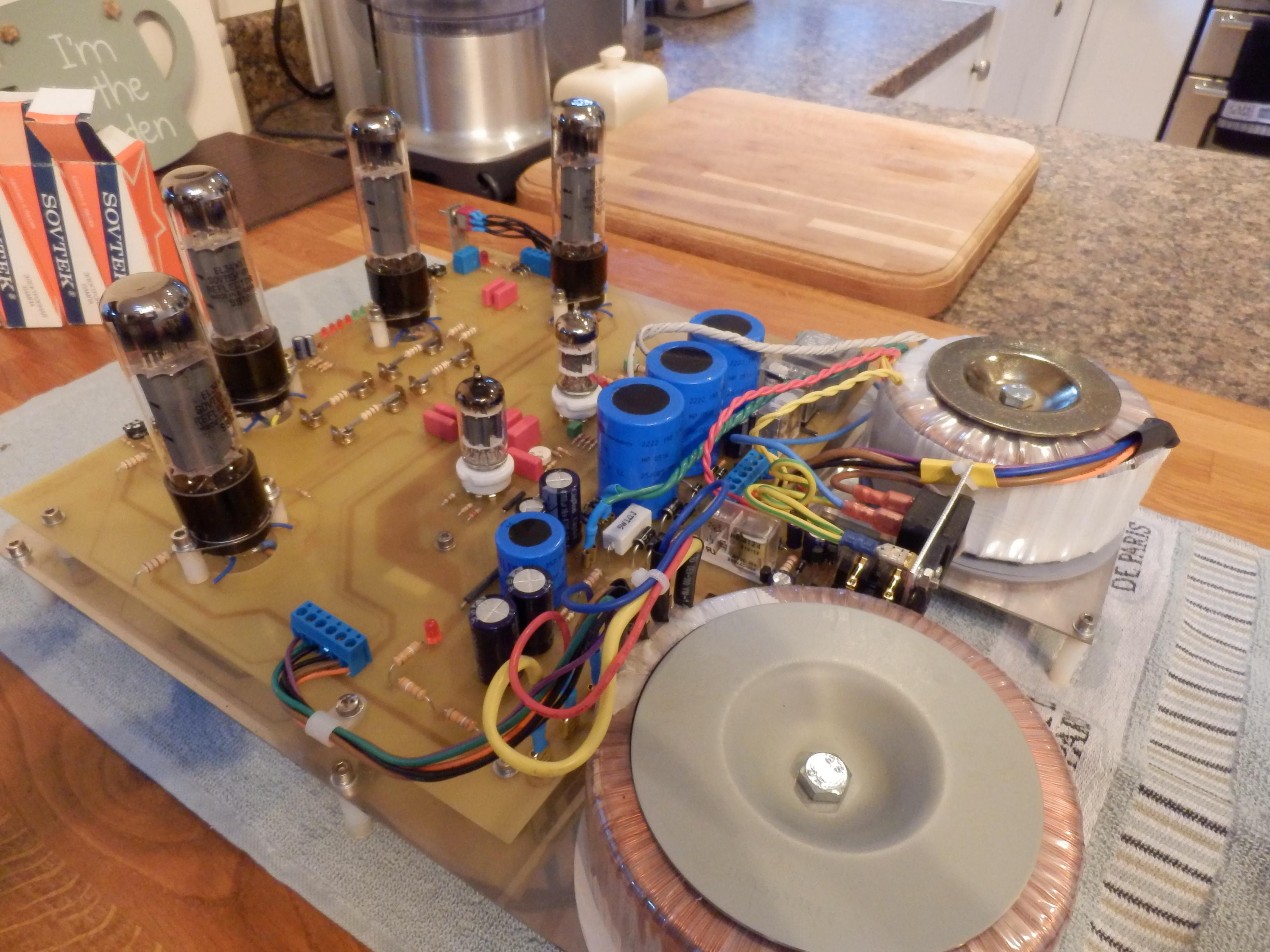

90w EL34 monoblocks

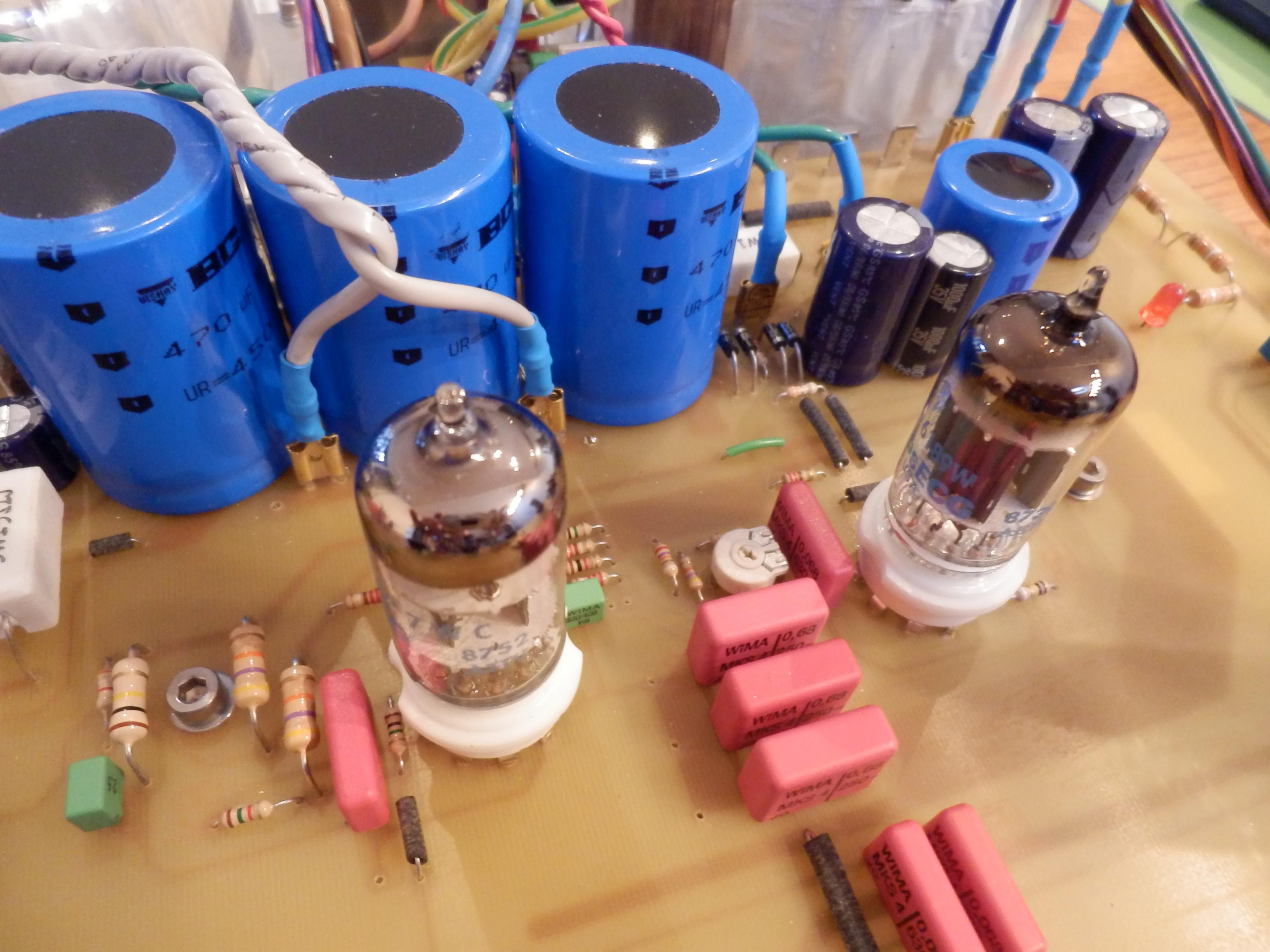

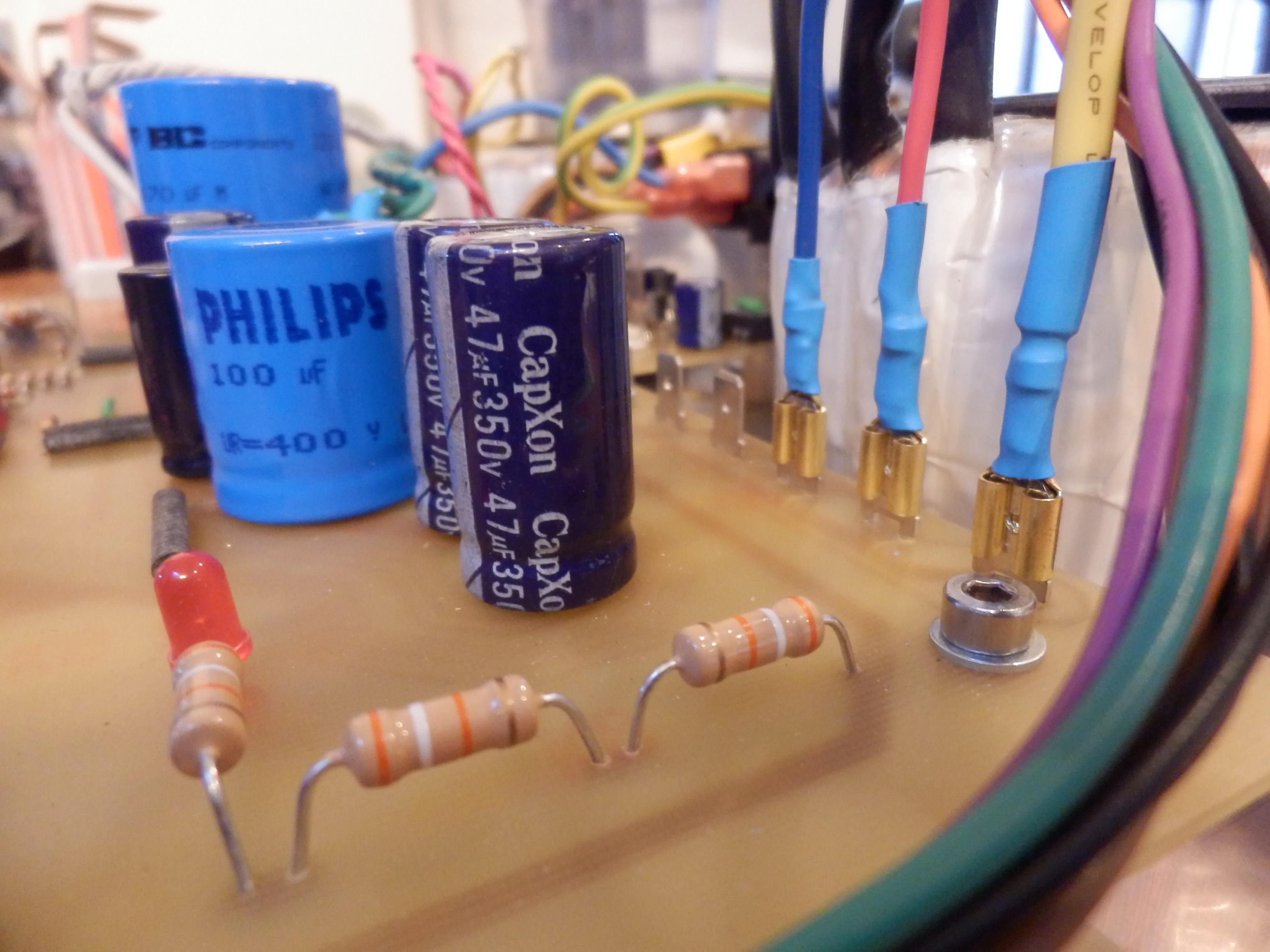

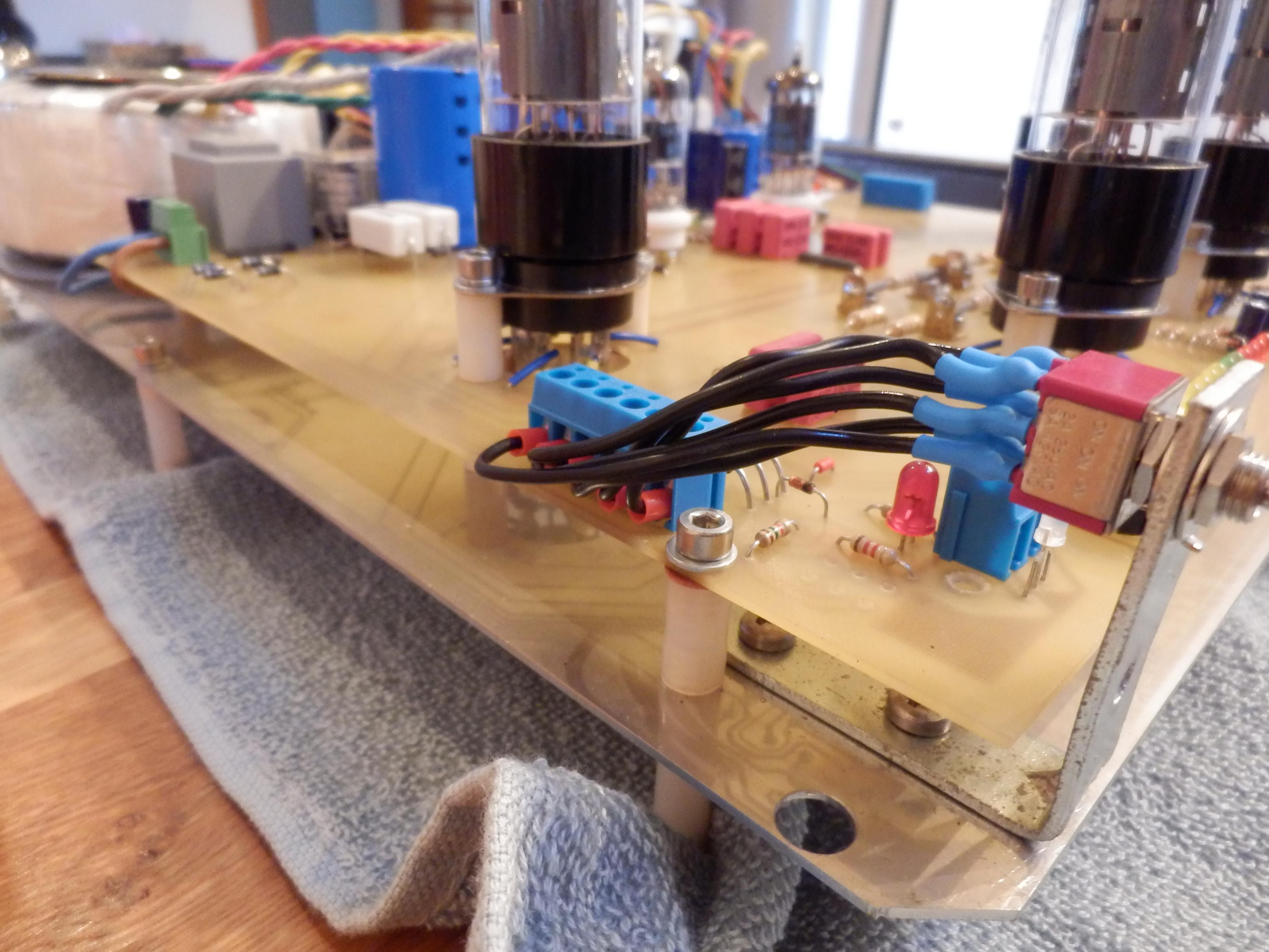

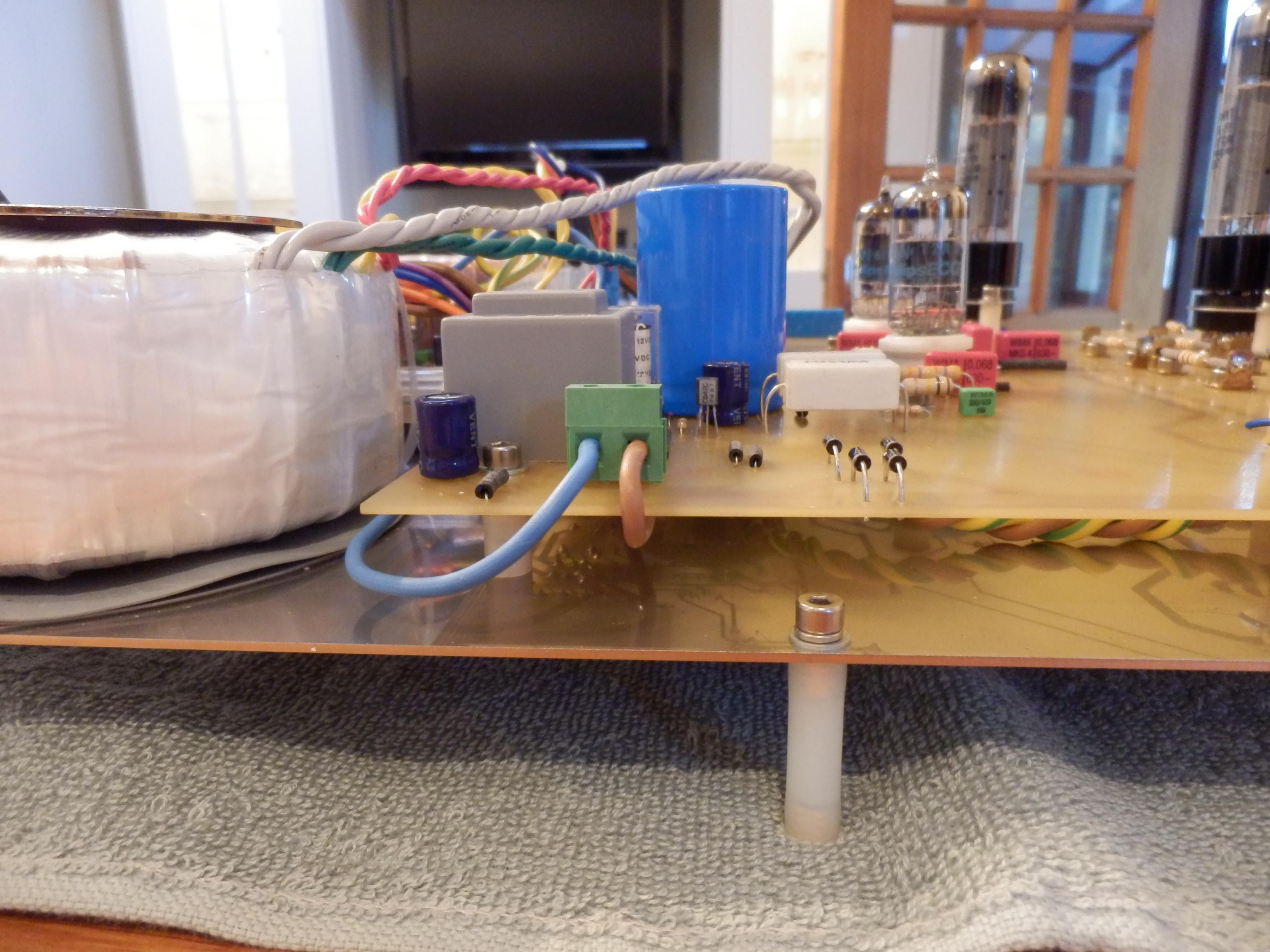

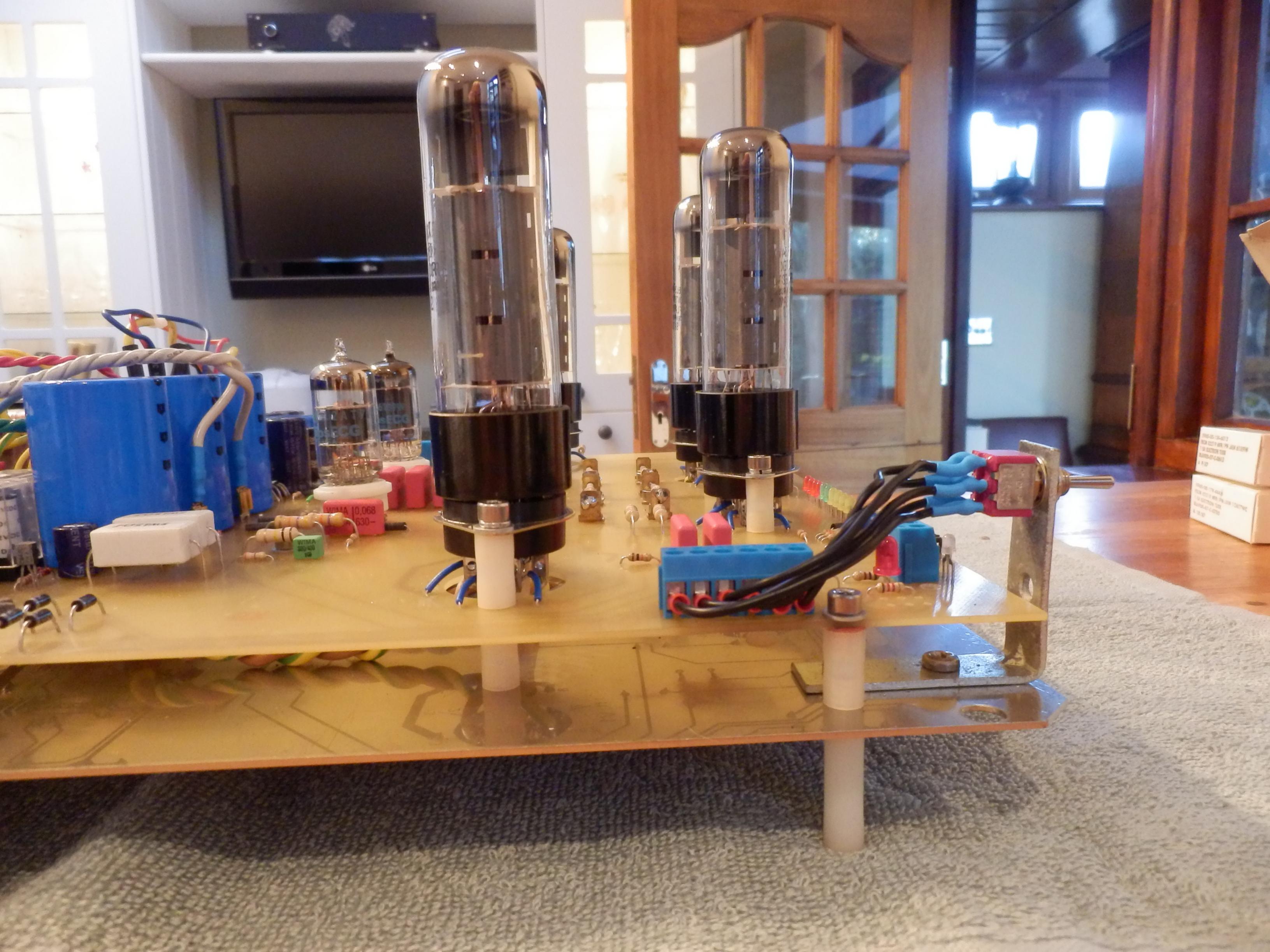

Hi

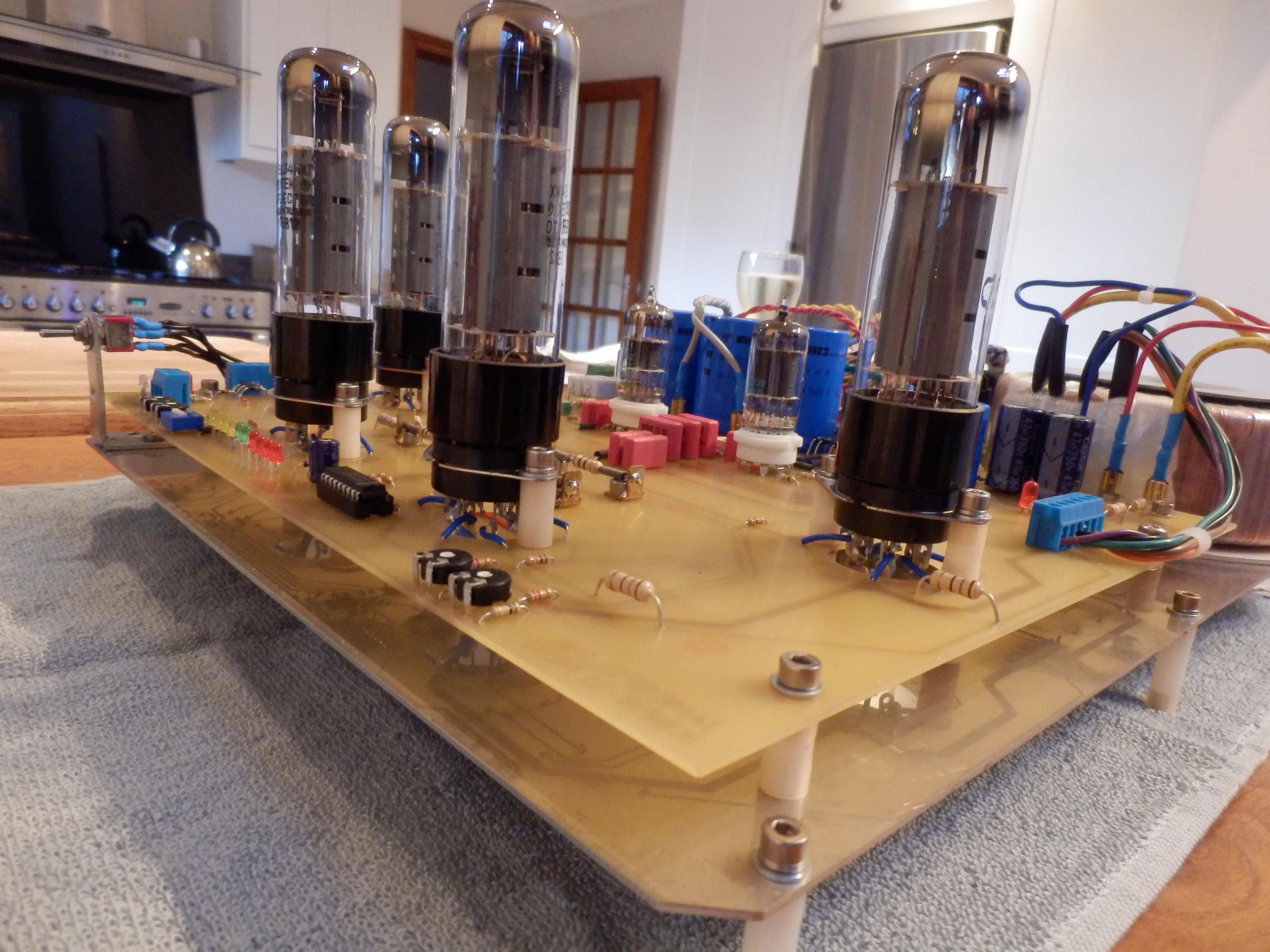

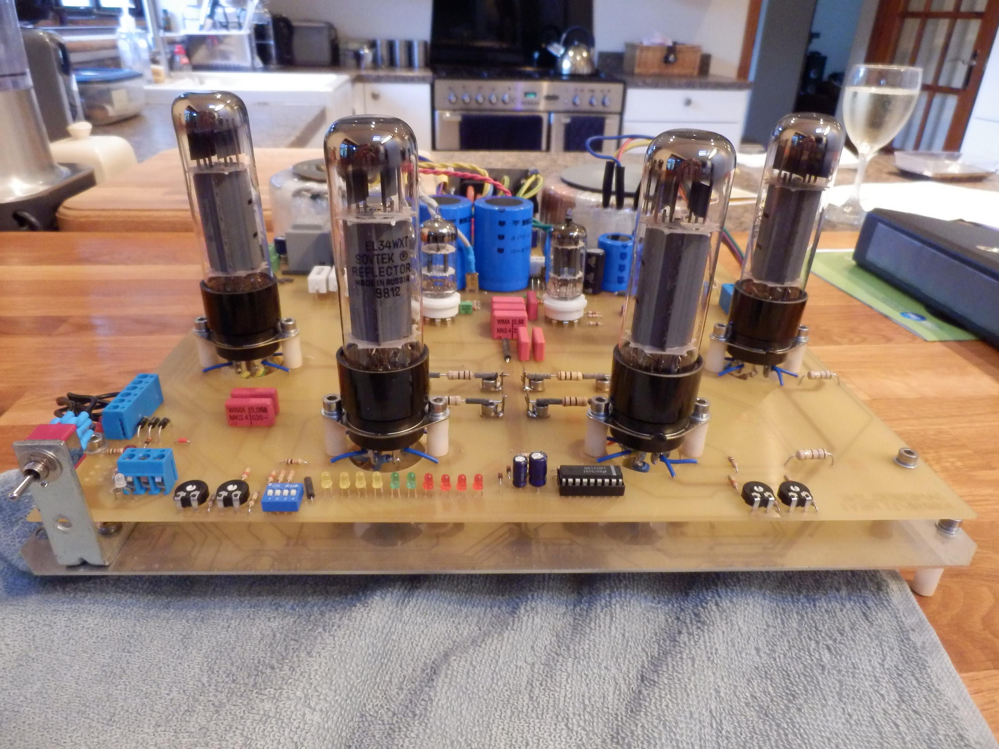

This is a new PCB gerber file conversion from old artwork, the boards are 2 oz copper tracks, with thick pcb board. This chassis is the 1st prototype board the rest will be put into a case for safety reasons.
Hi

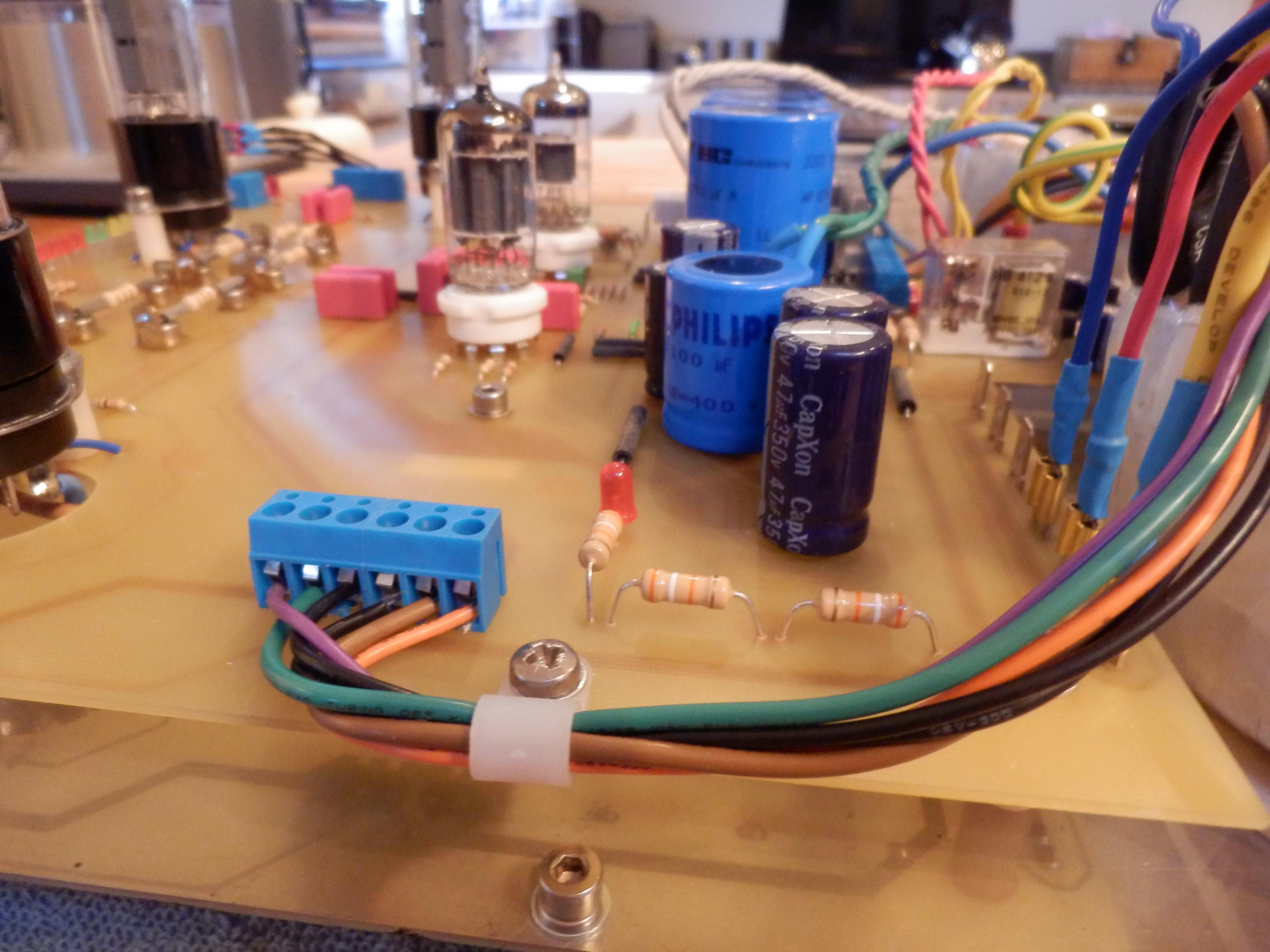

This is a new PCB
I like it, it's neat and tidy. The bias bar graph is a nice touch. I would probably have used cermet trimmers for bias adjusting, they are more reliable.

Good work:-some questions:
KT120 for the power you quote, these tubes are hardly being tickled ? Your reason for choosing them ?
Can you explain the reason behind the power drop with both channels driven in stereo mode ?
The response...maybe a 1dB rise at 20KHz ?...If so, the figure at 50kHz needs checking out.
richy
richwalters - regarding the lower power in stereo mode:
Maybe that issue above, or low filter capacity. I have used there only 235uF before and after choke. Probably increasing the filter capacitors value could improve power significantly. I am going to tune this in future, just I have to find the right capacitors 🙂
Regarding using the KT120... I have used them, because there was not big price difference between KT88 and KT120, so I decided to buy the better ones. Their max power in AB could be about 150W, so yes they are just "idling" even at max power 🙂 but I like to overpower things, at least I know they will have loooong life.
Regarding your frequency question... what I tested was off course the whole frequency range with oscilloscope. I was just saying, that I can't proove what exactly is the frequency response right now because I can't measure this very accurately at home. But at least from my "home" measures it looks like -3dB @ 50kHz at full power. This goes very nicely linearly down and ends somewhere at 200-300kHz. with no resonant peaks at all or something that is common in standard output transformers. And yes there were HF issues with this amp, even after tweaking global negative feedback with right capacitor values, it was oscillating 1V@1Mhz on the output. I have solved this with boucherot cell. After compensations it is nice and fully stable, and even square wave is nice and quite crispy 🙂
And so there is about 100V drop at the output of power supply when amp is draining full power.I have used only 400W toroid transformer, which is obviously not enough for max power (I used that one because I already had it from another amp). Also my transformer has symetrical secondary for anode voltage, this is also disadvantage that only rises internal resistance of the transformer so power is not so tought as it would be with only one non-symetric winding. Probably filter choke is too overboosted (1H/600mA), maybe better would be 0,5-0,8H / 800mA.
Hi Good advice .. I will do this on the next build
regards
Absolutely, I've used these for years on tube amplifiers and never had a problem. They're very stable, too.

Hi, multiturn cermet trimmers are better than the conductive plastic single turn ones. The tiny cermets are very good for adjusting fixed bias.
There are bigger, panel-mount ones available, but they are very expensive.
Wirewound pots shouldn't be used for fixed bias.
