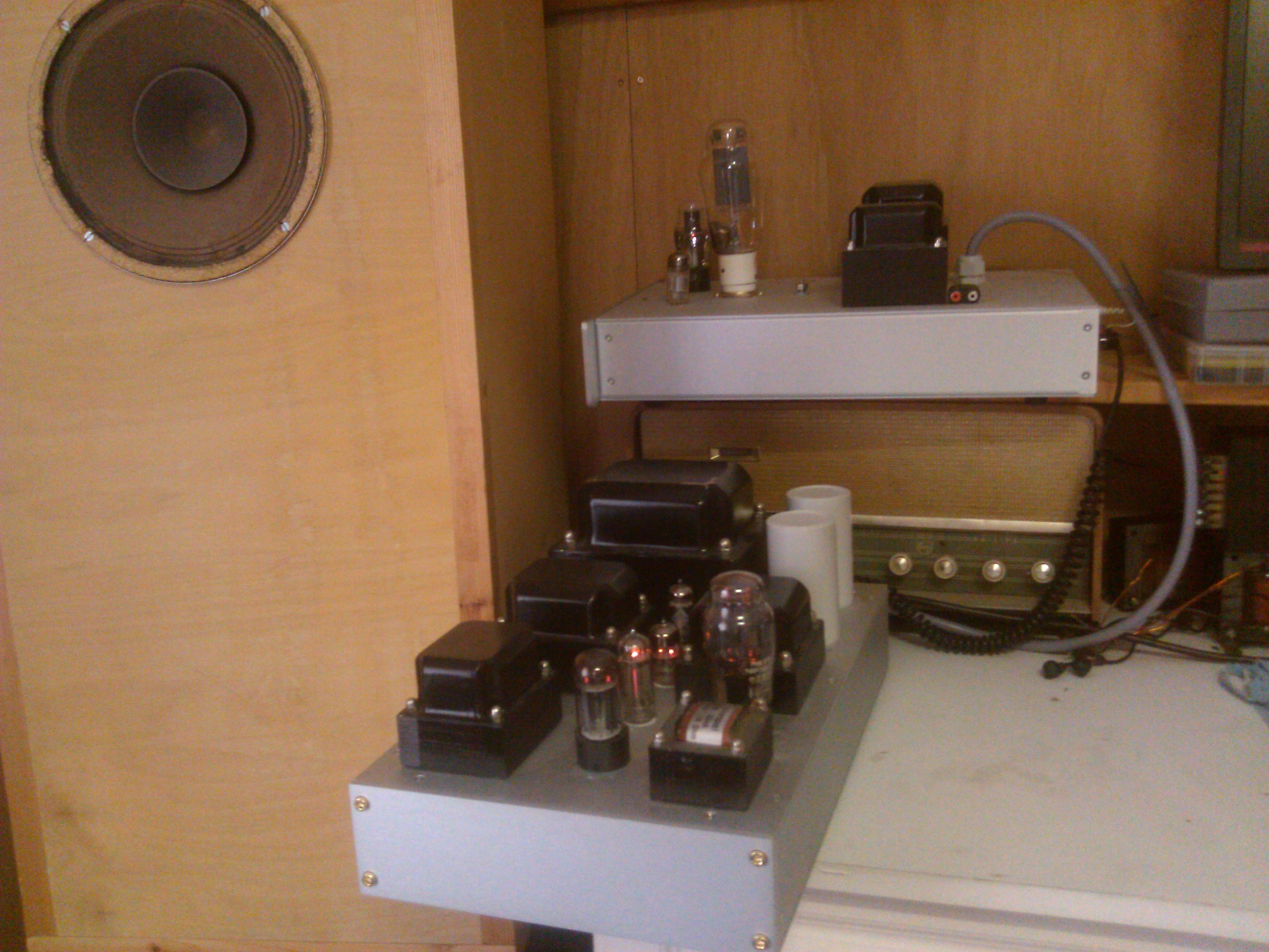

My excuse was that my little 813 amp doubles as testbox for the upcoming 813 audio amps.
To get back on topic: the power supplies are reconnected to their 300B amps so I have some music while studying.
And yes, those are parafeed 😀

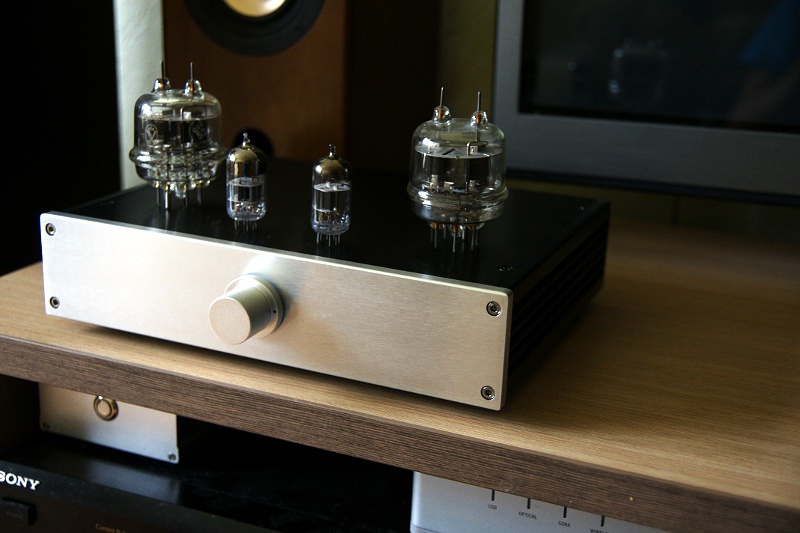

Hi guys! A while back I was asking questions on how to properly get at wiring up a preamp properly. And now with all your guys help and tips, it is now complete!
More photos and details :
Phono Pre-Amplifier

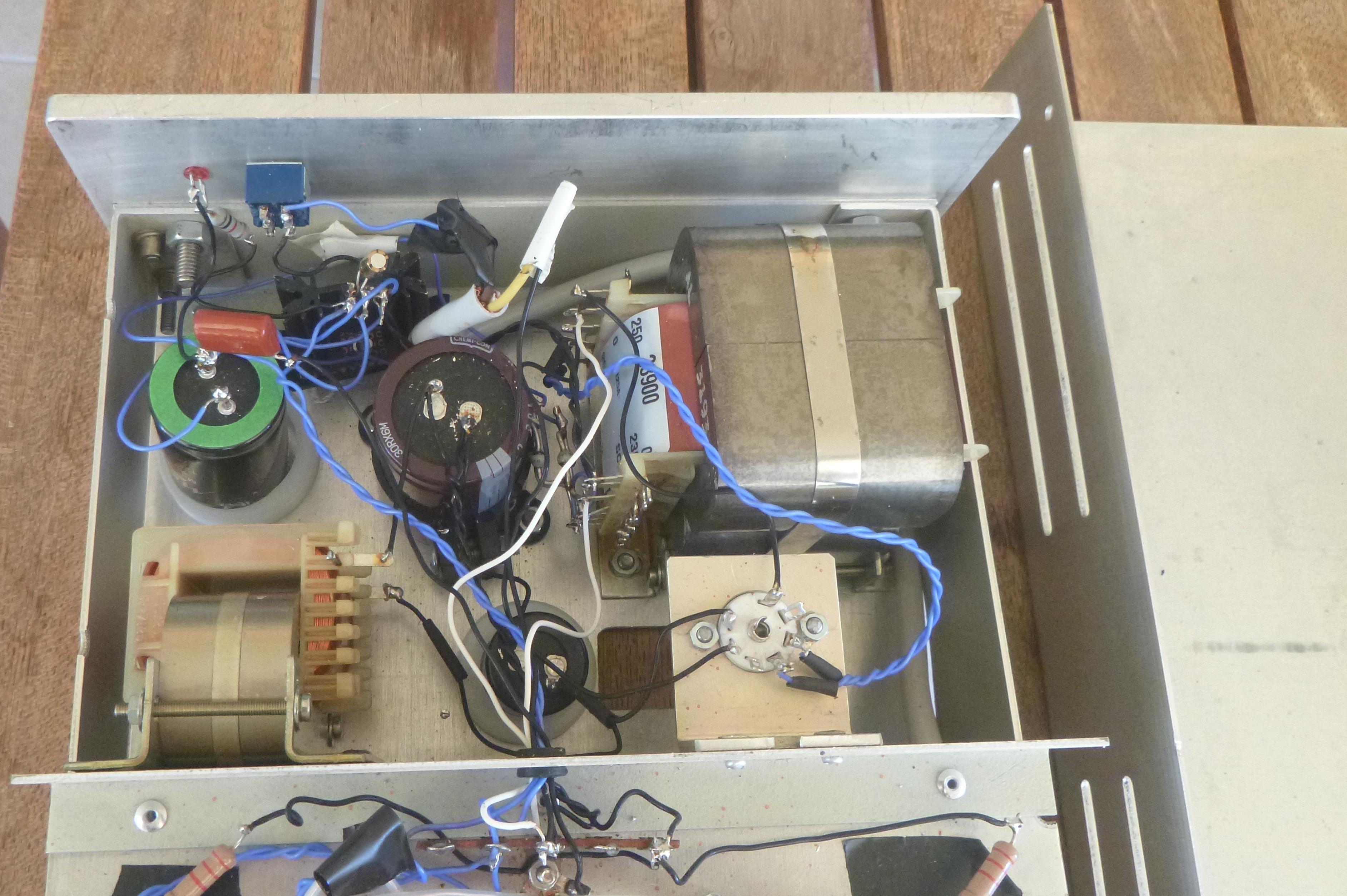

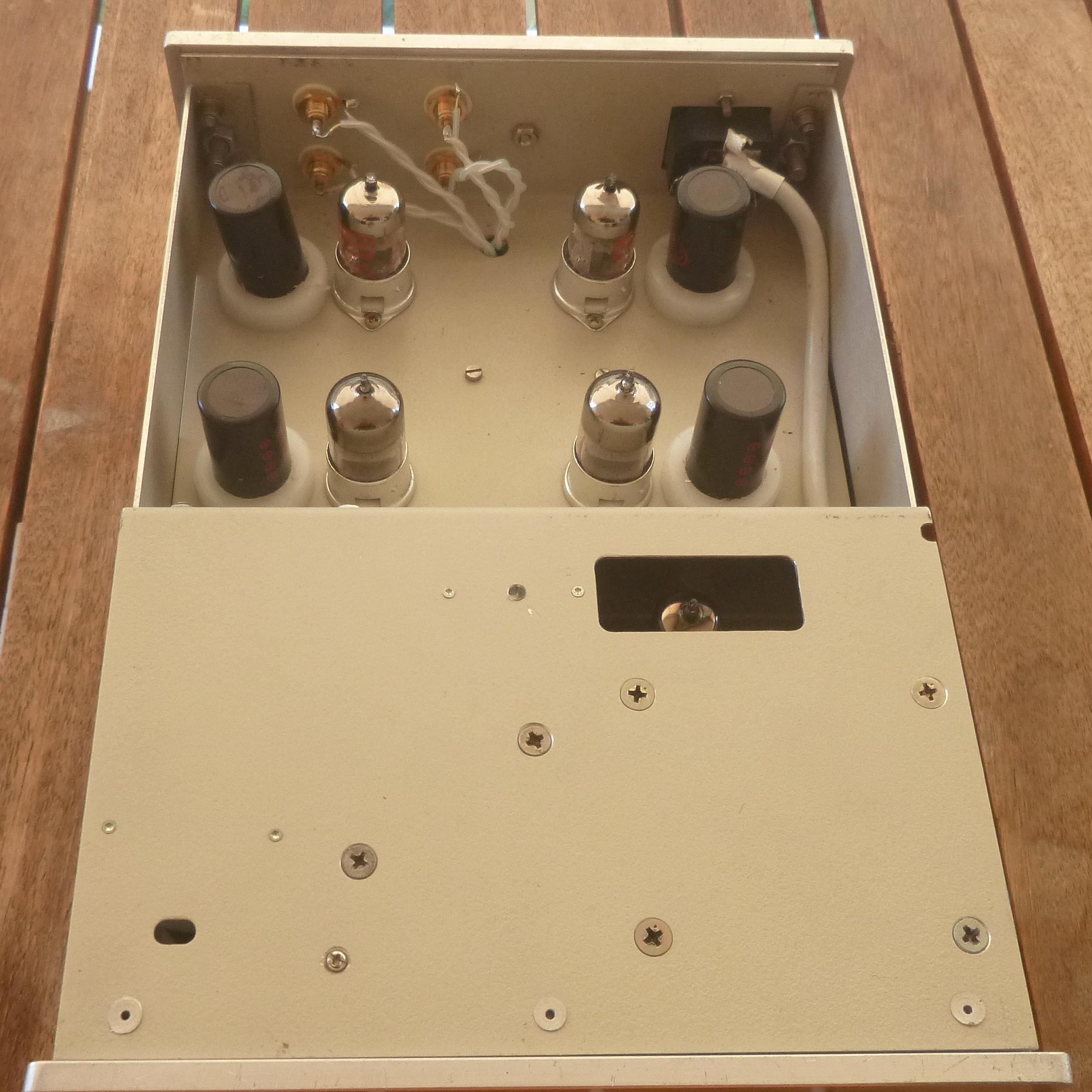

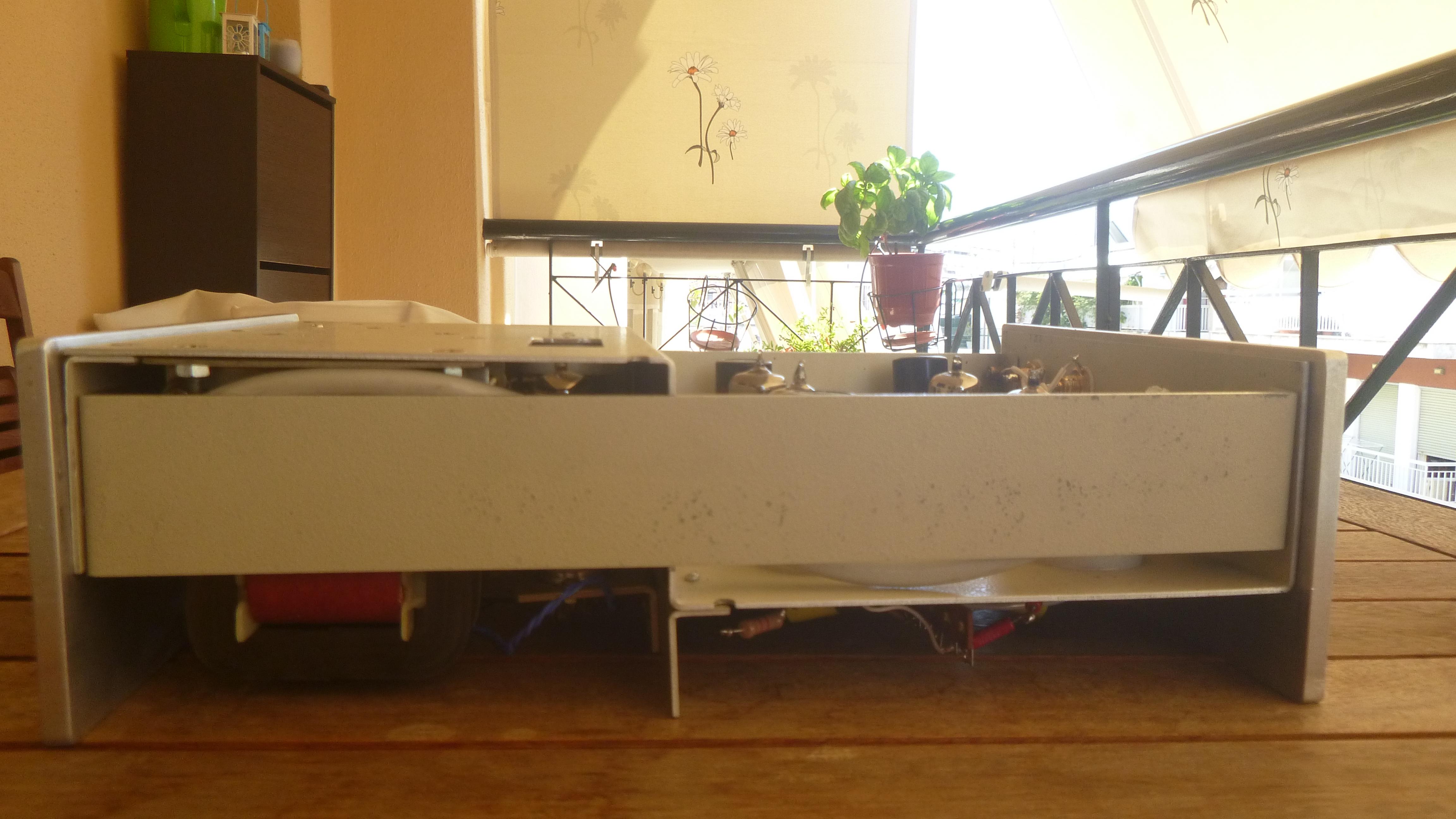

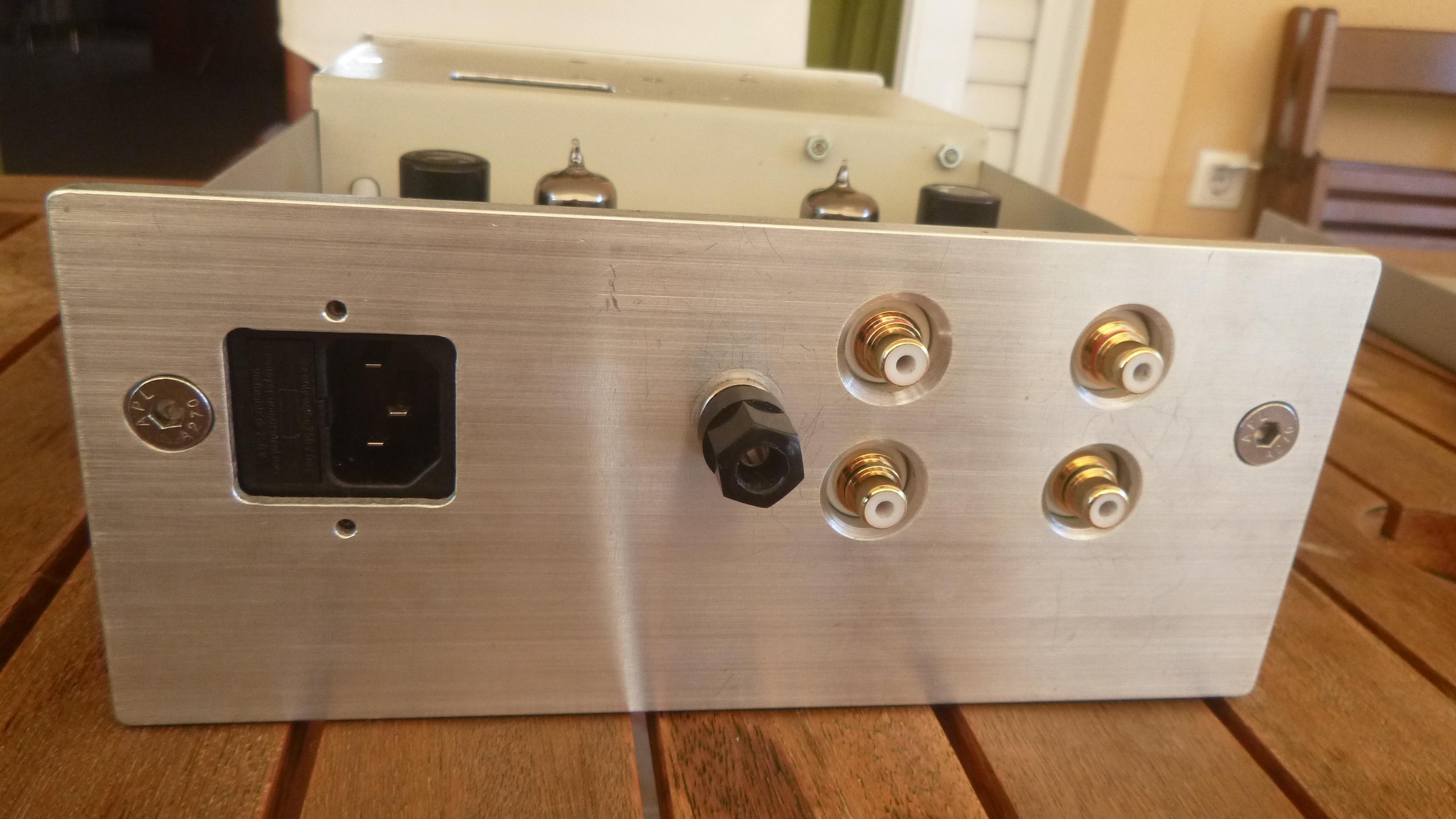

And here is my humble phonodude implementation. Please be gentle with it, it is my first tube creation.
All metalwork is DIY, reusing side aluminium panels from abandoned lab equipment; 1.5mm for the chassis, 6.5mm for front and rear panel.
The bottom part is too short, so some components fit marginally, but I had to constrain the total construction height to 90mm (WAF related reasons included).
With the precious help from a relative greek forum (some people are around in this forum too), this project came to reality and I really enjoy it!
Still have to decide about the top/bottom covers colour and paint them, and mount them with screws.

1. Really nice construction and neat cabling
2. Are these 6Ж32Π ?
3. Beware Beware these brown plastic caps! I founds some shorted in one case.
thanks to nylon ty-wraps and square plastic mounting bases, wiring is a breeze,
but the planning takes longer...
yes, i used the 6J32 analog of the EF86, these russian tubes i have grown to respect...
i do test components before soldering them in, as a common practice, i test the amp is various stages of construction to see that the target voltages are as designed, (sometimes they were slightly off....but no big deal really)
the one thing that i am proud of in my builds is that i make all the irons used in my amps, Z11/M6 in the OPT's and M18's in the power traffo....
