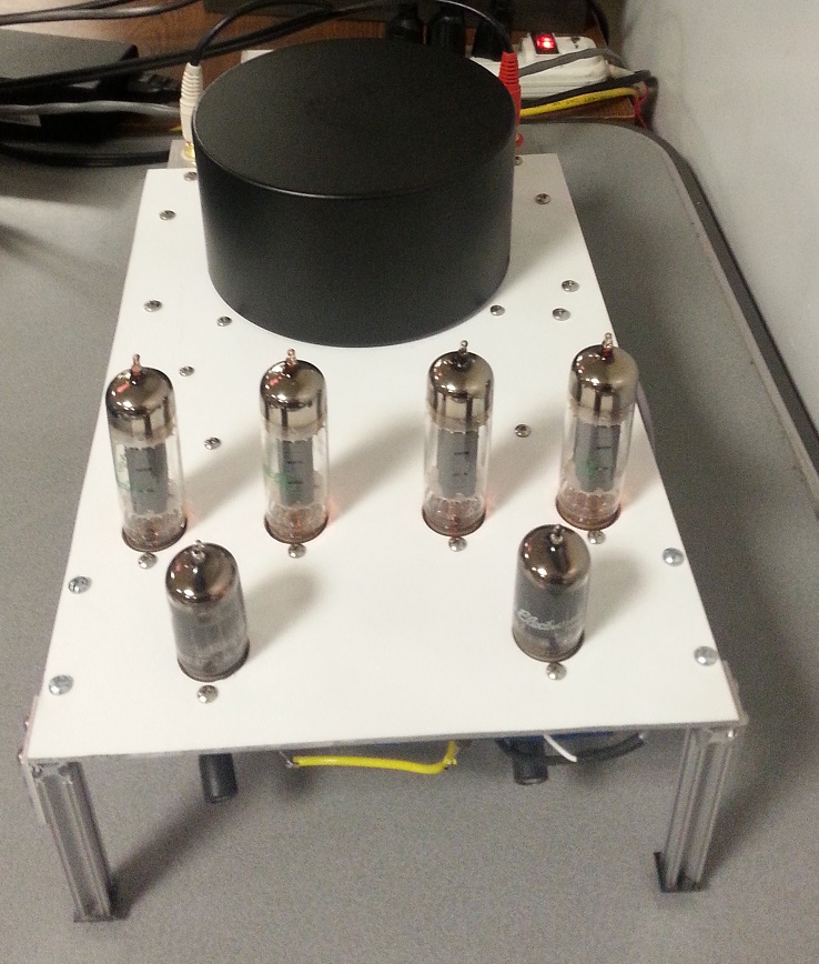

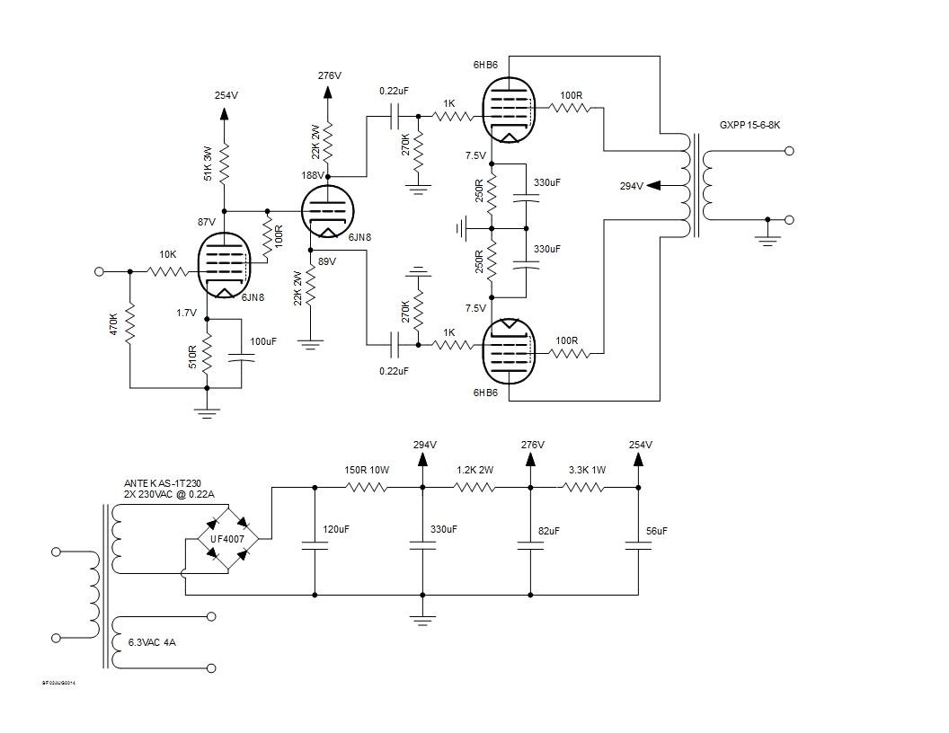

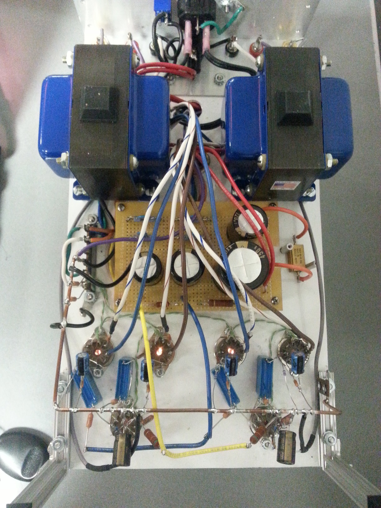

This is a prototype attempting to fit 10 gallons of tubes into a 5 gallon chassis. All tubes were $1. 6JN8 driver/splitter and 6HB6 outputs wired UL.
About 9W RMS/channel before clipping at 1.25V RMS input.

It sounds great to me 6L6, very sensitive input though.

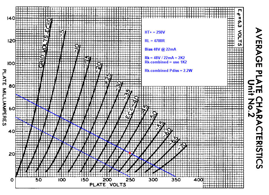

stajo, the 6JN8 is basically a 6GH8 with different pinout. Based on the triode-strapped pentode curves I found online for the 6GH8. They were fairly accurate. At the bias point I'm using the mu is about 20.
Not sure about a circuit board yet. We'll see how this turns out.
I was way off on the input voltage readings. Still about 9W RMS though. I'm not sure what happened, I must have been looking on the wrong scale or something on my scope. I took the measurements again.

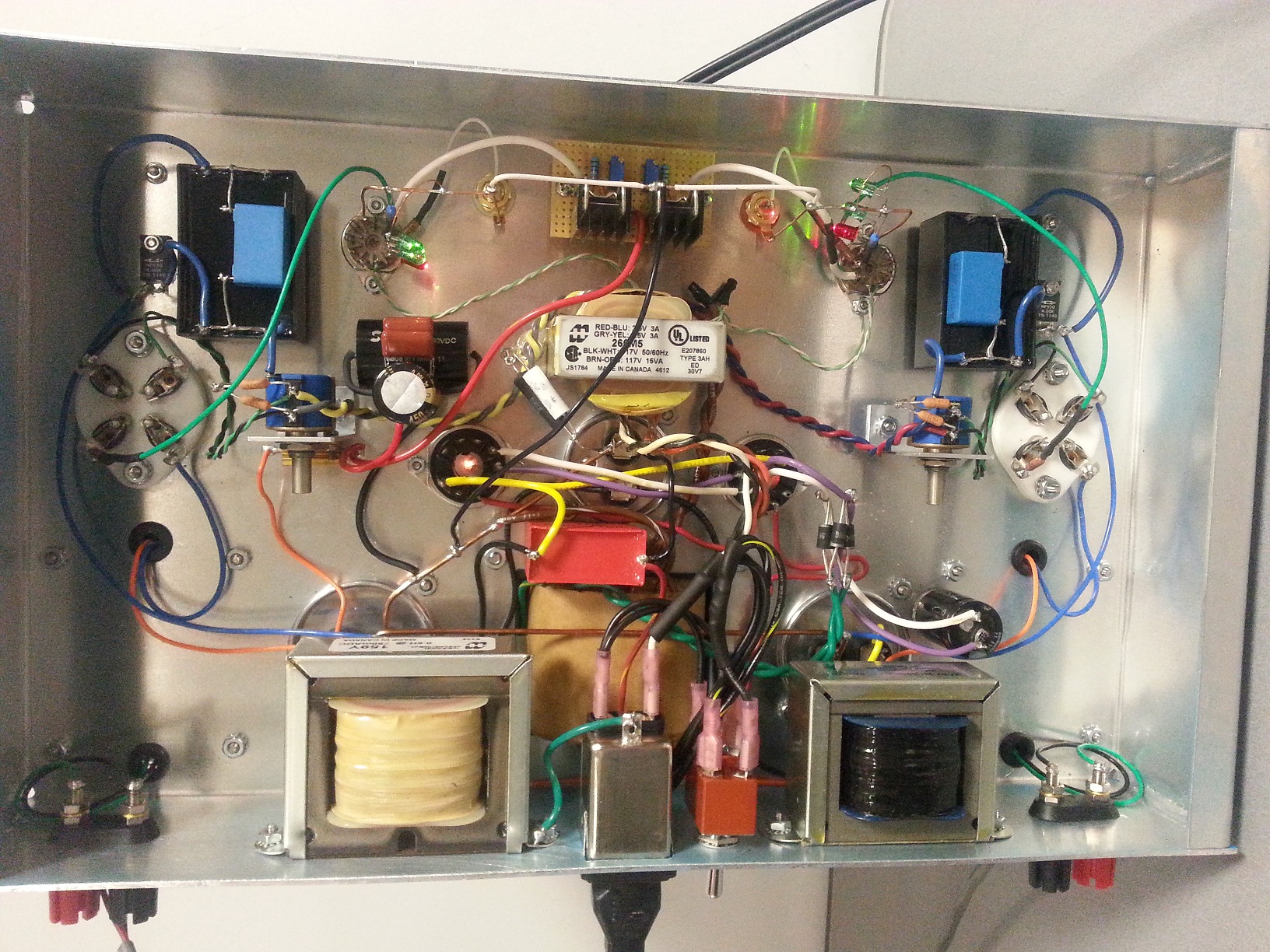

Yes Phil, they are indeed 6N6P. 6V LED bias, 10M45S CCS @ 14mA, ~160V plate.

The driver tubes look like 6N6P?

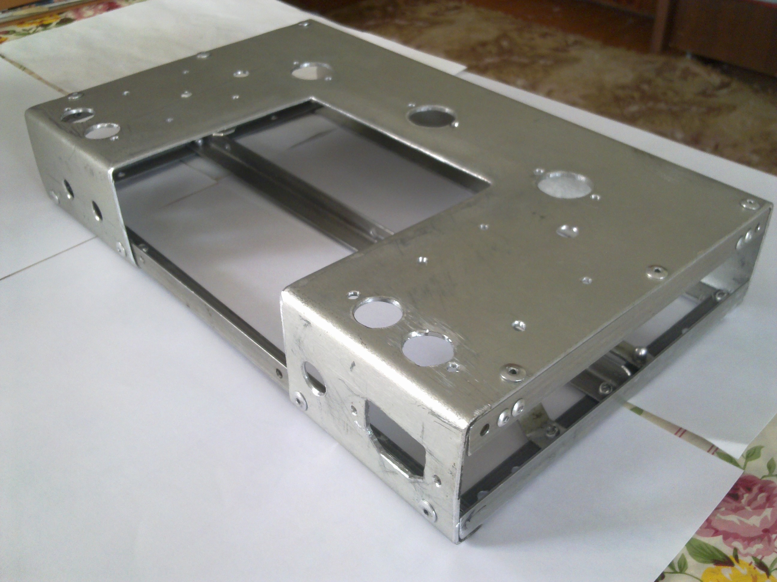

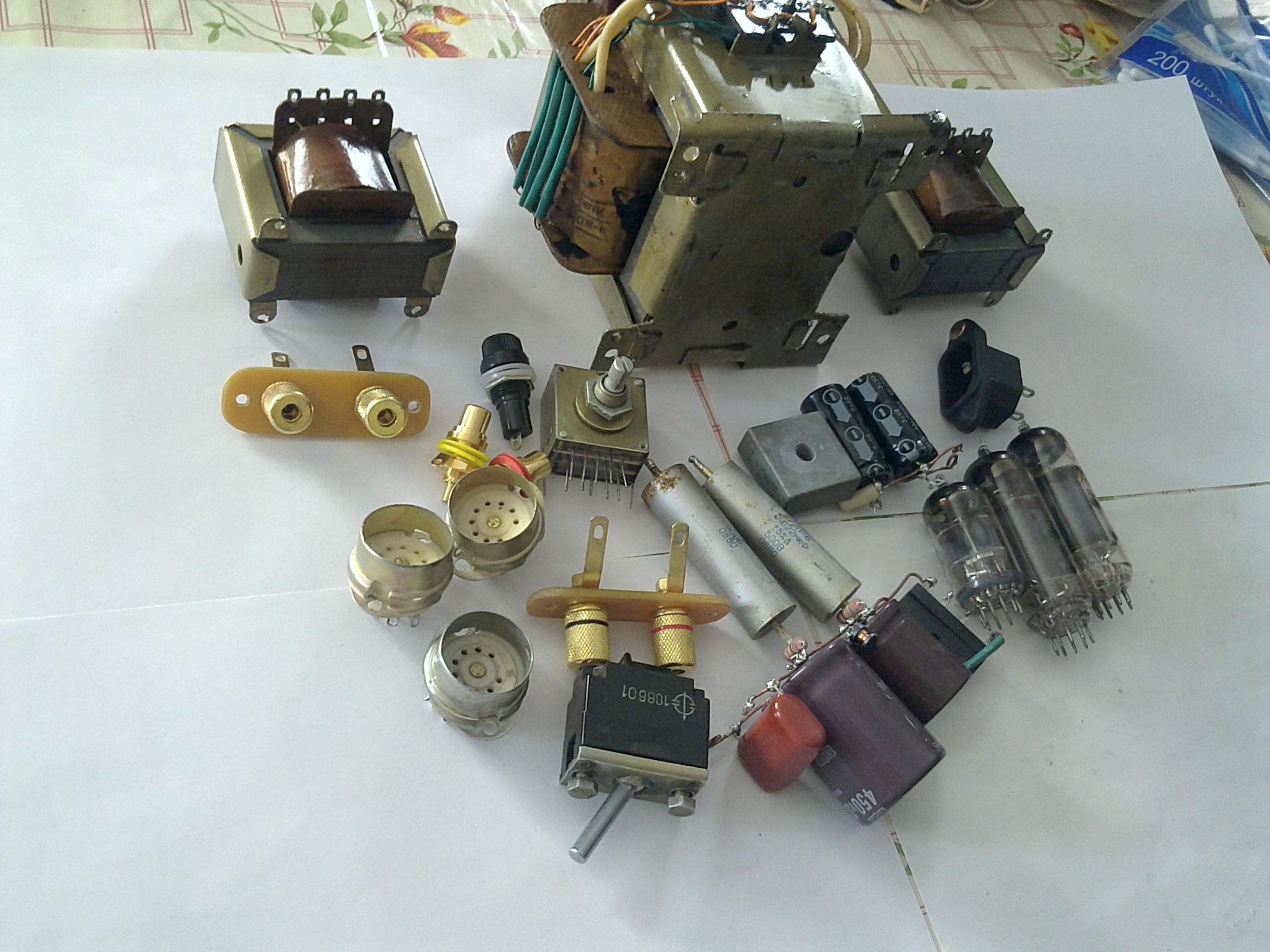

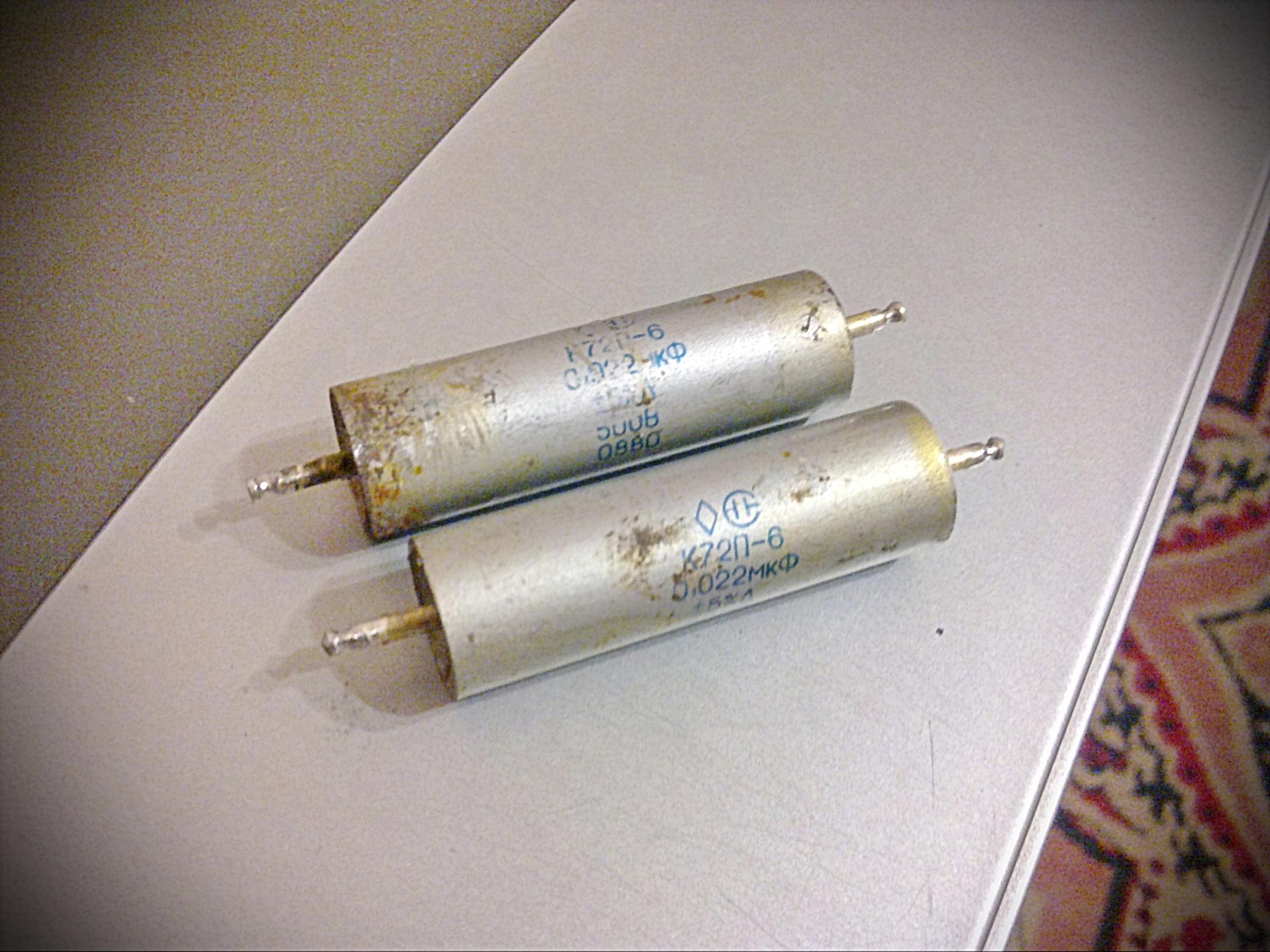

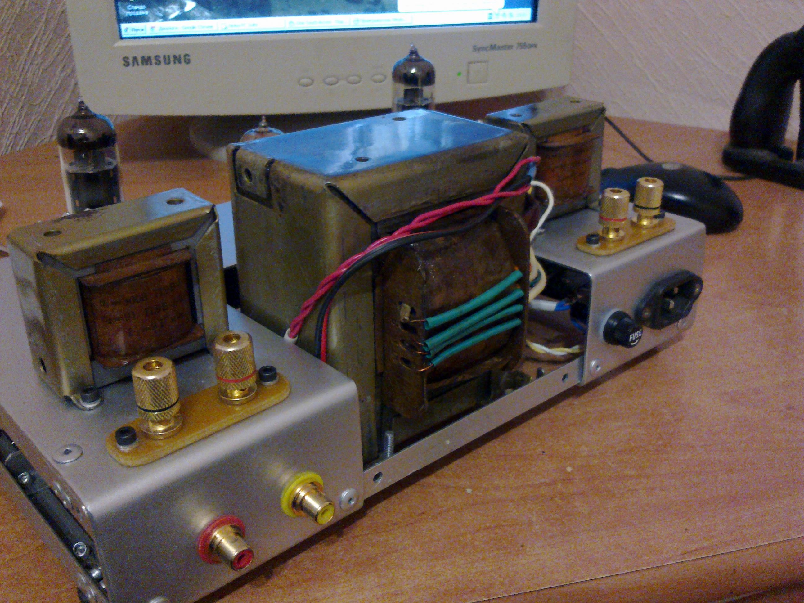

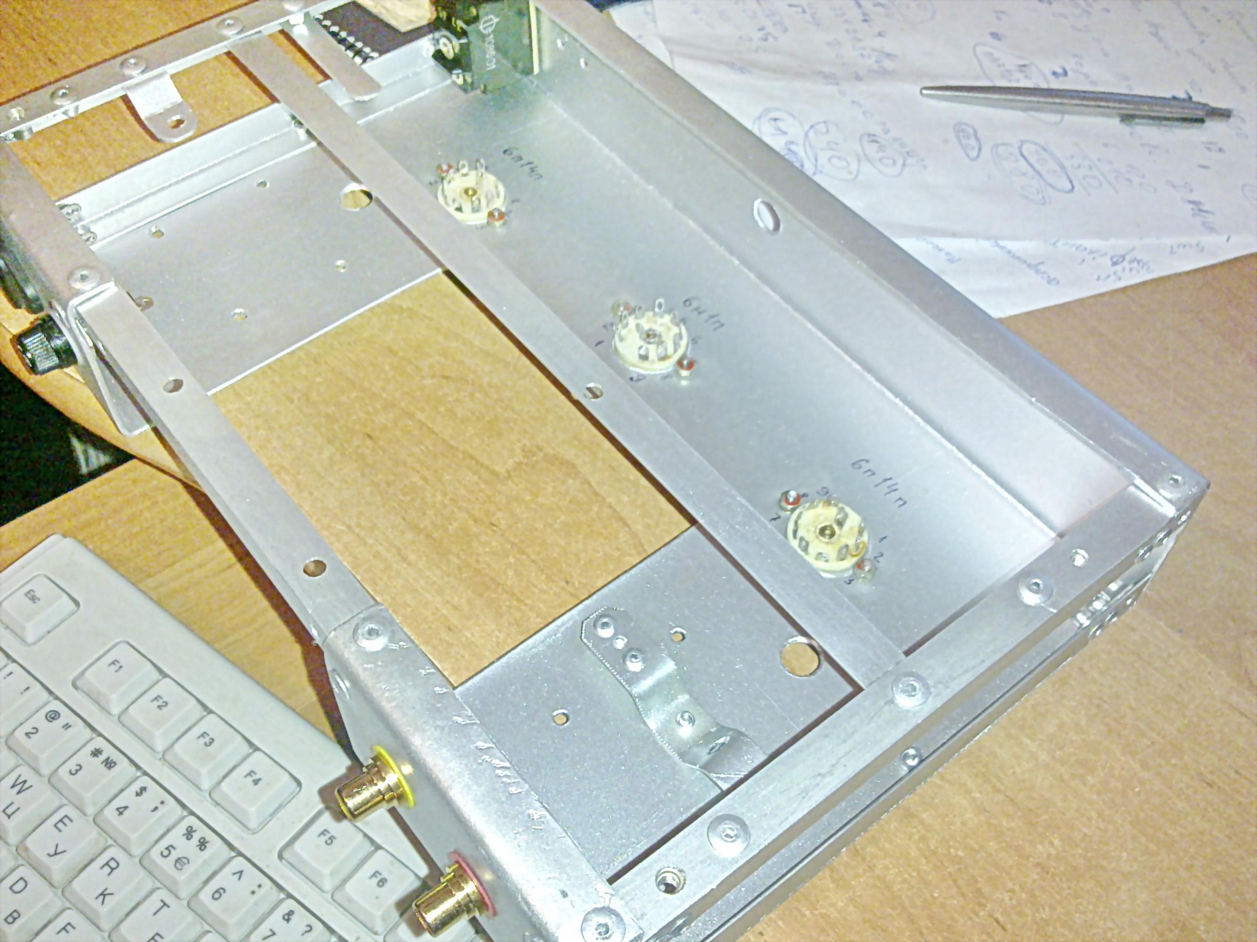

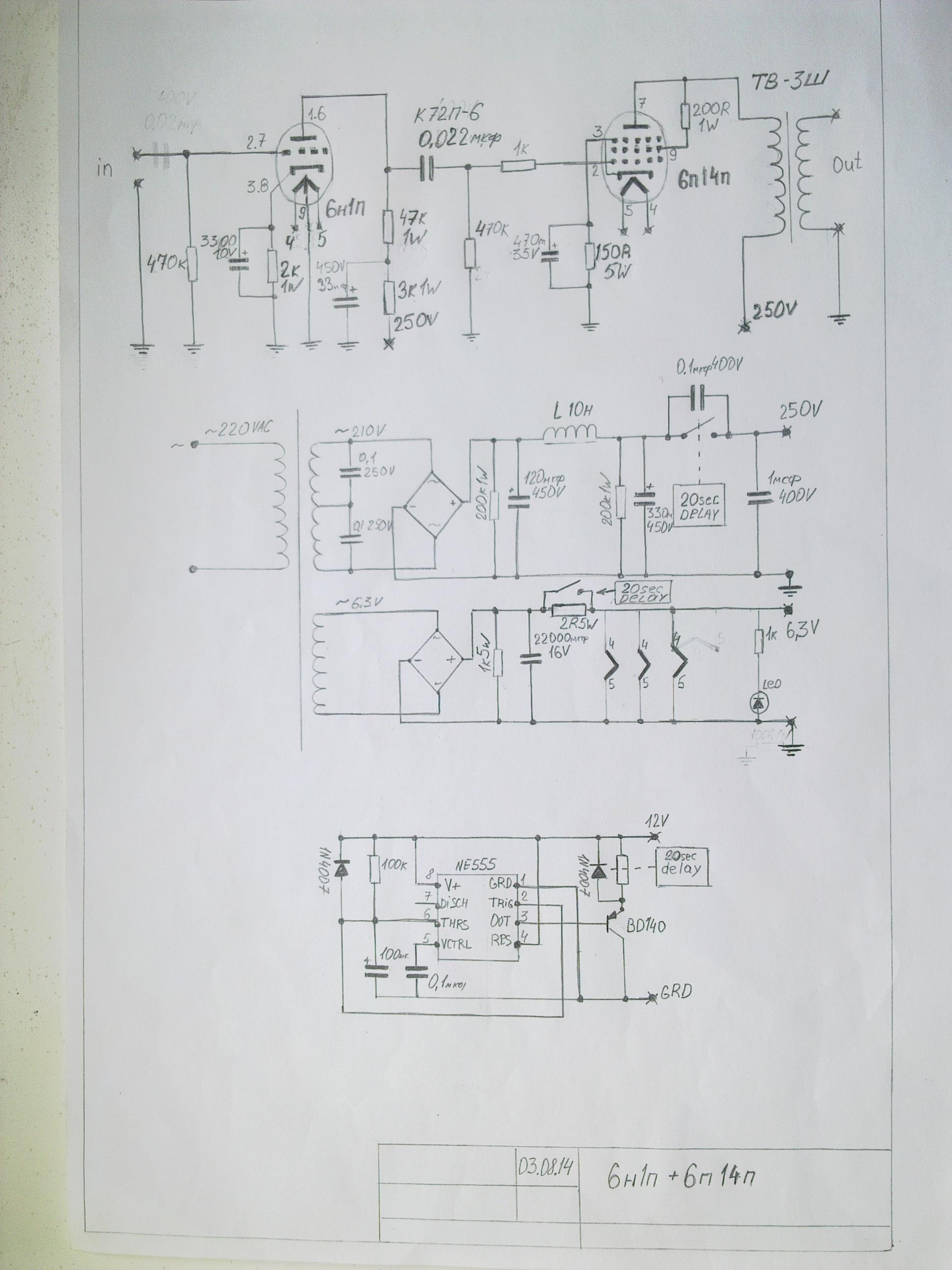

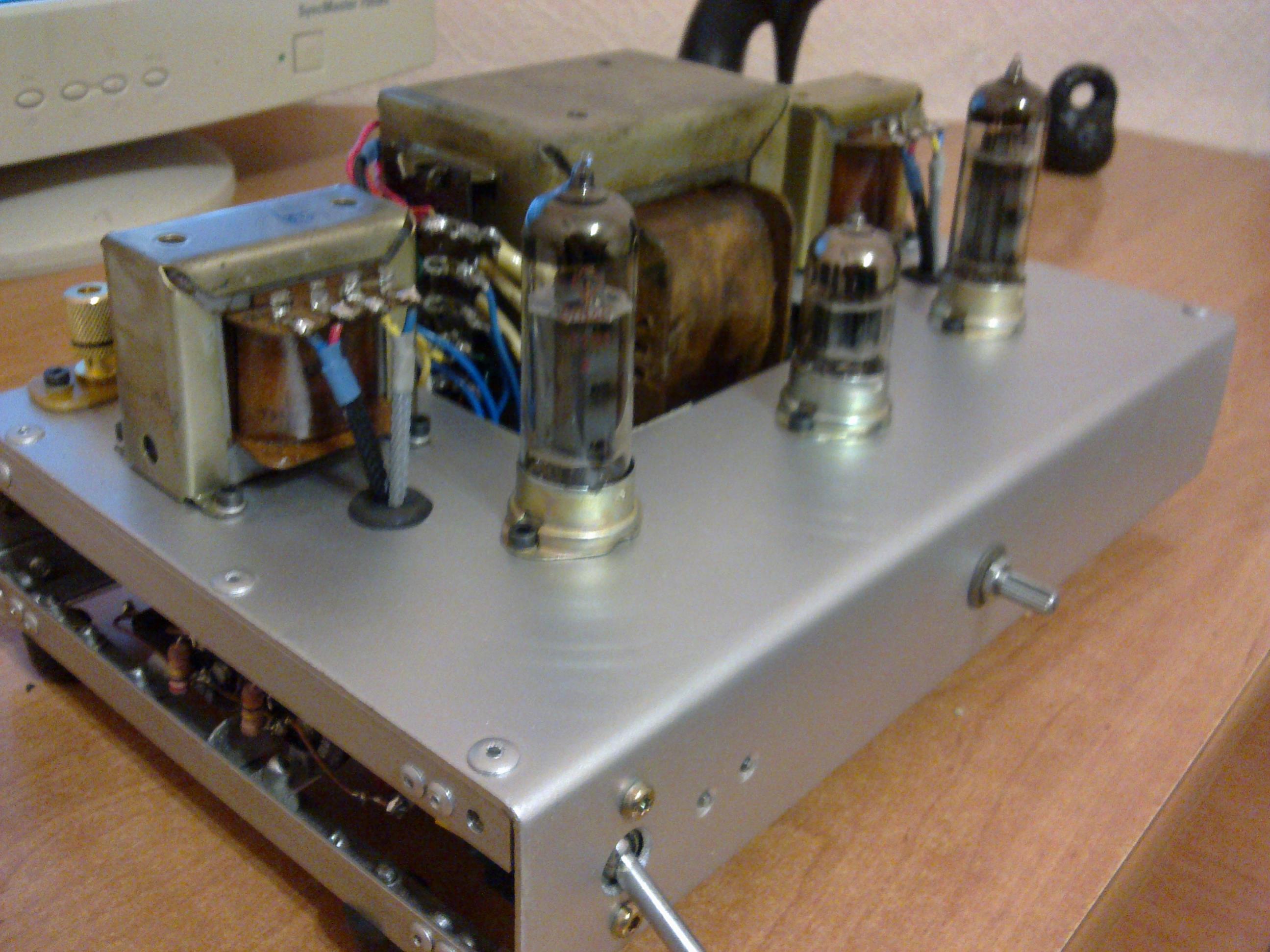

6н1п + 6п14п.SE без оос

Nice!
Clever way of making the big power transformer proportionally to the rest of the components..

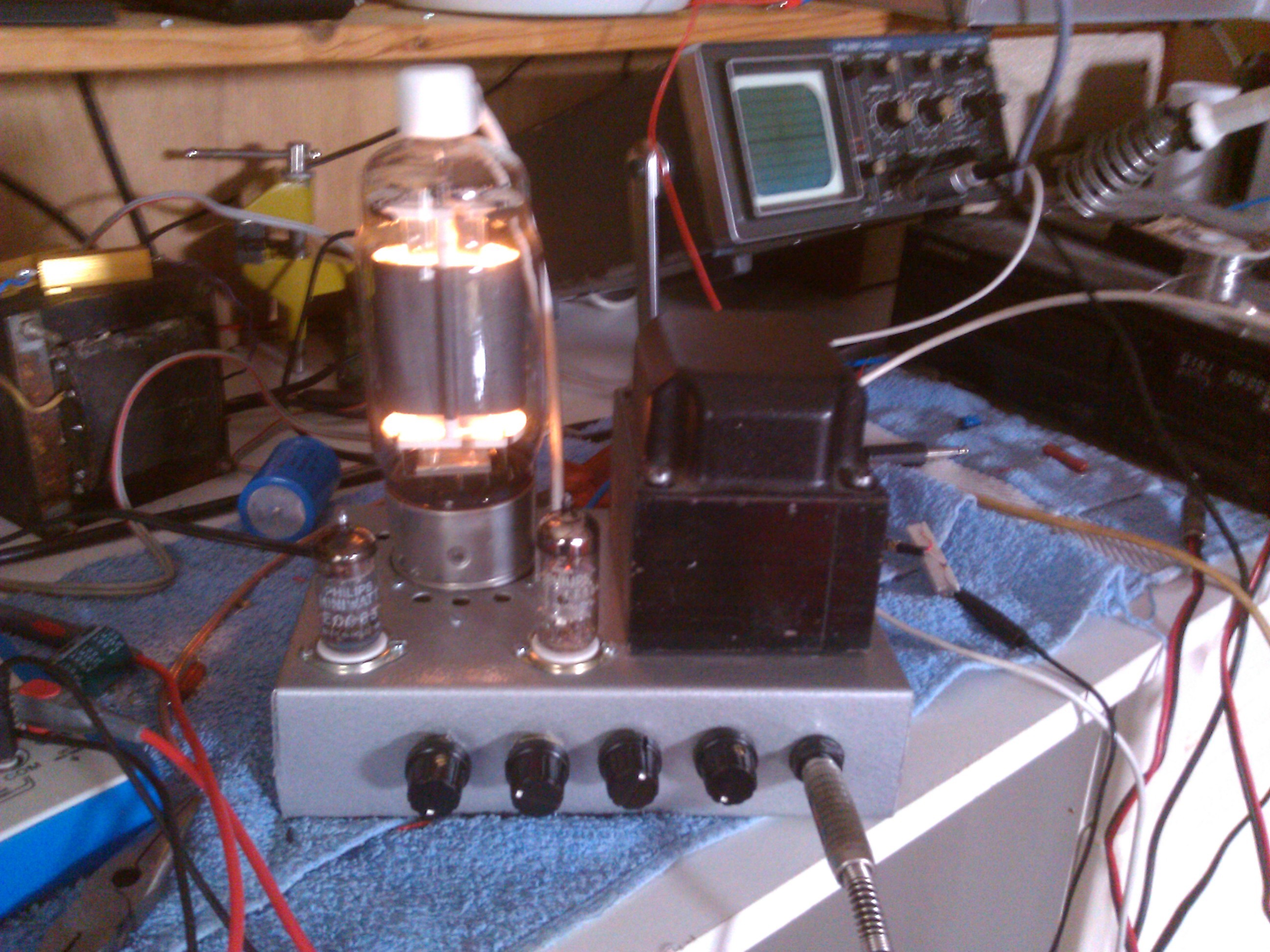

SE 813 guitar amp
OK, not an audio amp but it has been so long since I build my guitar amps that I just had to do it 🙄
And besides, it is a test setup as well for the 813. Another step towards getting them into my audio system.
It uses the external power supply that I can use for either my 300B mono's or the upcoming 813 mono's.
Right now they run on a measly 350V, producing around 5W (10% of the filament power
The filament runs on dc using Tomchr's universal filament reg. That 5 Amps is the limit of the LM22679 IC but it works well. Slow start and dead quiet.
Driver is an EF184 with a 2V red LED and a 10M45S CCS.
Next step: upping the HT 3x...

Hi Esteban,
This one is regular SE, 6k2 > 8 ohms.
A single tranny that I had on the shelf.
The stereo will be parafeed. Still saving for the PF iron, the other parts I already have: Johnson sockets, PF caps and Mullard power valves 😎

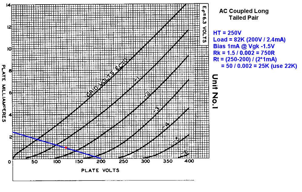

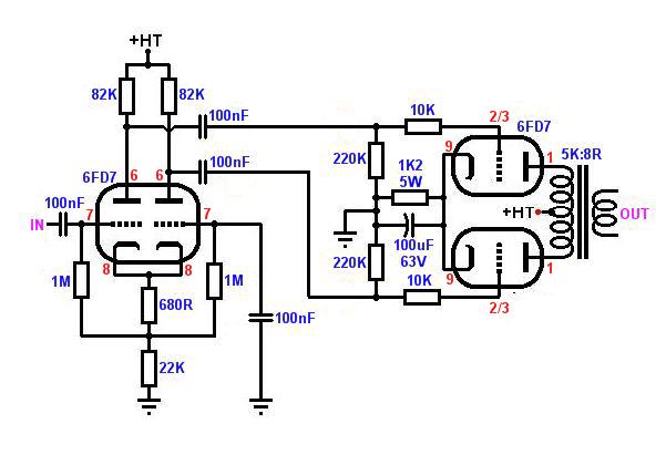

Ah so we can post instrument amps? Here is my bass guitar amplifier:
It's basically built on top of an op-amp based parametric tone control, tight fit indeed. Power amplifier is a pushpull 6FD7. HT+ is using an SMPS that was meant for Nixie tubes to save space and cost. OPT is a power transformer with 220-110-0 primary and 0-4.5V secondary as output to speakers. Puts out around 7-8 watts. It still needs more gain so there will be a 6N23P/6N2P gain stage at the input. Quite surprised with the wide frequency range the OPT transformer is giving!

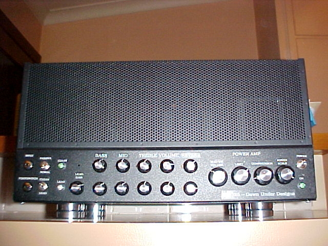

Oh so we are posting Git Amps now?
Here is my latest build.
A Quad of 6V6G into a Marshall JTM45 Output Tranny otherwise it is a straight London Power "Standard" from TUT5.
The Amp and me doing the final "Acceptance Test"
