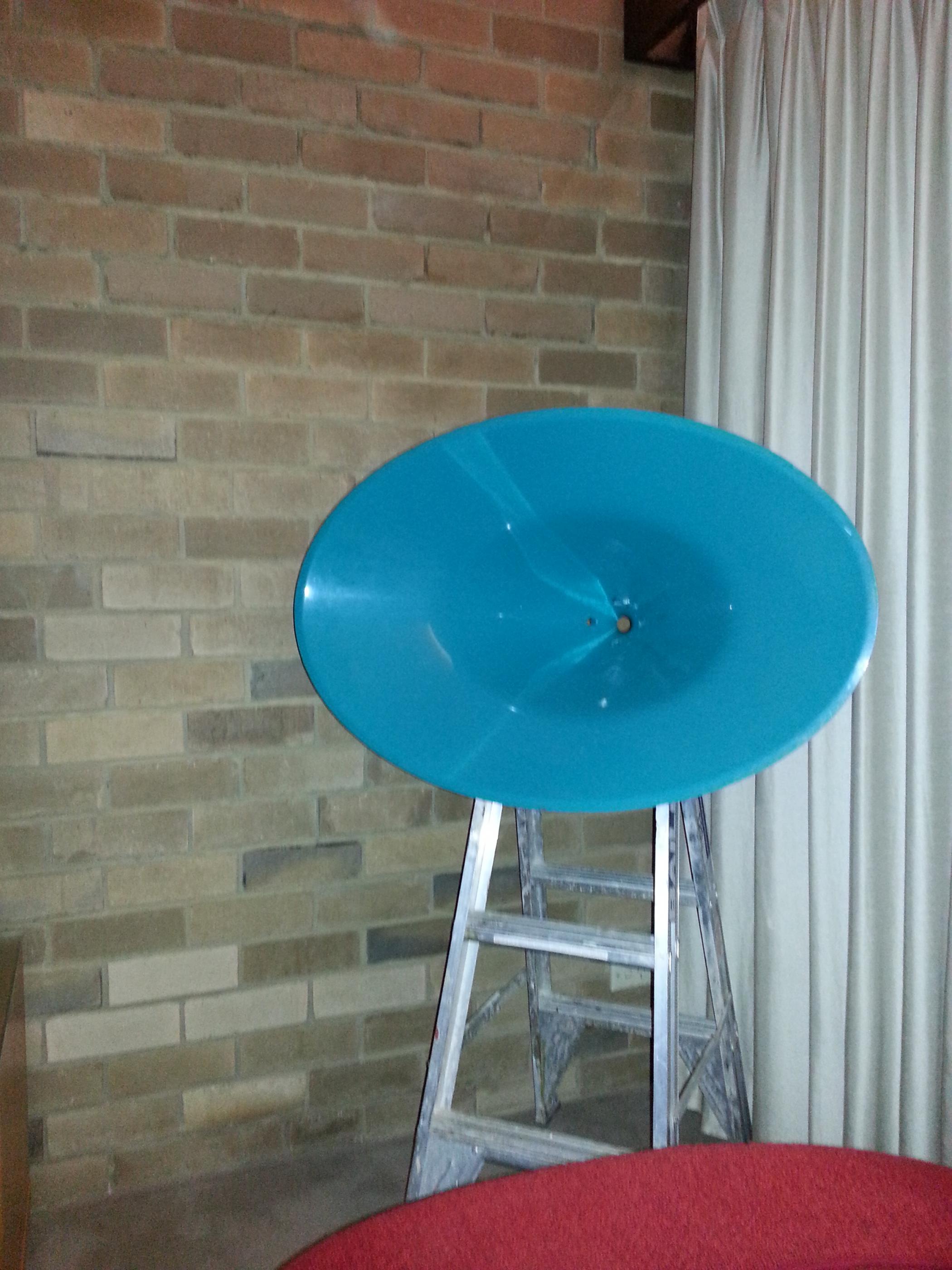

Yes and no ,a few changes another LC filter added .I sold my speaker project and started another one . So I need to change the OPT's in the R1 amps so they can be used as a fullrange amp .Either I'll sell them or use them to power the BMS 4550 CD's .
New active speaker project Pauls PSE-144 ,the pick is the first proto type Pauls lent me,mine will be black

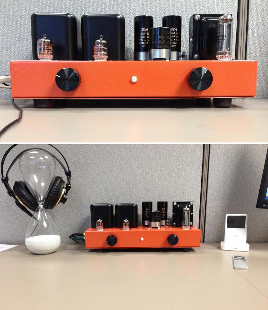

My Little Headphone Amp. It's using the 5842 tube and a 6CA7 rectifier, Power Supply is well filtered with 3 chokes and seperated after the first cap-choke into 2 paths one of each channel. The outputs are 5k to 32 ohm.
Very nice
Beautiful work, the rectifier could be 6CA4 or (European EZ81), the suffix 4 indicates four electrodes inside. This is a double rectifier for that reason has this number. 6CA7 is american equivalent to EL34.

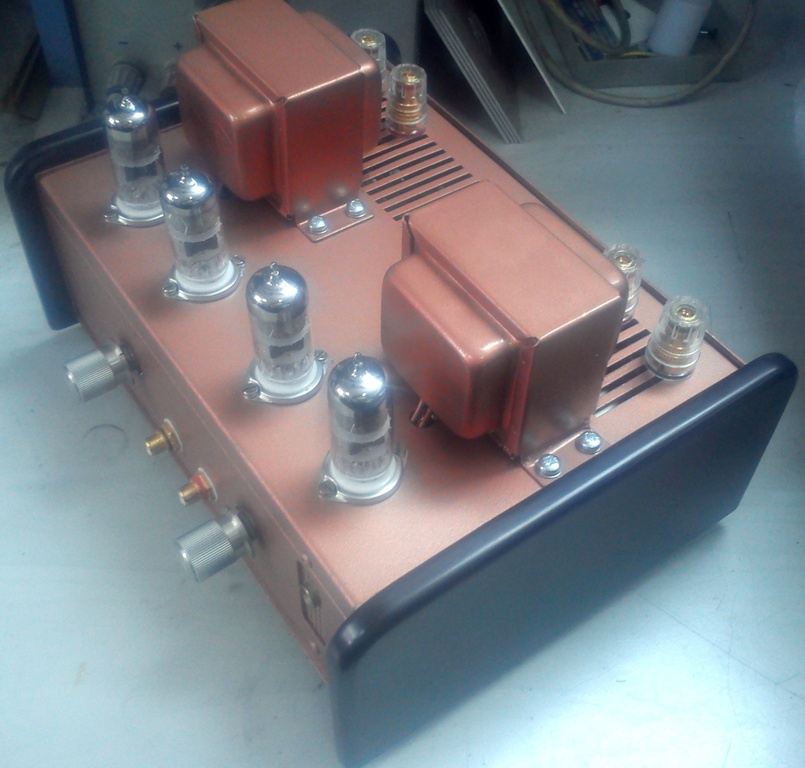

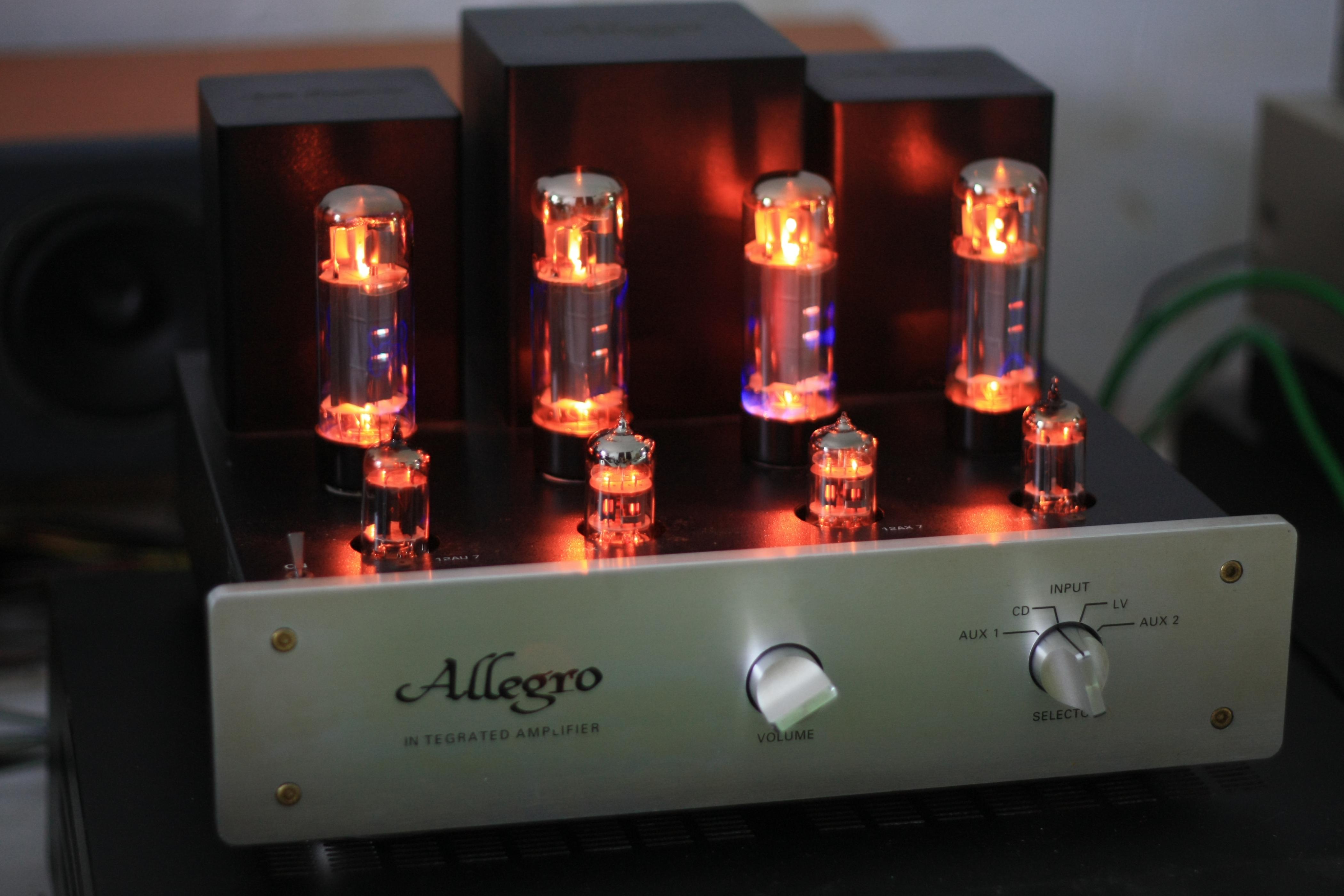

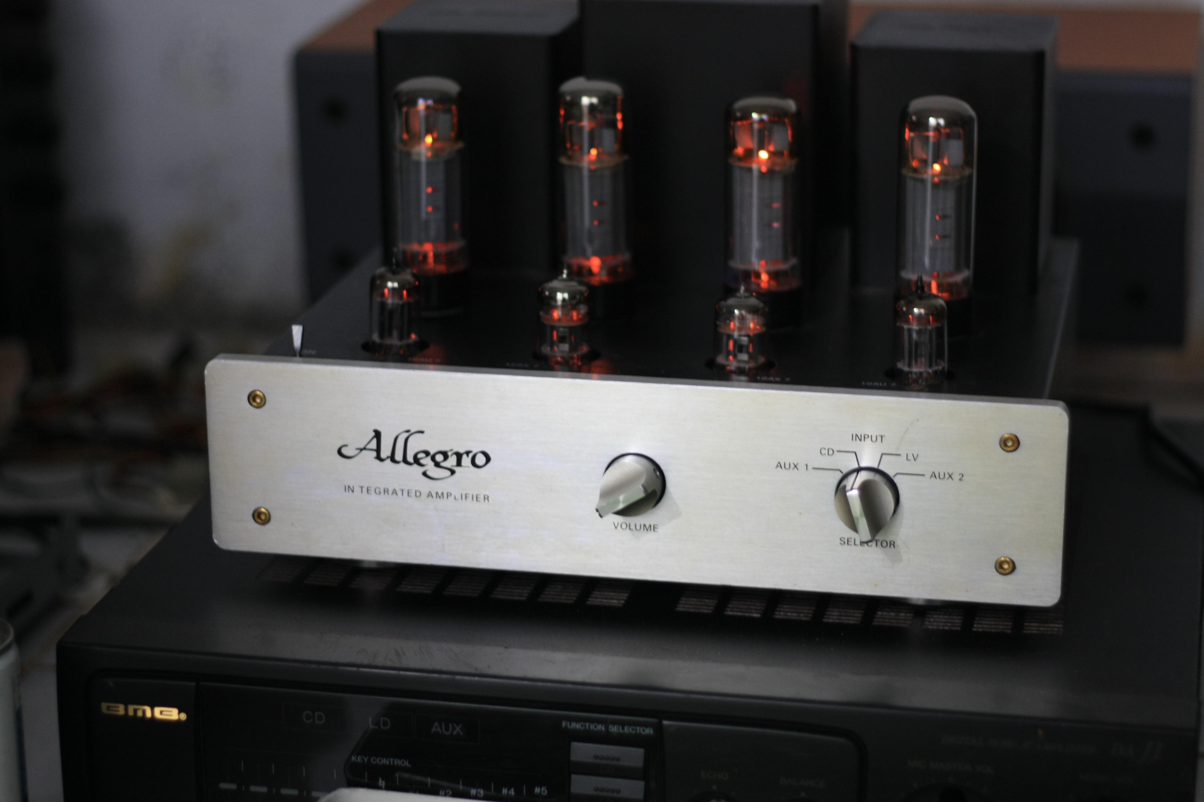

my EL34PP integrated amplifier .

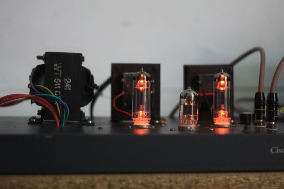

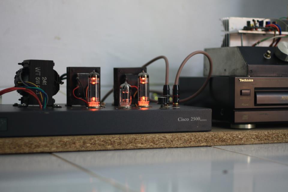

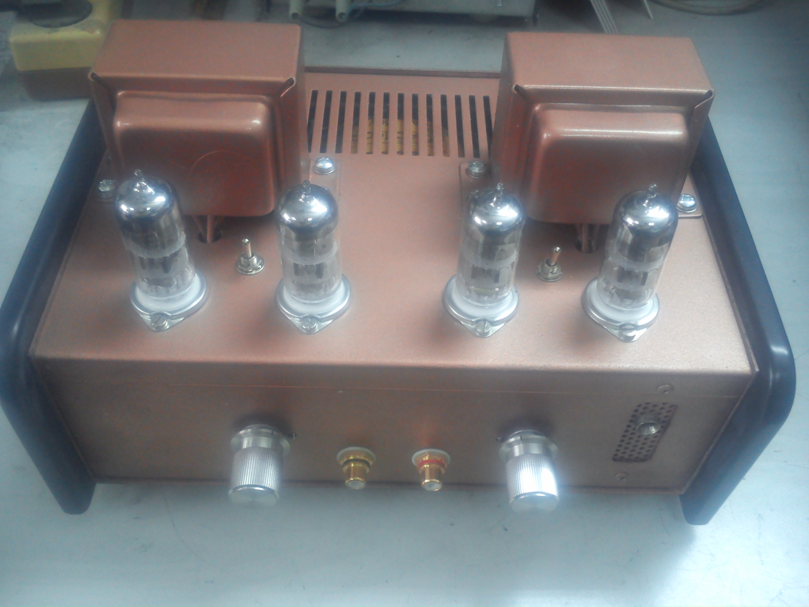

my EL84SE integrated amplifier . use Philips Transformer .
Lovely work. Can you share the schematics?
Current too high, had that problem myself, had to turn the current down, made no difference to the volume, but the valves didn't glow so bright, longer life.
Using a cisco network device as the case! Excellent idea, I have some laying around but never thought of doing this.
