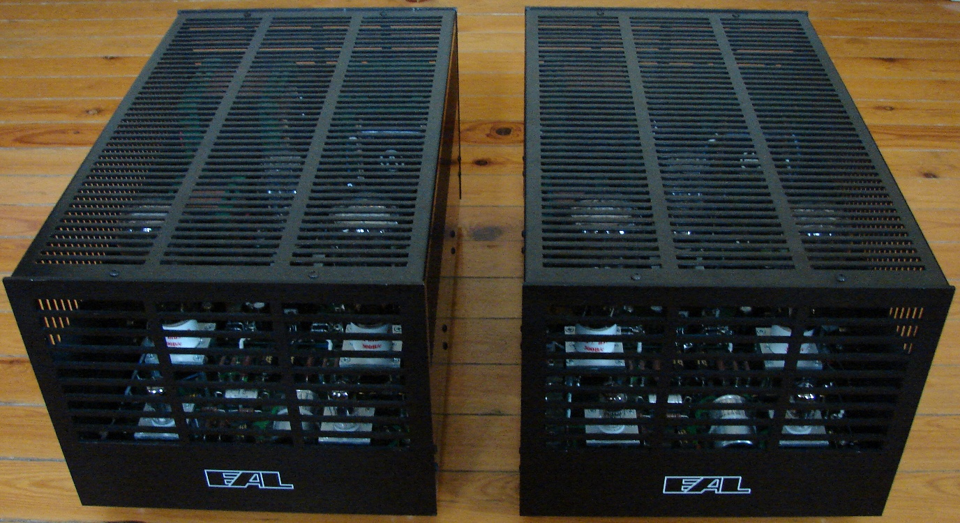

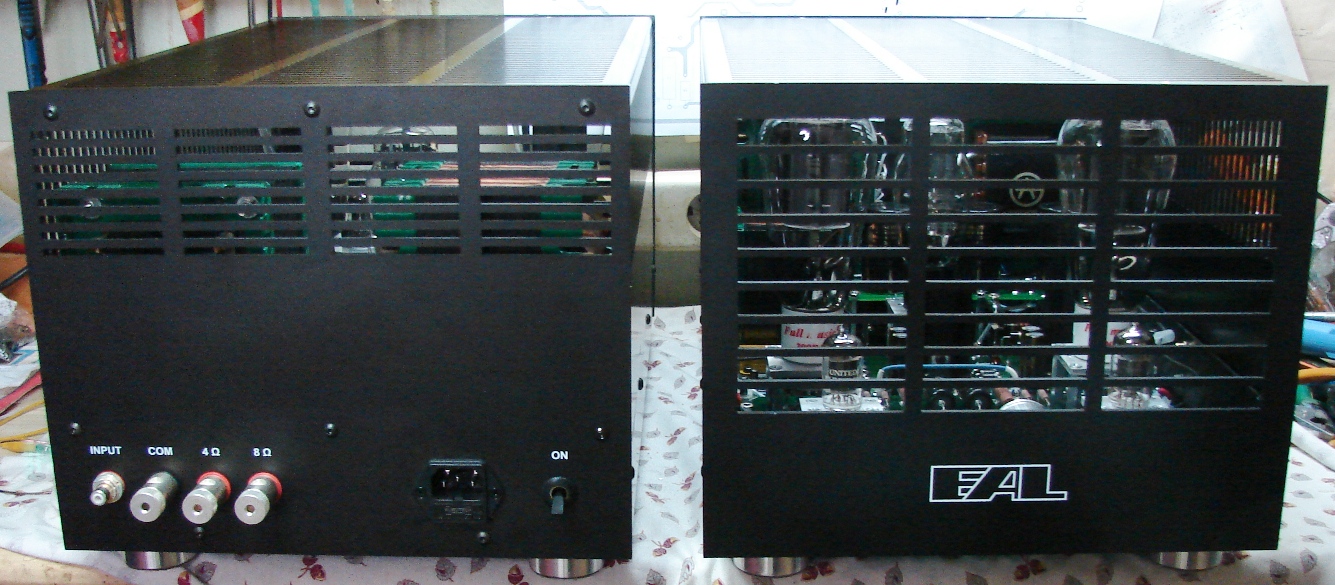

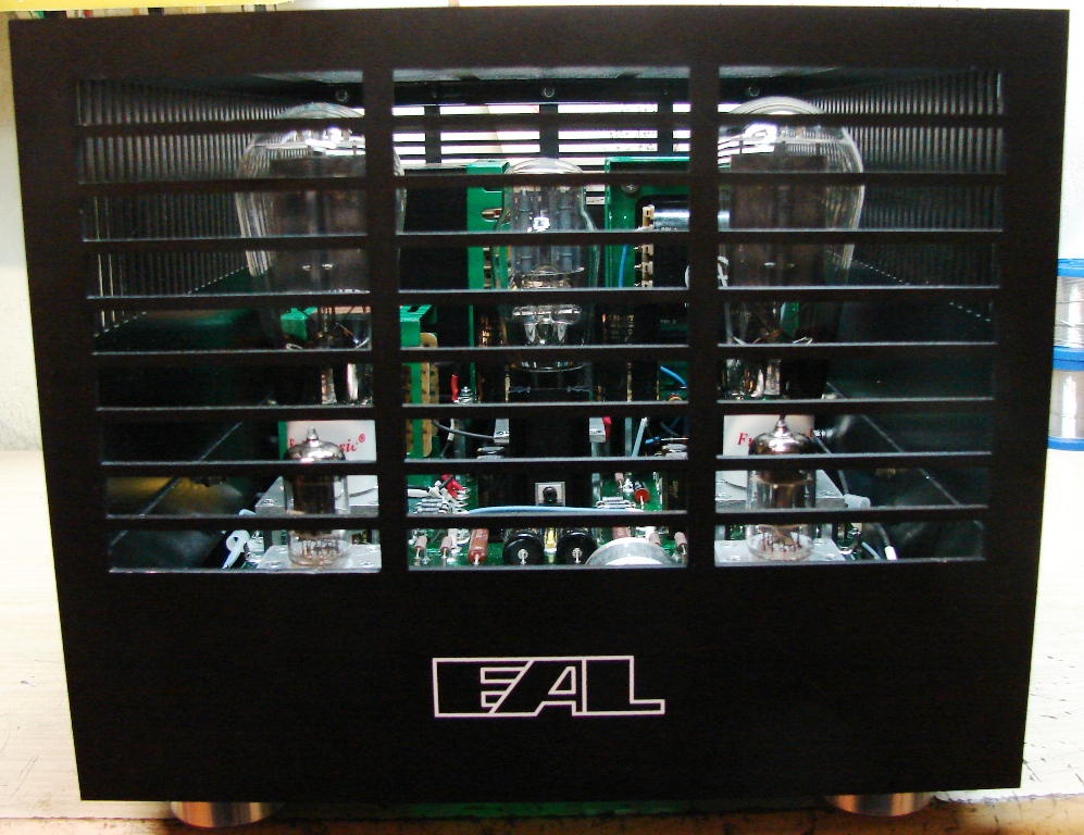

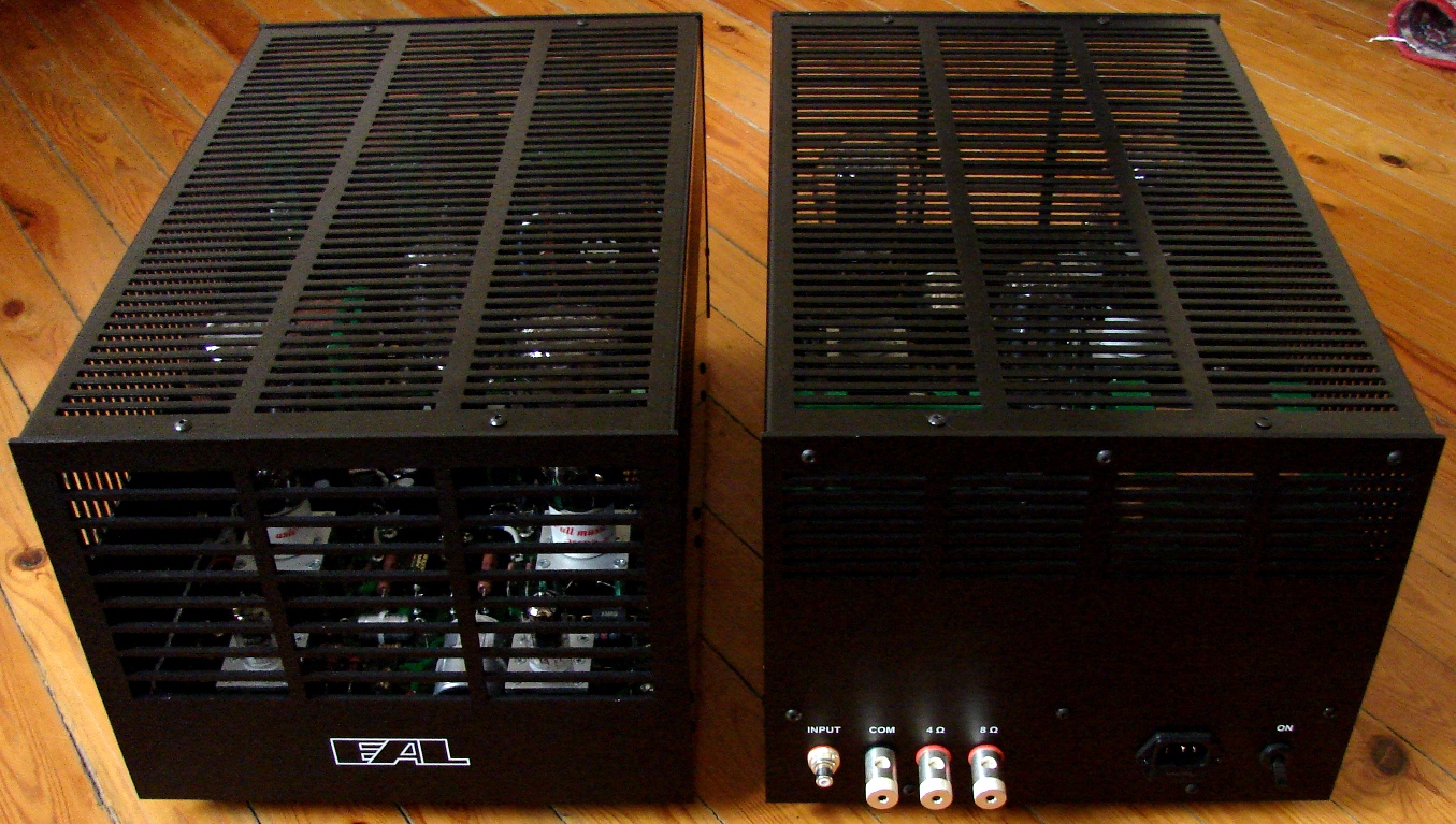

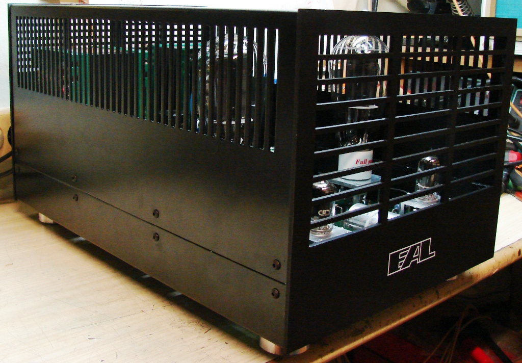

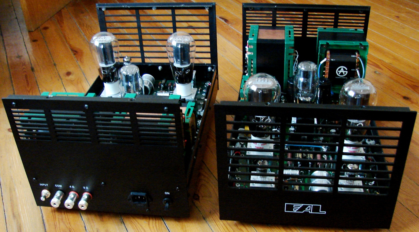

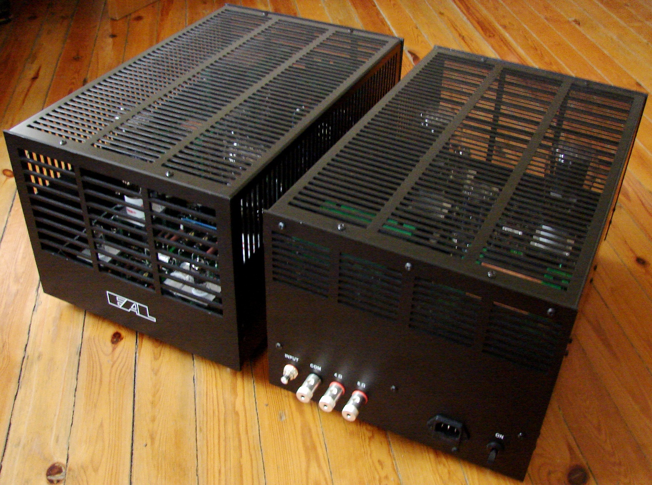

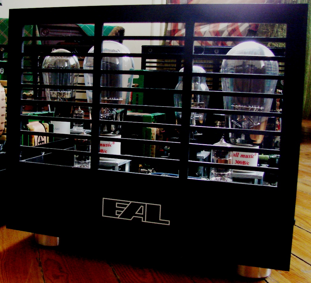

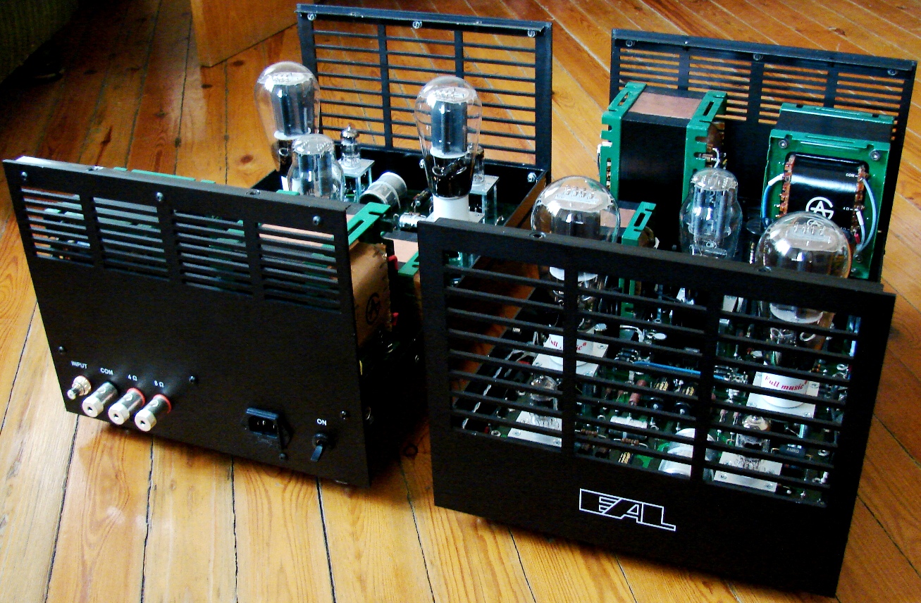

SET monoblocks.
A pair of super duper monoblocks into full covered aluminum chassis for safety reasons (kids in home). Very difficult construction because the restricted outer dimensions: 46cm depth X 23cm height X 29cm width. Chassis are designed to offer clear visibility of internal parts, for that reason the enormous ventilation holes especially in front panel. Single ended, no feedback and of course class A operation. Sincerely, the best sound i have ever heard! Low order harmonics are growing up gradually in a nice way and in accordance with the output power offering thus a nice sound coloration. Output tubes are a paralleled matched pair of TJ Full Music 300B with solid carbon plates so can be driven up to 20-21 Watt RMS without fear which means that amplifier is compatible with speakers even of 86-87dB SPL sensitivity. Input tube is a EF86 pentode which is buffered from output tubes thru a 5687 dual triode connected as cathode follower.

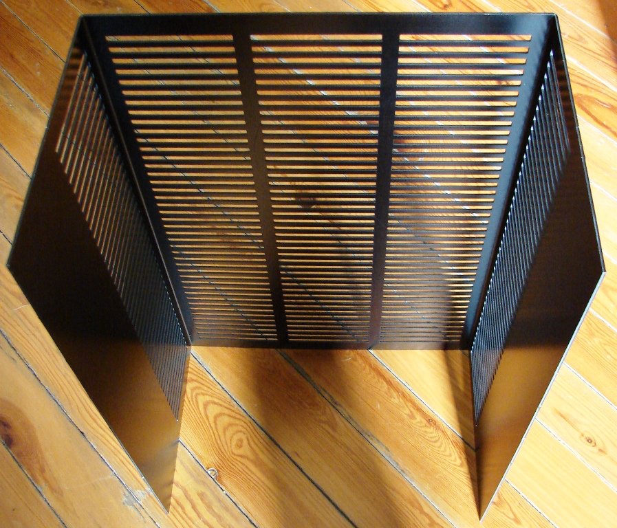

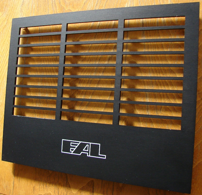

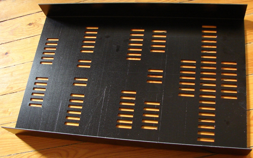

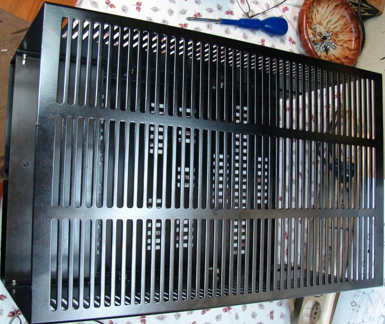

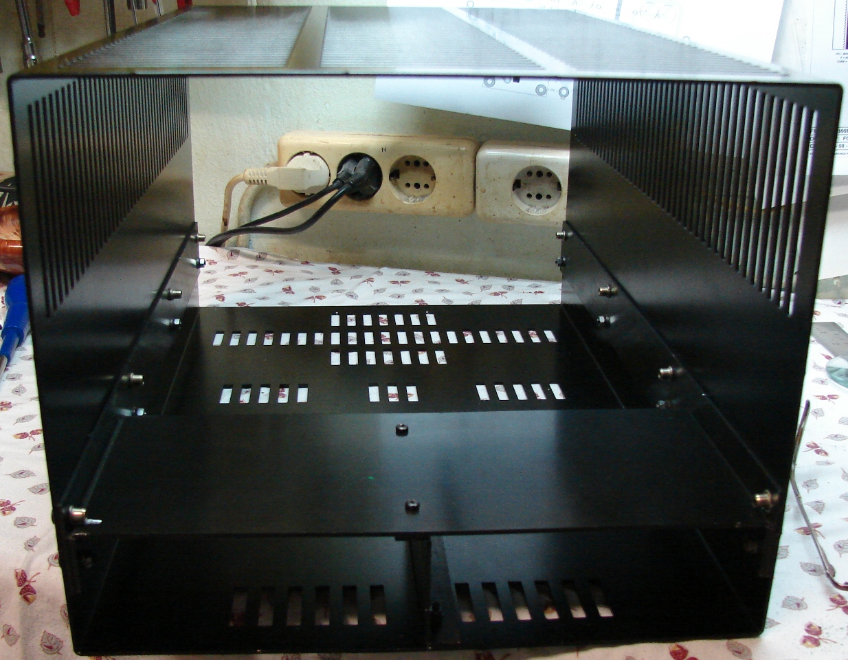

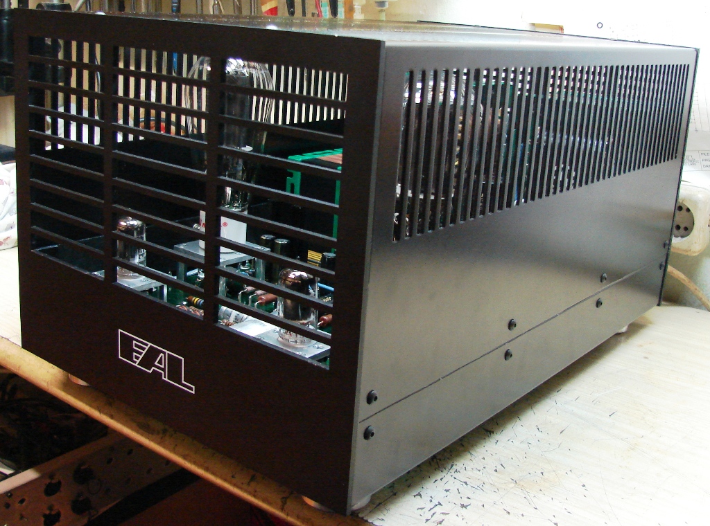

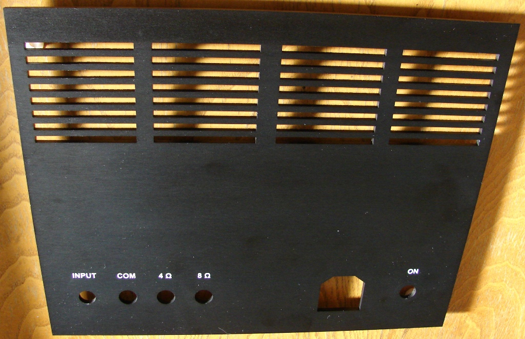

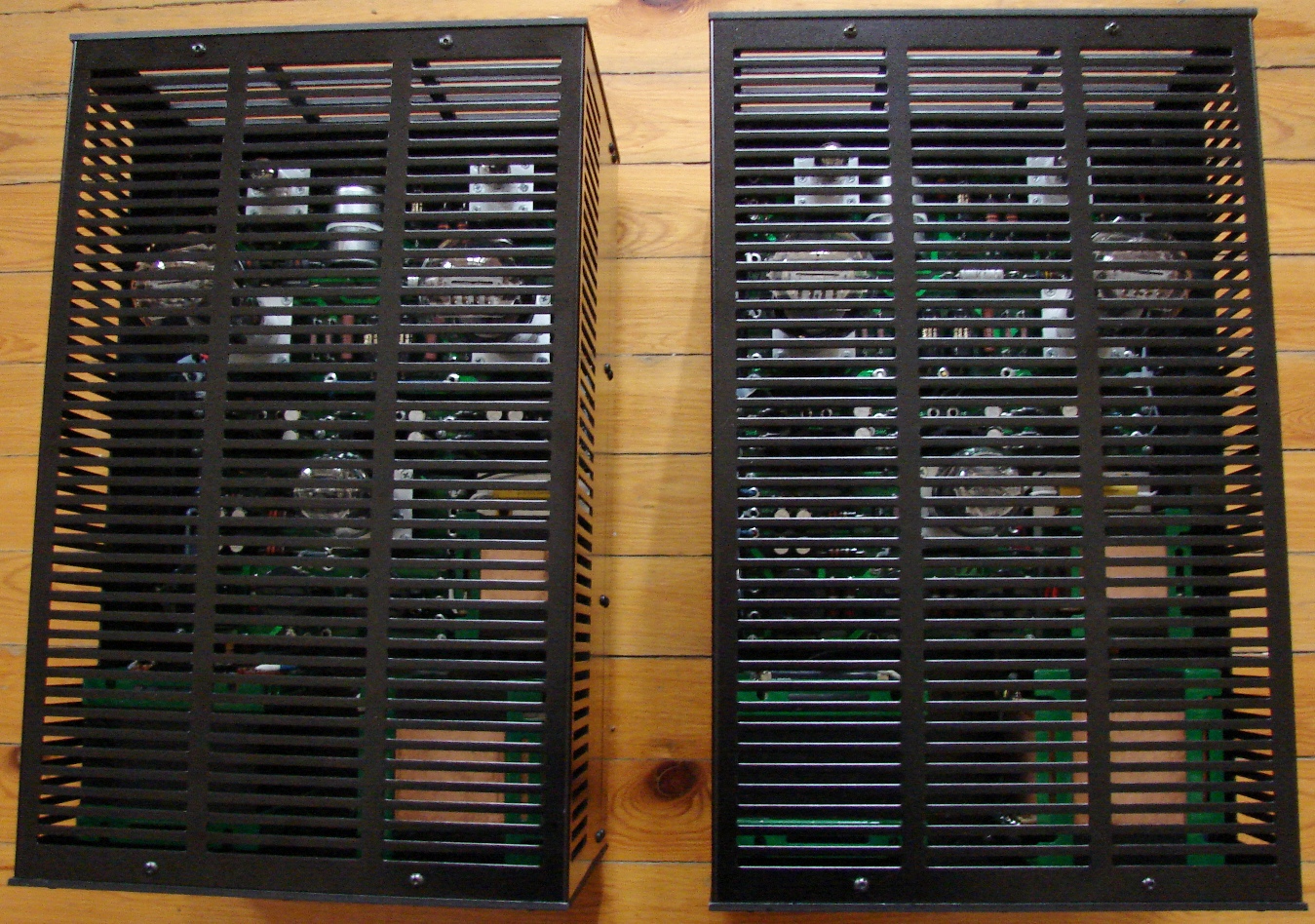

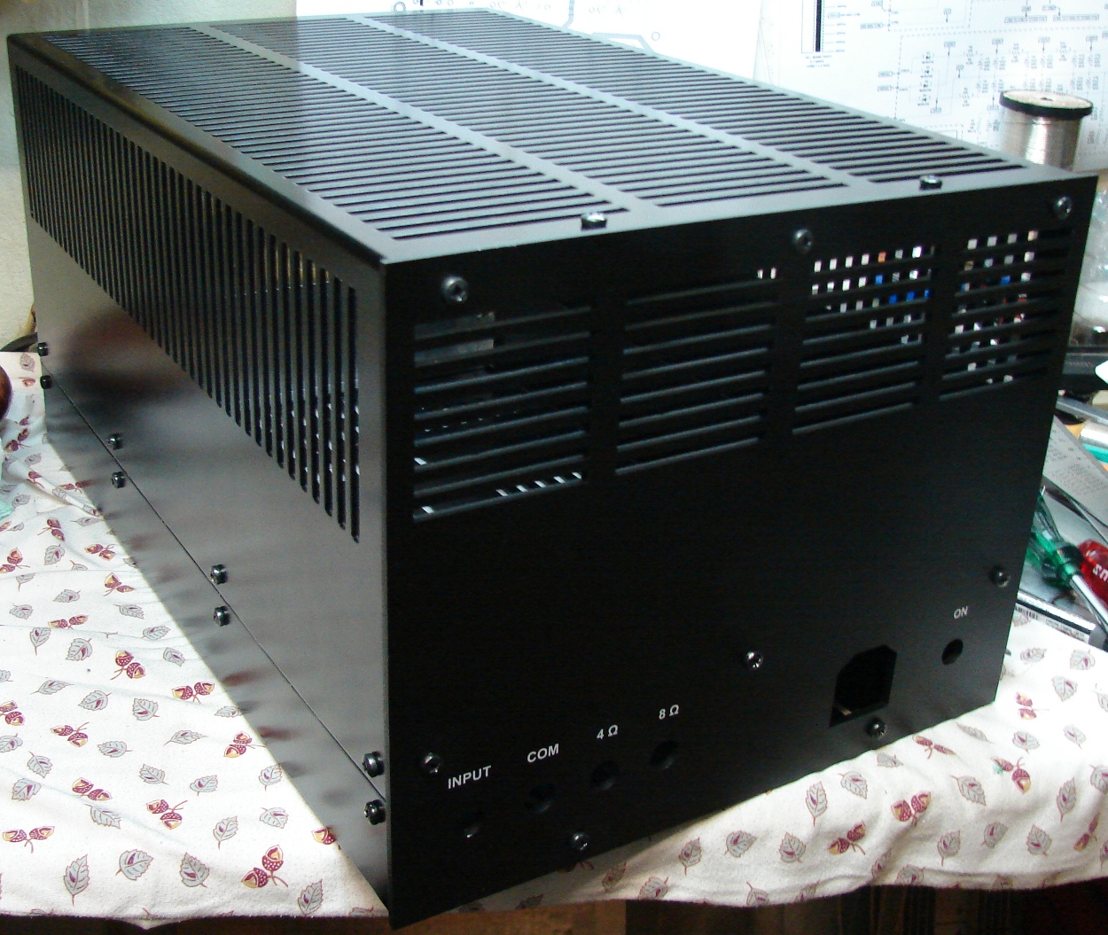

SET monoblock B-part
Here pictures of chassis parts. Front and rear panels are made from 4mm aluminum while top and bottom cover from 2mm. Front and rear panels are processed with CNC laser while top and bottom covers with CNC punching machine. All made in Greece. In two pictures the chassis assembled off-hand.

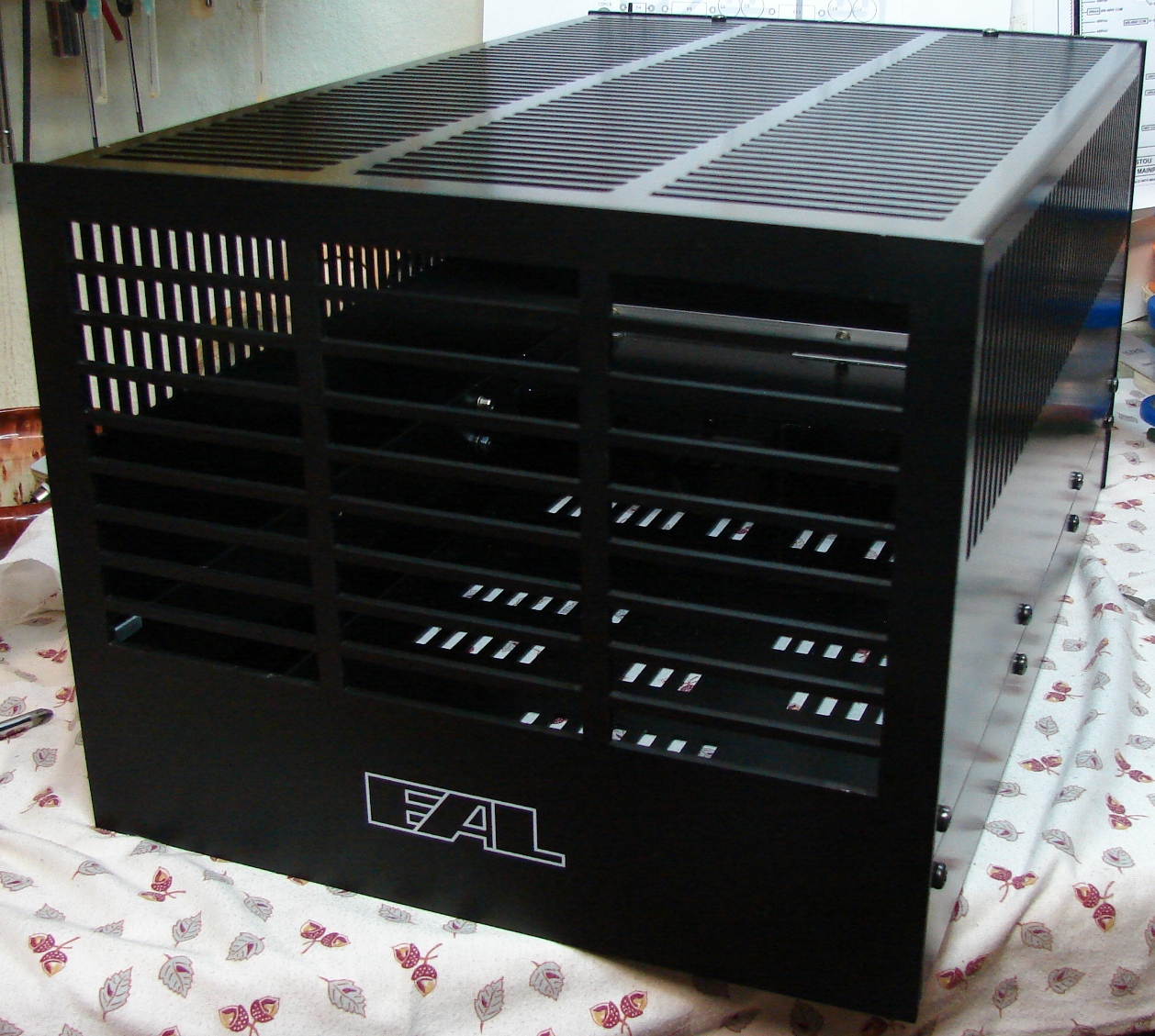

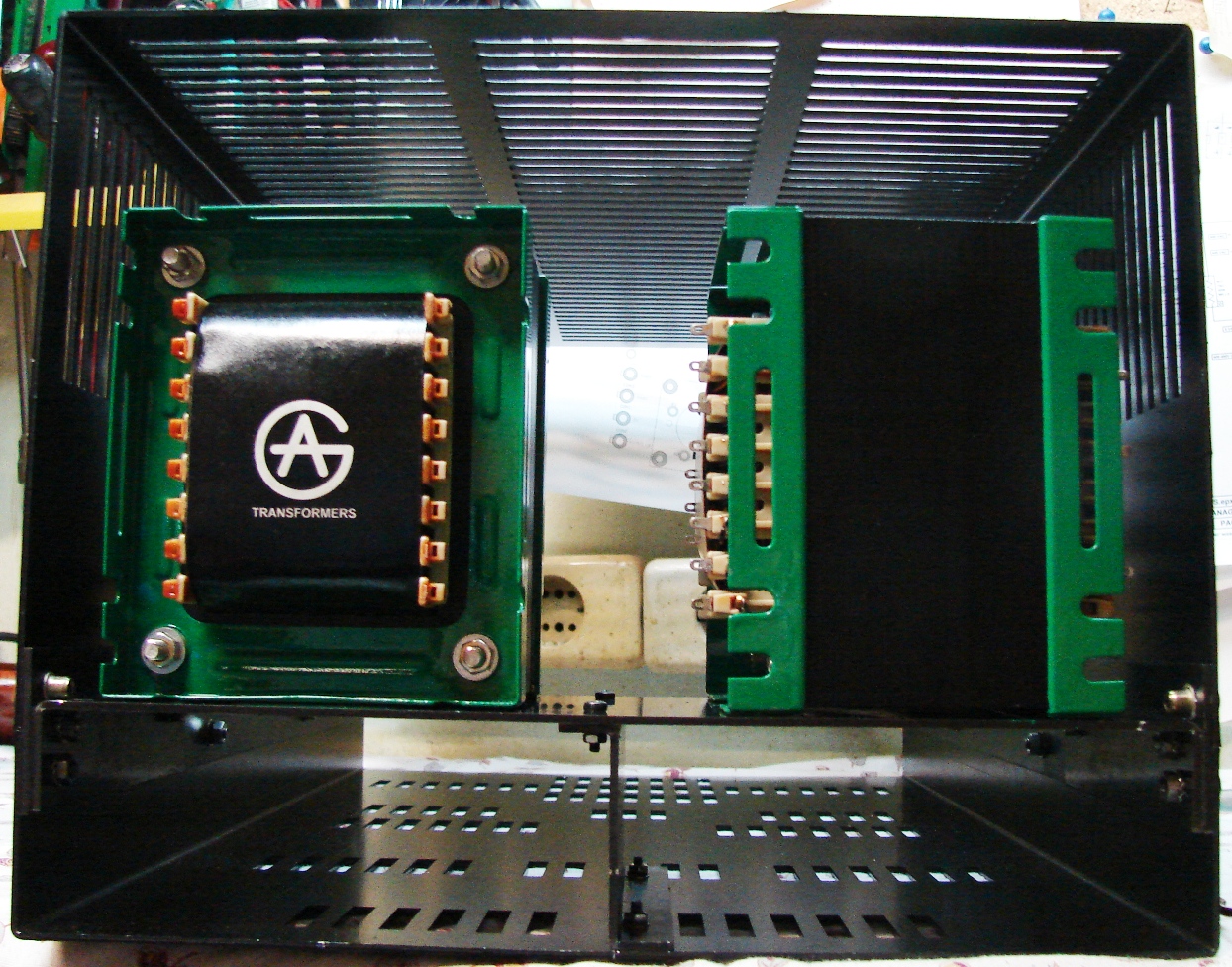

SET monoblock C-part
Here more pictures of chassis. In the first you can see the difficalty of assembly: the power and output transformers are mounted on a rised support plate because the lower space is needed for mounting of input RCA socket, output binding posts, IEC mains inlet and power switch.

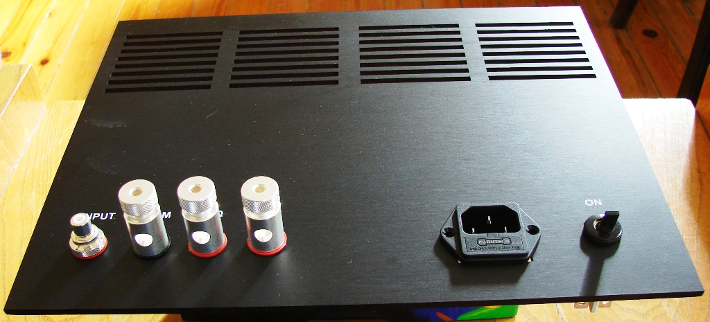

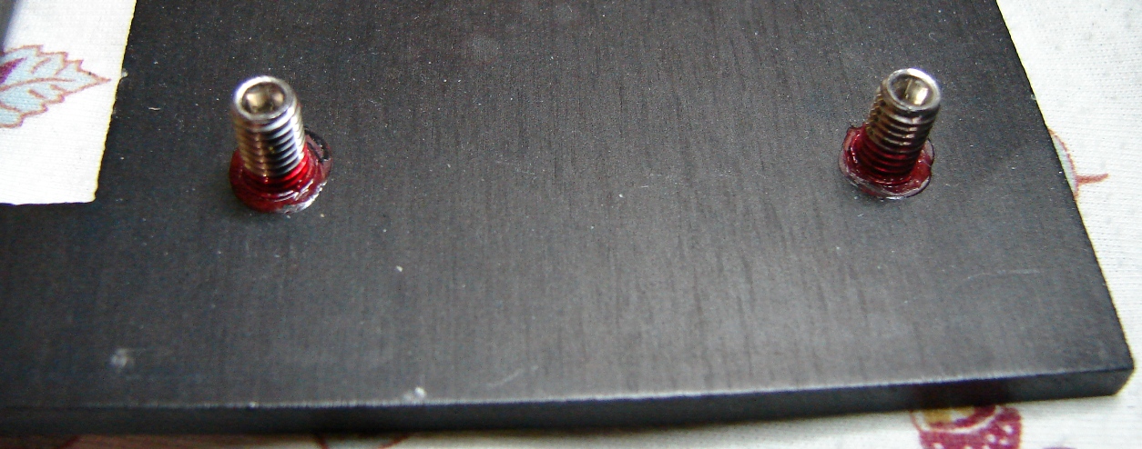

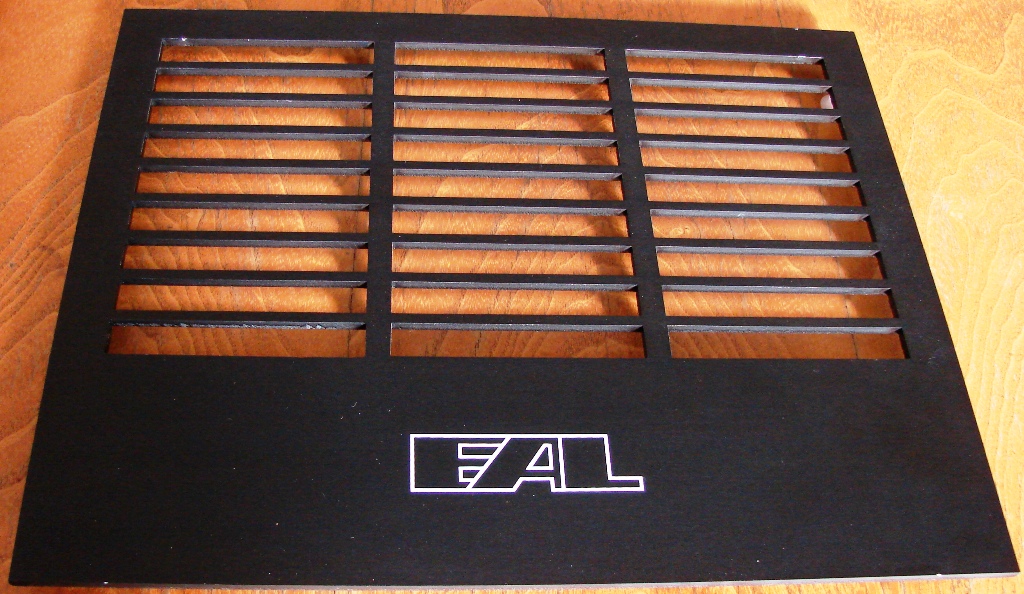

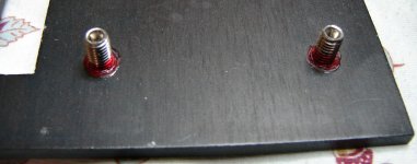

SET monoblock D-part
Here again details of chassis. In the first pic are shown the back panel parts: 1) The input CMC silver phono socket 2) The three Audio Note silver output binding posts 3) The Furutech rhodium IEC mains inlet, and 4) The APEM (Made in France) 2 pole 16A/250Vac toggle power switch which makes a nice "clonck" sound when is moved. In the rest pics you can see how the front panel is mounted on front support plate with "hidden" grubb screws.

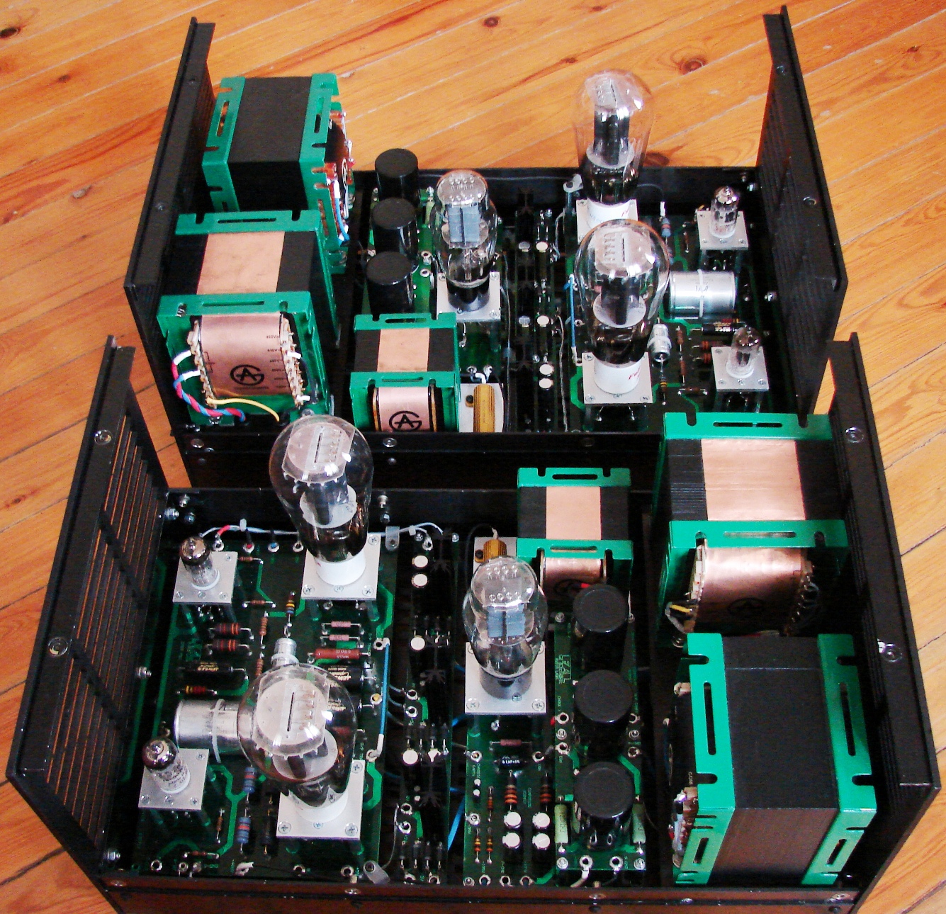

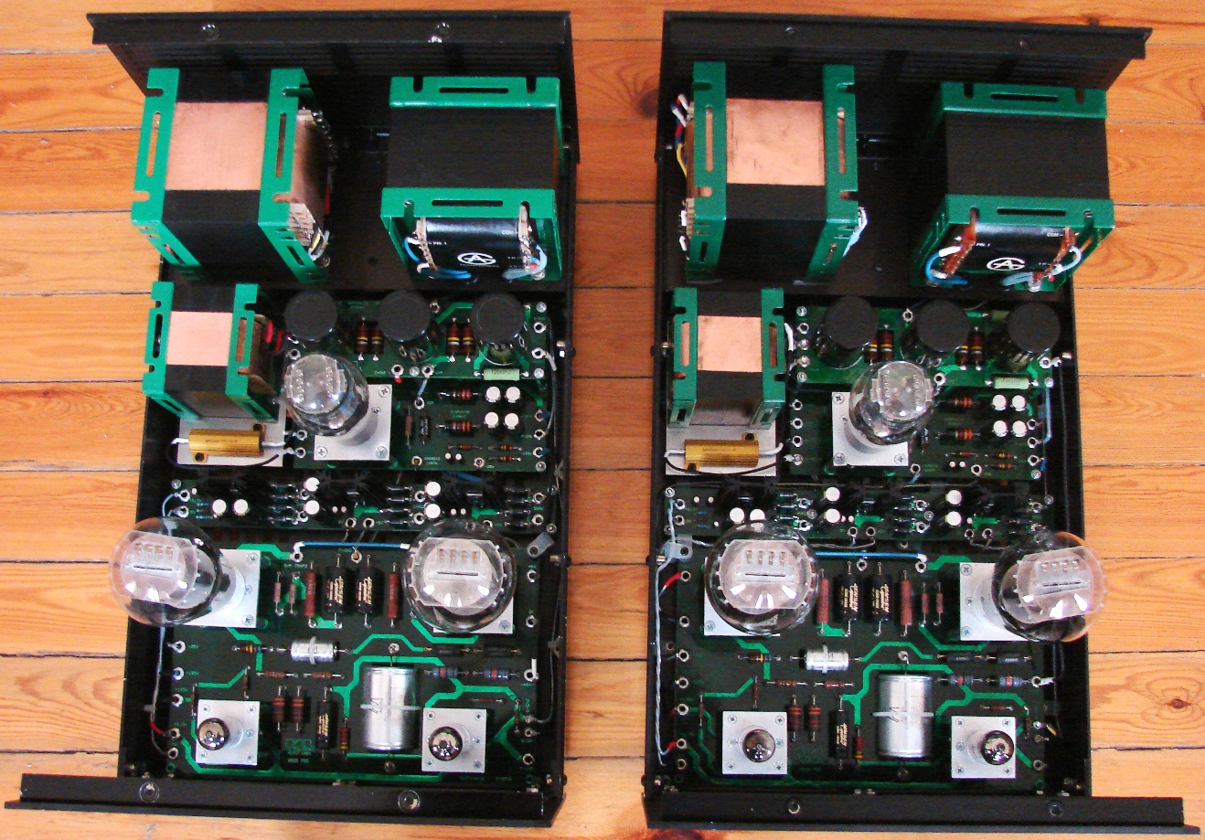

SET monoblock part-F
Now some internal pics. All internal wiring is made with Neotech UPOCC silver wire (either 0.8mm or 1.0mm) with PTFE sleeving. All colored cables are so because i added over the PTFE extra insulation from heatshrinkable tube where the tension exceeds 400V. Safety first!
