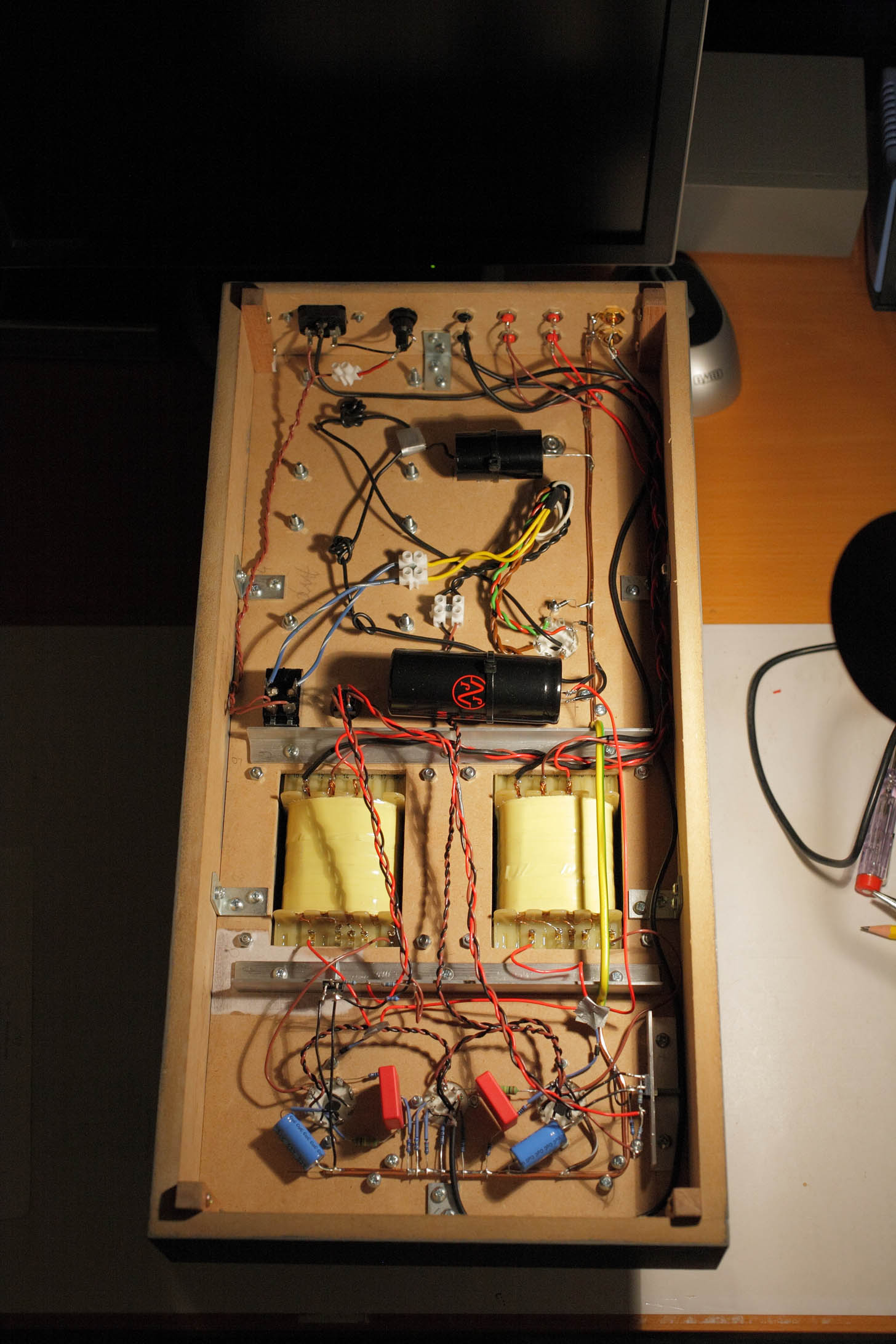

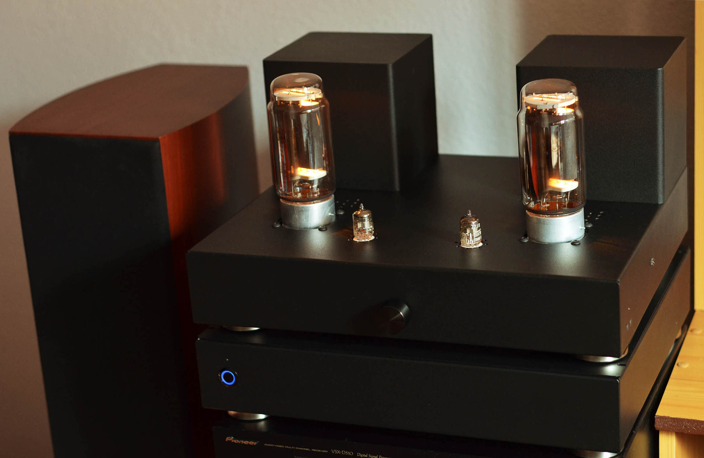

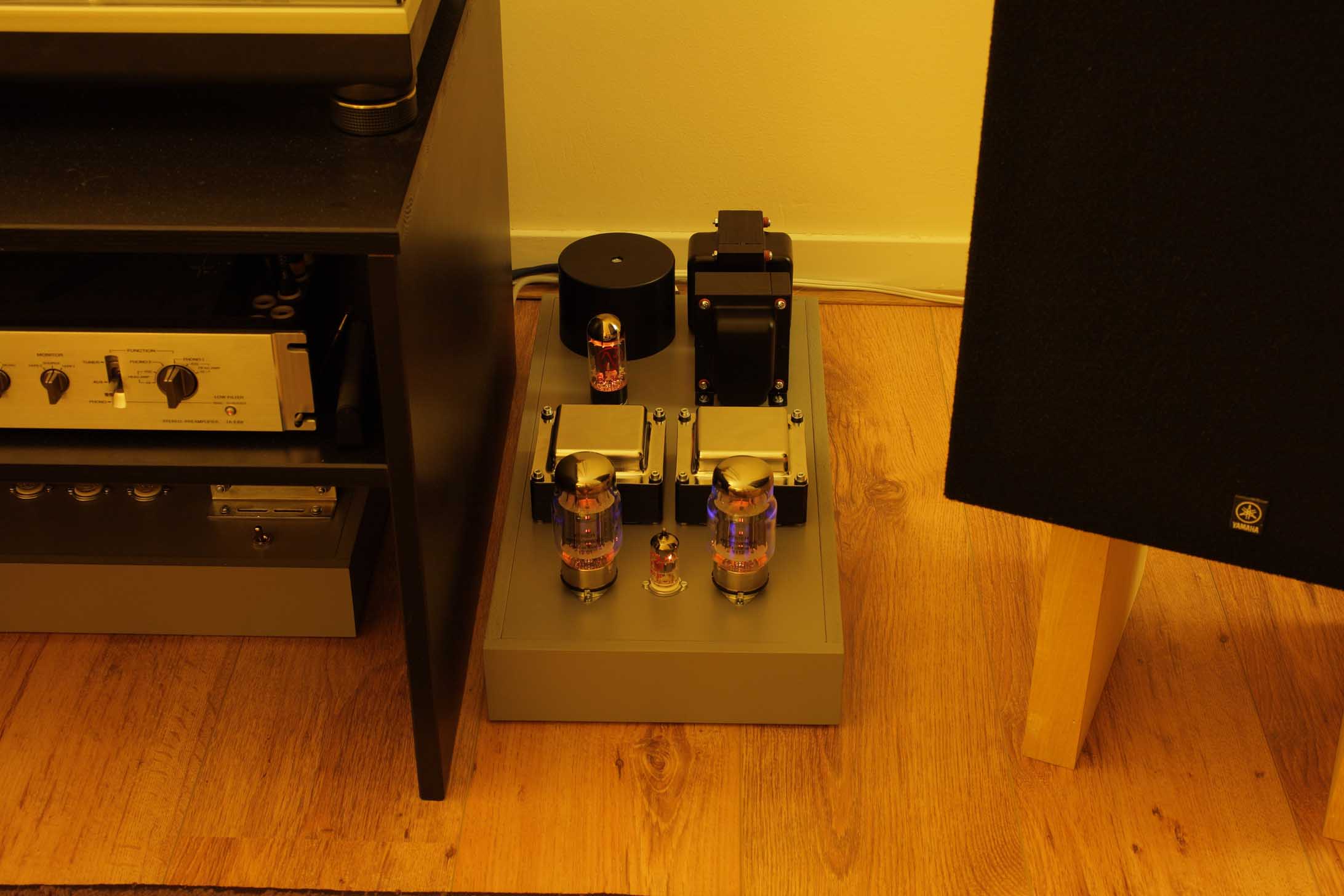

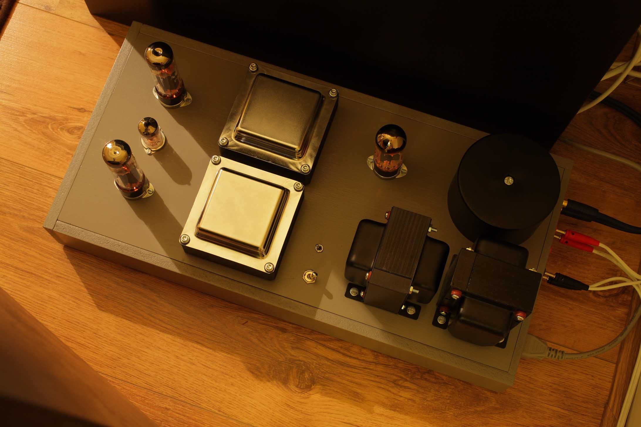

RH Universal build
Pictures of my new build, the 'RH Universal'. Schematic by Aleksandar Kitic.
It's a single ended design allowing the use of various output tubes, by selecting the cathode current and/or changing rectifier type. One could say it works best with the KT88, but that depends on taste as well.

Nice build! How common is it to have the driver stage being supplied through the OPT of the output stage?
Like the sound even more as from my RH84, very clean and precise, also easy to listen to.

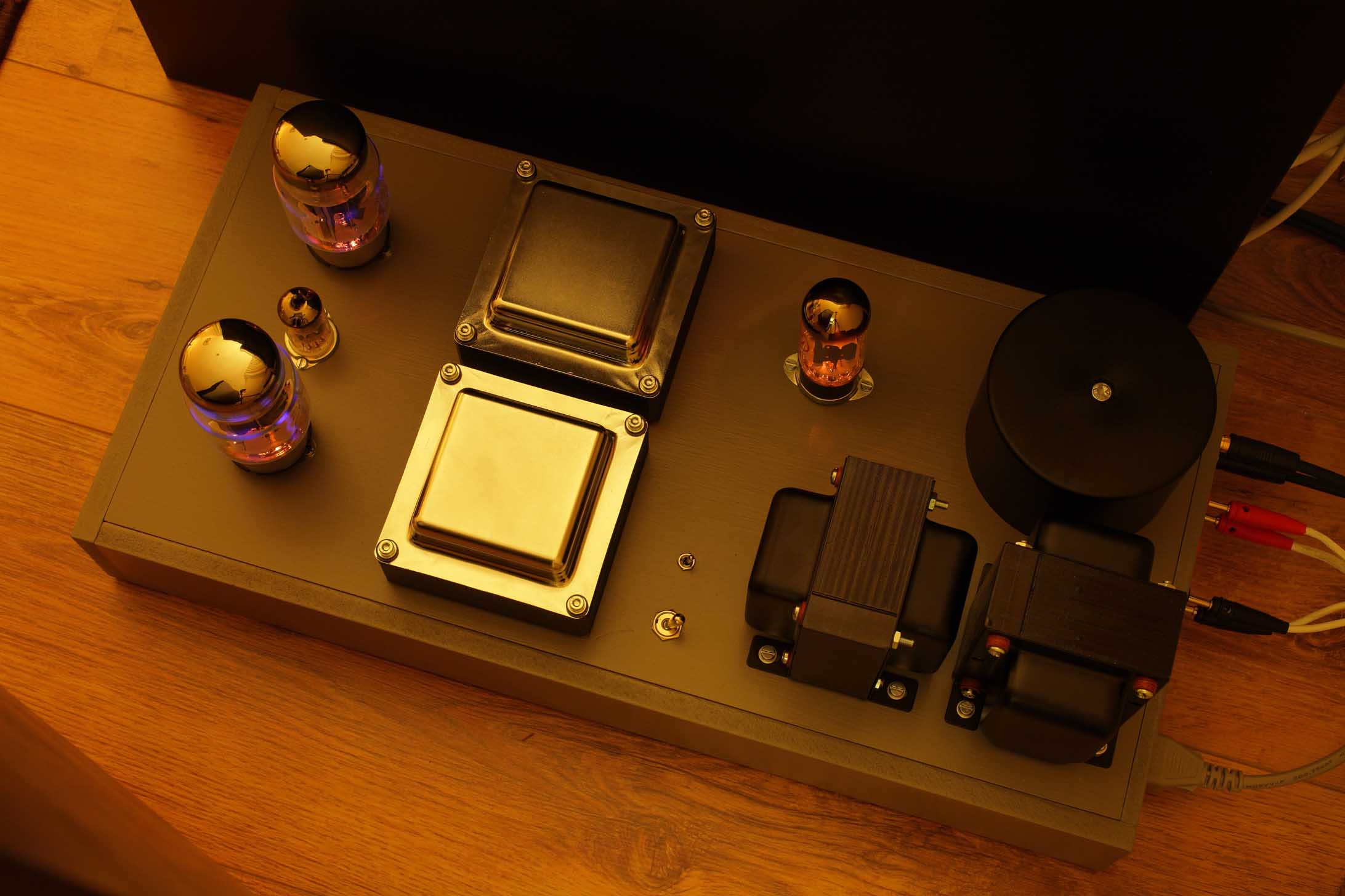

from left to right....7N7 Aikido, 5670-12AU7 Aikido, 6CG7-6GU7 Aikido.....will roll preamps.... 😀

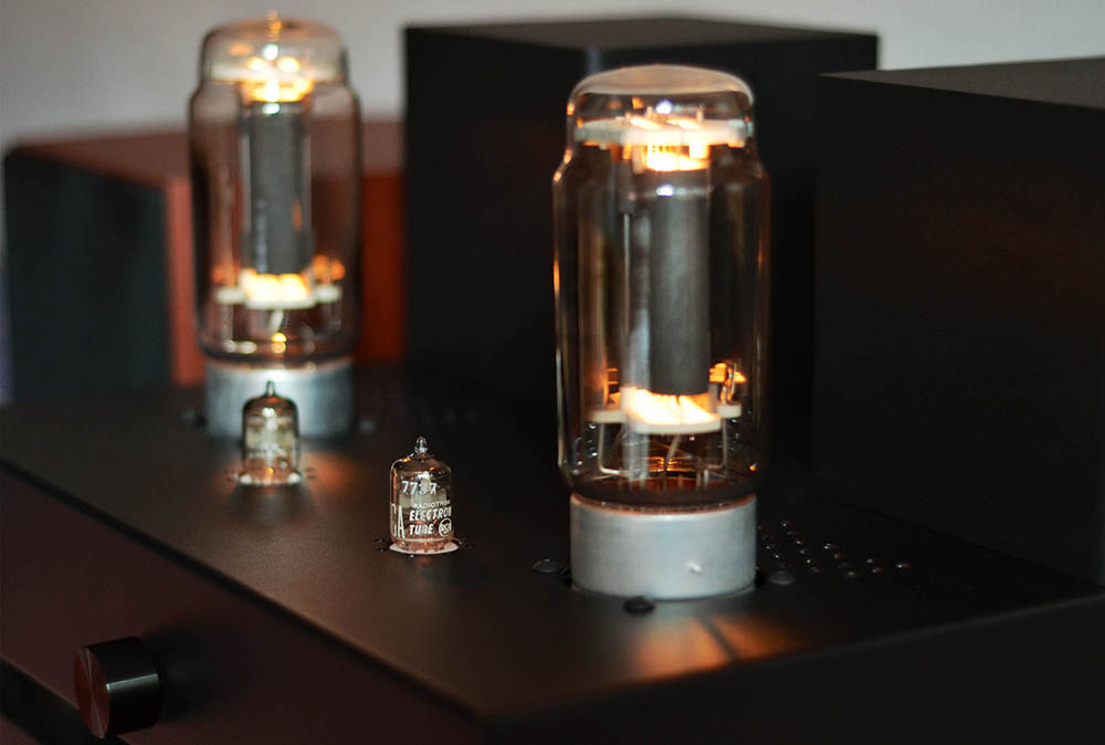

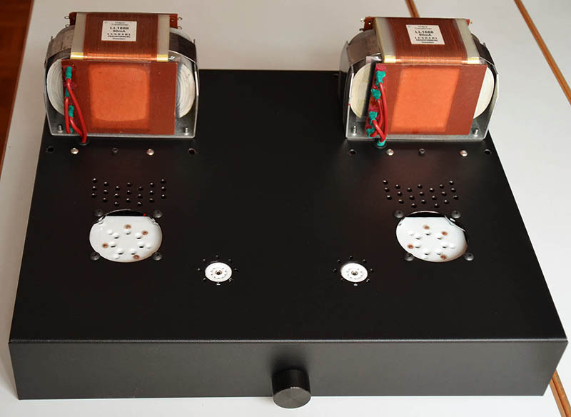

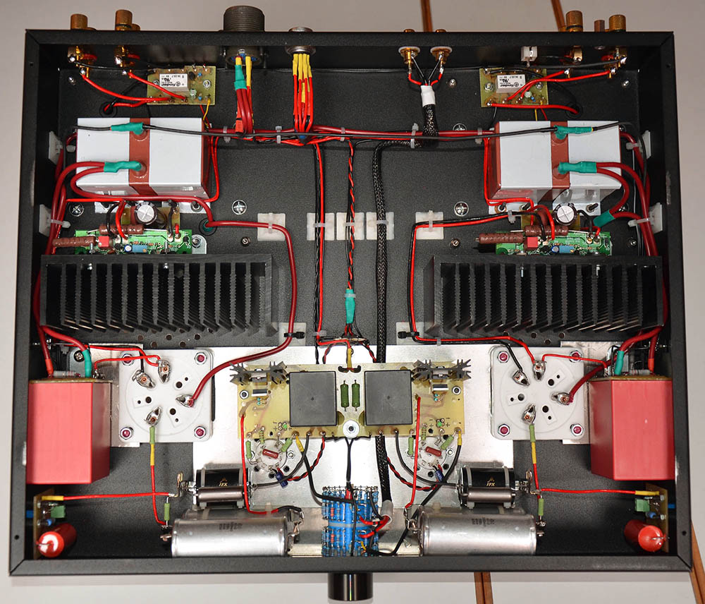

Sure. Here is the GM-70 SE amp that I've just (almost) finished.
My own schematic, but it's nothing really special.
It outputs a measured 29W RMS before distortion shows. The first stage is a CCS loaded, LED biased D3a (the photos were taken with an E186F in that position). The D3a has enough swing to drive the GM70 into clipping.

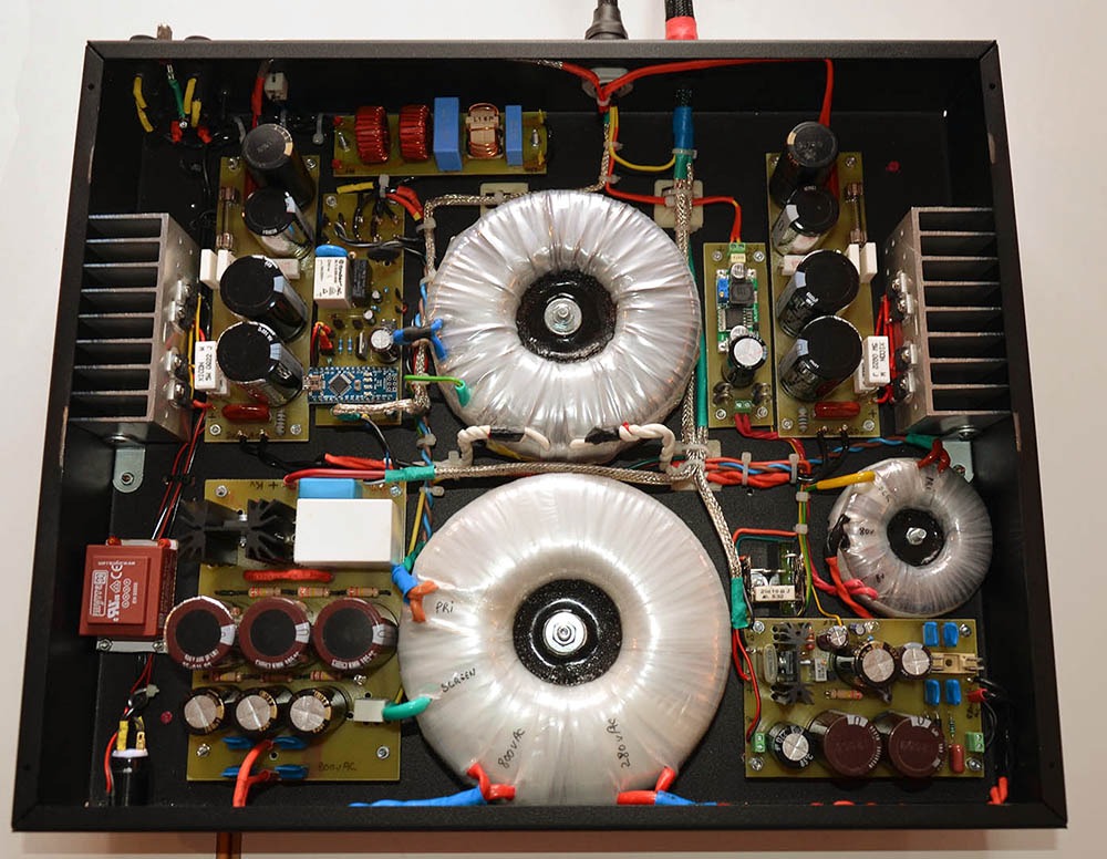

The GM-70 are fixed bias. They are constantly monitored by an Arduino microcontroller that I've programmed, which switches off the amp in case of problems. It also does soft start and temporisation, plus LED control to indicate status, problems or overload/clipping.
OPTs are custom gapped (90mA) Lundahl LL1688.
The supplies are in a separated chassis. There are no filtering chokes in my supplies - it's done with Mosfets and SiC Schottky rectifiers, including the 1050v GM70 supply. The kilovolt supply is not stabilized, only filtered;
the 350v supply is stabilized, not regulated (I do not like the sound of regulated supplies).
Together with Rod Coleman's filament supplies, this makes the amplifier absolutely silent, ear to the (95dB) speaker.
It sounds great.
Forgot to say this is my first big amp project, I only did headphone and guitar before. I think and hope the next one WILL look better!
