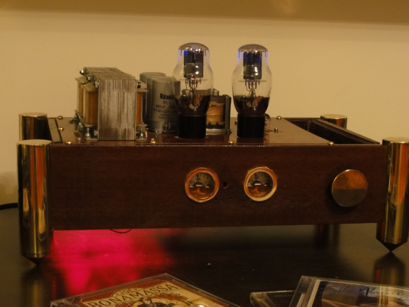

Forgot to say this is my first big amp project, I only did headphone and guitar before. I think and hope the next one WILL look better!

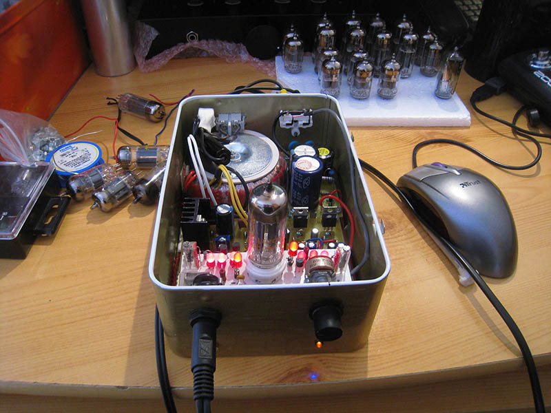

Here, this was my first headphone amp. Made it in a sugar box. Re-wound the toroid myself, by hand (took me ages). Nice, eh? 😛

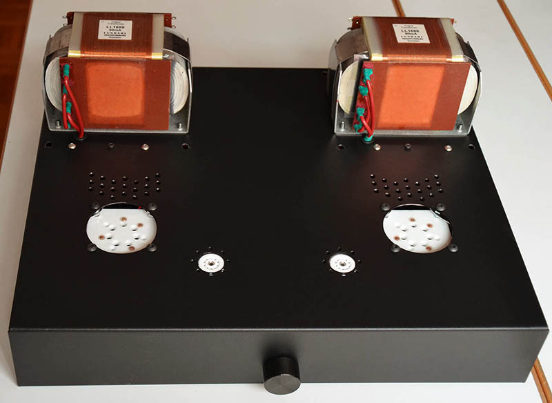

Sure. Here is the GM-70 SE amp that I've just (almost) finished.
My own schematic, but it's nothing really special.
It outputs a measured 29W RMS before distortion shows. The first stage is a CCS loaded, LED biased D3a (the photos were taken with an E186F in that position). The D3a has enough swing to drive the GM70 into clipping.
The GM-70 are fixed bias. They are constantly monitored by an Arduino microcontroller that I've programmed, which switches off the amp in case of problems. It also does soft start and temporisation, plus LED control to indicate status, problems or overload/clipping.
OPTs are custom gapped (90mA) Lundahl LL1688.
The supplies are in a separated chassis. There are no filtering chokes in my supplies - it's done with Mosfets and SiC Schottky rectifiers, including the 1050v GM70 supply. The kilovolt supply is not stabilized, only filtered;
the 350v supply is stabilized, not regulated (I do not like the sound of regulated supplies).
Together with Rod Coleman's filament supplies, this makes the amplifier absolutely silent, ear to the (95dB) speaker.
It sounds great.
I forgot to mention that Tony built his own enclosures, do you too ?
http://www.diyaudio.com/forums/tubes-valves/216206-my-russian-set.html
BTW. You should to drill the holes as well as he does.
Yes. I know the thread and I admired the quality of that chassis. I didn't like the apparent electrolytics, but it's a nice project anyway.
These holes look so good because he powder coated the chassis *after* he drilled. I didn't. Maybe on my next project? Thanks for the suggestion. 🙂

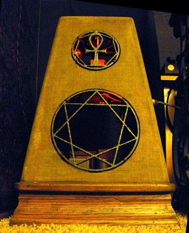

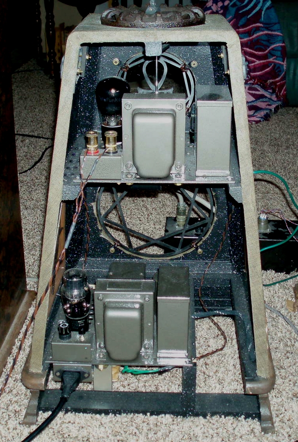

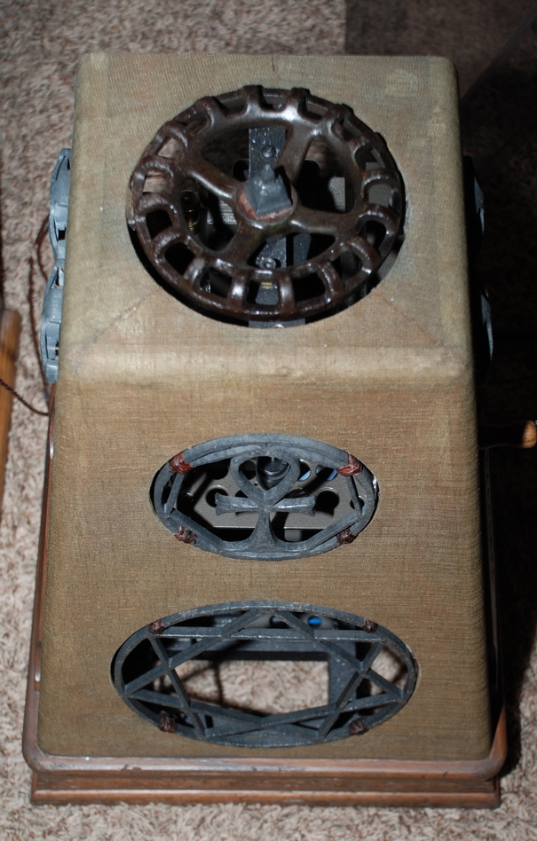

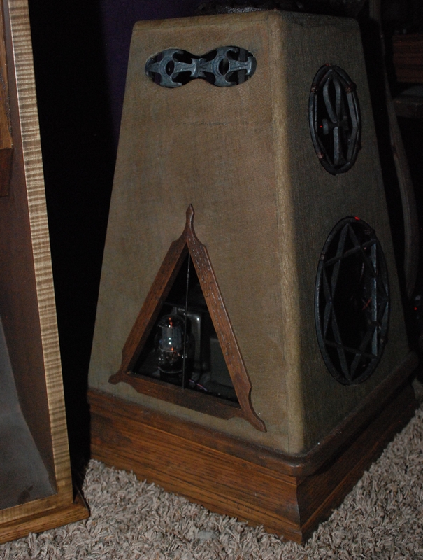

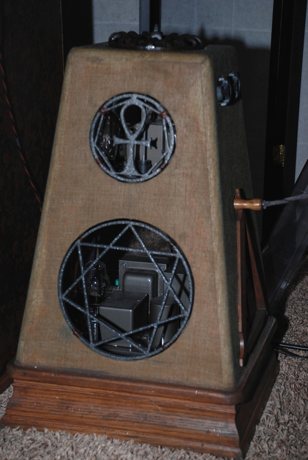

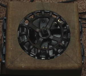

3 watt monoblocks.Telefunken RS242 power tube,transformer coupled to a 6SN7 preamp/driver.Still a few details to finish,like illumination,and some protective screens on the rear.The top vent rotates,operating the stepped attenuator.
pebmrb -
Wow! What an awesome build! I love the 'knob' for the attenuator.
What is the exterior finish? It's not obvious from looking at the photos.
And I like the symbology. I get it. 😉
Thanks 6L6
Exterior is cloth over plywood.Not too difficult to apply with the right TooL.😉
Wow! Very creative. Quasi-Ancient style, I like it! 🙂
