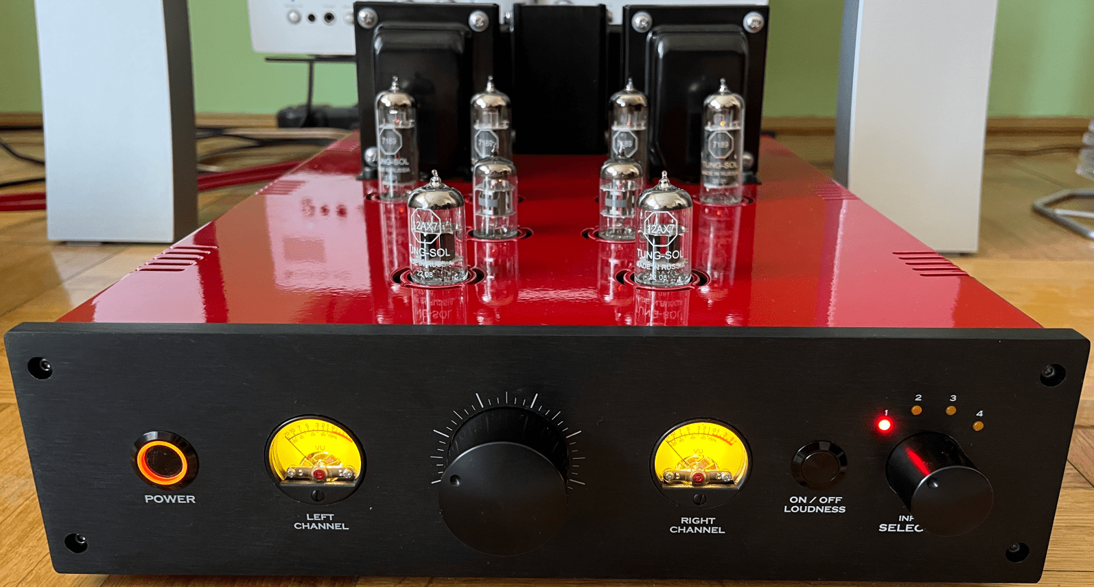

Sansui AU-70 clone
Carrion, are you using the Madras boards? what transformers?
For easy reference, there is huge thread on the Sansui AU70 clone over
on the Polish audio forum here and they have at least 3 different PCB sets and multiple
Sansui transformer clone vendors there -
https://www.audiostereo.pl/topic/152864-klon-sansui-au-70-reduktor-szumu/
Marcin Waszak (Madrass) AU70 Pro described here -
http://ww.forum-trioda.pl/viewtopic.php?t=40216

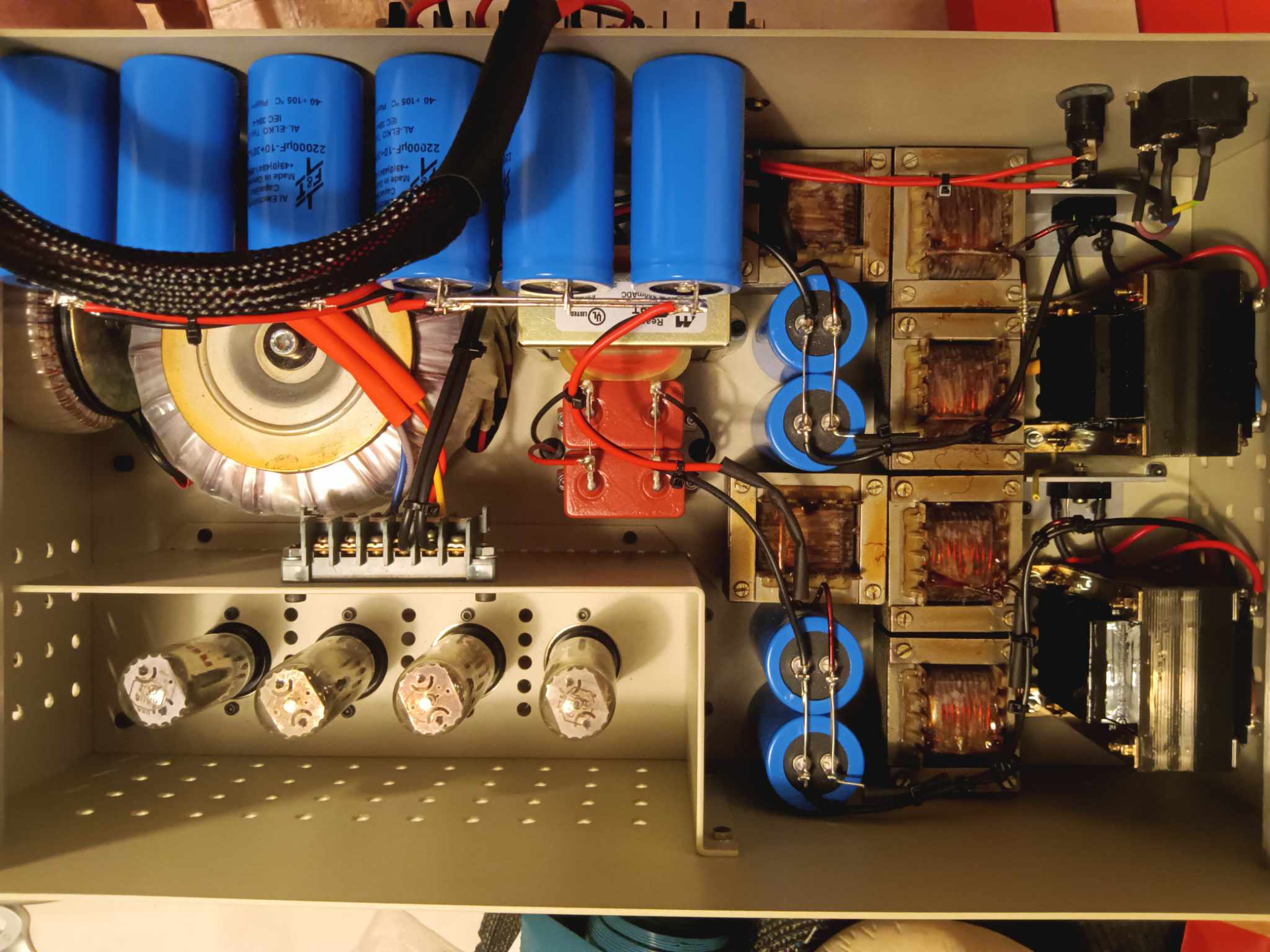

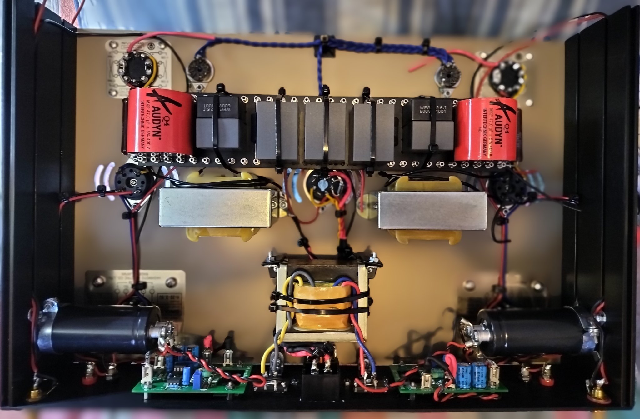

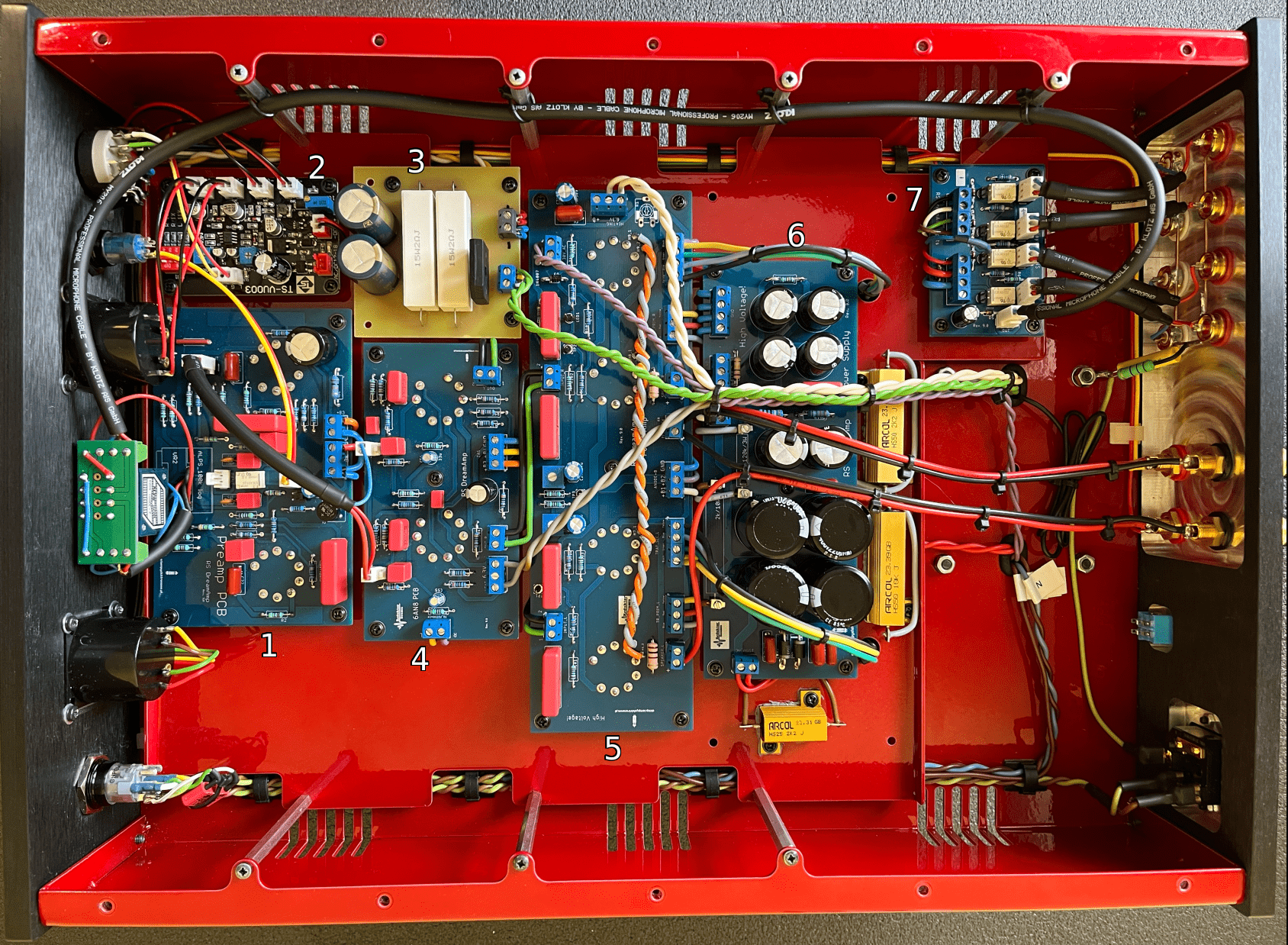

Underside at an early stage of wiring:@ruffrecords - Would be great to see the inside of that magnificent metal work.
And with the top off:
Tricky and laborious to build, but the sound quality is very, very rewarding. AU-70 was an outstanding amplifier.
- 12AX7 preamplifier
- VU meter driver
- 12.6VDC: heating preamplifier (1) tubes and also DC power supply for VU meter (2) and input selector (7)
- 6AN8 driver/phase inverter
- 7189 power amplifier
- power supply
- input selector

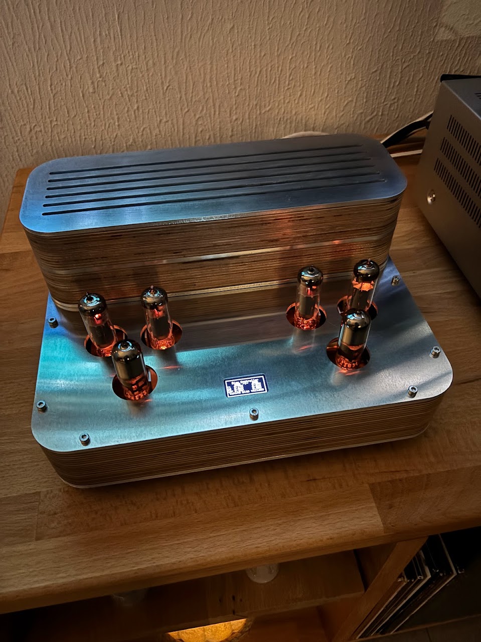

"Old Painless", named after an equally lethal piece of equipment in the classic 1987 movie Predator:
The PSU has just the right amount of copper, iron and caps for a 2x8W amp:

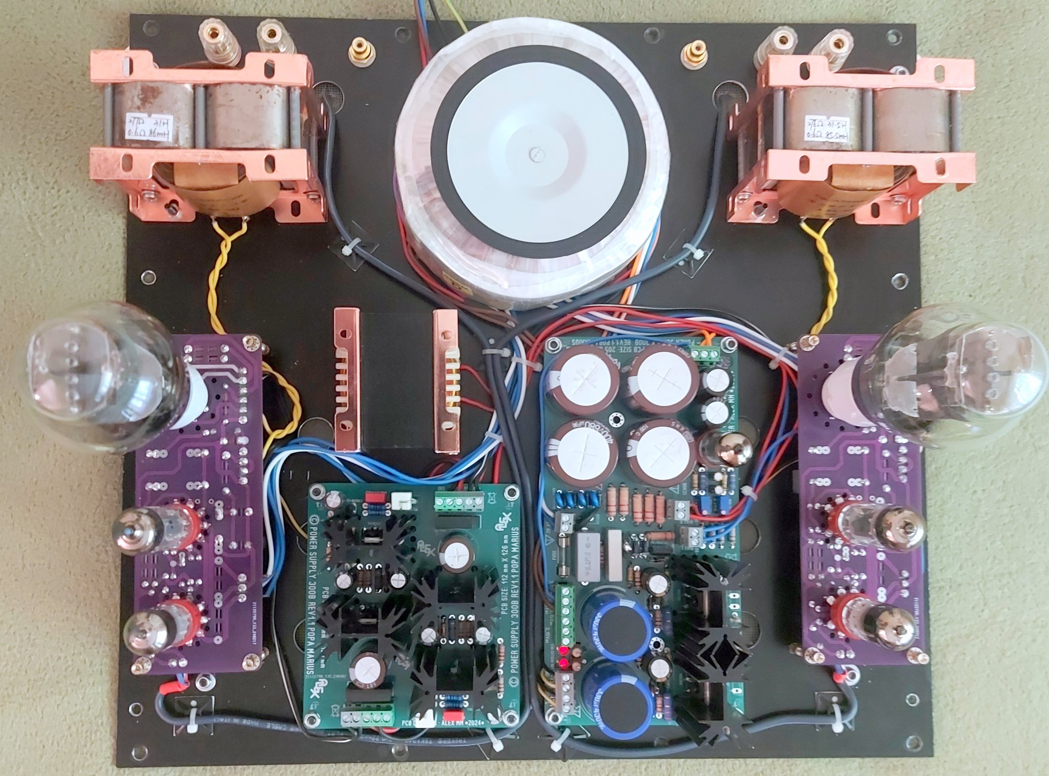

Forgive me Tim deP, but I redesigned your amp TVA10 to Ultralinear....EL34, with 12au7 srpp input, 12at7 ltp phase slitter and 12au7 cathode followers, this amp did not use global negative feedback...

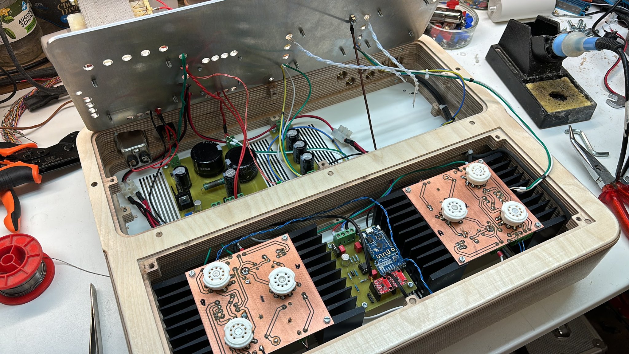

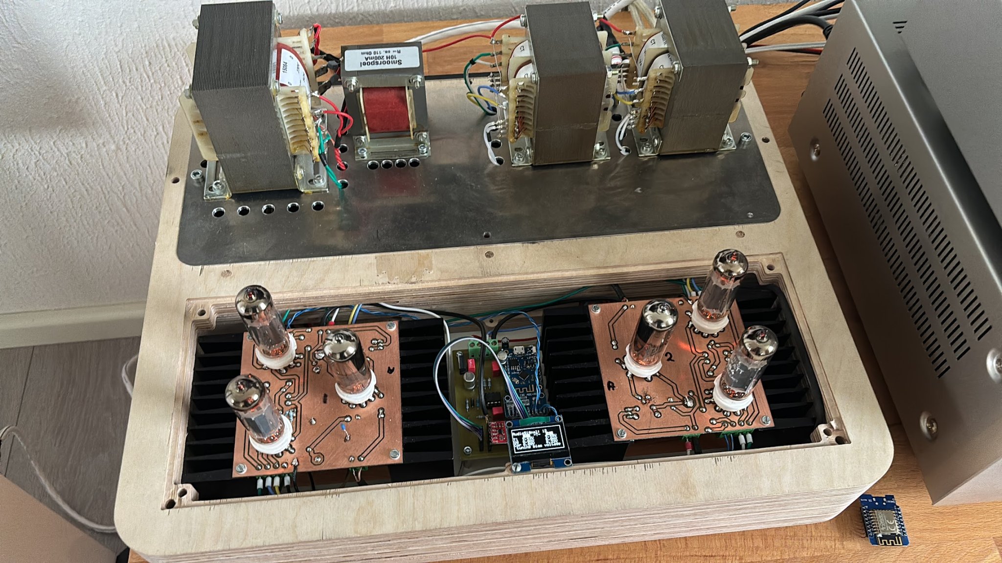

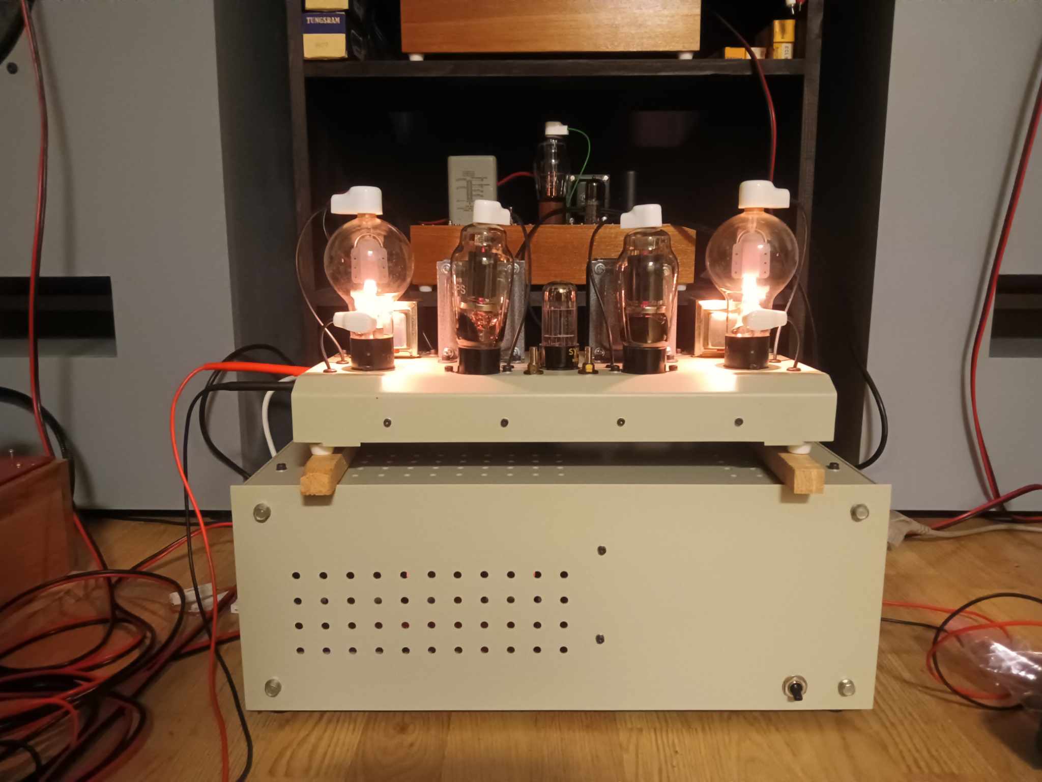

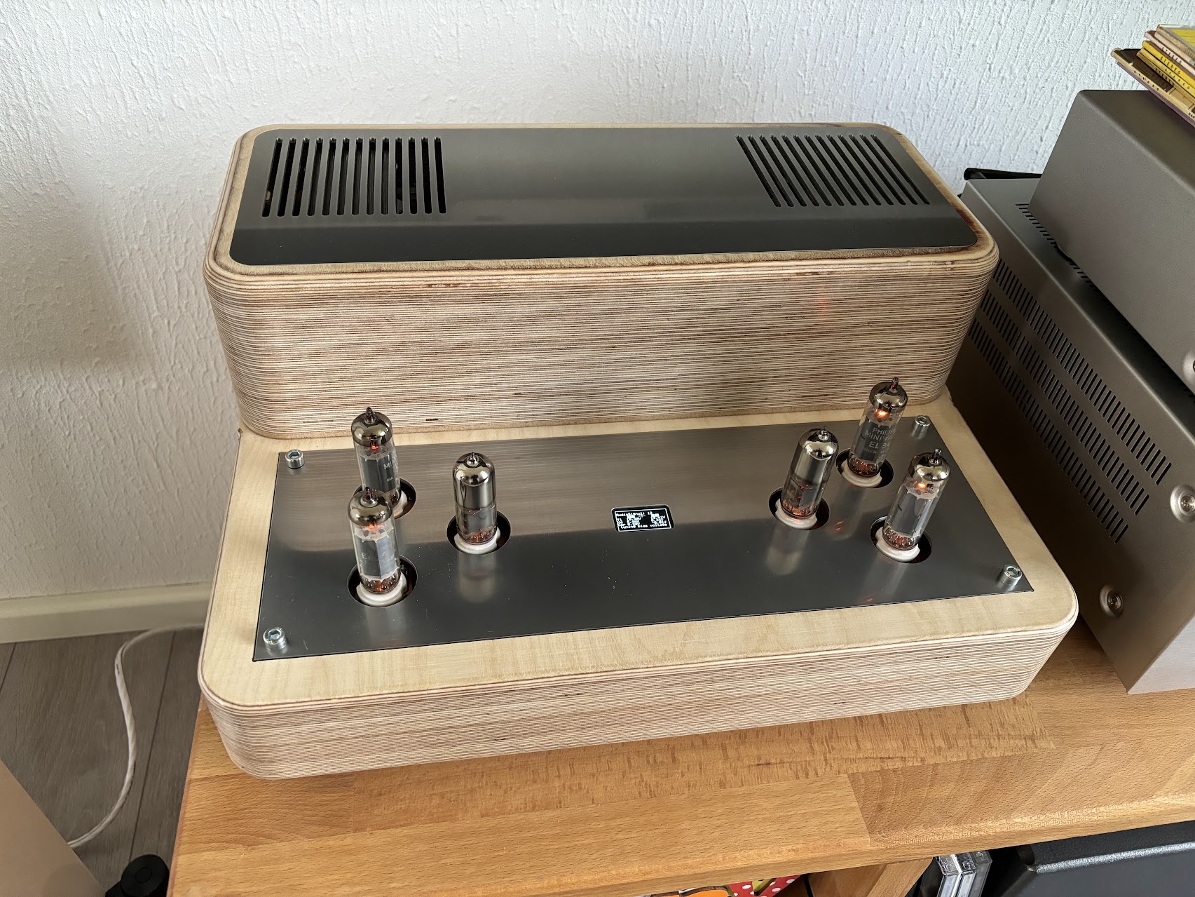

After 2 years of prototyping, this amp is nearing completion. It is a pure class A self splitting push-pull amp, with a esp32 based regulator that ensures both tubes are biased exactly equal (less than 40uA). Tubematching is optional.
Driver is 6E5P but minor redesign to 6E6P is something I want to do, because of the pinout and the possibility to try different driver tubes. (6E6P, D3A, E180F and others all have more or less the same pinout). Power tubes are EL84, NOS. Power output is a measured 8W RMS just before clipping. Distortion figures at 1W are about 0,3% mostly 2nd and 3th. No global feedback is applied.
I designed it to be an alternative for my 300B SE amplifier, because the 300B tube are becoming too expensive, and they lasted only 2-3 years in my setup. The amplifier uses silicon everywhere (CCS, regulators, Vref, DAC,ADC ...), so my initial name for the project was "Apostate". Because of the CCS's used the powersupply is almost completely isolated from the signal, and there is only one capacitor per channel in the signalpath. (I used a russian Teflon capacitor)
The amplifier sounds amazing, never had a more stable 3D stereo image.
After living with the proof of concept prototype till january this year I designed the new enclosure to match my Thorens TD160 turntable, that I build in 2023.
Beautiful work.

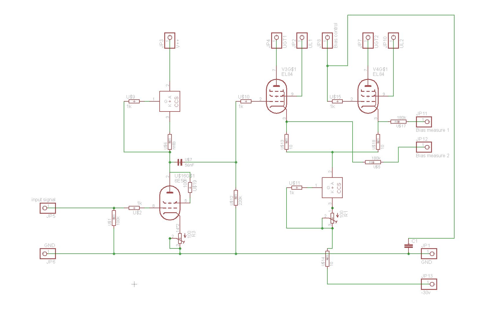

Self inverting?
Is there a CCS in the cathodes of the EL84 pair?
Post a schematic if you care to share.
Thanks!
Self inverting?
Thanks!
Yes, self inverting, and there is a CCS in the cathodes.Beautiful work.
Self inverting?
Thanks!

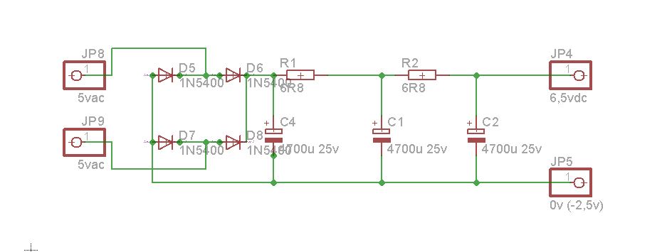

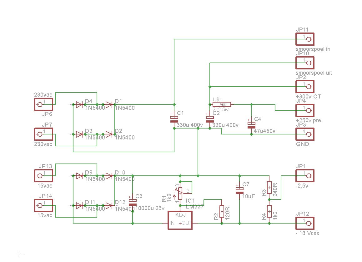

Schematics: (from old eagle version I still use)
The latest version of the amp is slightly different, but I didnt had to change the PCB's for that. The hardest thing was to get a rock-stable and noisefree -2,5v as reference for the bias controller; the regulating voltage is directly applied to the grid of the second el84, and should be able to range from -2,5v to +2,5v. The voltage splitter in the -18v line is now a 1k2 resistor and a TL431 instead of the 1k2 /240R. Vref is now very stable -2,49V, but noisy (I short that noise to ground with a capacitor.) The opamps in the bias controller are for detecting audio signal, if there is audio signal, regulating is postponed till there is no audio signal. (between songs) The 1K balancing resistors on the Bias controller and the "realground" connection are removed from the PCB. Oh and dont mind the 1n5400 diodes everywhere, i took them only for their shape/size. In reality it is a mix of shottky's, and high voltage ultrafast diodes.
