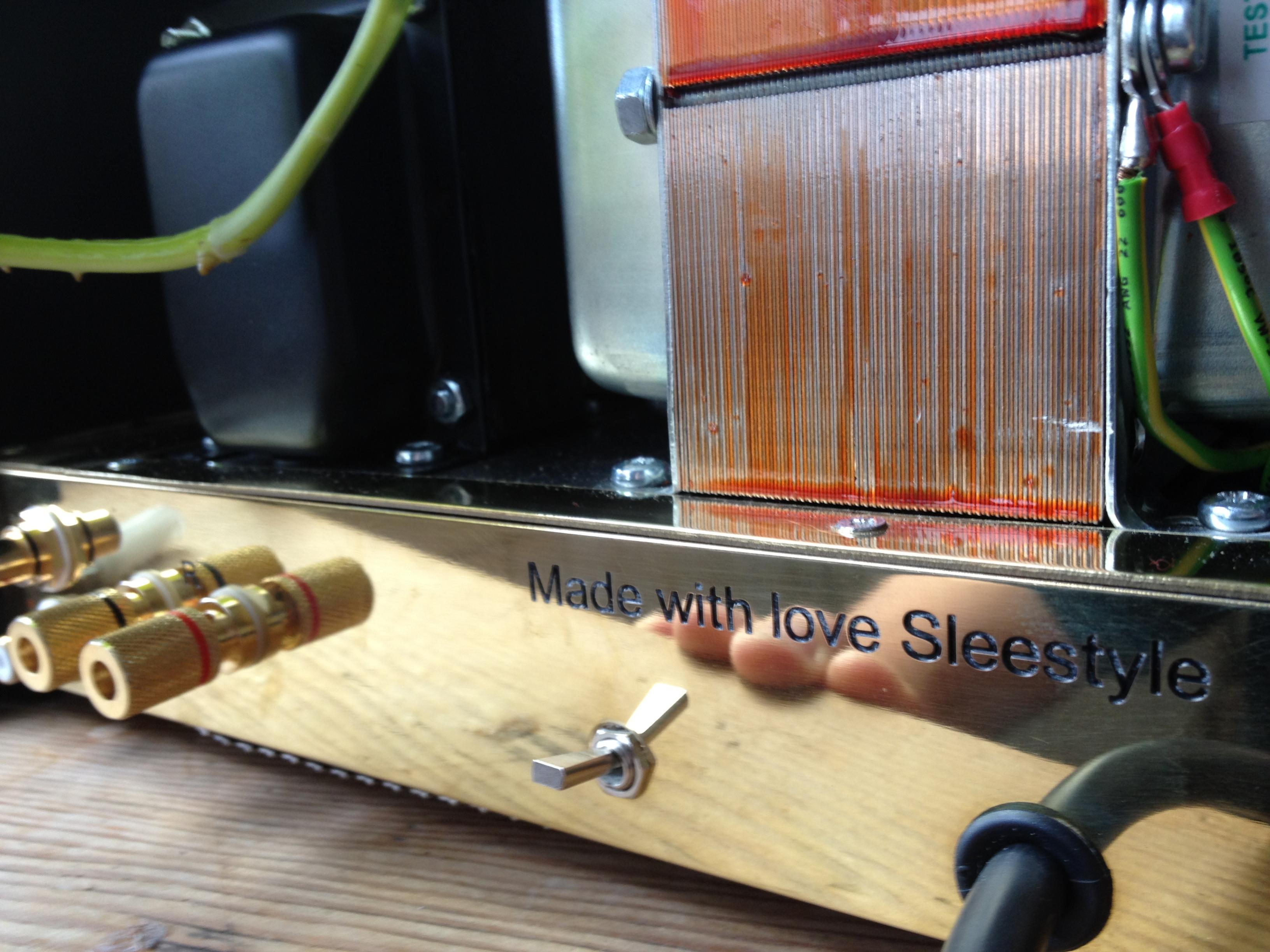

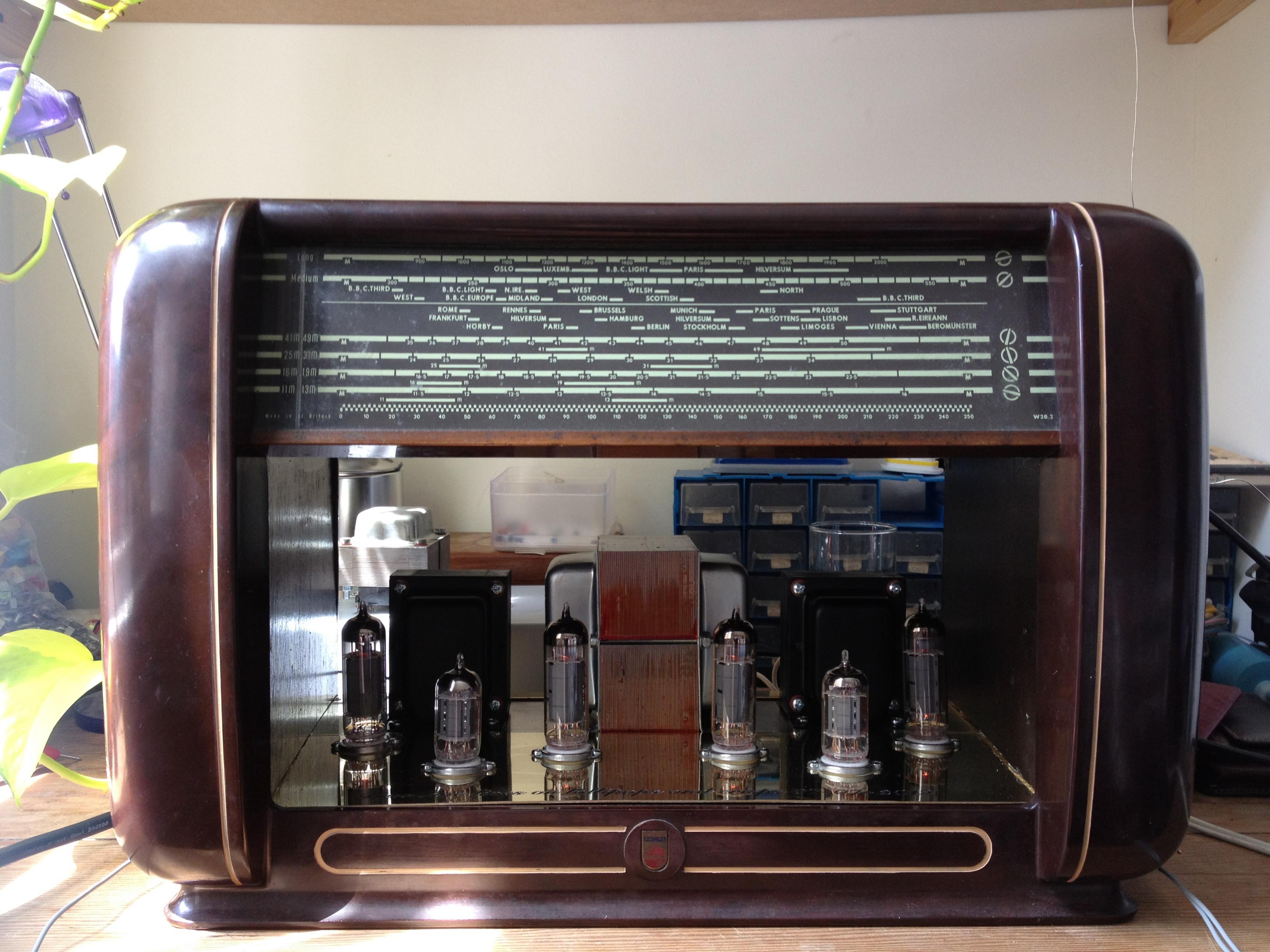

Here is an amp I built for a friends wedding present. It is an old bakerlight radio, gutted then a EL84 PP amp built inside. Engraved on the front is a lyric from Radiohead - True love waits and the date.
It sounds good, not amazing but good enough for a gift I think. And it took quite a while to get it all together - I thought my metal work was bad, it turns out my wood work is even worse!🙄 It is a little rough around the edges to say the least.
Right, now that is done I can finally get to work on my #26 preamp. I really don't know where you guys get the time for all your projects, you must all be retired! 😉
Cheers
Charlie

CSlee,
Nice build and very thoughtful. Hope your friends enjoy the amp, and most importantly their life together.

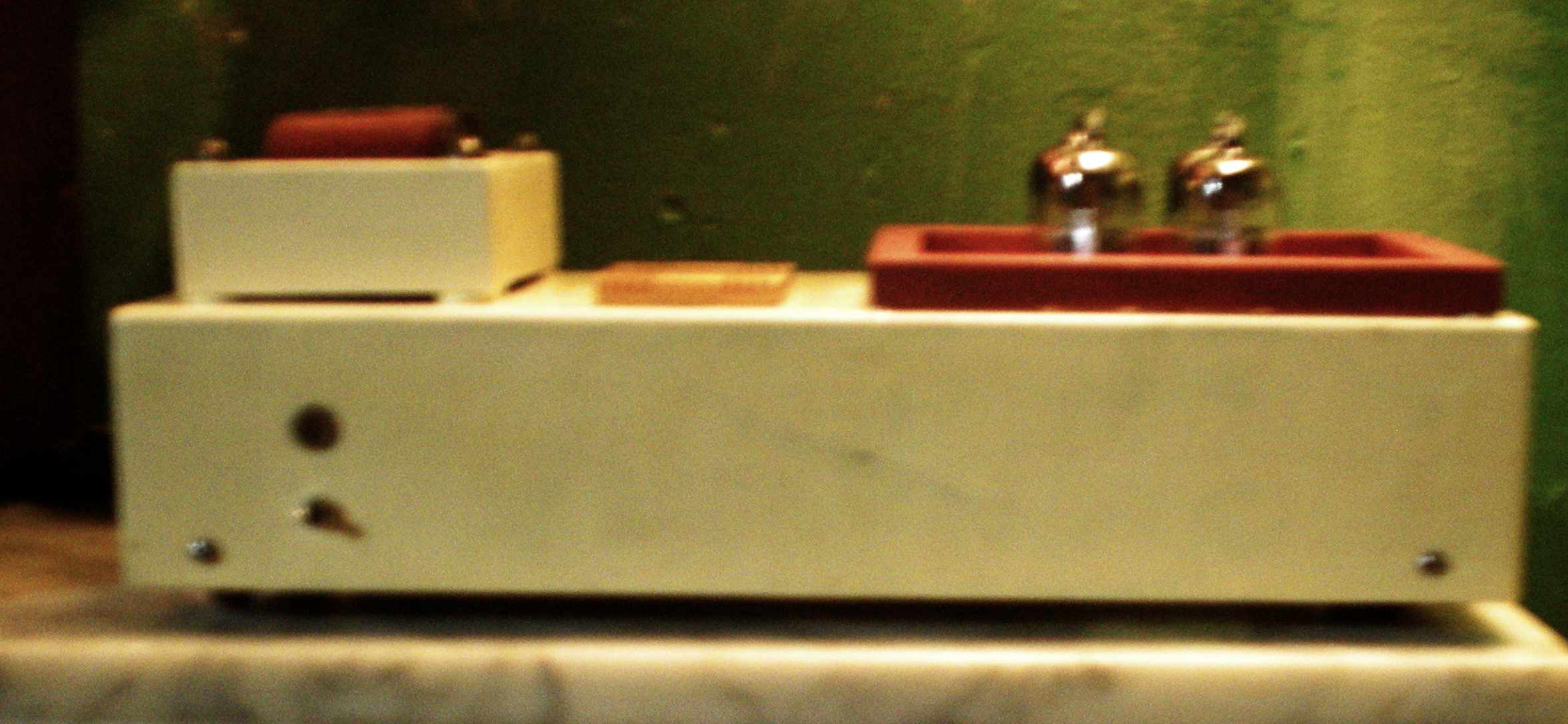

my first 6GK6 classA pp amp build:
Hope they thanked you for such a fine gift.
Thank you. Wedding is next weekend, I will be very glad to see the back of it!
Better give it one last clean before it gets packed up.

Very cool 😎 .
Cheers
Thanks, It's walnut, stained with some water-based red dye.Love the colour combinations and the art deco logo! Which wood for the cheeks?
Beautiful amplifier Charlie! What a great wedding gift!
