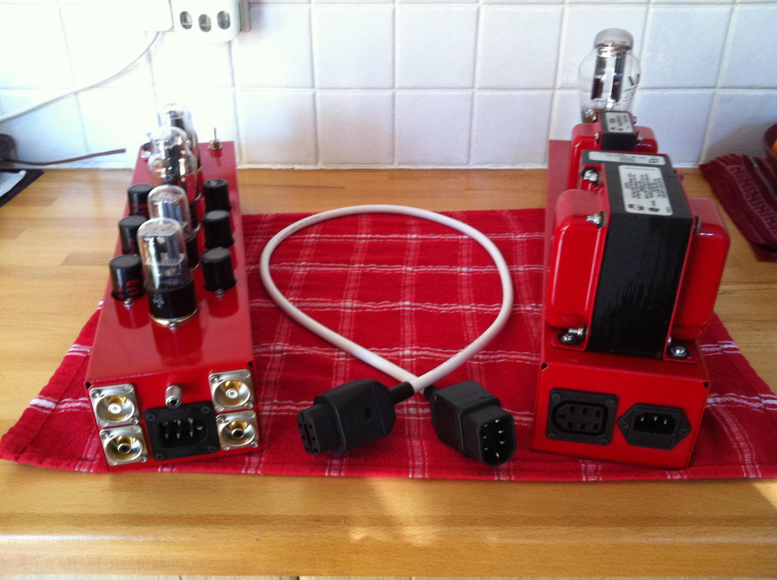

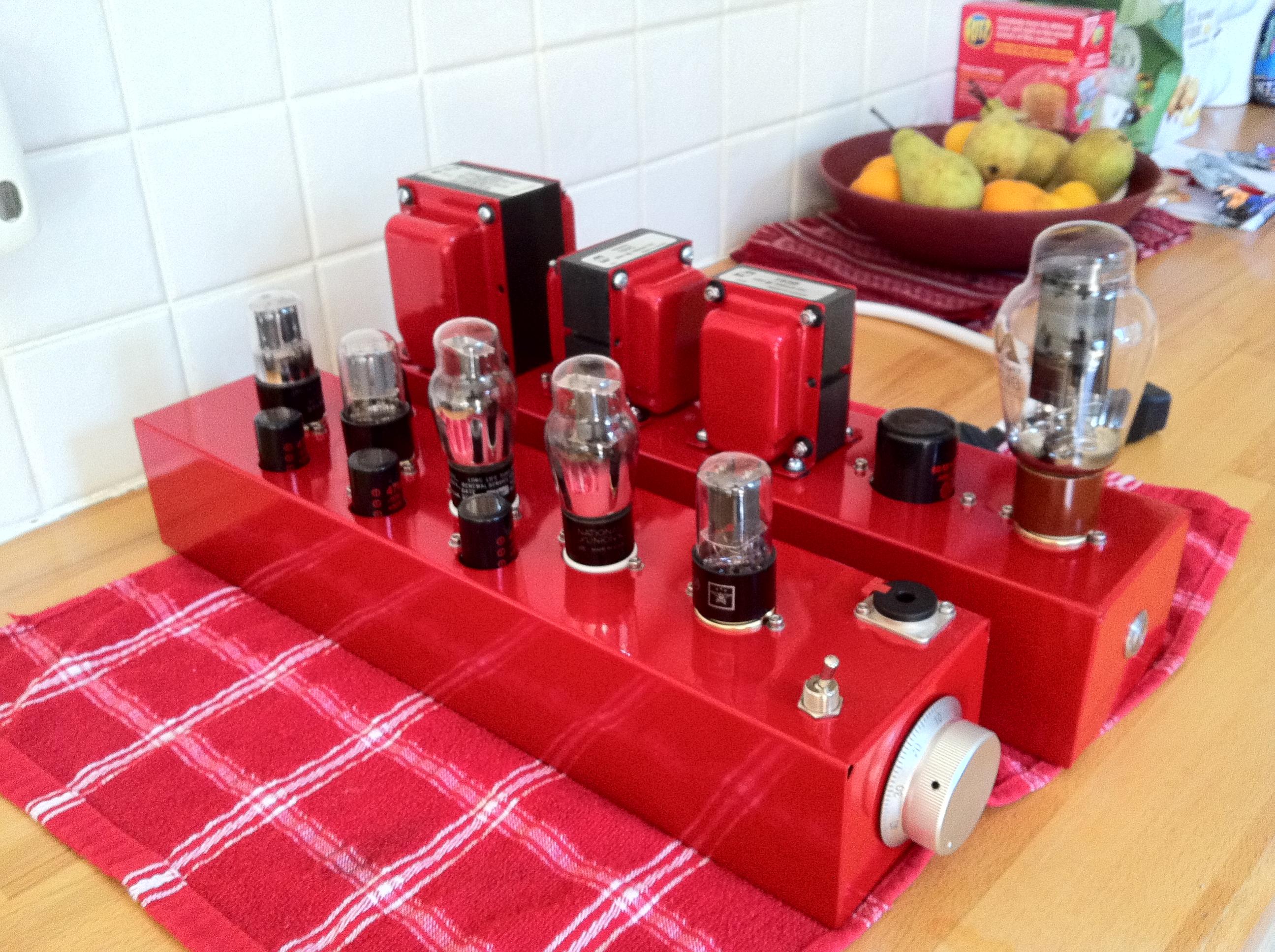

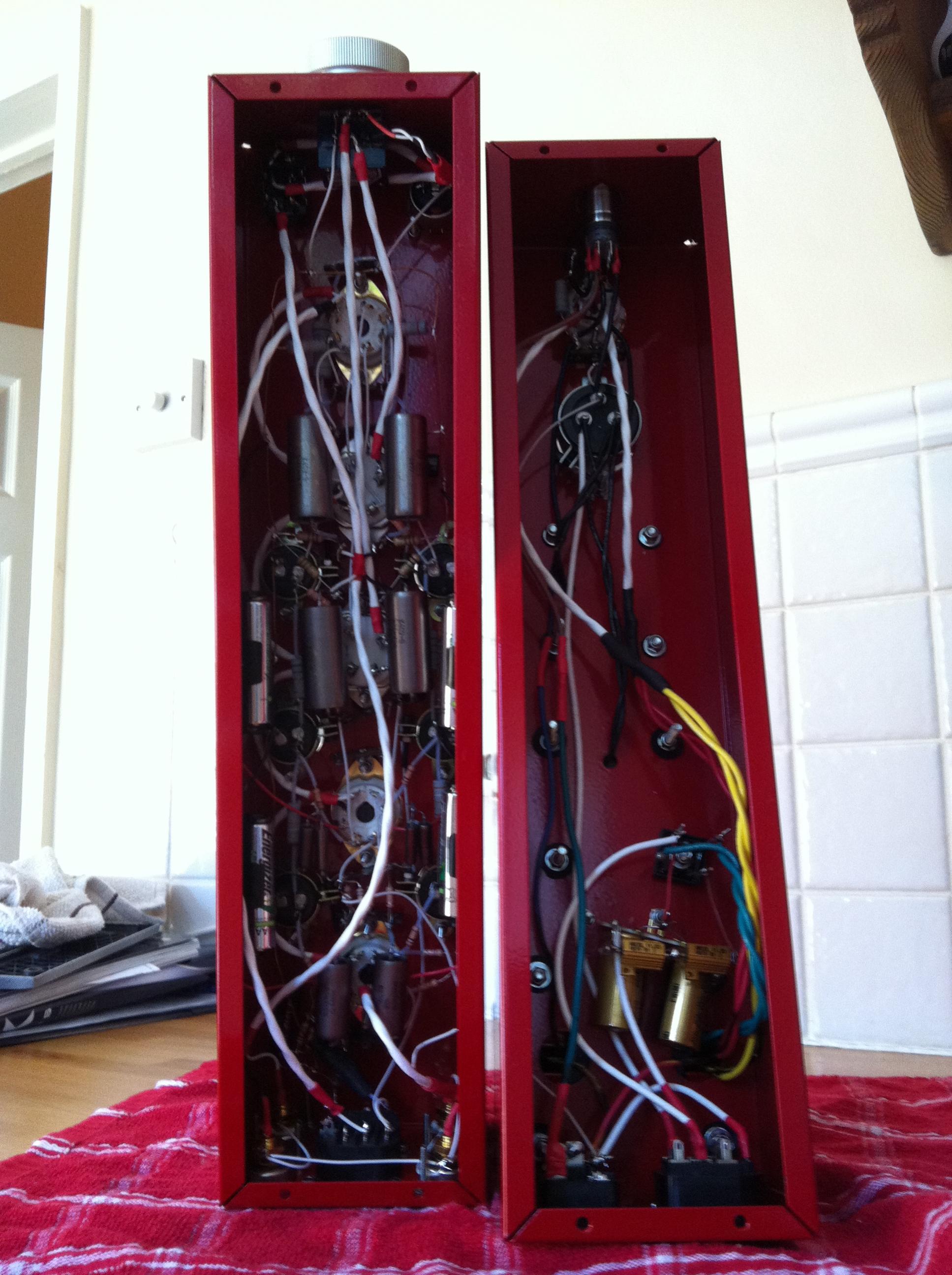

My latest project. A dual chassis phono preamp based on the JE labs circuit. Thanks guys.
Wonderful!
What model of network connections from the power supply to the amplifier?
Very nice to see some different designs🙂
PS Connection
The connections use 7 pin iec plugs and sockets bought from ebay. (Only four connections are used in this application.) They are rated 250vac 10amps but I rang the UK importer's technical department and was unofficially told that they should be able to handle 400-500vdc. The B+ is about 300vdc so I think safe enough...
pof@

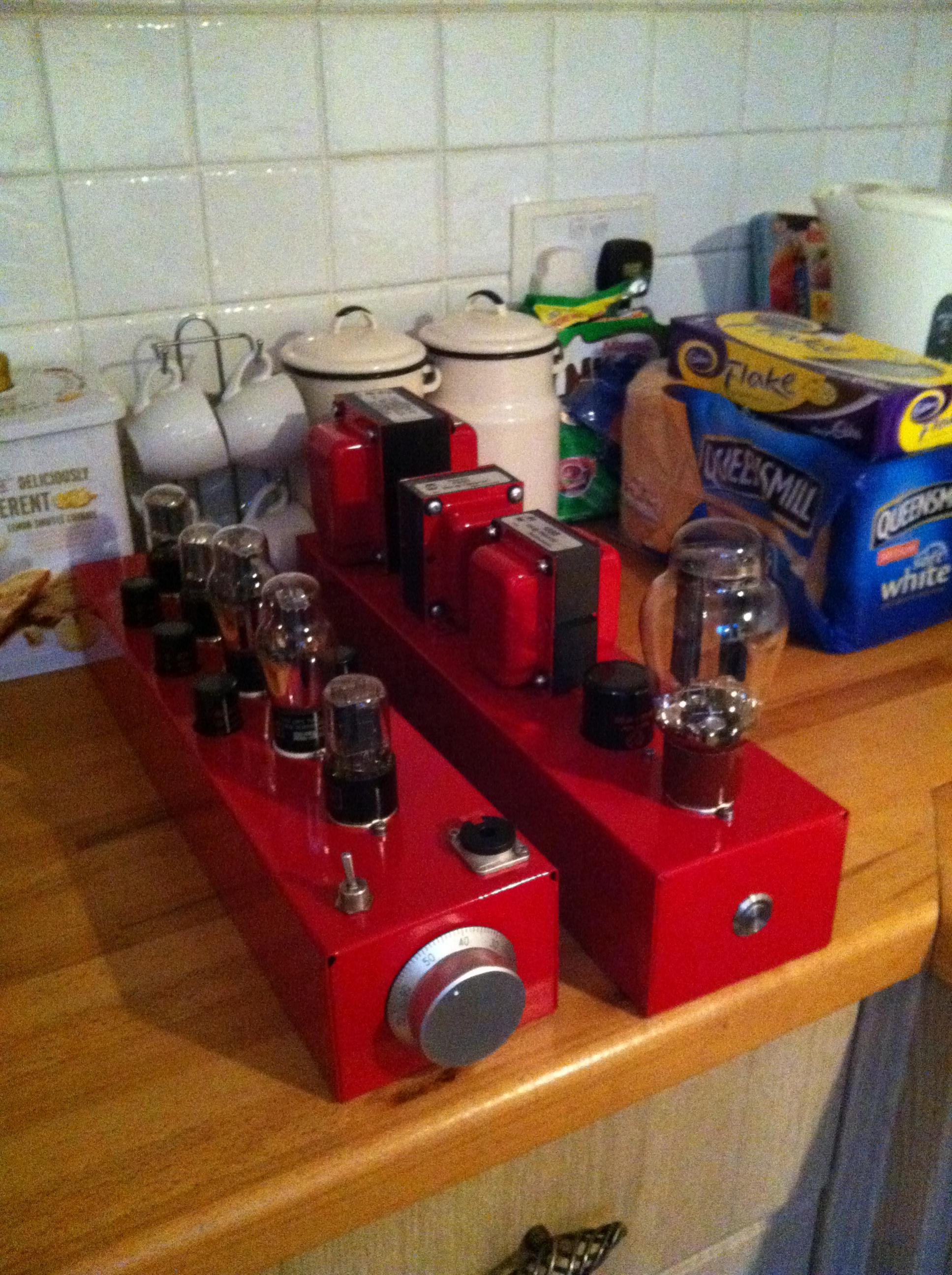

This is the matching preamp to my 2a3 amp on page 404 of this thread. The layout (inspired by the Icon Audio PS) was my solution to be able to get both on the same shelf. Thanks

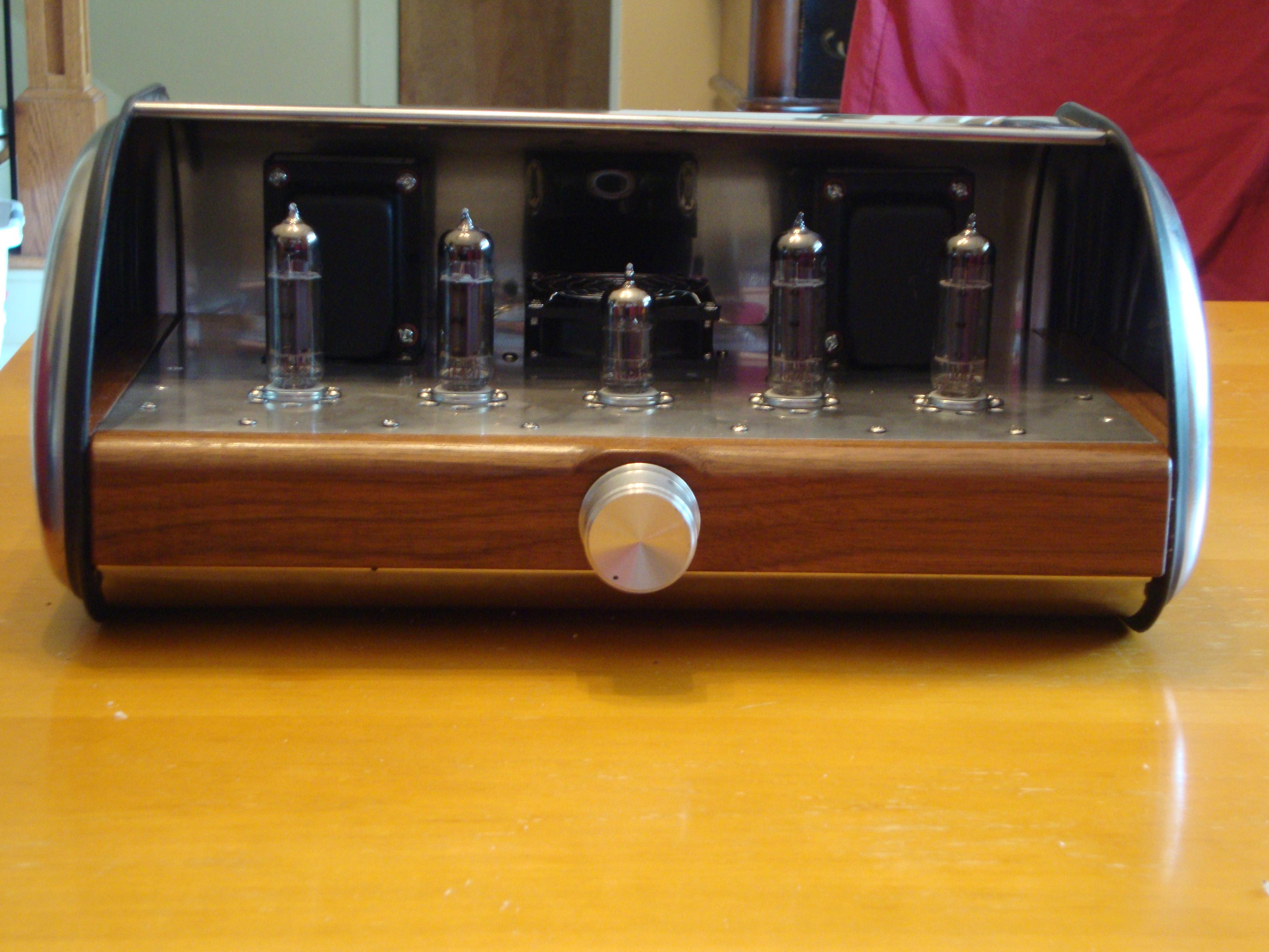

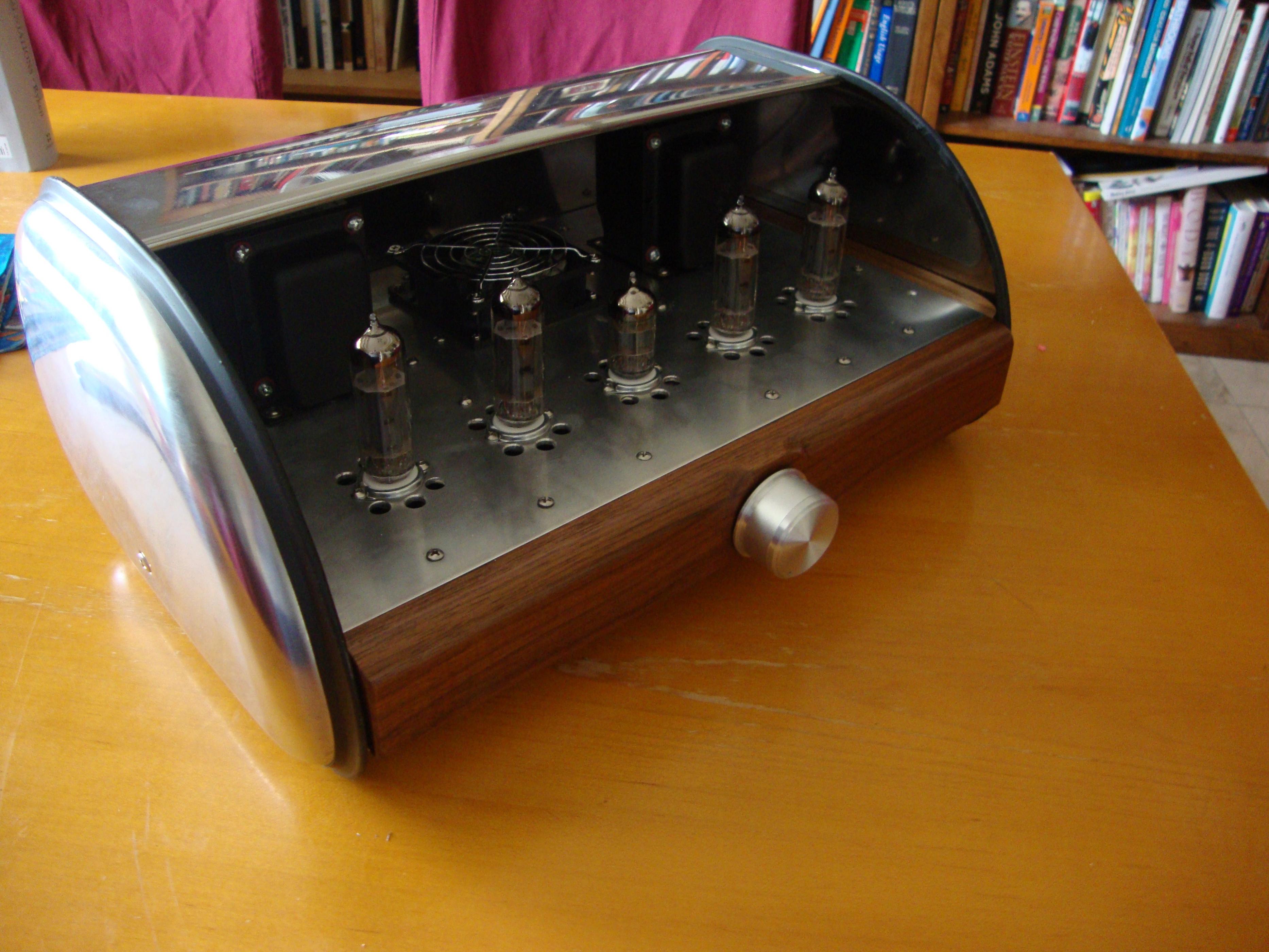

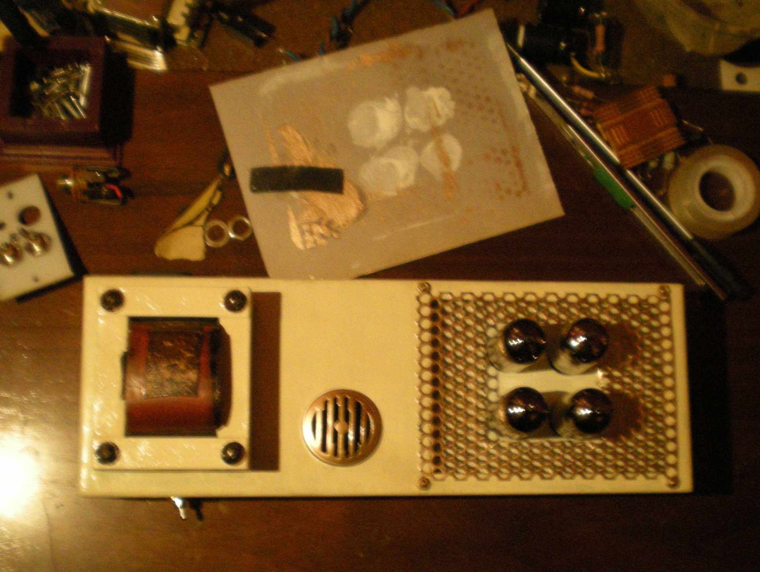

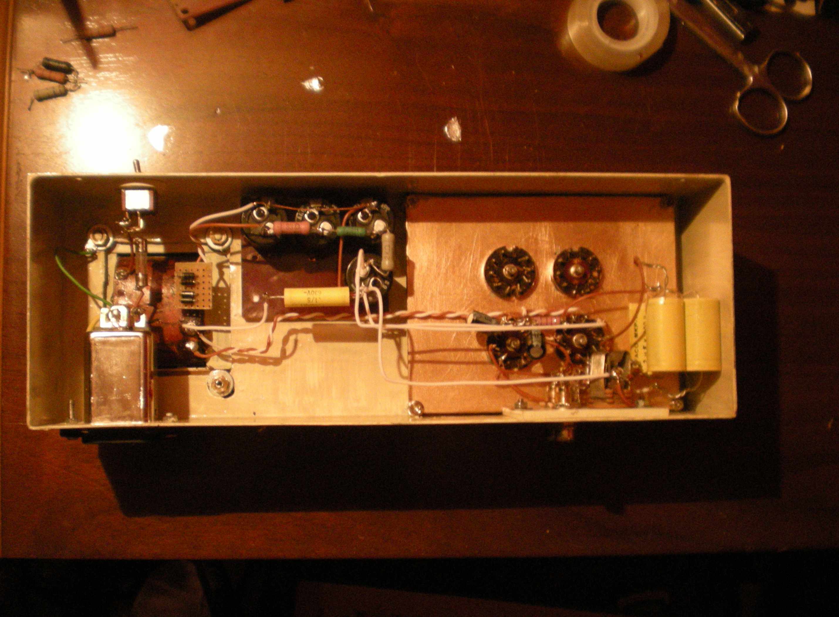

Headphone amp
Not finished (transformer needs a cover and I can't make up my mind about a few other minor details) but almost there. To be honest it looks like a DIY amp (it looks crap) but it will do. It was supposed to be a Mu follower + Cathode follower but when I started wiring it I got lazy and it ended up being only a SRPP stage. My headphones have a high impedance (600 ohms) so I think it will work, if not, I have two extra tubes to fix any deficiency. I'm not a headphones fan anyway.
Sometimes I build stuff that I don't need. Looking at the positive side, it is true that later I enjoy destroying stuff that I don't need. Kind of a mini god in my own terms. Anyhow, none of my creatures is perfect - they must die sooner or later.

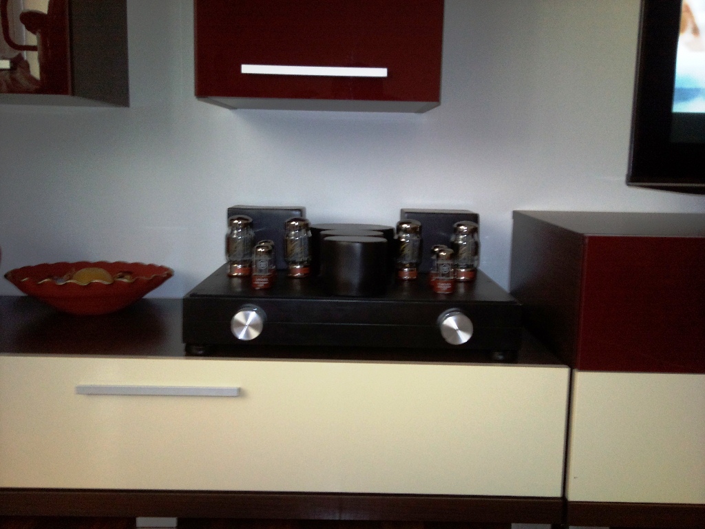

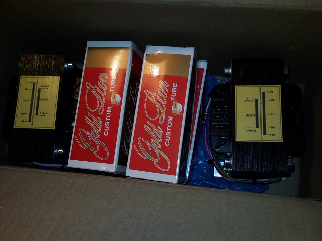

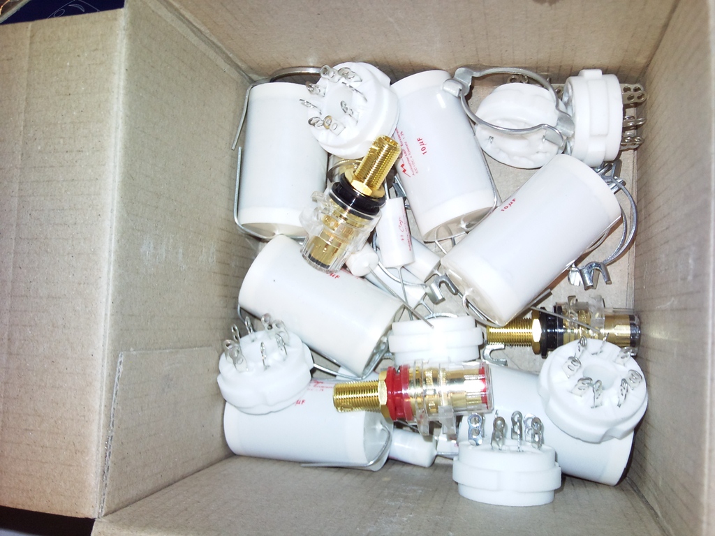

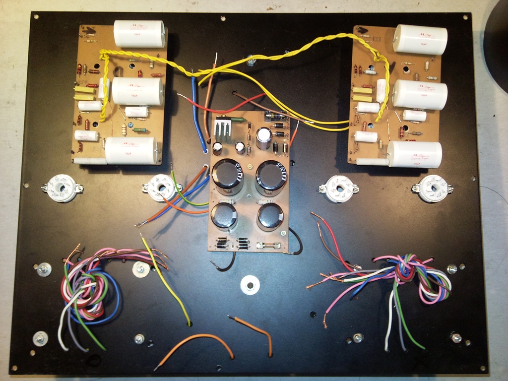

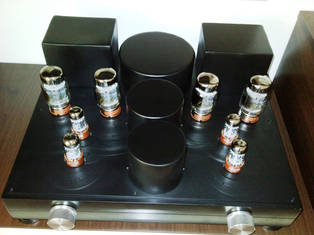

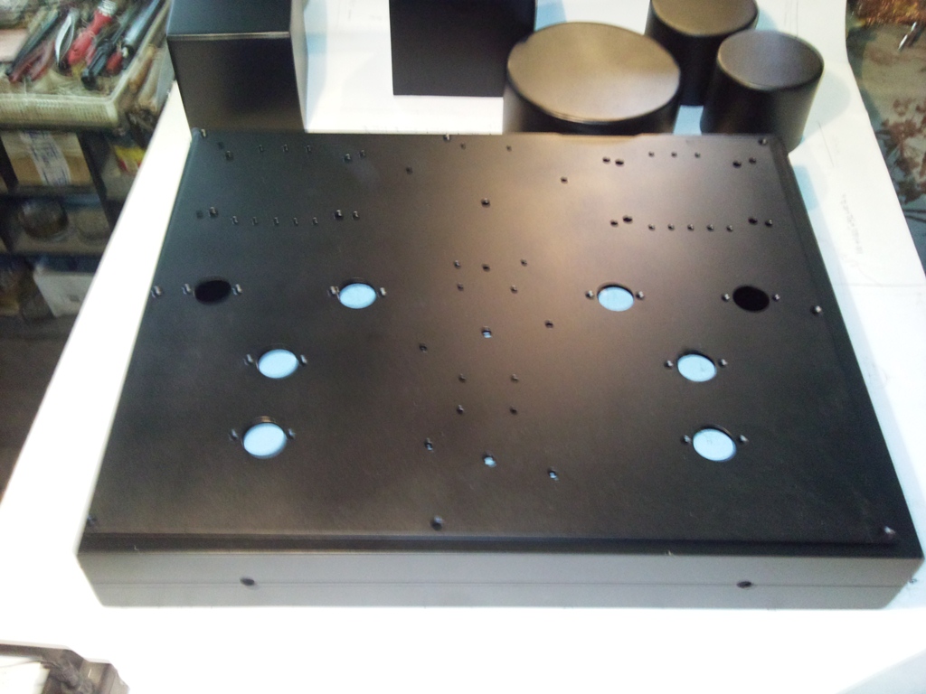

Hi !

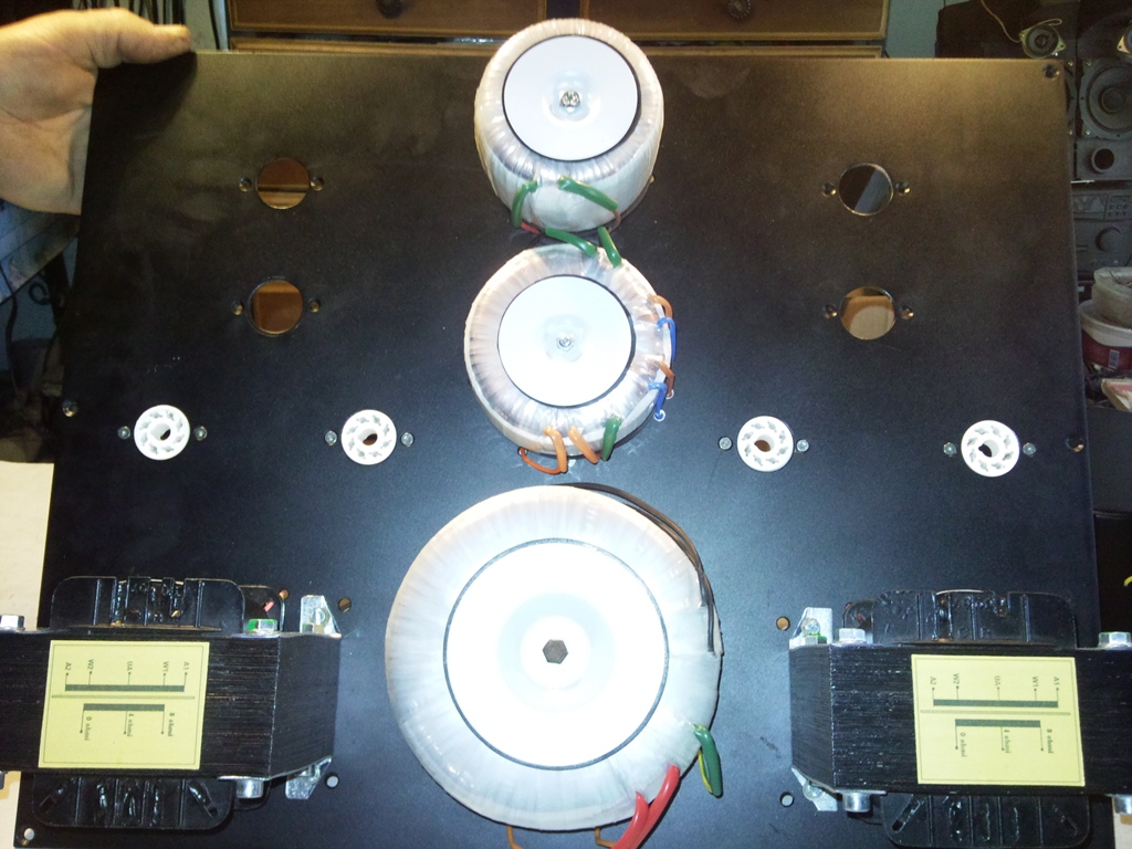

My amp kt88 - 6sn7, 2 channels 100 watts each...!

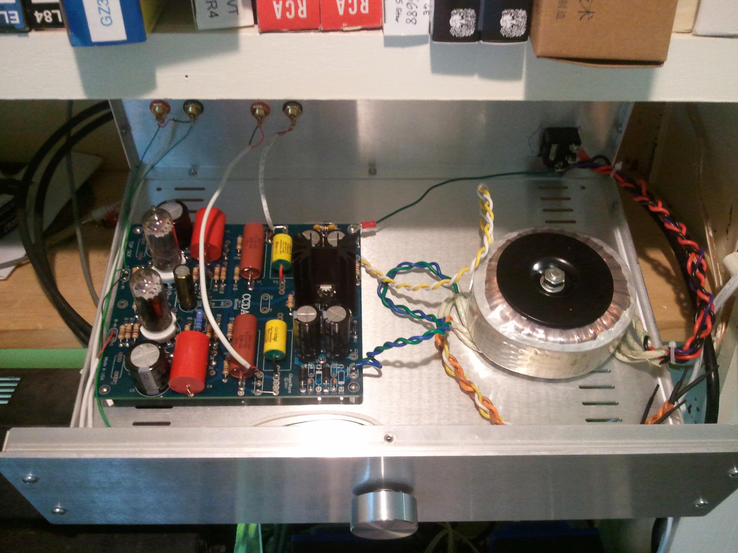

Just "finished" a Broskie CCDA rev 2 preamp
John had sent me a board to evaluate a while back and I finally got around to essentially completing it.
Still need to add the power switch and get some feet for the chassis.
Funny thing is that I used some "bad" ebay 6CG7's to do my smoke testing, they fuzzed/hissed really bad in my Aikido. I ended up doing the first sound test with them still in the sockets and they are DEAD SILENT!!!
Another weird thing is that I am measuring 4.2V across the 300ohm cathode resistors...so that is like 14mA... didn't know a 6CG7 was capable of that...
This is the first time I have used a Toroid for the PT and using a Par Metal chassis, which is very nice BTW...
The sound is excellent...I need to live with it for a while and break in the coupling caps...running russion K40Y9's .22uF and Auricaps .47uF in parallel.
Here is a righteous under skirt shot...
Pretty nice, do you have an schematic for that?Hi !
Thank you
Hi !
How much B+ are you running the amp?
What's your bias current?
Is it pentode?
I just finish a pair of mono block PP kt120 with B+ 580
and bias @ 75ma
UL conected and I don't really know how many watts I'm pushing.
Just wondering how you measure your.
Why not goind the old school route? Hook up an 4/8 dummy power resistor to the output, measure voltage, and let ohm's law make the magic. Should help to have a scope.Just wondering how you measure your.
Pwedi po,ba ang vacuun tube for disco music ksi sa pagnka alam ko pang
classic lng sya ma,ganda pa kinggan
Thanks!
Just got a scope a week ago, I will be doing the ohms law thing, but I was wondering if the 100 watts claim was an estimate.
The wired state forum is bilingual maybe it's more polite to post in Tagalog there. But to answer, I suppose with sensitive enough speakers then disco is not out of reach. After all these amps use to provide the sound in cinemas.

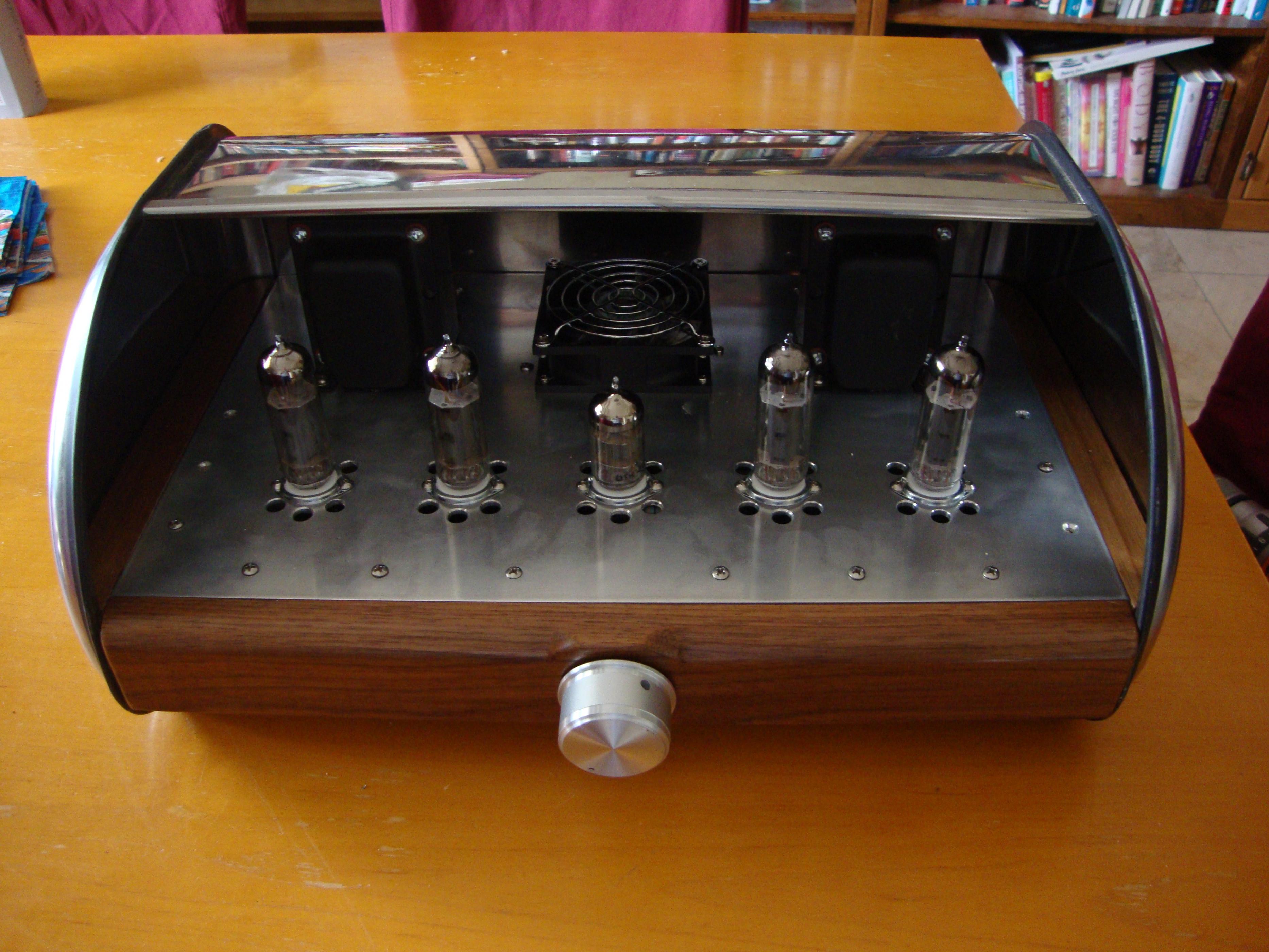

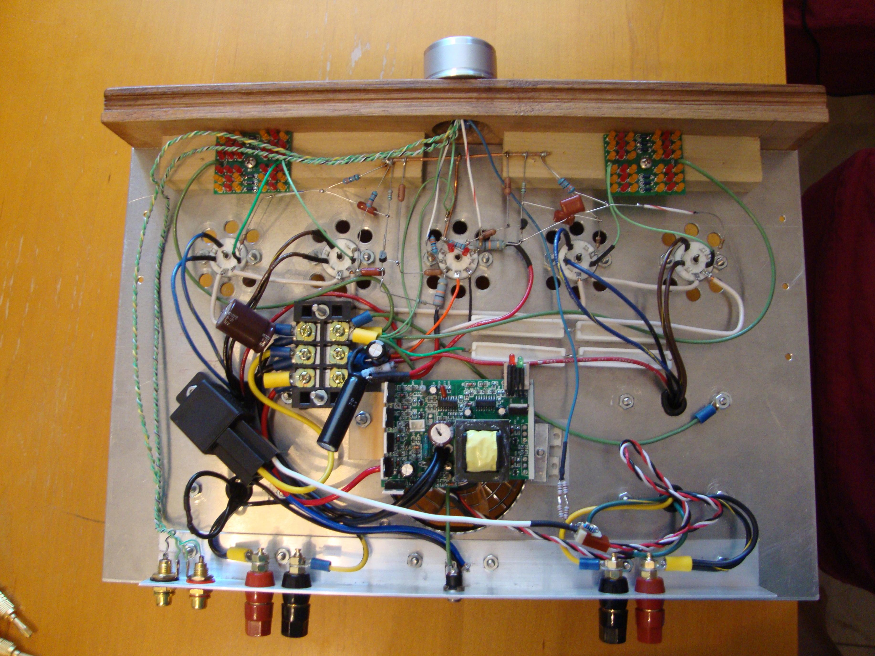

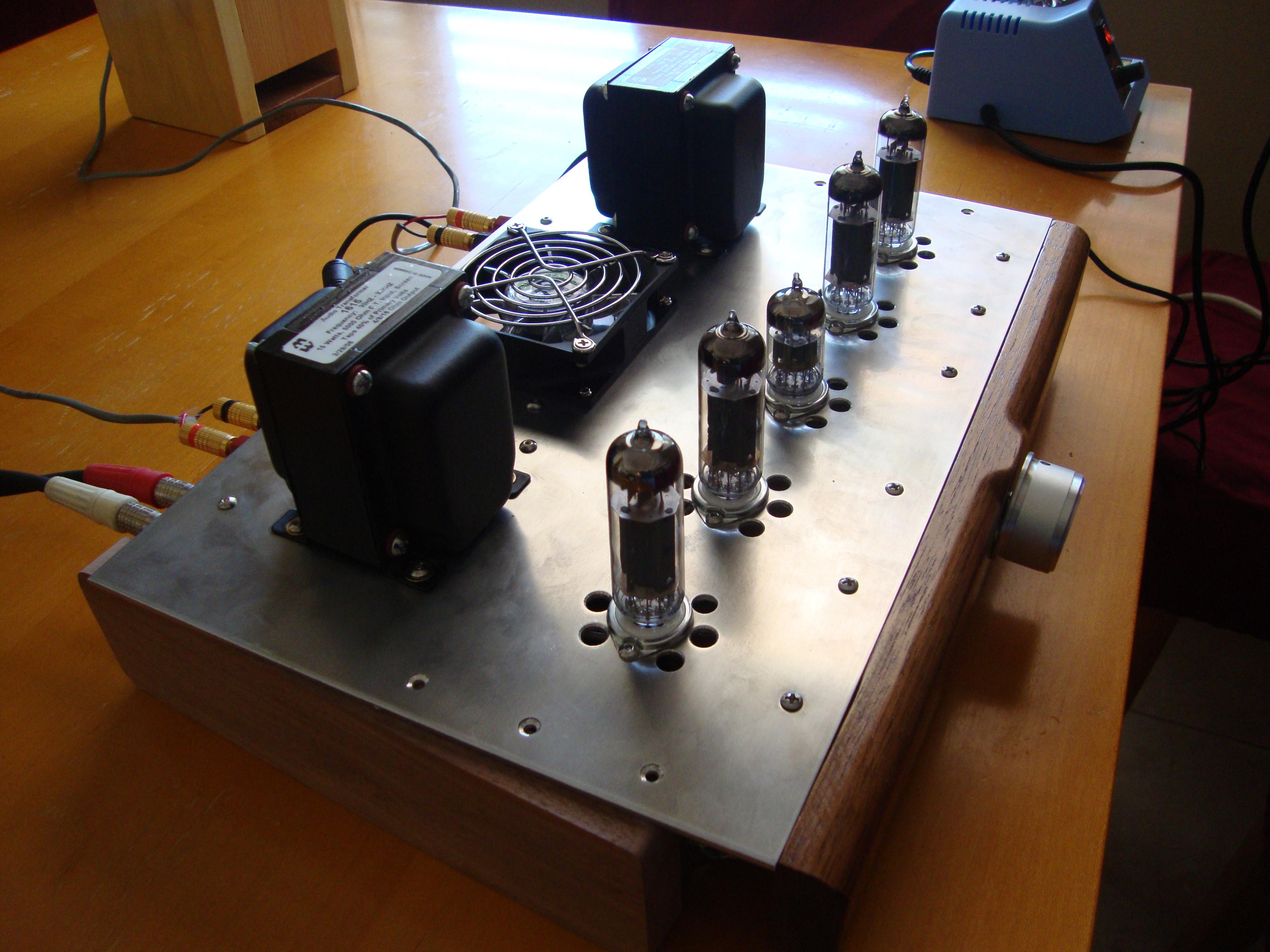

This is my Tube amp.
6922-12AU7- 4 X EL84 PPP
Switching psu and a lot of leds. Interesting/different. Do you have schematic? How is the sound?
