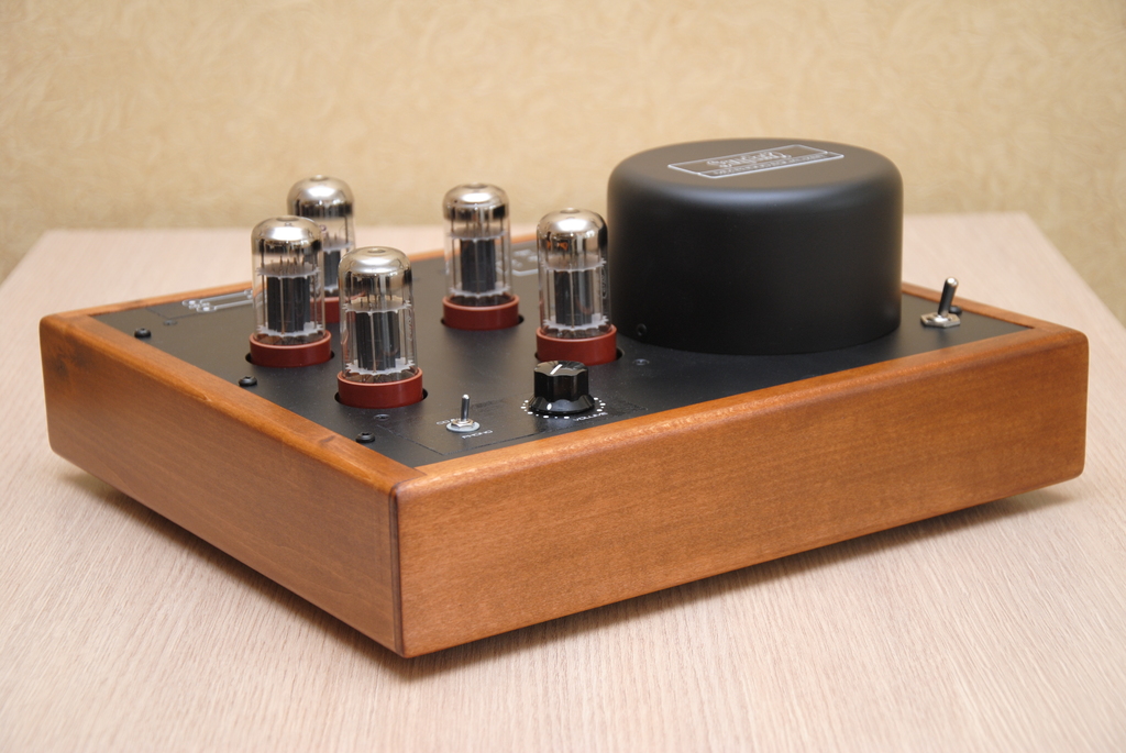

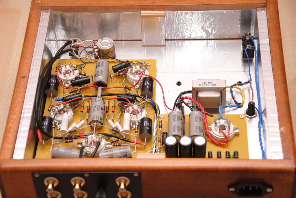

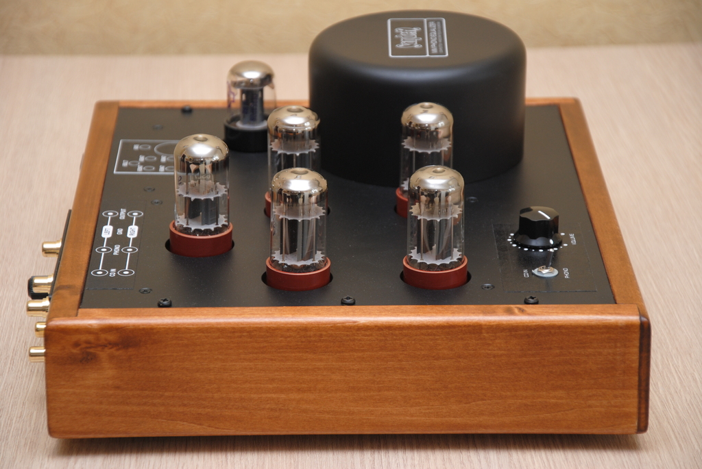

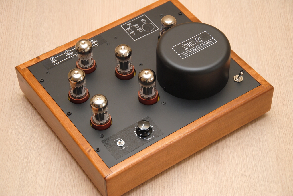

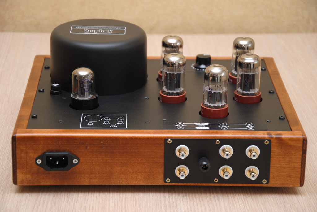

6SL7/4x6SN7/6X5 phono stage/preamlifier.
Damn! That's nice!! I really like the lap joints in the woodwork. The component outline with the tube types indicated is a nice retro touch as well. Nice work. Thanks for sharing.
~Tom
tomchr, boywonder, thank you!
Labels I do myself. I draw in Corel Draw and then print out on a laser printer (Samsung ML-1215) on plain paper. Varnished and glued with double-sided adhesive tape.

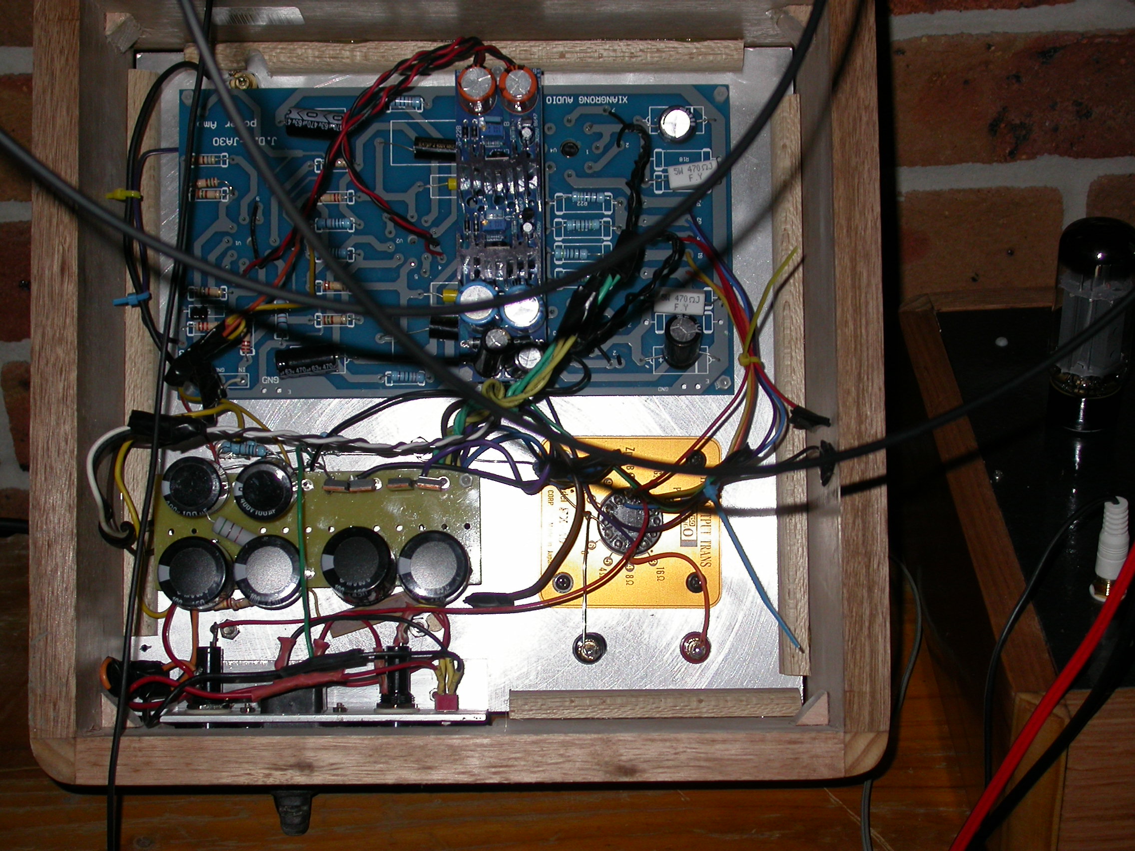

Jadis 30 clones .. Audio8 boards
I built a couple of these . Used Tango (ISO) transformers I picked up in Tokyo recently
The boars come from audio8 they could be smaller .. I used the provided (huge ) power supply boards in one but did one on a tag board on the other.
I think Iwill provide some balanced inputs for them as I am using long lines.

MOTIP Dupli-Color.Sander'z Perfect work! What type of varnish you use?
the timber is Tasmanian oak and the varnish is a spray gloss estapol.. lots of sanding. the corners are pine moulding

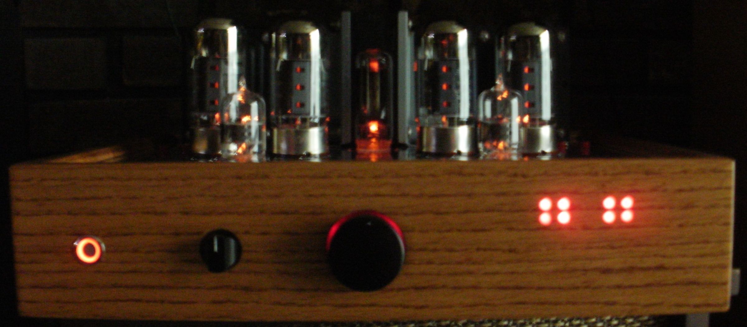

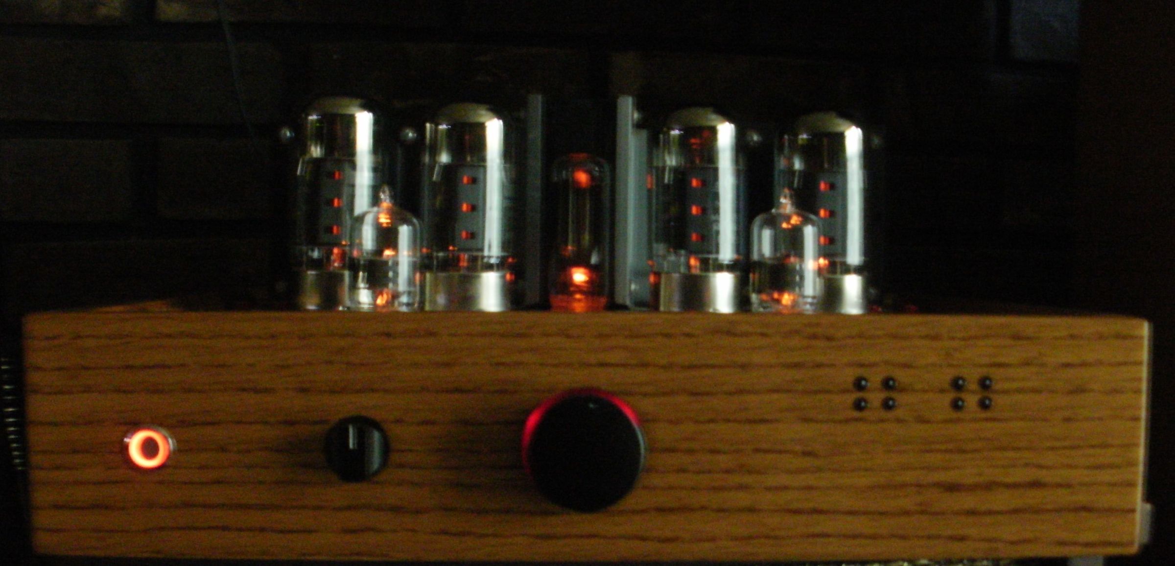

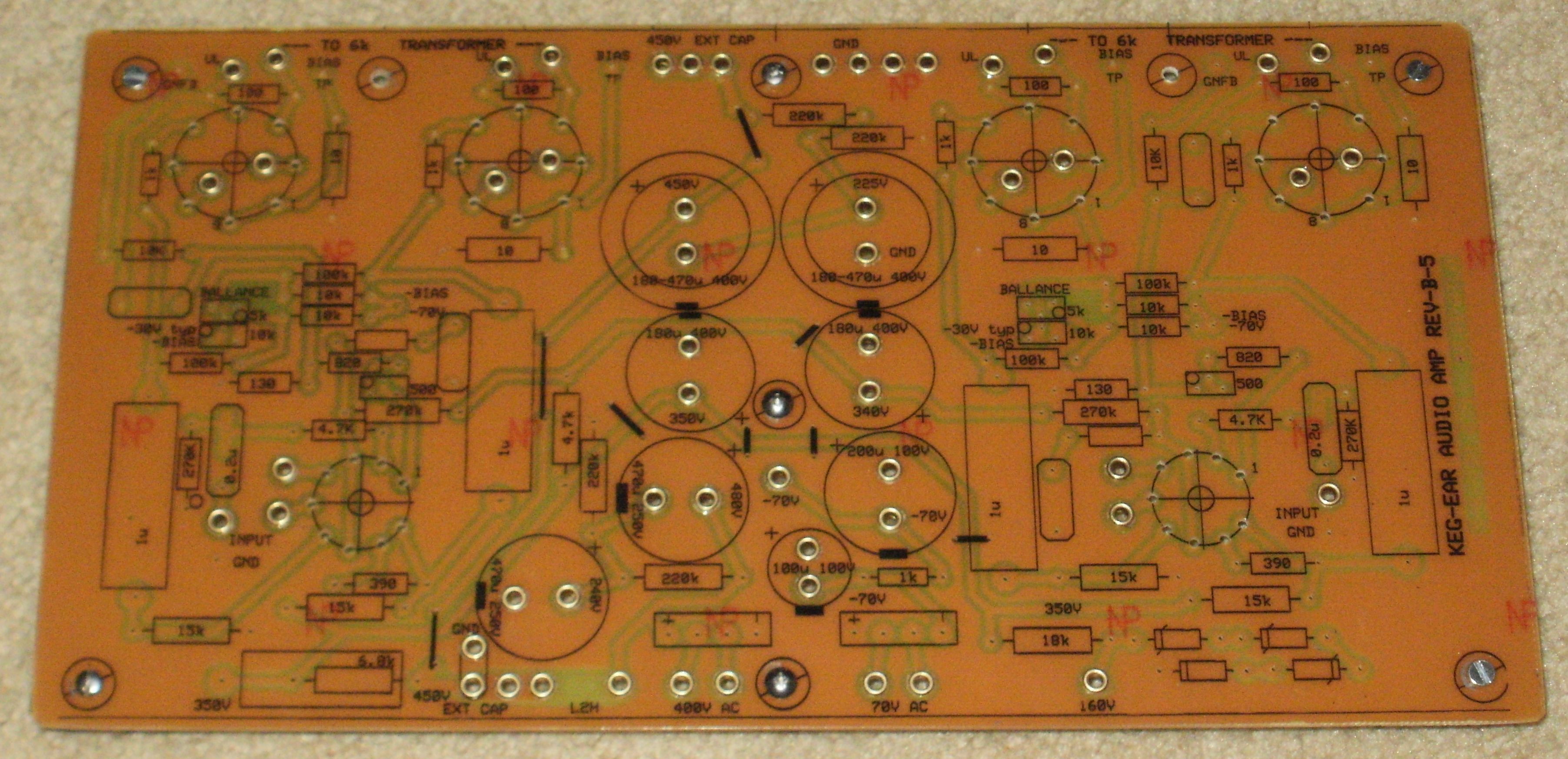

KEG-EAR AUDIO AMP
6L6-KT88 based amp, UL-Triode selectable. 60 watt Hammond 4.3k output iron. PCB is toner transfer method etched in a sink, brass eyelets used for all wire and underboard caps. worked with low cost 6P3S Russian 6L6 to KT88 tubes. 6550=C= were the best to my ears in triode mode. LED bias monitors on front to indicate a bias shift or bad tube. Oak chassis with 10 coats of tung oil.
