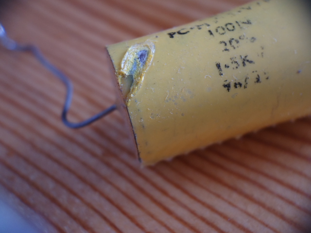

Just impressive. Why did you placed orange tape around capacitors?
Modern type axial foil caps have quite thin outer layers of tape; the one in pic was grazed with a soldering iron to the outer foil; and rendered useless due to moisture ingress. A cap with this must be rejected fom audio circuits.
The same applies to modern resistors; can become noisy if outer layer is scrapped.
Nomex tape is bit pricy, but burn resistant and saves alot of troubles so I wrap a couple of turns round delicate components.

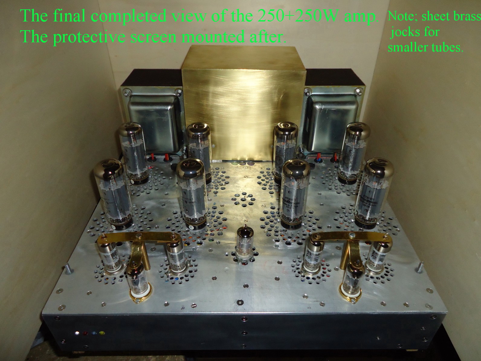

Pic of the previous amp; this latest one built on exactly the same circuit lines except with slightly lower A-A imp enabling a maximum output power of 550W.
The work continues.

No, not useless because I'm using them. I have an amp in which both coupling Auricaps got badly burned. I sanded the rough edges off and leveled the crater with some wax, then a sticker. No problems after several years. I'm not saying this is a good thing to do, I'm just saying this is what I did. Very open sound. Haha.

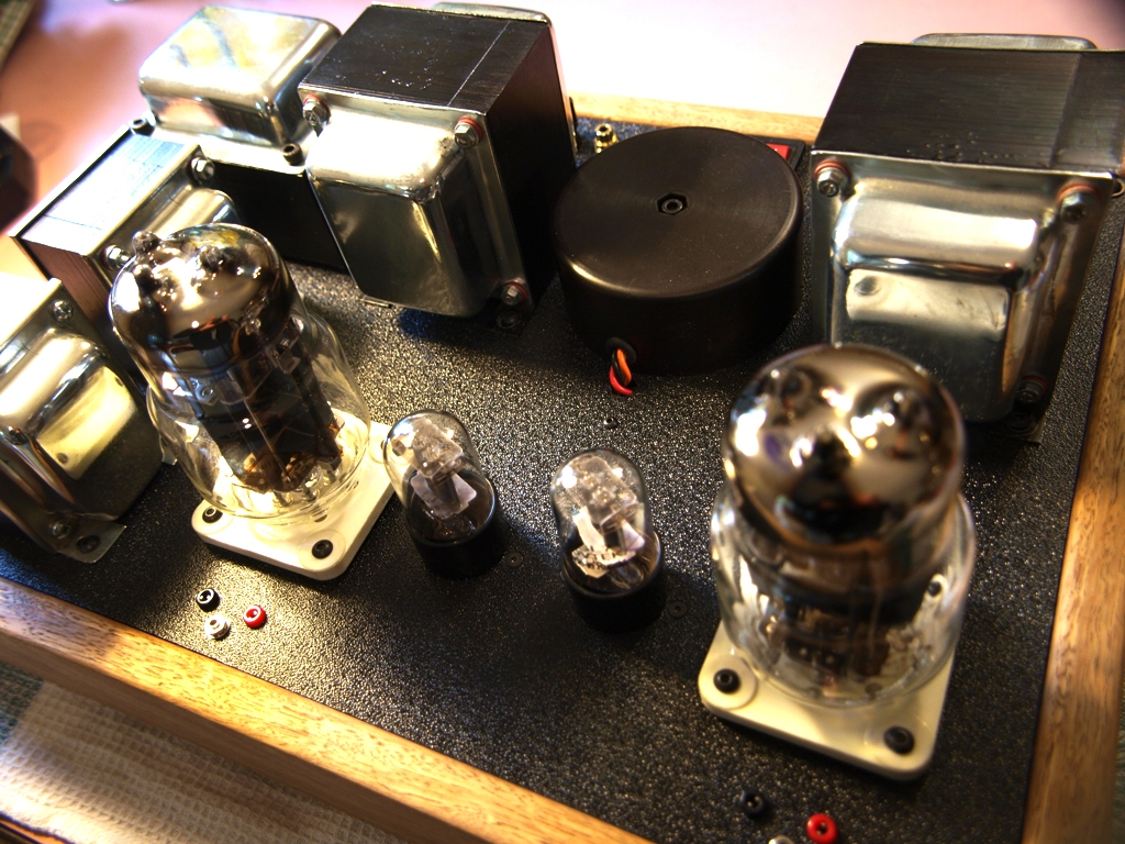

Had my Stealth-5 finished after a smaller mod - adding an extra line input, an iPod dock and a selector switch.
Tubes are glass 12A6 and metal 12SJ7 and 12SC7. Transformers are standard 8K PP OP trannies and a special ordered mains transformers. No bells or whistles but it plays good music without sounding bad. Goes well with my small 5" Sonido horn speakers.
(Don't tell me, I had accidently swapped a pair 12SC7/12SJ7).

That's a cool amplifier!
